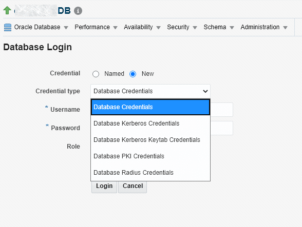

When you select the New radio button for Credential on the database login page, a drop down menu displays allowing you to select from a list of credential types enabled for the database target.

You enable one-time login using multiple credential types as well as enabling support for the two new credential types (RADIUS and Kerberos Keytab) via the OMS property oracle.sysman.db.multiCredTypeLogin.
emctl set property -name oracle.sysman.db.multiCredTypeLogin -value true
A value of false (or property not set) will disable this functionality and revert to the authentication functionality from Oracle Enterprise Manager 13c Release 5 Update 5 (13.5.0.5) and earlier. The default value is false if the property is absent.

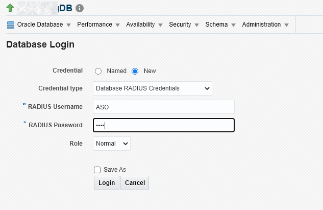

Synchronous Login
Enterprise manager supports one-time database login using RADIUS by setting following OMS properties:
emctl set property -name oracle.sysman.db.enable_radius_auth -value true
AND
Enabling the RADIUS authentication type provides a full-fledged RADIUS credential type that will prompt for the username and password, as shown in the following graphic.

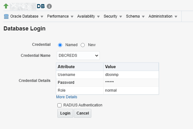

Co-existance with an Earlier Version of Radius Authentication
If you are using the existing option of specifying the OMS RADIUS property and used the Enable Radius checkbox in the database login UI, set the following OMS properties as shown below to revert back to the original behavior for RADIUS credentials.
emctl set property -name oracle.sysman.db.multiCredTypeLogin -value false (or unset this property if previously set via emctl delete property -name oracle.sysman.db.multiCredTypeLogin)
emctl add property -name oracle.sysman.db.enable_radius_auth -value true

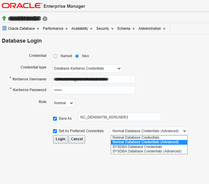

 - Define and Set a Kerberos/RADIUS Credential as a Preferred Credential via the One-Time Database Login Option
You can set the following OMS properties to enable a one-time database login using a new RADIUS/Kerberos credential type.
emctl set property -name oracle.sysman.db.enable_kerberos_auth   -value true
Once the above Preferred Credentials are set on the database and/or related target, they can be used for underlying jobs (like ExecuteSQL or SQLScript) that support these advanced credentials types.
