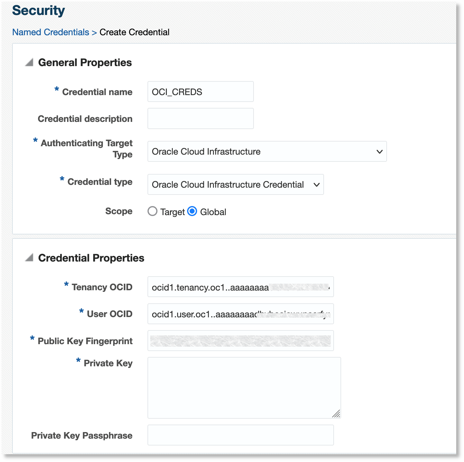

  1. Click the setup icon Setup icon, click Security, and select Named Credentials. The Named Credentials page is displayed.
  2. Click Create. The Create Credential page opens.
  3. OCI Named Credentials
    Provide the following information:
    • Credential Name: Provide a suitable name to the credential. For example, OCI_CREDS.
    • Credential Description: Describe the purpose of the credential and the intended use.
    • Authenticating Target Type: Specify the target type for which this credential set will be used for authentication. Select Oracle Cloud Infrastructure from the menu.
    • Credential Type: Specify the type of the credential that you're creating. Select Oracle Cloud Infrastructure Credential from the menu.
    • Scope: Select the visibility of the credential in Enterprise Manager. Select Global.
    • Tenancy OCID: The OCID of your OCI tenancy.
    • User OCID: The OCID of the user to access OCI.
    • Public Key Fingerprint: Provide the fingerprint of the public key of your API signing key pair.
    • Private Key: Provide the private key of your API signing key pair.
    • Private Key Passphrase: Specify the passphrase of your private key, if any.
    Click Save.

    • Username and Password: Provide the user name and password to access the storage cells. This is the exacli user that was generated as part of the Exadata Cloud Service setup.
    • Run Privilege: You can select the level of privilege provided to the user for access.
    • Access Control section: You can add grants, and select the grantee in this section.
    Click Save.
You can now view the new credential created in the Named Credentials page.
