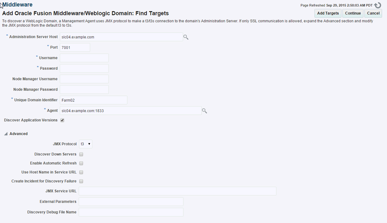

Discovering the SOA Suite
You can use a local or a remote Management Agent to perform the discovery process. as follows:
Discovering the SOA Suite Using a Local Agent
If you use a local agent, you need to use a Management Agent that is running on the same host as the Administration Server.
Discovering the SOA Suite Using a Remote Agent
You can discover the SOA Suite using a remote agent which may be running on a host that is different from the host on which the Administration Server is running. In this case, you may not be able to provision SOA Artifacts remotely, or capture the host metrics.

Discovering the SOACS Instance Using the Hybrid Cloud Agent
You can discover a SOA instance on the Oracle Public Cloud in Enterprise Manager using the Hybrid Cloud Agent. To understand the architecture of the hybrid cloud see Enabling Hybrid Cloud Management in the Oracle Enterprise Manager Administrator’s Guide. The steps required to discover the SOACS instance are also a part of the same chapter. However, a detailed listing of the steps along with the relevant links to the sections is given below.
