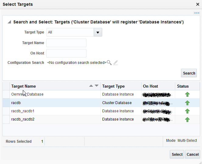

 - Click Create Rule Set. In the Create Rule Set page, in the Targets region, select the All Targets of types option. Select Java Virtual Machine and Java Virtual Machine Pool target types.
 - Click Create in the Rules region and in the Select Type of Rule to Create window, choose Incoming events and updates to events option and click Continue. The Create New Rule: Select Events page appears. In the Type drop down list, select JVM Diagnostics Threshold Violation.
 - Then select Specific events of type JVM Diagnostics Threshold Violation.
 - Click Add. The JVM Diagnostics Threshold Violation Rule window appears. Select the JVM Diagnostics metrics that will trigger threshold violation events. These events will be promoted to incidents. Click OK. Click Next, review the rules, and click Continue to save the rule. All events that match the criteria will be promoted to incidents and will appear in the JVM Diagnostics Pool Home page.

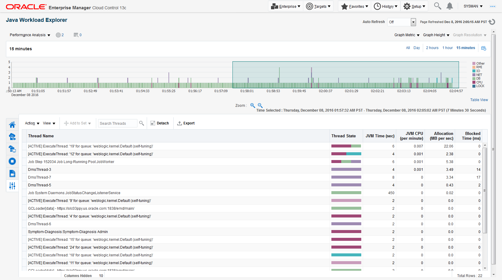

This page shows the real-time data for all the JVMs in the selected pool. This data is useful in analyzing the various active and idle threads on the JVM. During analysis you can drill down from the thread level to methods used in the thread to local variables that are part of the method.
From the Targets menu, select Middleware, and then click on a Java Virtual Machine Pool target. Select the Live Thread Analysis option from the Java Virtual Machine Pool menu.
This page shows the following:
JVMs: This table shows the list of JVMs and the current status of each JVM. The current activity of the JVM including CPU usage, memory, number of threads waiting for a database response, number of threads waiting for synchronization lock, and other details are displayed
JVM Threads: This table shows a list of all the threads running in the selected JVM. For each thread, the following details are displayed:
Thread Name: Name of the thread. Click on the link to view the JVM Stack.
Request: Application request being processed by the thread.
OS PID: Operating system and Thread IDs for this thread.
Current Call: Lowest user method being executed by the thread.
File Name: Name of the file that contains the class and method for the current call.
Line: Line number in the method currently being executed.
State: The current state of the thread. This can be DB Wait, RMI Wait, or Network Wait.

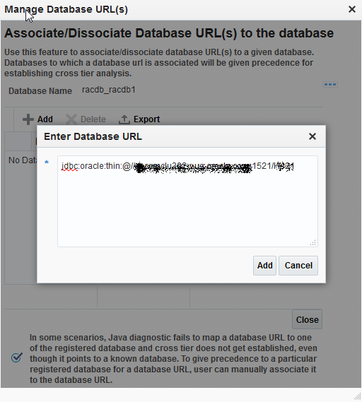

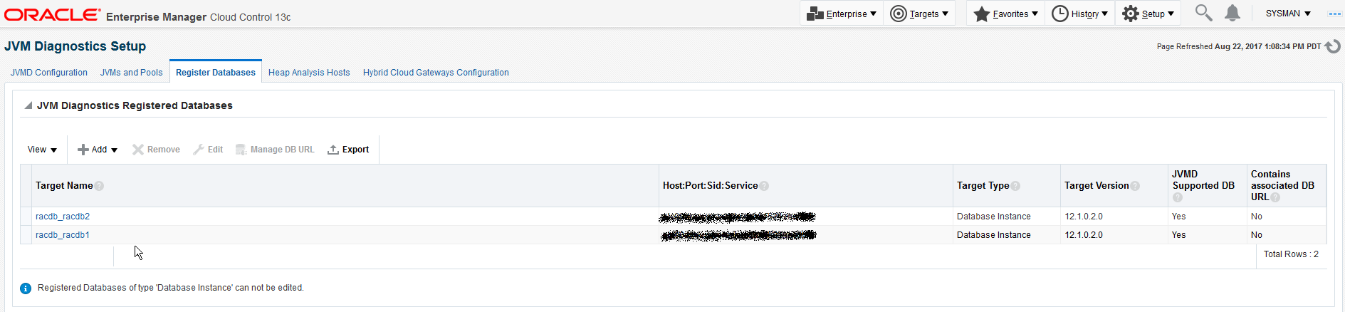

If a thread is in the DB Wait State, the Waiting On column displays the name of the database the thread is waiting on, and the time the thread has to wait is displayed in the Waiting Time column.
Click the link to view the database diagnostics details. See Performing Cross Tier Analysis for more details.You can track database issues and determine the application request responsible for the database activity. You can also view the complete call stack including the method and line number information.
To view the database diagnostics details, ensure that:
The JVM Diagnostics Agent is running on the JVM that initiated the request.
The monitored database must be registered by the JVM Diagnostics Engine.

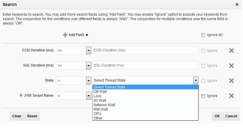

Search/Filter: To minimize the number of reported rows, in the Search field select the column name and then provide a filter. For example, select Thread Name then type the word job. The search reports on threads that include the word job.

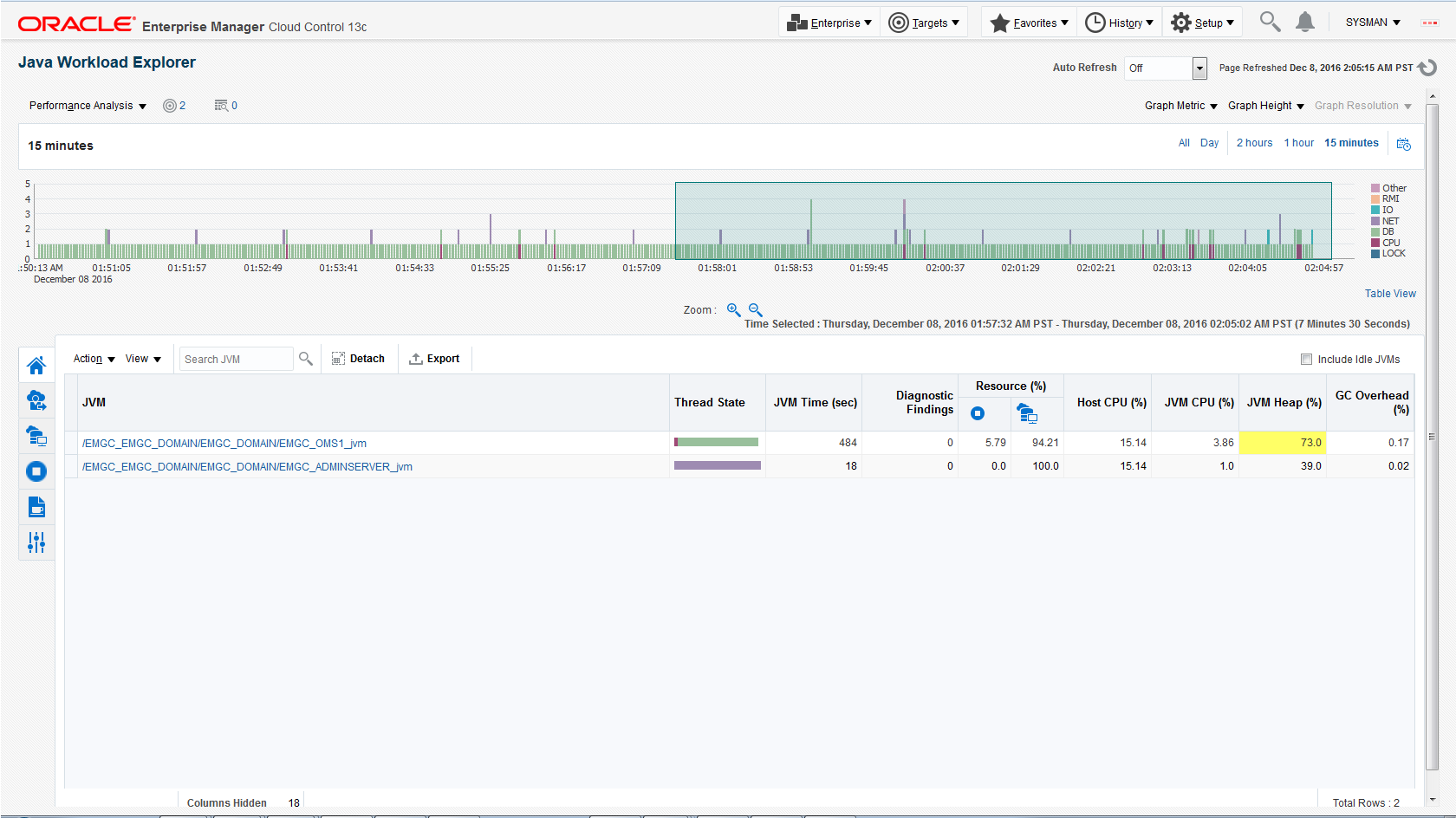

Viewing the JVM Live Thread Analysis Page
This page shows the real-time data for a selected JVM. This data is useful in analyzing the various active and idle threads on the JVM. During analysis you can drill down from the thread level to methods used in the thread, to local variables that are part of the method. To view this page:
- From the Targets menu, select Middleware, then click on a Java Virtual Machine target.
 - Click the Live Thread Analysis link at the top of the page or select the Live Thread Analysis option from the Java Virtual Machine menu.
JVMs: This table shows the list of JVMs and the current status of each JVM. The current activity of the JVM including CPU usage, memory, number of threads waiting for a database response, number of threads waiting for synchronization lock, and other details are displayed. JVM Process statistics include: CPU (%), Memory (%), Context Switch (per sec), and Open File Descriptors (%). Threads statistics include: CPU, DB Wait, Lock, Network Wait, IO Wait, RMI Wait, and Idle Threads.
JVM Threads: This table shows a list of all the threads running in the JVM. Click on a thread to view the thread details. To view all the available columns, from the View menu, select Columns, then select Show All.
If a thread is in the DB Wait State, the Waiting On column displays the name of the database the thread is waiting on, and the time the thread has to wait is displayed in the Wait Time column. You can click on the link in the DB Wait column to view the database diagnostics details. This is helpful in tracking database issues and determining the application request responsible for the database activity.
You can view the database diagnostics details if:

If a database is not registered with JVMD, the Database JDBC details, SQL statement, SQL ID, and schema name will be collected by the JVMD agent for threads in DB Wait state.
In the case where the database is not an Enterprise Manager target, you can still register the database with JVMD as a “Custom database" which will track the database activity to this database by its name. The SQL statement and SQL ID would be fetched real-time from the database but you cannot drill-down from JVM Diagnostics pages to Database Diagnostic pages.
To register the database:
From the Setup menu, select Middleware Management, then select Setup. Select the JVM Diagnostics Engine row in the JVMD Engines table and click Configure.
Click the Register Databases tab. The list of registered databases is displayed. The database name, host, Oracle SID for the monitored database, and listener port number is displayed. You will also see a column indicating “JVMD Supported DB". If this column has a value of Yes, you can proceed with the cross tier analysis. If the column has a value of Unavailable, you cannot perform cross tier analysis because the JDBC connection to the database cannot be established.
If cross tier correlation is not established even after registering the database with JVMD, select a database and click Manage DB URL. In the Associate / Disassociate a Registered Database field, select a Database URL and click Add and specify the URL of the database to be associated. After the URL has been associated with the registered database, the JVM Diagnostics Engine will start monitoring the cross-tier calls between JVM targets and the underlying database.

Establishing Cross-Tier Correlation in Oracle RAC Databases
Oracle Real Application Cluster (Oracle RAC) databases have a complex configuration of database instances and listeners. User applications use Oracle RAC services to connect to the database instead of SIDs that are used for single instance databases. User applications can connect to Oracle RAC listeners that are listening on different machines than the actual database instances. For cross tier correlation to be established, all the listener and database instances must be discovered targets in Enterprise Manager. Cross tier correlation can be established by using either of the following options:

Create: Click Create to create diagnostic snapshots for one or more JVMs. The Create Diagnostic Snapshot page is displayed.

Analyze: Select a file and click Analyze. The Analyze Diagnostic Snapshot page is displayed.

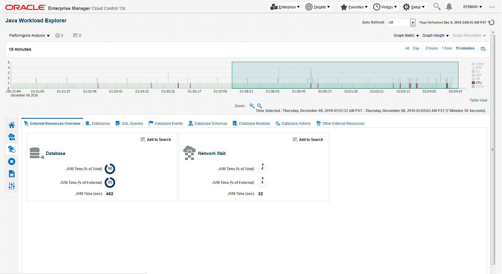

Using Java Workload Explorer
Java Workload Explorer provides a detailed view of all performance statistics associated with the JVM and JVM Pool targets.
Accessing Java Workload Explorer
To use Java Workload Explorer:
From the Targets menu, select Middleware, then select either a Java Virtual Machine target or a Java Virtual Machine Pool target.
You can also access this page by selecting Middleware from the Targets menu and then selecting the Middleware Features menu. Select Java Workload Explorer.
On the resulting page, click the Java Workload Explorer link at the top of the page.

Java Workload Report
Provides insight into the performance of the JVM in a selected time window. The report is available for a maximum of 10 targets with a duration of no more than one hour duration. Creating the report enables you to analyze the data with data reported at different points in time.
The following tables are displayed in the Java Workload Report:
Summary tables for each target include:
JVM Summary
Diagnostic Findings
Threshold Violations
JVM Statistics
OS Statistics
GC Statistics
Multiple tables aggregated by all targets in the context and sorted by important metrics include:
Requests Statistics
Request Instances Statistics
Session Statistics
User Statistics
Application Statistics
Thread Statistics
Method Statistics
Class Statistics
Packages Statistics
Databases Statistics
SQLs Statistics
Database Events Statistics
Database Schema Statistics
Database Modules Statistics
Database Actions Statistics
Other External Resources Statistics
Locks Statistics
Files Statistics
Supplemental Information
Contains JVM startup parameters, full SQLs, and Stacks
Search Criteria
The Search Criteria provided throughout the page enables you to fine tune your search and minimize the reported data.
Figure 10-5 Search Criteria
By default, the following keywords are used: ECID Duration (ms), SQL Duration (ms), and State. Using State enables you to select the Thread State in which you have interest. During any search, you can elect to ignore the field.
Using the Add Field menu, you can select fields for any of the following: request, user session, database, internal resource, code, and threads.

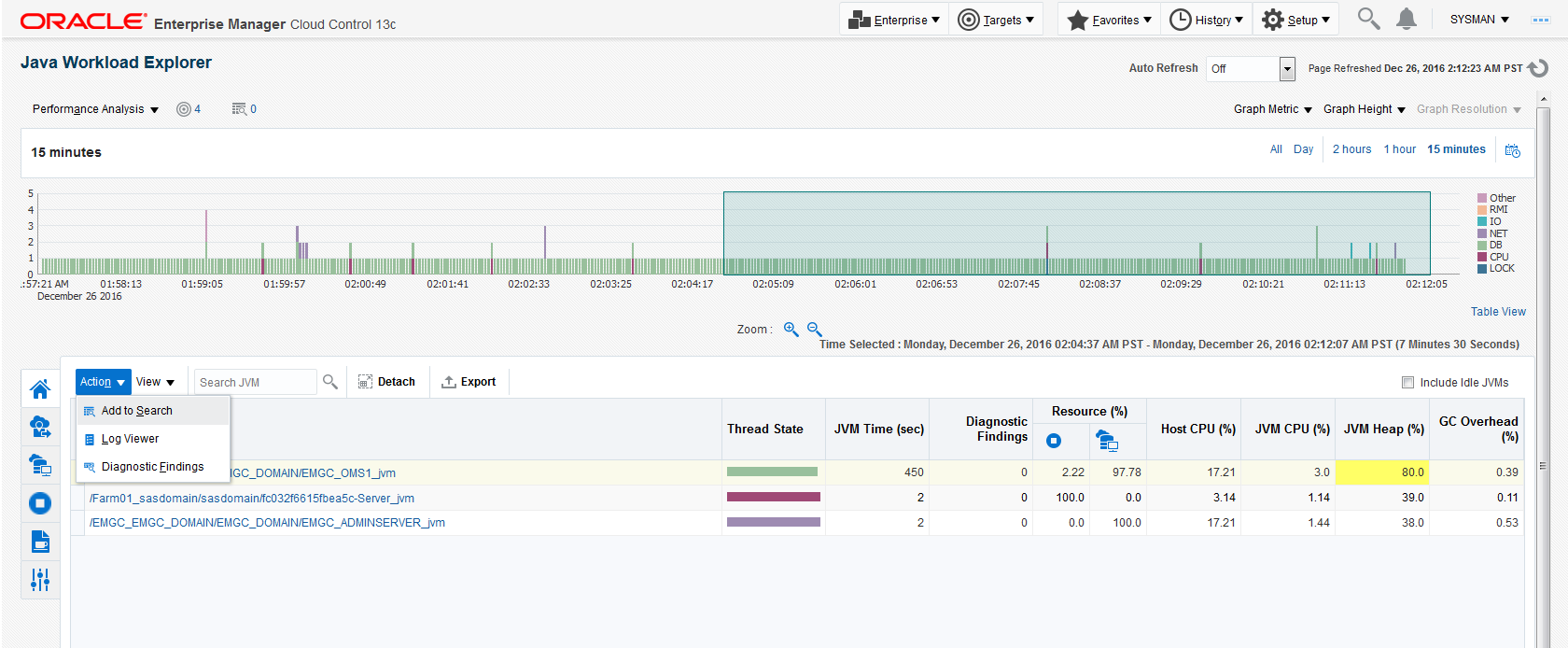

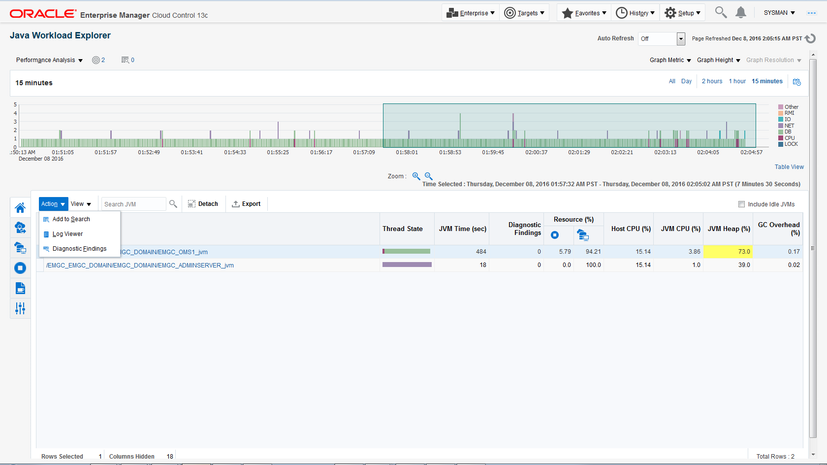

Diagnostics
The statistical data associated with the JVM or JVM Pool is available in the form of tabs. A diagnostic tab corresponds to a user intention based on a region or a set of related regions. A tab can have associated subtabs.

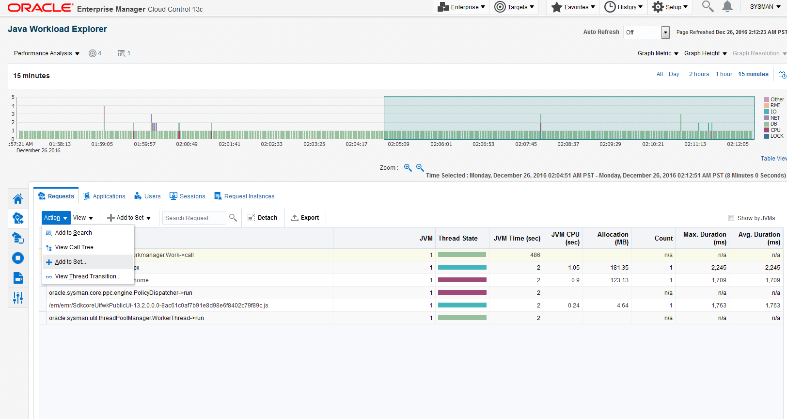

The majority of the tabs have an Action menu and a View menu. The options on the Action menu often replicate the options available on other parts of the screen, most notably Add to Search and Add to Set. Additional menu options are:
Add to Search: It adds the element to the Search Criteria.
Figure 10-6 Add to Search
Add to Set: It adds the element to the Set Criteria.
Figure 10-7 Add to set
Log Viewer (Displays Log Messages).
View Call Tree (Displays the methods and the percentage of time for the call to execute to method).
View Thread Transition (Displays the graphical view of how threads change over time).

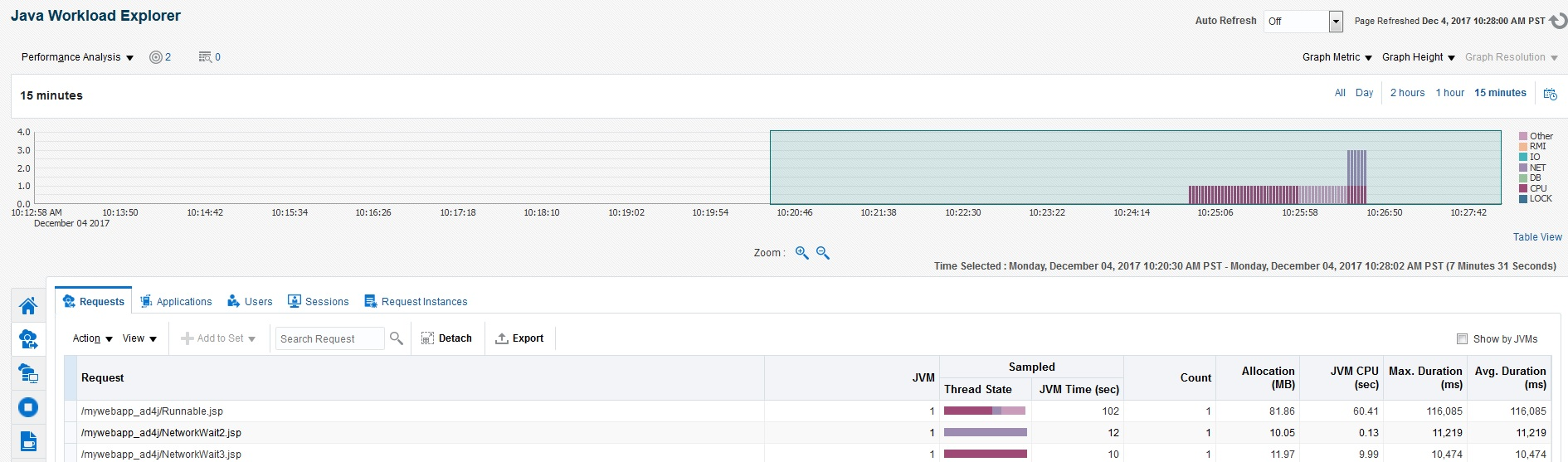

Requests, ECIDs, Sessions, and Users.
Requests
Figure 10-9 Request Tab
Statistics include: Duration (ms), Max. Duration (ms), JVM CPU (sec), Allocation (MB), Count, JVM Time (sec), and Thread State.
Sample Request metrics (e.g. count, Allocation, Duration) are calculated based on data collected from specific instances that are caught while taking a sample of the stuck. The non-sample metrics are calculated based on all the instances that were executed since the previous sampling.
For example:
A Request average execution time varies from 50 to 1500ms, while the average execution time is 100ms. The request is executed 1000 times per second.
Sampling catches mainly the slow executions. The sampled count will be much smaller than 1000/s and the average execution time and other metrics will reflect the behavior of the caught slow executions. With the new feature introduced in 13.3, all the Request executions are counted and measured. In the example above, the count will show 100/s and the average will be 100ms.
The Thread state and JVM Time metrics are available only as sampled data.
- Request that are not sampled at all (not even one instance is seen the thread stuck when it is sampled by JVMD) will not show at all for that 2 second time period.
Actions available are: Add to Search, View Call Tree, Add to Set, and View Thread Transition.

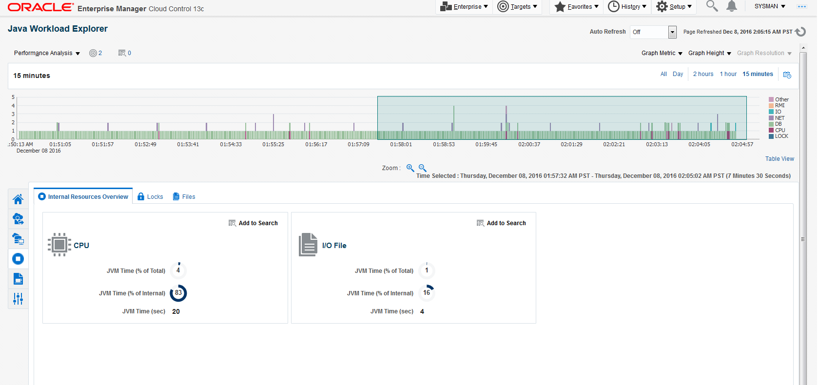

Internal Resources
Figure 10-11 Internal Resources Tab
Internal Resources Overview
CPU - JVM Time (% of Total), JVM Time (% of Internal), and JVM Time (sec)
Lock - JVM Time (% of Total, JVM Time (% of Internal), JVM Time (sec)
I/O File - JVM Time (% of Total), JVM Time (% of Internal), and JVM Time (sec)
Locks
Statistics include: Held Locks (JVM Time (sec), Avg. Duration (ms), Max Duration (ms) and Waiting Locks (Thread Trend, JVM Time (sec), Avg. Duration (ms), and Max Duration (ms)
Actions available are: Add to Search, View Details, Add to Set
Files
Statistics include: I/O file and JVM Time (sec)
Actions available are: Add to Search, Add to Set

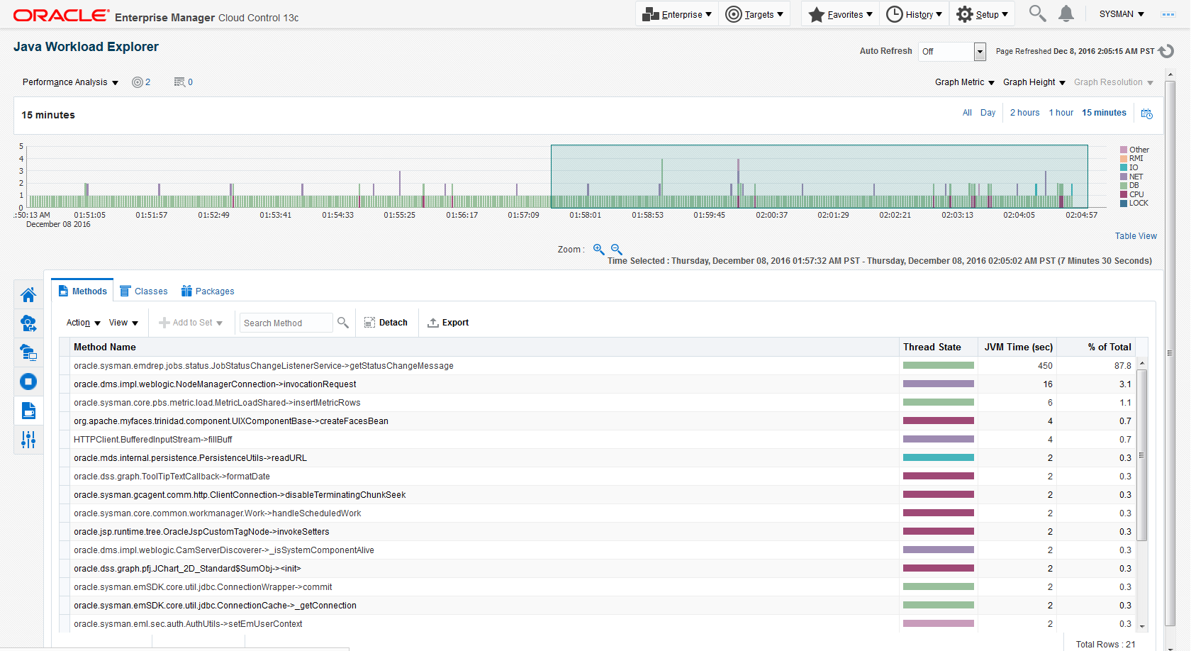

Code
Figure 10-12 Code Tab
Statistics include: % of Total, JVM Time (sec), and Package
Methods
Classes
Packages
Threads
Figure 10-13 Threads Tab
Statistics include: Write Characters, Read Characters, Wait Count, Waited Time (sec), Blocked Count, Blocked Time (ms), Hogger (%), Stuck (%), Allocation (MB per sec), JVM CPU (per minute)
Actions available are: Add to Search, View Call Tree, Add to Set, Log Viewer, View Thread Transition, Sample Analysis
