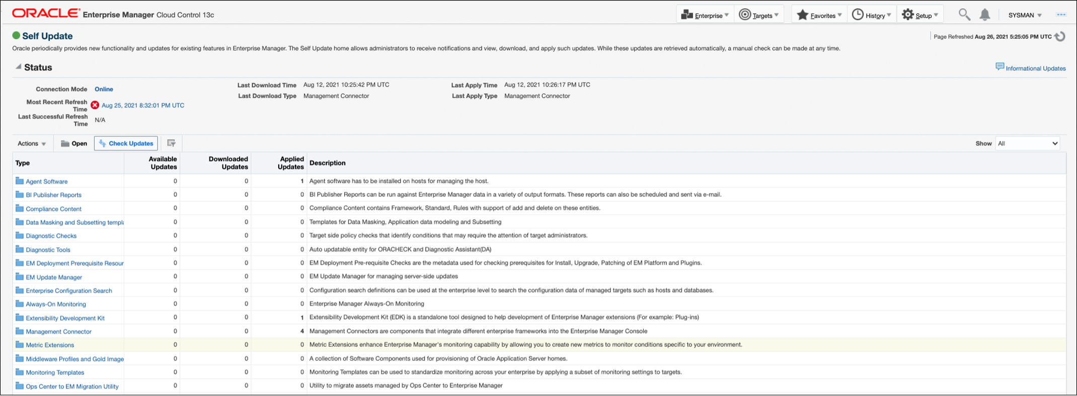

 - From the Enterprise Manager console Setup menu, select Extensibility, then Self Update.
 - From the Self Update page, look for the IBM Tivoli Netcool/OMNIbus REST Event Connector in the table list. If it does not appear, go to the next step.
 - Click Check Updates to schedule a job to collect the metadata for the connector, as shown in following figure.

From the Enterprise Manager console Setup menu, select Setup, then select Extensibility, then select Self Update.
Click on the Management Connector link in the Type column. The IBM Tivoli Netcool/OMNIbus REST Event Connector appears in the list with a status of Available.
Click on the appropriate IBM Tivoli Netcool/OMNIbus REST Event Connector to select it, and then click Download.
The Schedule Download window appears, where you can determine when the download should be performed.
Click Select to download immediately.
If you want to schedule the download for a later time, specify the date and time when the download should occur, and click Select. You will need to return and finish the remainder of this procedure after the scheduled download date and time.
If necessary, refresh the screen until the status of the connector changes to Downloaded.
Click on the IBM Tivoli Netcool/OMNIbus REST Event Connector to select it, then click Apply.
After you respond to the prompt to confirm the operation, a page appears that indicates the request has been submitted.
Refresh the screen until the status of the connector changes from Apply Scheduled to Applied.

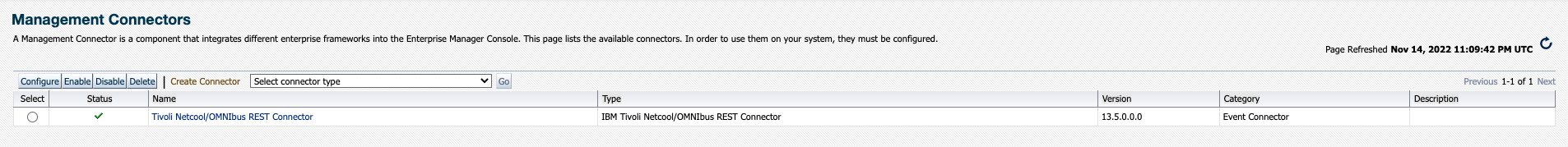

 - Click the Configure button for the IBM Tivoli Netcool/OMNIbus REST Event Connector. The General tab of the Configure Management Connector page appears.
 - Provide the required settings. See "Providing General Settings" for details.
 - Click OK.
The Management Connectors page reappears. The row for the IBM Tivoli Netcool/OMNIbus REST Event Connector should have a check mark in the Status column, as shown in the following figure.

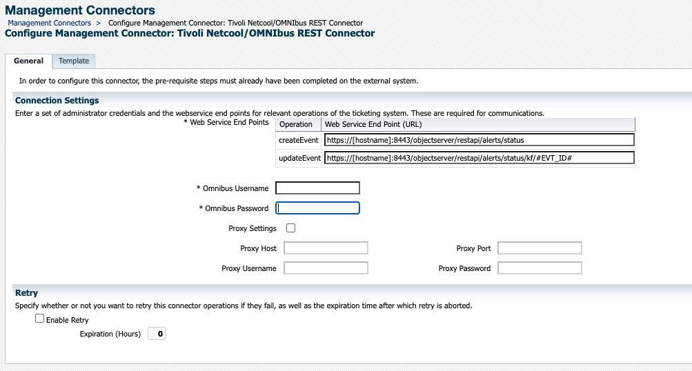

The following sections explain how to provide various configuration details for the General tab of the Configure Management Connector page as shown in the following figure.
The IBM Tivoli Netcool/OMNIbus REST Event Connector communicates with Netcool/OMNIbus through IBM Tivoli Netcool/OMNIbus’ REST API. All of the following fields are mandatory:
Web Service End Points: URL to use when creating and updating alerts in IBM Tivoli Netcool/OMNIbus.
Modify the URL for both operations based on whether the web service for IBM Tivoli Netcool/OMNIbus was set up using HTTP or HTTPS.
For HTTP:
- Change the protocol from
httpstohttp. - Replace
[Hostname]in the URL with the host name or IP address of the IBM Tivoli Netcool/OMNIbus system. - Change the port number from
8443to8080.
- Replace
[Hostname]in the URL with the hostname or IP address of the system where the web service for IBM Tivoli Netcool/OMNIbus was installed.
For HTTPS:
- Replace
It is possible that the port being used is not the default. On your ObjectServer verify your port number as defined in Prerequisites.Example:
If IBM Tivoli Netcool/OMNIbus was installed on a system with a host name of
omnibus, the following URLs would be configured for the different protocols:For HTTP:
For HTTPS:http://omnibus:8080/objectserver/restapi/alerts/statushttps://omnibus:8443/objectserver/restapi/alerts/status/kf/#EVT_ID# - Change the protocol from
Omnibus Username: Username of the user that will access IBM Tivoli Netcool/OMNIbus.
Omnibus Password: Password of the user that will access IBM Tivoli Netcool/OMNIbus.

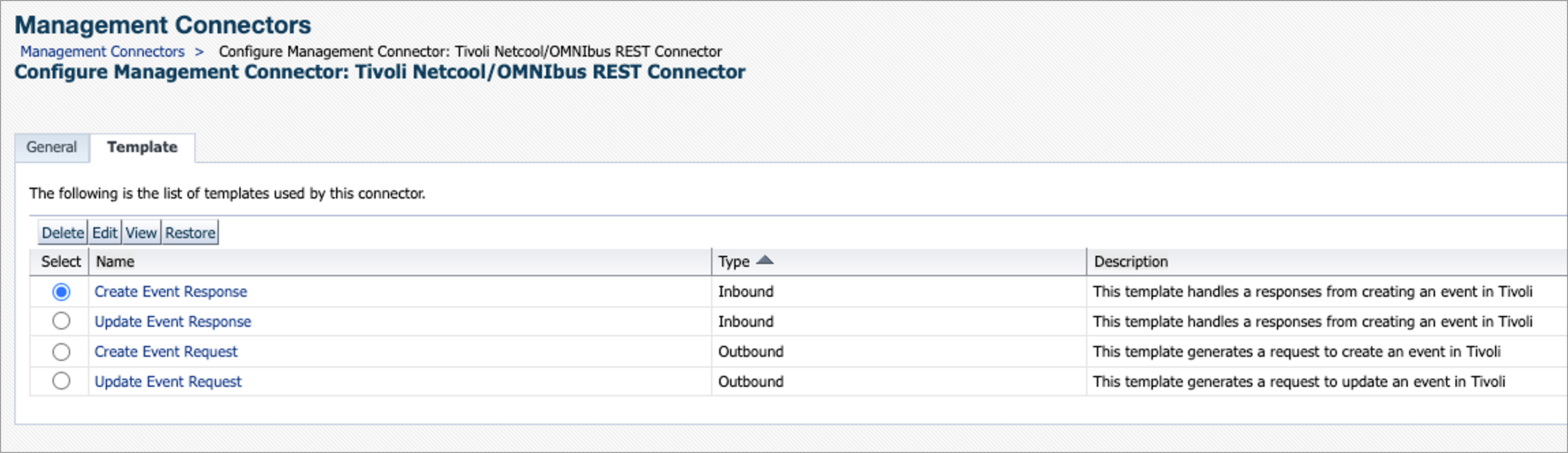

To view template code, do the following:
- Select the connector instance and go to the Configure Management Connector page.
 - Select the Template tab, as shown in the figure below.
 - Click a template name or click View to view the XSLT code for the template.
The event templates are in XSLT format. A basic knowledge of XSLT is required to understand the code.
