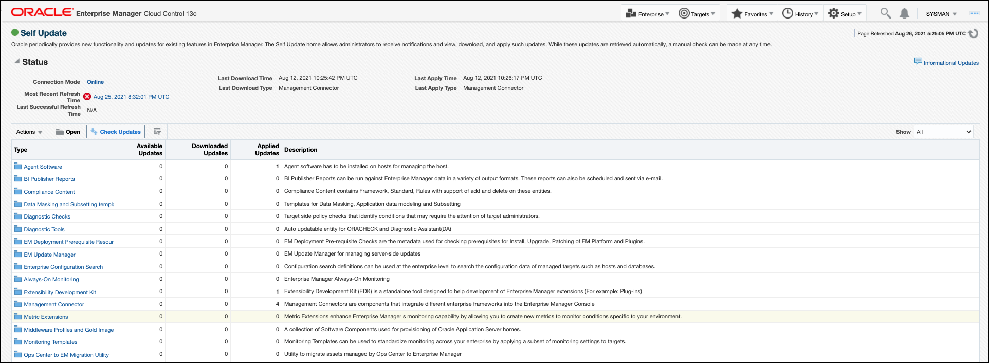

- From the Enterprise Manager console Setup menu, select Extensibility, then Self Update.
- From the Self Update page, look for the PagerDuty REST Ticketing Connector in the table list. If it does not appear, go to the next step.
- Click Check Updates to schedule a job to collect the metadata for the connector, as shown in following figure.

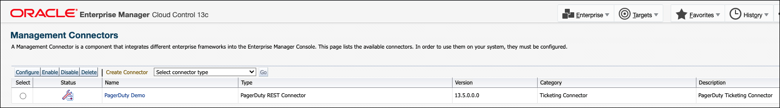

The connector instance appears as unconfigured on the Management Connectors page, shown in the following image. .

The Management Connectors page appears that lists all created connector instances.

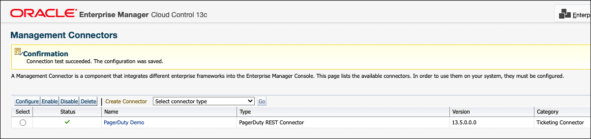

The status column with a green tick mark indicates that the connector is already configured.
Click the Configure button for the PagerDuty Connector. The General tab of the Configure Management Connector page appears.
Provide the required settings. See "Providing General Settings" for details.
Click OK.
The Management Connectors page reappears. The row for the PagerDuty Connector should have a check mark in the Status column, as shown in the following figure.

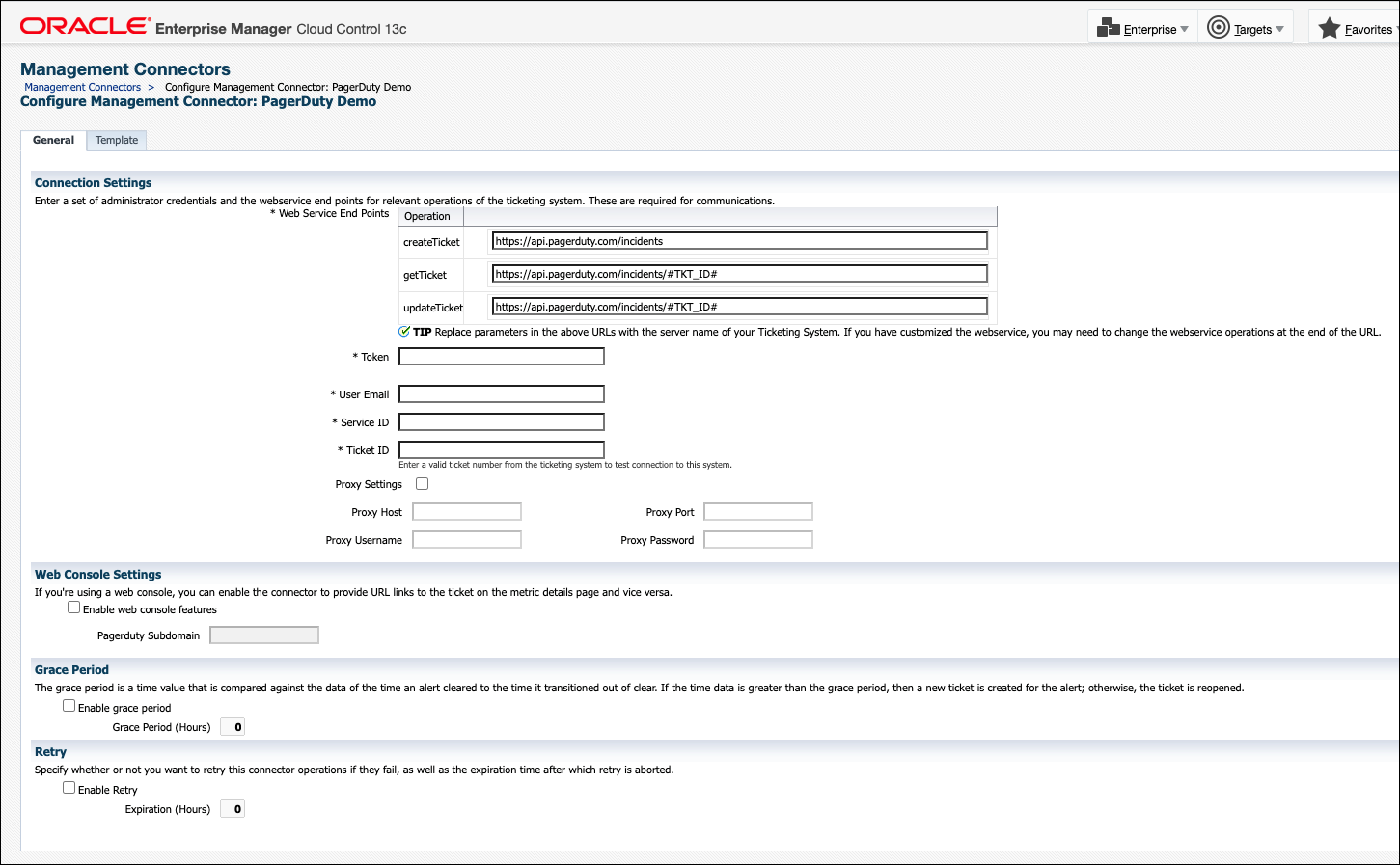

The following sections explain how to provide various configuration details for the General tab of the Configure Management Connector page as shown in the following figure.
Connection Settings
The PagerDuty Connector communicates with the Service Desk through their Web services.
- WebService End Points —End points to createTicket,updateTicket,and
getTicketwebservices exposed by PagerDuty. These should not need to be edited.

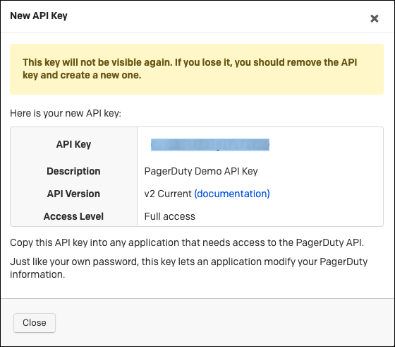

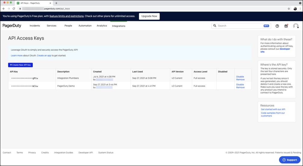

- Token ID—API Token with permissions to retrieve, create, and update tickets from PagerDuty.
- Log in to PagerDuty.
- Hover over the Integrations tab.

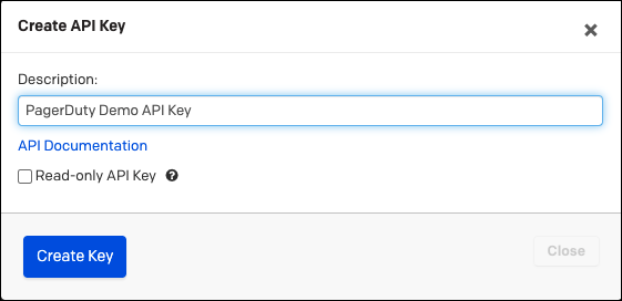

- Under the Develop Tools section, select API Access Keys.
- On the landing page, click Create new API Key and follow the instructions.
Leave the Read-only API Key option unchecked. You will be using the Create API to create tickets in PagerDuty.
- User Email—Email of the PagerDuty user attached to the API Key.

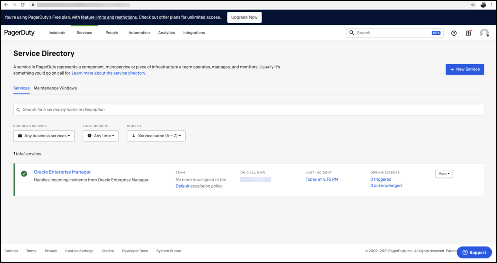

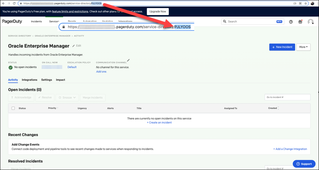

- Service ID—The ID of the PagerDuty Service the incidents with be created in.
- Hover over the Services tab.
- Select Service Directory.
- If you have not already done so, create a service for Oracle Enterprise Manager.
- Once your service is created, click on the service name.
- To get the Service ID, navigate to the landing page and copy the seven letter string at the end of the URL.

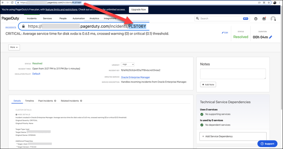

- Ticket ID—An existing Ticket ID to test the connection to the PagerDuty system. The ticket does not need to be open.

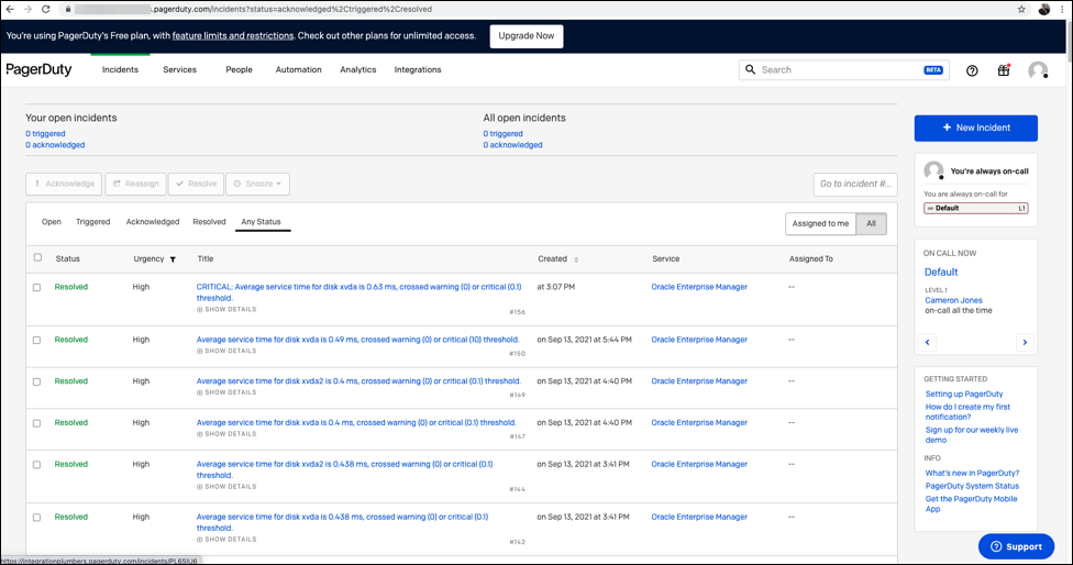

- Click on the Incidents tab.
On the landing page, you'll see a list of your incidents.

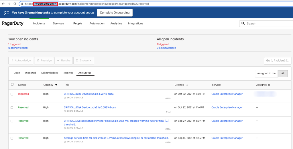

- From the list of incidents, click on the incident for which you want the Ticket ID. The individual ticket information displays.
- To determine the Ticket ID of the selected incident, navigate to the URL and copy the seven letter string at the end of the URL.

Web Console settings are required if you want the connector to provide links toPagerDuty tickets created by Enterprise Manager in the context of an incident.
To enable this functionality, provide the following Web console settings.
- EnableWeb Console —Check this box to enable launching of the PagerDuty incident page within context from Enterprise Manager.
- PagerDuty Subdomain — The subdomain of your PagerDuty account.
- Go to any URL to obtain the subdomain (the text between https:// and .pagerduty.com).
Example:
https://yourcompany.pagerduty.comwhereyourcompanyis the subdomain.

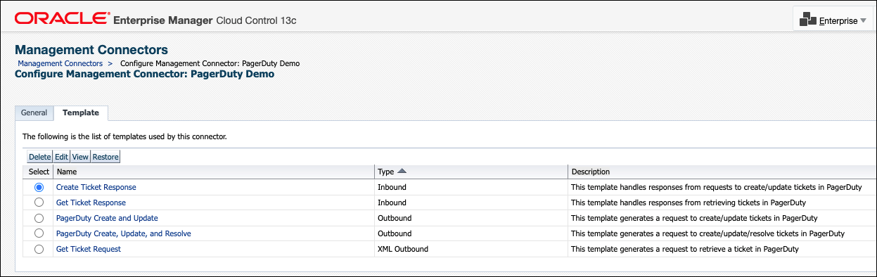

Viewing Template Code
To view template code, do the following:
Select the connector instance and go to the Configure Management Connector page.
Select the Template tab, as shown in the figure below.
Click a template name or click View to view the XSLT code for the template.
The ticket templates are in XSLT format. A basic knowledge of XSLT is required to understand the code.
