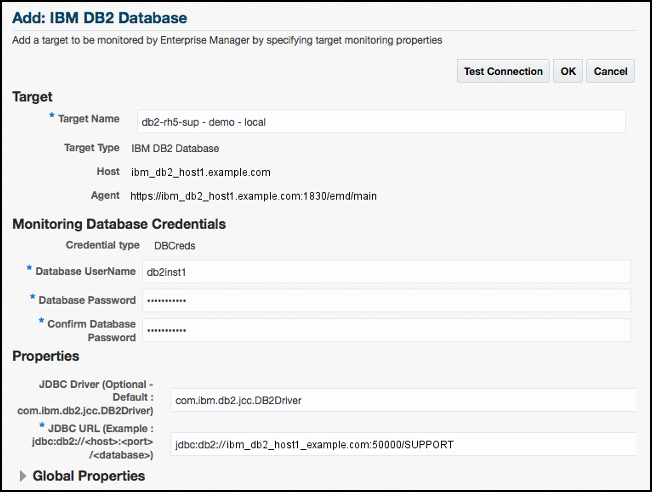

  2. In the Add Targets Manually page, select Add Targets Declaratively by Specifying Target Monitoring Properties, select Target Type as IBM DB2 Database, select a Monitoring Agent and click Add Manually.
  3. In the Add IBM DB2 Database page (Figure 3-1), provide the following information for the properties:
    • Target Name: Unique target name across all the Enterprise Manager targets, such as DB2_Hostname. This is the display name in Enterprise Manager.
    • Monitoring Database Host Credentials
      • Database Host User Name: Operating System account for the DB2 Database Host.
      • Database Host Password: Corresponding password for the Database Host User Name.
      • Confirm Database Host Password: Confirm the Database Host Password.
    • Monitoring Database Credentials
      • Database User Name: Valid User Name for the Database.
      • Database Password: Password for the Database User Name.
      • Confirm Database Password: Confirm the Database Password.
    • Properties
      • JDBC Driver: (Optional) Name of the DB2 Universal JDBC Driver. For example:
        com.ibm.db2.jcc.DB2Driver
      • JDBC URL: URL name for the IBM DB2 JDBC Driver connectivity. For example:
        jdbc:db2://<server>:<port>/<database>
        The JDBC URL argument represents a data source. Parameter definitions are shown in Table 3-1:
        Table 3-1 JDBC URL Parameter Definitions
        jdbc:db2
        Indicates that the connection is to a DB2 UDB server.
        server
        Fully qualified host name or IP address of the database server.
        port
        TCP/IP server port number assigned to the database server, which is an integer between 0 and 65535. The default port for IBM DB2 Database is 50000.
        database
        Database alias, which refers to the DB2 database catalog entry on the DB2 client.
        The database argument is the database name defined during DB2 UDB (LUW) installation.
    Figure 3-1 Add IBM DB2 Database Page
  4. Click Test Connection to make sure the parameters you entered are correct.

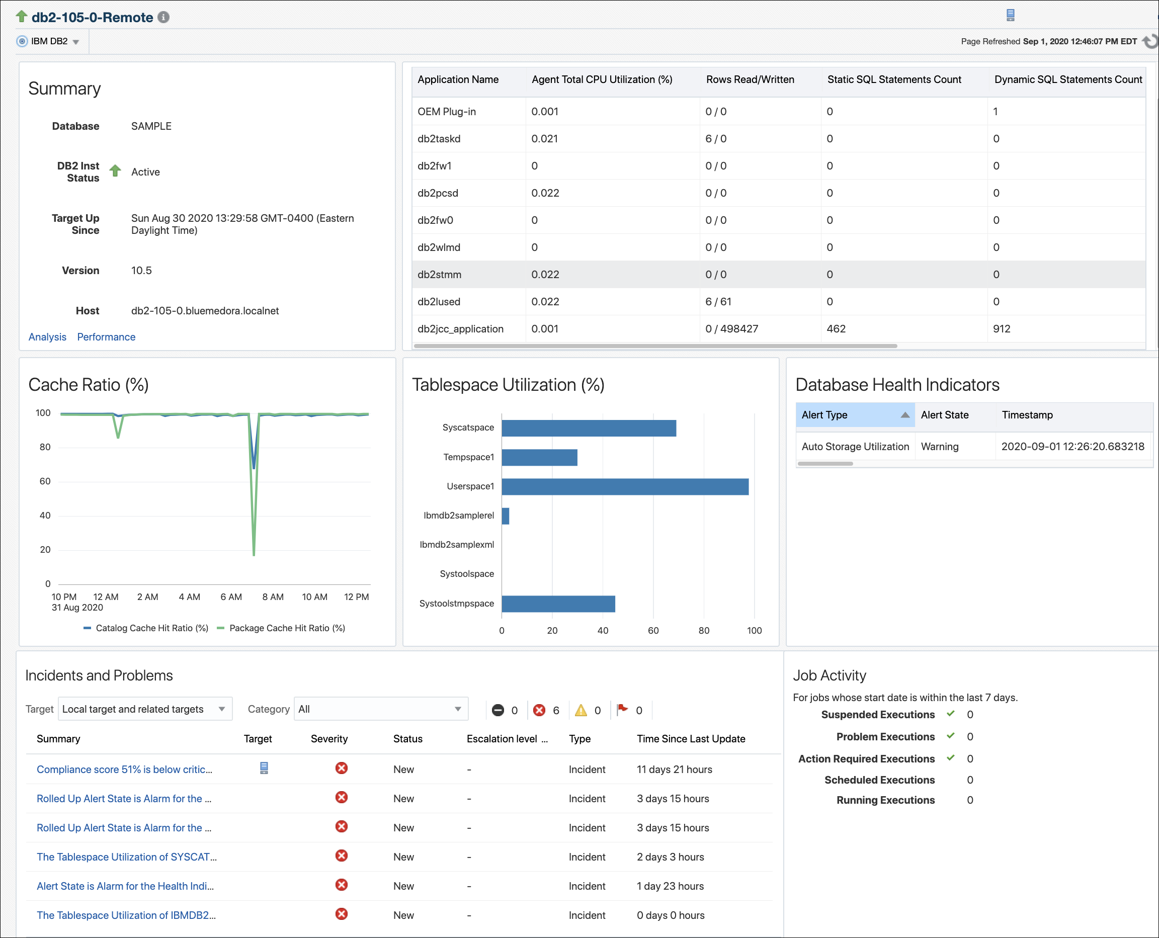

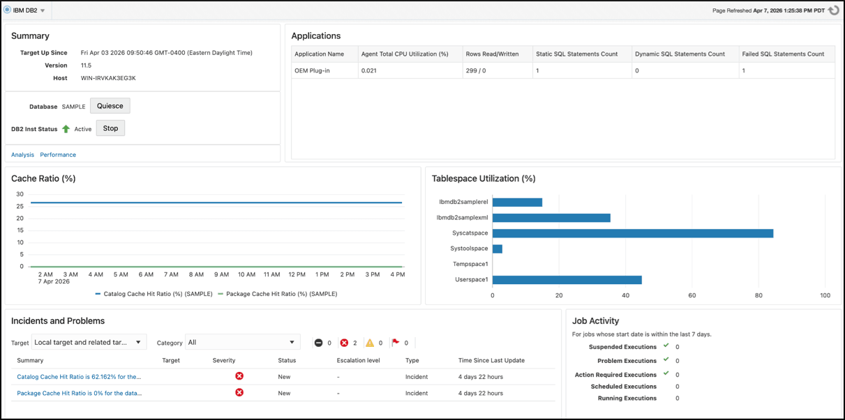

  1. Click the IBM DB2 Database target link from the All Targets page.
    The IBM DB2 Database home page appears as shown in Figure 3-2:
    Figure 3-2 IBM DB2 Database Target Home Page

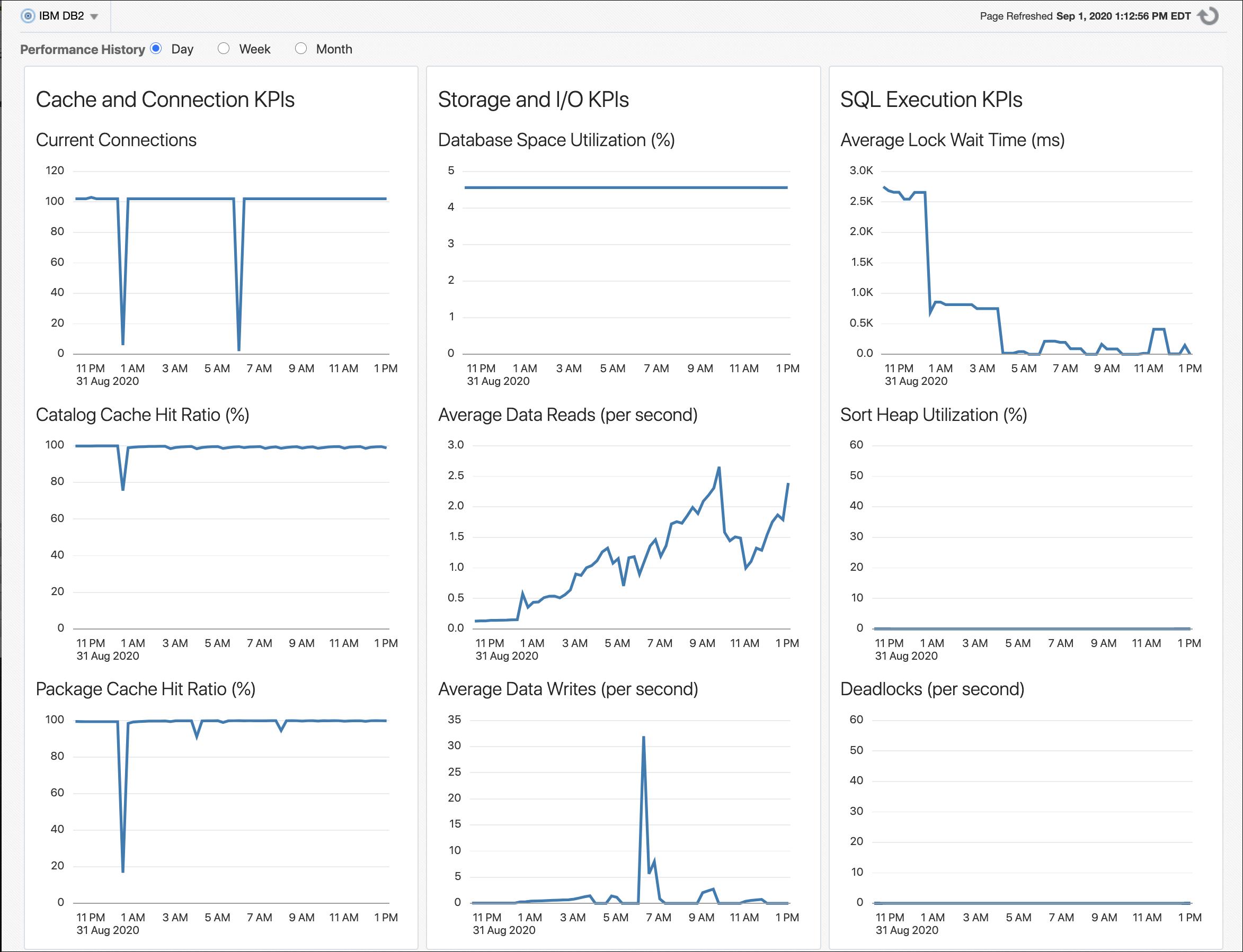

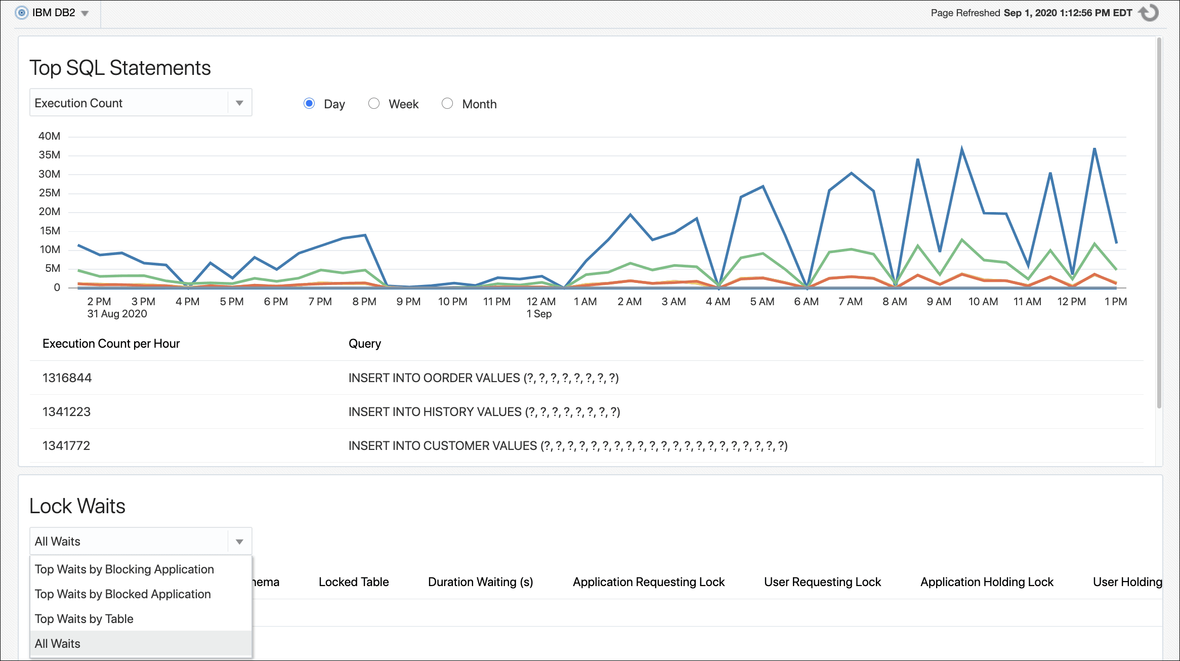

  5. Ensure that the Analysis page can be viewed by clicking Analysis in the Target menu. The IBM DB2 Database Analysis page appears as shown in Figure 3-3:
    Figure 3-3 IBM DB2 Database Plug-in Analysis Page

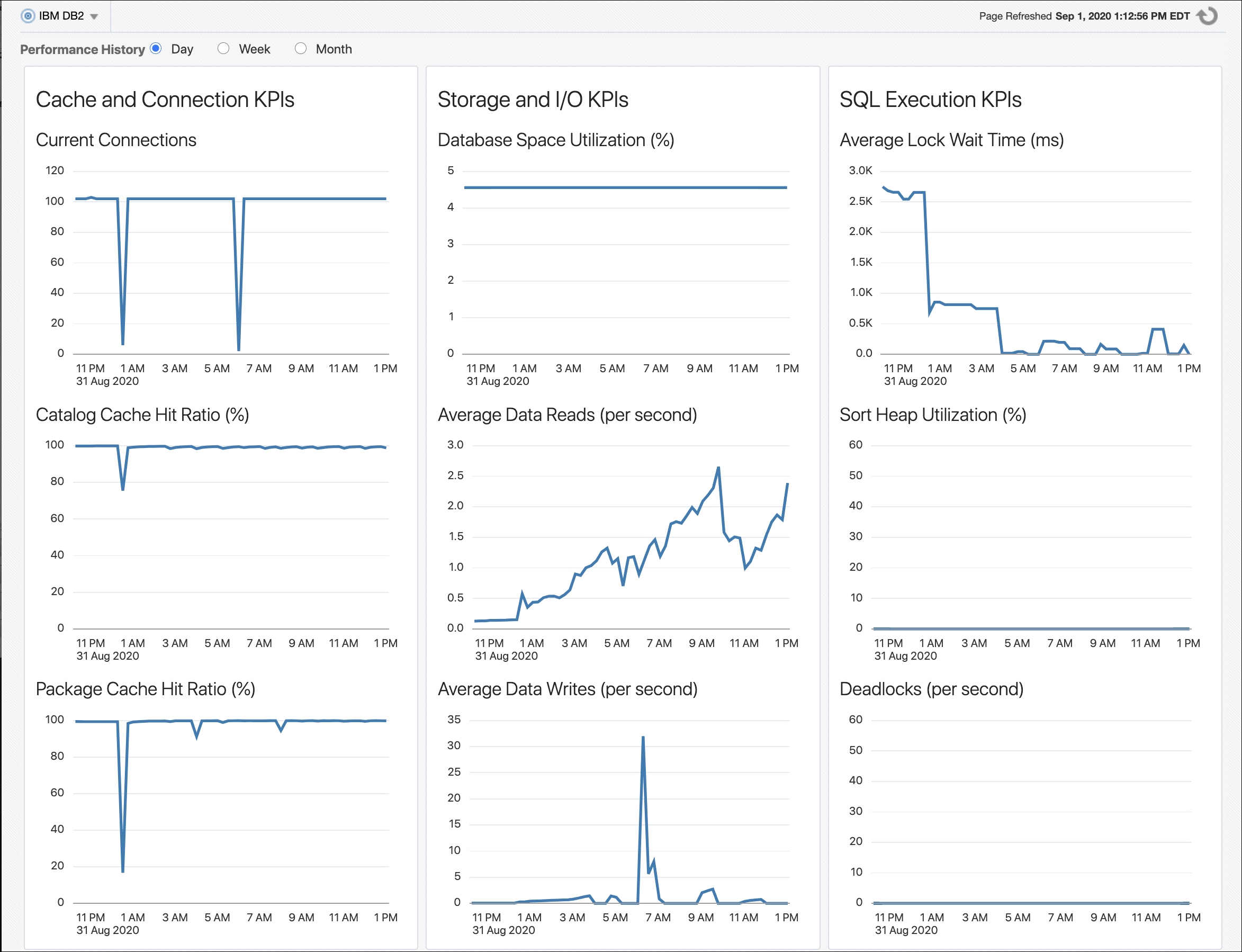

  6. Ensure that the Performance page can be viewed by clicking Performance in the Target menu. The IBM DB2 Database Performance page appears as shown in Figure 3-4:
    Figure 3-4 IBM DB2 Database Plug-in Performance Page
