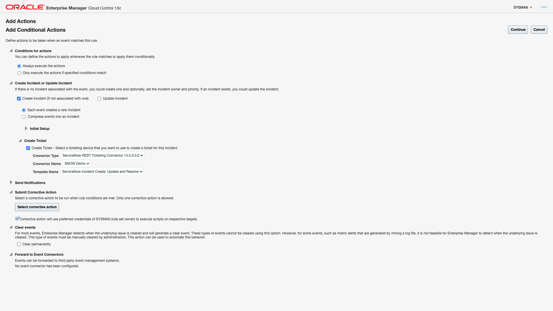

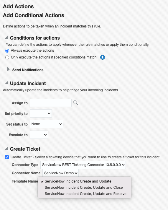

  4. While configuring the above rule under the Add Actions page:
    • For events —
      Select the Create Incident check box. This makes the Create Ticket option visible. Then, select the Create Ticket check box. It will display the combo box to select Connector Type, name, and template.
    • For incidents —
      You can use this option to create tickets based on incident attributes, such as priority 1 incidents or incidents based on fatal or critical severity.
      Select the Create Ticket check box. It will display the combo box to select Connector Type, name, and template.
    Figure 3-1 shows the Add Actions page for events, and Figure 3-2 shows the Add Actions page for incidents.
    Figure 3-1 Add Actions Page for Events
    Shows Remedy Default Category Auto Resolve selected from Template Name list.
    Figure 3-2 Add Actions Page for Incidents
    Shows default settings for page.
  5. After selecting an appropriate connector and template, click Save.

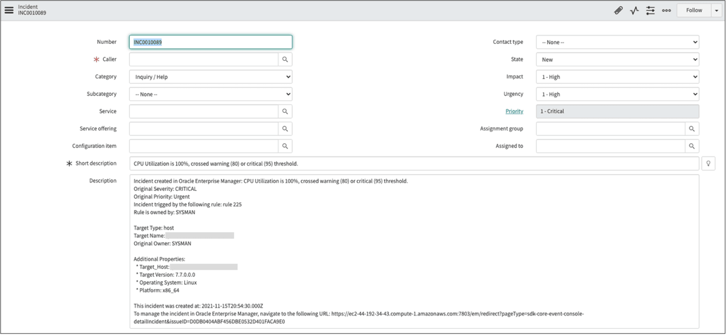

The following process occurs after you create the event or incident rule:
  • A request is sent to the ServiceNow Connector when an incident is created due to an event that matches your rule.
  • The ticket is created or updated on the ServiceNow system.

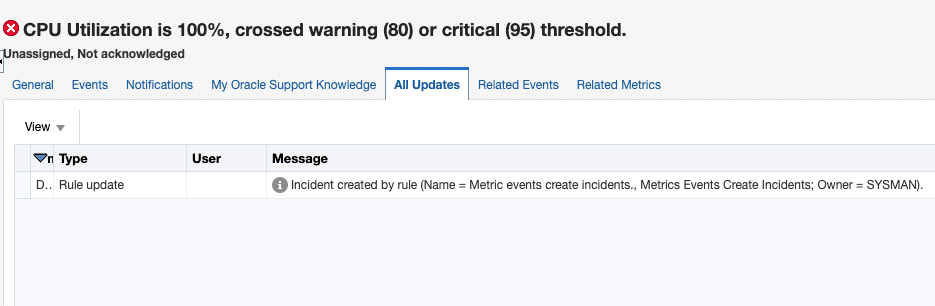

  • In Enterprise Manager, the incident is annotated with a comment on the Updates tab to indicate that a ticket was created or updated, as shown in Figure 3-3. Additionally, the incident is updated with the ticket ID, ticket status, and ticket URL under the Incident Tracking section.
A ticket is updated if there is an existing active ticket for an incident. Figure 3-4 shows the ticket in ServiceNow.
Figure 3-3 Incident Comments
Image shows All Updates tab with incident message.
Figure 3-4 ServiceNow Ticket
Image shows tiket window.

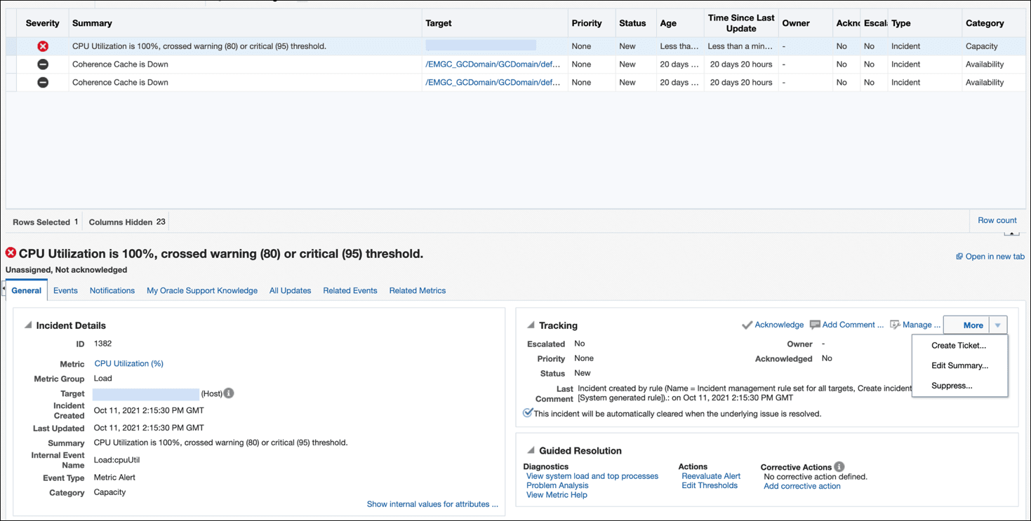

  1. From the Enterprise menu of the Enterprise Manager console, select Monitoring, then Incident Manager.
    The Incident Manager page appears, showing all open incidents.
  2. Select any incident from the list in the table.

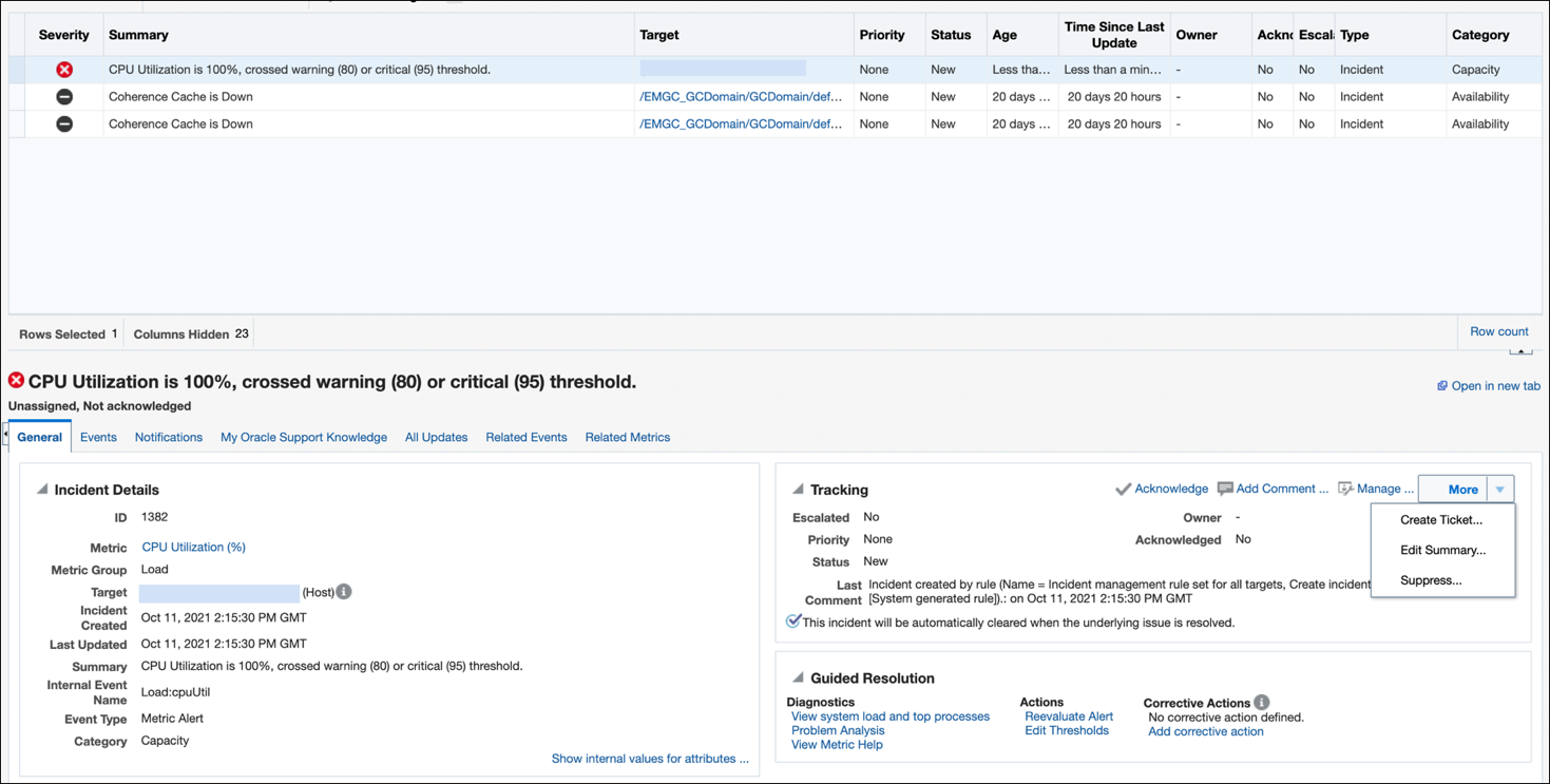

  3. In the Tracking section, click More, then Create Ticket, as shown in Figure 3-5.
    Figure 3-5 Tracking Section of Incident Manager
    Create ticket button in tracking section of incident manager.

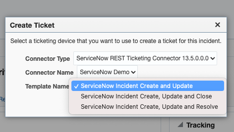

  4. In the Create Ticket pop-up window, select a ticket template from the Template Name drop-down menu as shown in Figure 3-6, then click OK.
    If you do not see the desired template, you can add one using the emctl command. See Adding Ticket Templates.
    Figure 3-6 Create Ticket Pop-up Window
    Drop down menu in create ticket pop-up window.
