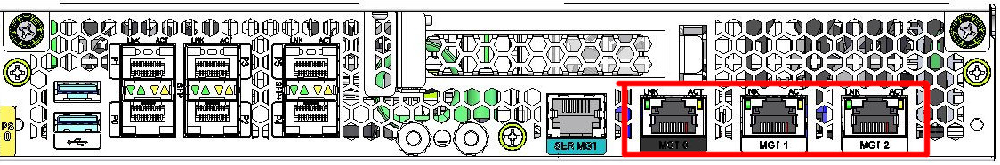

Management Network Ports
Standard shielded CAT5e or CAT6 (or higher) Ethernet cables with RJ45 jacks are used for connecting the Acme Packet 4900 management Ethernet ports to your network. These ports support 10/100/1000 Mbps speeds.
All management ports can be used to connect the Acme Packet to your LAN. If you are going to use High Availability (HA), use ports 1 and 2.
Keep Ethernet cables separated from power cables by at least 60mm where possible and never run them in the same channel of a trunking system without segregation.Note:
As a rule, Mgmt0 should be reserved as the boot/maintenance interface. Mgmt1 and Mgmt2 are available for high availability.To connect Ethernet cables to the rear panel Ethernet ports:
