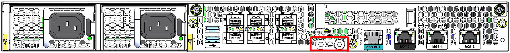

Grounding Cable Installation
The chassis grounding terminals are located on the rear of the Acme Packet 4900 chassis, to the left of the Serial Management port. The Acme Packet 4900 ships with 2 kep nuts screwed onto the ground terminals. Use an 11/32” nut driver to remove and install these kep nuts.
This section shows you how to install the grounding cable on your Acme Packet 4900.
