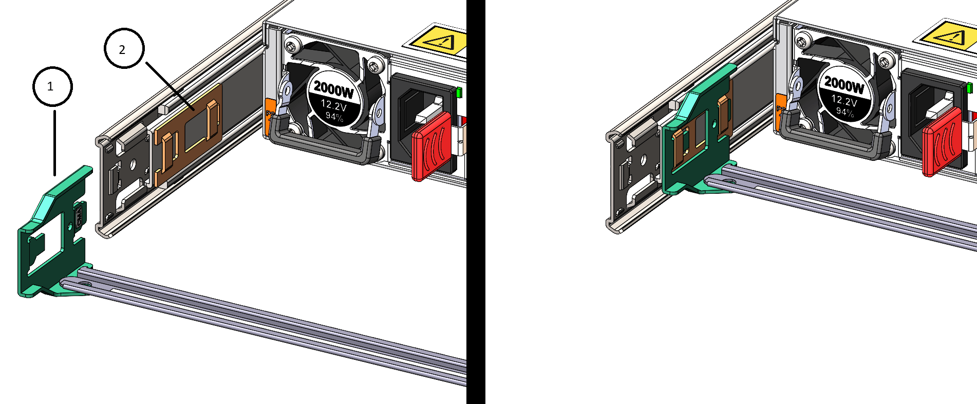

  3. To install CMA connector A into the left slide-rail:
    1. Insert CMA connector A into the front slot on the left slide-rail until it locks into place with an audible click [1 and 2].
      The connector A tab (callout 1) goes into the slide-rail front slot (callout 2).
    2. Gently tug on the left side of the front slide bar to verify that connector A is properly seated.
      Figure showing how to install connector A into the left slide-rail.
      Call Out Description
      1
      Connector A tab
      2
      Left slide-rail front slot

  7. To install CMA connector D into the left slide-rail:
    1. While holding the slide-rail latching bracket in place, insert connector D and its associated slide-rail latching bracket into the left slide-rail until connector D locks into place with an audible click [1 and 2].
      When inserting connector D into the slide-rail, the preferred and easier method is to install connector D and the latching bracket as one assembly into the slide-rail.
    2. Gently tug on the left side of the CMA back slide bar to verify that connector D is properly seated.
      The slide-rail latching bracket has a green release tab. Use the tab to release and remove the latching bracket so that you can remove connector D.
      Figure showing how to install the CMA's connector D and its associated latching bracket into the left slide-rail.

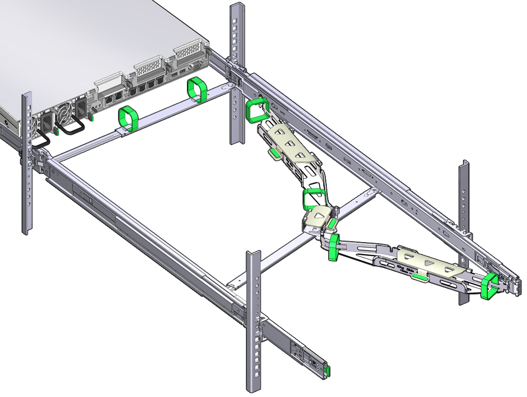

  9. To verify that the slide-rails and the CMA are operating properly before routing cables through the CMA:
    1. Ensure that the rack anti-tilt bar is extended to prevent the rack from tipping forward when the is extended.
      Caution:
      To reduce the risk of personal injury, stabilize the rack cabinet and extend the anti-tilt bar before extending the Acme Packet 6400 from the rack.
      For instructions to stabilize the rack, see Stabilize the Rack.
    2. Slowly pull the Acme Packet 6400 out of the rack until the slide-rails reach their stops.
    3. Inspect the attached cables for any binding or kinks.
    4. Verify that the CMA extends fully with the slide-rails.
      Figure showing the CMA fully extended.

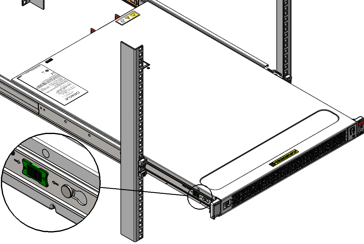

  10. To return the Acme Packet 6400 to the rack:
    1. Simultaneously pull and hold the two green release tabs (one on each side of the Acme Packet 6400) toward the front of the Acme Packet 6400 while you push the Acme Packet 6400 into the rack. As you push the Acme Packet 6400 into the rack, verify that the CMA retracts without binding.
    2. To pull the green release tabs, place your finger in the center of each tab, not on the end, and apply pressure as you pull the tab toward the front of the Acme Packet 6400.
      Figure showing the location of the release tabs on the slide-rails.
    3. Continue pushing the Acme Packet 6400 into the rack until the slide-rail locks (on the front of the Acme Packet 6400) engage the slide-rail assemblies.
      You hear a click when the Acme Packet 6400 is in the normal rack position.

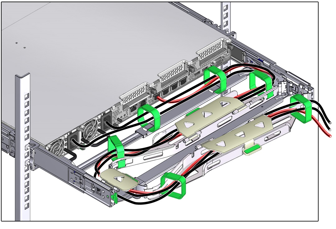

  12. Open the CMA cable covers, route the Acme Packet 6400 cables through the CMA cable troughs (in the order specified in the following steps), close the cable covers, and secure the cables with the six Velcro straps.
    1. First through the front-most cable trough.
    2. Then through the small cable trough.
    3. Then through the back-most cable trough.
      Caution:
      When securing the cables with the Velcro straps located on the front slide bar, ensure that the Velcro straps do not wrap around the bottom of the slide bar. Otherwise, expansion and contraction of the slide bar might be hindered when the Acme Packet 6400 is extended from the rack and returned to the rack.
      Figure showing CMA with cables installed, cable covers closed, and cables secured with Velcro straps.
  13. Ensure that the secured cables do not extend above the top or below the bottom of the Acme Packet 6400 to which they are attached.
    Otherwise, the cables might snag on other equipment installed in the rack when the Acme Packet 6400 is extended from the rack or returned to the rack.
  14. If necessary, bundle the cables with additional Velcro straps to ensure that they stay clear of other equipment.
    If you need to install additional Velcro straps, wrap the straps around the cables only, not around any of the CMA components. Otherwise, expansion and contraction of the CMA slide bars might be hindered when the Acme Packet 6400 is extended from the rack and returned to the rack.
