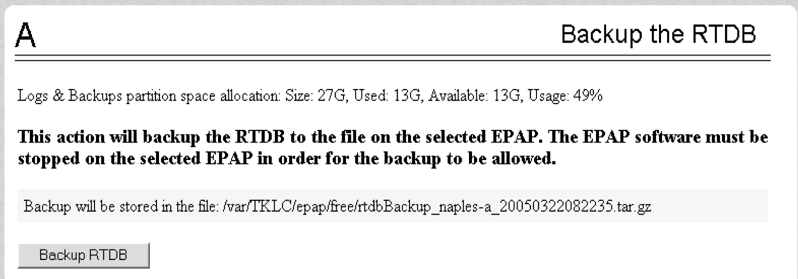

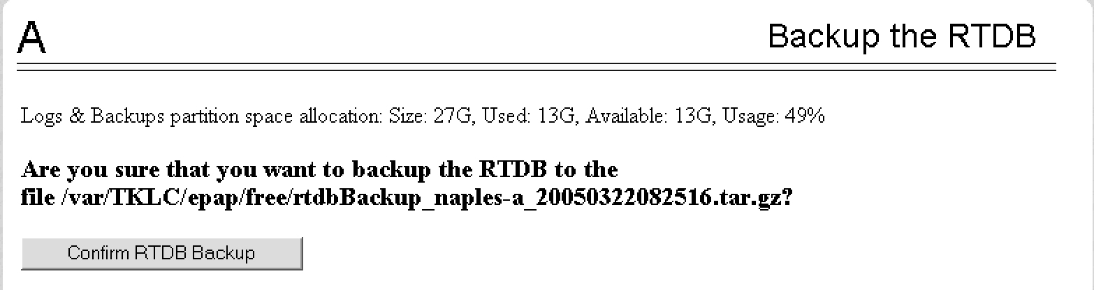

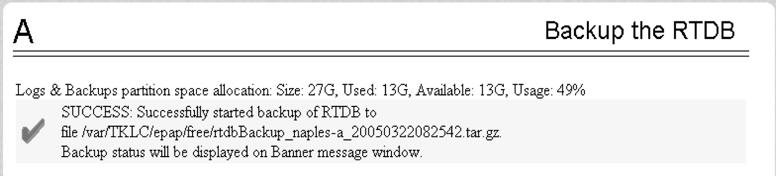

3.1.1 Backing Up the RTDB
Perform this procedure once each day. The estimated time required to complete this procedure is one hour.

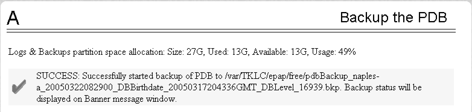

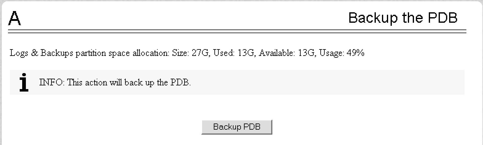

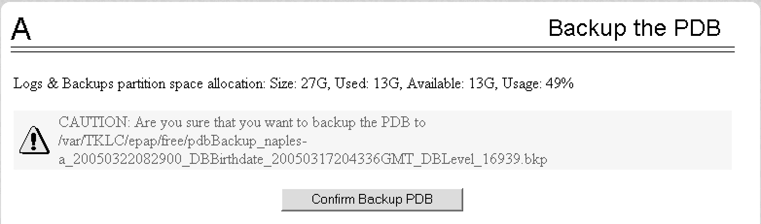

3.1.2 Backing Up the PDB
Perform this procedure once each day. The estimated time required to complete this procedure is two hours. PDB provisioning can take place while this procedure is being performed, but will extend the time required.
Make sure that you perform this procedure on the same server on which you performed Backing Up the RTDB. Make sure that you performed Backing Up the RTDB first so that the RTDB backup level will be lower than the associated PDB backup level.3.1.3 Transferring RTDB and PDB Backup Files

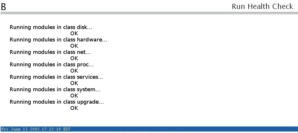

3.2.1 Health Check Outputs
System health check utility syscheck output can be
Normal (brief) or Verbose (detailed), depending on how it is initiated.
Normal Output
The following example is an output in Normal format:
[admusr@EPAP17 ~]$ sudo syscheck
Running modules in class disk...
OK
Running modules in class hardware...
OK
Running modules in class net...
OK
Running modules in class proc...
OK
Running modules in class services...
OK
Running modules in class system...
OK
Running modules in class upgrade...
OK
LOG LOCATION: /var/TKLC/log/syscheck/fail_log

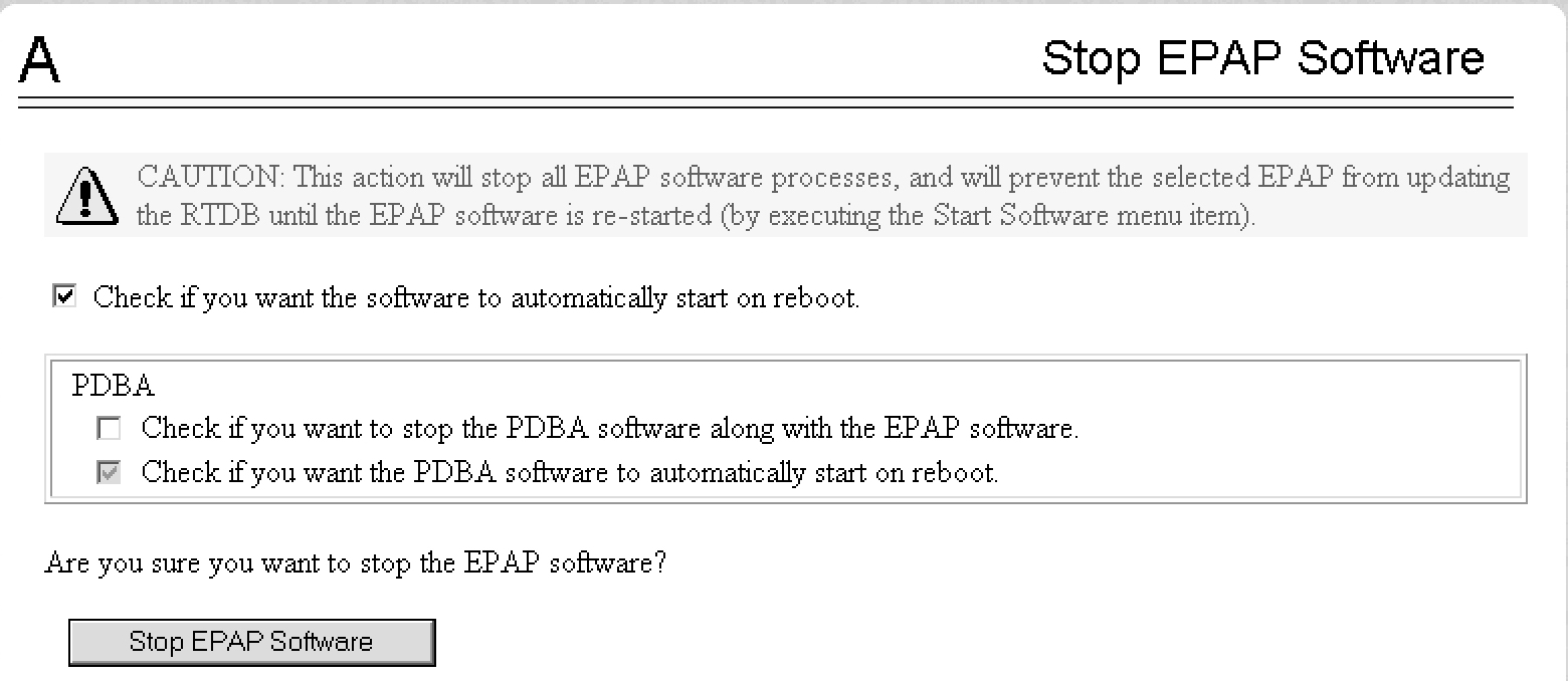

Select Process Control>Stop Software to ensure that no other updates are occurring. The screen in Figure 3-13 displays:
Figure 3-13 Stop EPAP Software

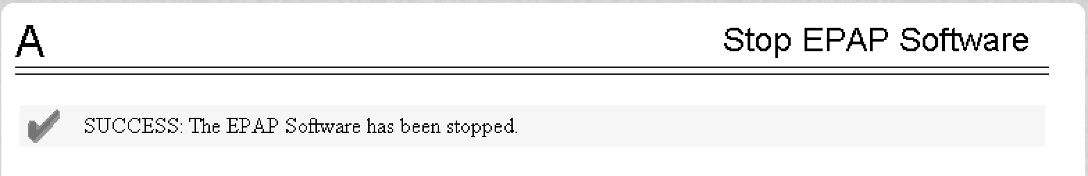

When you stopped the software on the selected EPAP, the screen in Figure 3-14 displays:
Figure 3-14 Stop EPAP Software - Success
Select RTDB>Maintenance>Restore . The screen shown in Figure 3-15 displays:
Figure 3-15 Restoring the RTDB
On the screen shown in Figure 3-15, select the file that was transferred in Figure 3-15. Click Restore the RTDB from the Selected File.
To confirm restoring a file, click Confirm RTDB Restore shown in the screen for RTDB in Figure 3-16:
Figure 3-16 Restore the RTDB Confirm
When restoring the file is successful, the screen shown in Figure 3-17 displays:
Figure 3-17 Restore the RTDB - Success
This procedure is complete.
