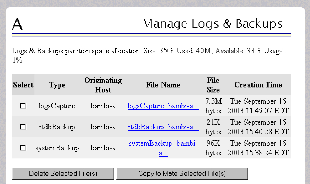

4.6.4 4000000000000008 - File System Full
This alarm indicates that the server file system is full.
Recovery
- Call My Oracle Support for assistance.

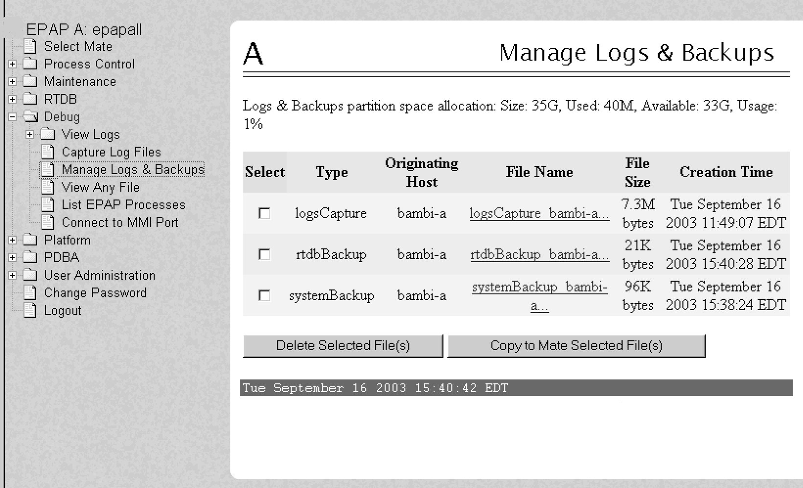

4.6.7 4000000000000040 - Fatal Software Error
A major software component on the EPAP has failed.
Recovery
- Restart EPAP software. See Restarting the EPAP Software
- Capture the log files on both EPAPs (see Saving Logs Using the EPAP GUI) and contact My Oracle Support.

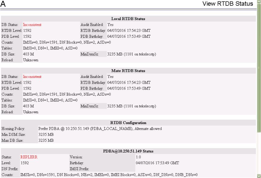

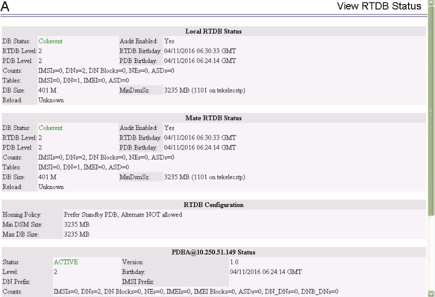

4.6.9 4000000000000100 - RTDB Inconsistent
This message indicates one or more of the following conditions:
The real-time database for one or more Service Module cards is inconsistent with the current real-time database on the Active EPAP fixed disks
RTDBs detect that it is ahead of an ACTIVEPDBA that it just connected to (probably a PDBA switchover has occurred, or a restore from a backup of PDB with a previous db level)
RTDB timestamp of most recent level does not match the PDBAs record of that timestamp.
Recovery

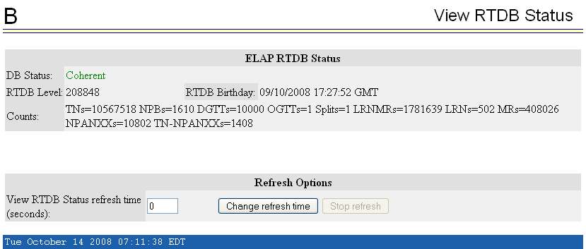

4.6.10 4000000000000200 - RTDB Incoherent
This message usually indicates that the RTDB database download is in progress.
When the download is complete, the following UIM message will appear:
0452 - RTDB reload complete
Recovery
- If this alarm displays while an RTDB download is in progress, no further action is necessary.
- If this alarm displays when an RTDB download is not in progress, capture the log files on both EPAPs (see Saving Logs Using the EPAP GUI) and contact My Oracle Support.

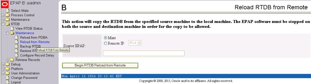

4.6.13 4000000000004000 - RTDB Reload Is Required
This message indicates that the RTDB reload is required for one of the following reasons:
The PDB Birthday on the EPAP reporting the error does not match the mate EPAP’s PDB Birthday.
The transaction logs did not contain enough information to resynchronize the databases (the transaction logs may be too small).
Caution:
If both sides are reporting this error, contact My Oracle Support.
If only one side is reporting this error, use the following procedure.
Recovery

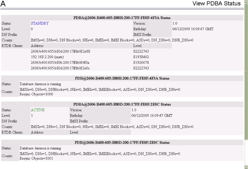

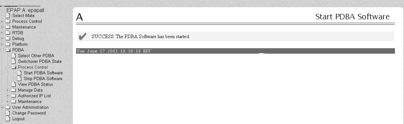

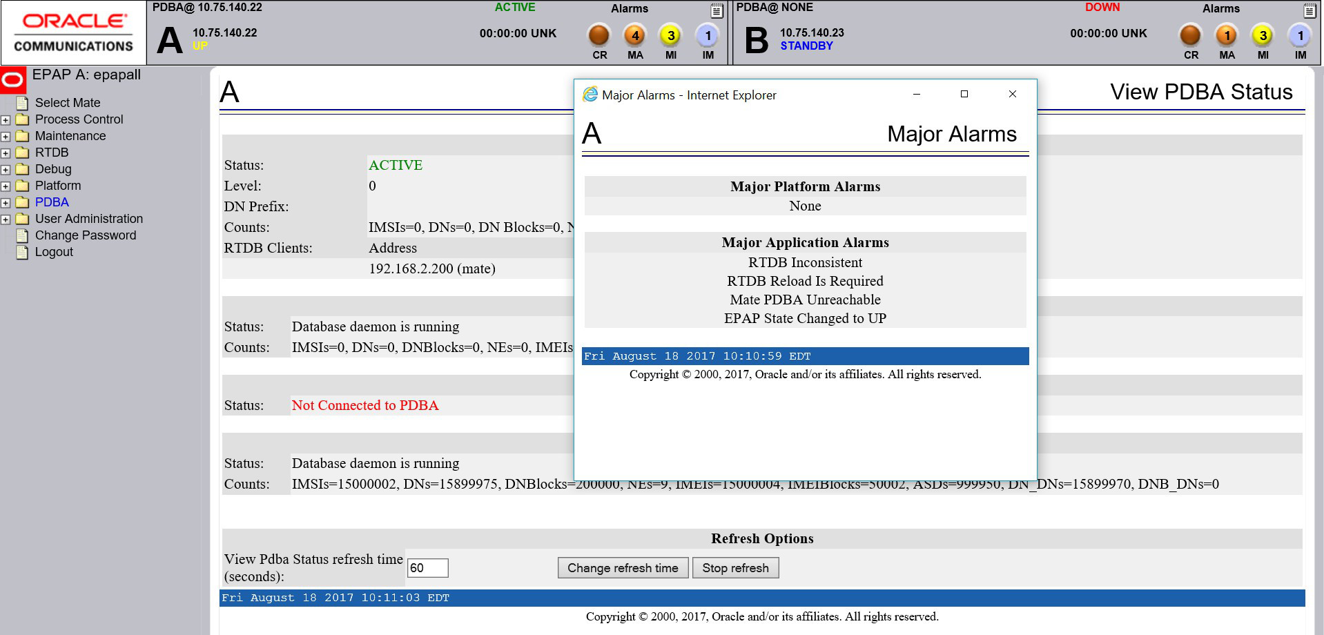

4.6.14 4000000000008000 - Mate PDBA Unreachable
This message indicates that the other PDBA is unreachable.
Recovery

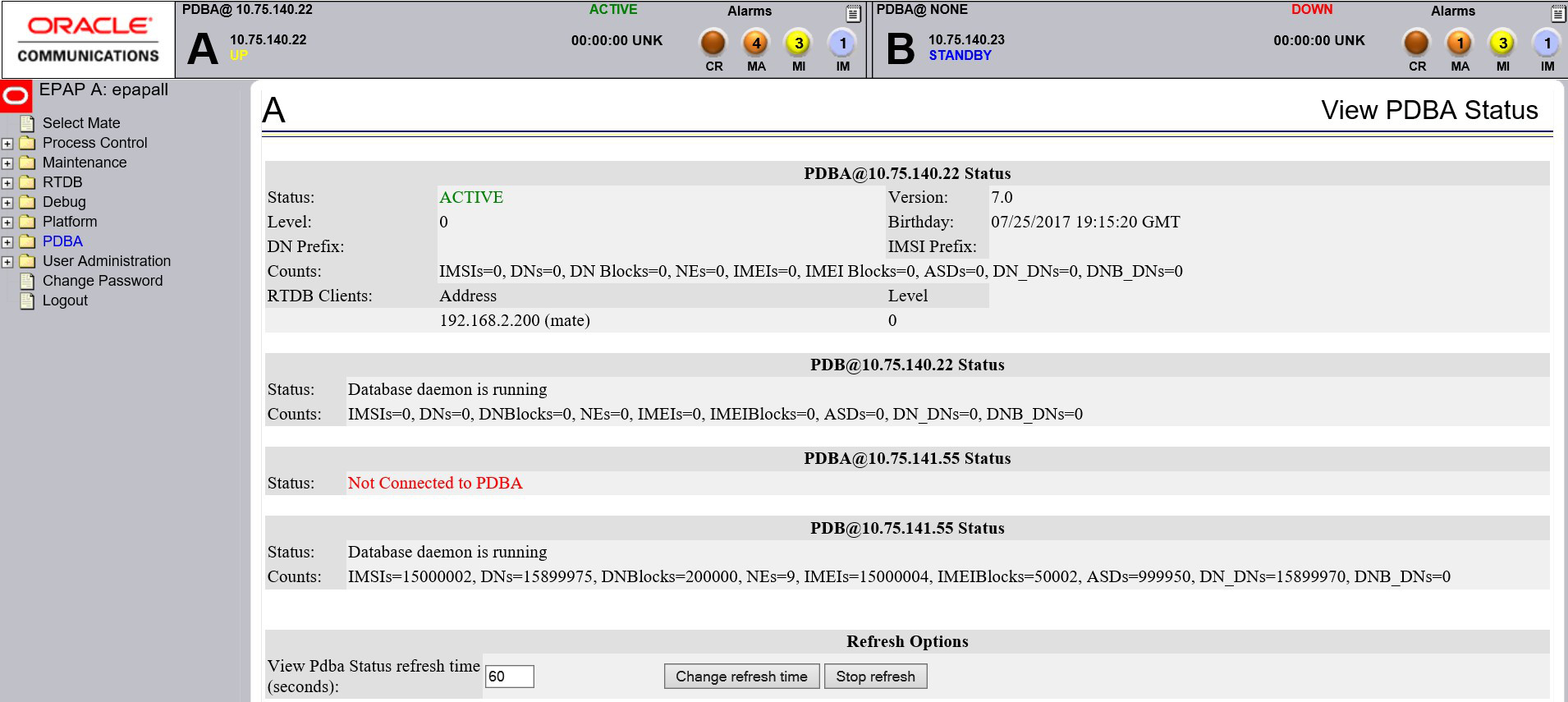

4.6.15 4000000000010000 - PDBA Connection Failure
The local EPAP RTDB process cannot connect to the local PDBA.
Recovery
4.6.16 4000000000020000 - PDBA Replication Failure
Provisioning data is no longer being exchanged from the Active PDB to the Standby PDB.
- Run
savelogs(see Saving Logs Using the EPAP GUI). - Contact My Oracle Support.

4.6.21 4000000000800000 - EPAP State Changed to UP
The standby EPAP state was changed from STANDBY to UP.
Recovery

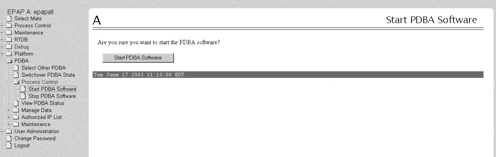

4.6.23 4000000020000000 - Mysql Lock Wait Timeout Exceeded
If MySQL is not able to get a lock to write to the PDB table, then an alarm is raised after 15 minutes when the lock wait timeout is exceeded.
Occasionally, a transaction can hang for a longer time, particularly in a multi-threaded environment, and also due to some underlying hardware failure on the disk, kernel bugs, and so on.
Recovery
Restart the PDB software.

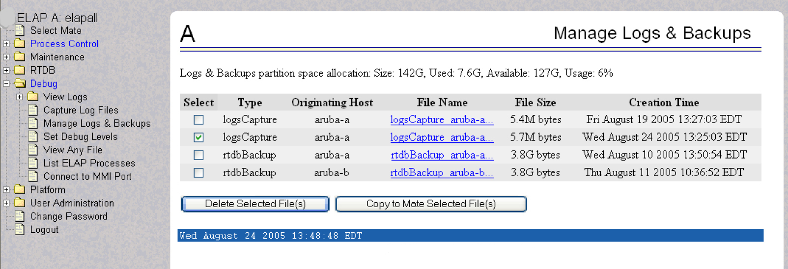

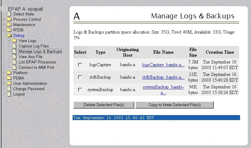

4.7 Minor Platform Alarms
Minor platform alarms involve disk space, application processes, RAM, and configuration errors.
4.7.1 32500 5000000000000001 – Server Disk Space Shortage Warning
Alarm Type: TPD
- A file system has exceeded a warning threshold, which means that more than 80% (but less than 90%) of the available disk storage has been used on the file system.
- More than 80% (but less than 90%) of the total number of available files have been allocated on the file system.
Severity: Minor
OID: 1.3.6.1.4.1.323.5.3.18.3.1.3.1
Alarm ID: TKSPLATMI15000000000000001
Recovery
- Examine the syscheck output to determine if the file system
/var/TKLC/epap/free/var/TKLC/elap/freeis low on space. If so, continue to step 2a; otherwise skip to step 3. - Delete unnecessary files, as follows, to free up space on the free partition:
- Contact My Oracle Support, and provide the system health check output.

4.8.5 6000000000000020 - Standby PDBA Falling Behind
This is an indication that there is a congestion condition affecting updates to the standby PDBA. The amount of time between an update being committed in the Active PDB and the same update being committed in the Standby PDB has reached an unacceptable level.
- Provisioning activity is very heavy
- The provisioning network is experiencing errors or latency
- Server maintenance functions (such as backups, restores, imports, exports, etc) are occurring
Recovery
4.8.6 6000000000000040 - RTDB Tree Error
For ELAP 7.0 or earlier, this alarm indicates either that the depth is greater than the theoretical maximum or that some other general problem has been found with a tree. RTDB data is stored as inverse tree structures. The trees have maximum theoretical depths based on the number of records in the tree.
This alarm indicates either that the depth is greater than the theoretical maximum or that some other general problem has been found with a tree. RTDB data is stored as inverse tree structures. The trees have maximum theoretical depths based on the number of records in the tree.
Recovery

4.8.16 6000000000040000 - RTDB Client Lagging Behind
This alarm is generated if the RTDB was not up while provisioning was done at the PDB, or if there is latency in the network resulting in RTDBs receiving updates late.
This alarm may occur during import and should eventually clear when the RTDB process catches up.Recovery
The provisioning at the PDBs can be stopped until the RTDBs reach the same level.
