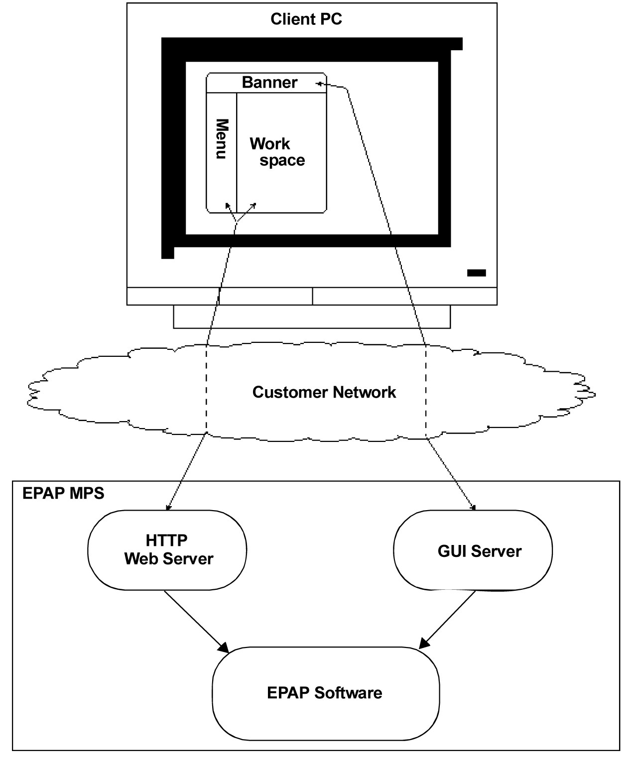

EPAP uses a Web-based user interface in a typical client-server paradigm. The front end appears on a Web browser. See Compatible Browsers for supported browsers. The back end operates on the MPS platform.
The graphical user interface display has three different sections:
  • Banner header section for displaying the real-time status of the MPS servers
  • Menu section for selecting desired actions
  • Work area section for filling out requested information and displaying results
The banner header sections communicate directly with the GUI Server process on the MPS. The menu and work area sections primarily consist of CSS3 and HTML5 generated by Ajax and CGI (Common Gateway Interface) scripts on the back end. Perl socket programming, along with CGI scripts, are used for the watchers. The banner displays the current EPAP IP and Status, PDBA IP and Status, Timer, Oracle Logo, Watchers, Alarm Indicators and Message History. The banner contains the EPAP A and B areas, both PDBA areas, and the busy icon.
An http or https (Hypertext Transfer Protocol) Web server starts the process of handling requests from browsers. It receives the requests and loads the document. If the document is a simple HTML file, the http or https Web server returns the document to the browser. The EPAP software may also connect with the GUI server to request actions be performed. HTML output from the script is returned to the browser and displayed.
For GUI differences related to Standalone PDB EPAP, see Standalone PDB EPAP.
Figure 3-1 shows the architecture view of the EPAP user interface.
Figure 3-1 Process Architecture View of the EPAP UI

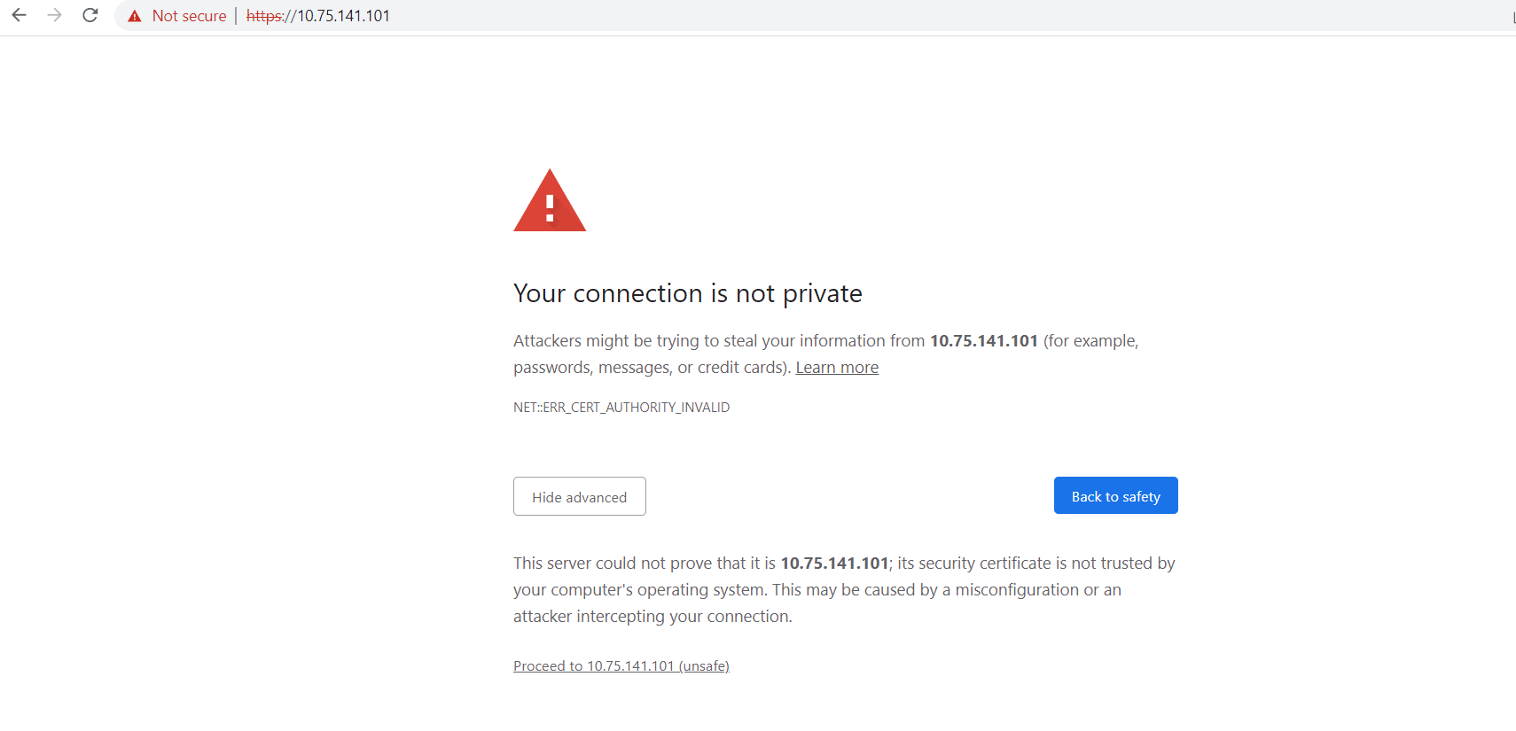

Opening HTTPS Mode Without Installing Security Certificate
Opening the EPAP GUI in HTTPS mode without installing the security certificate causes the following menu tabs to fail to open:

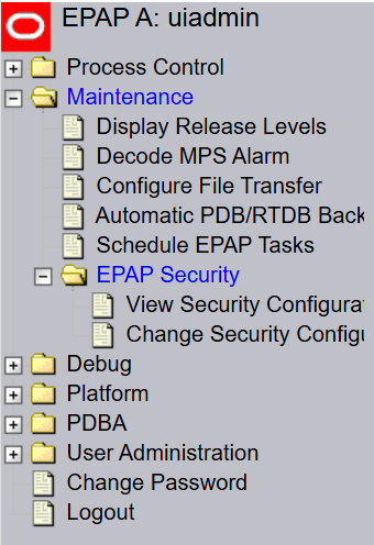

Process Control
  • Start Software
  • Stop Software
Maintenance
  • Force Standby
    • View Status (Mixed EPAP)
    • Change Status (Mixed EPAP)
  • Decode MPS Alarm
  • RTDB Audit
    • View Enabled (Mixed EPAP)
    • Change Enabled (Mixed EPAP)
  • Automatic PDB/RTDB Backup
  • EPAP Security
    • View Security Configuration
    • Change Security Configuration
RTDB (Mixed EPAP menu)
  • Maintenance
    • Reload from Remote
    • Backup RTDB
    • Restore RTDB
    • Configure Record Delay
Debug
  • Capture Log Files
  • Manage Logs & Backups
  • Set Debug Levels (Mixed EPAP)
Platform
  • Run Health Check
  • Reboot the MPS
PDBA
  • Process Control
    • Start PDBA Software
    • Stop PDBA Software
  • View PDBA Status
  • Manage Data
    • IMSI Range
      • Add
      • Update
      • Delete
    • Prov BL
      • Add
      • Delete
      • Retrieve
  • Authorized IP List
    • Add Authorized IP
    • Modify Authorized IP
    • Removed Authorized IP
  • Maintenance
    • Backup
      • List Backups
      • Backup the PDB
      • Restore the PDB
    • Transaction Log Params
      • View Params
      • Change Params
    • Number Prefixes
      • View Prefixes
      • Change Prefixes
    • Logs
      • Set Log Params
User Administration
  • Authorized IPs
    • Add Authorized IP
    • Change UI IP Authorization
  • HTTP(S) Support
    • Change Configuration
  • Modify Defaults

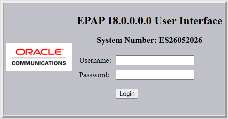

  1. Access the EPAP GUI by opening a web browser and entering the IP address of Server A.
    Figure 3-2 EPAP Login
    EPAP Login
  2. Login as uiadmin.
    Figure 3-3 Login Successful
    Login Successful

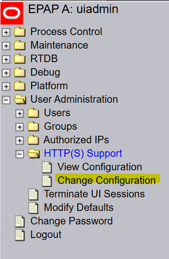

  3. On the EPAP A site, select User Administration, and then HTTP(S) Support, and then Change Configuration.
    Figure 3-4 Change Configuration Menu Option

  9. Click on "Continue to this website (not recommended)."
    Figure 3-8 Security Certificate

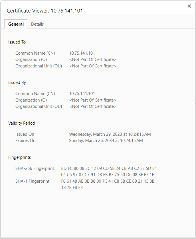

  11. In the popup window titled "Certificate Invalid," click on the View certificates link to display the Certificate dialog box.
    Figure 3-10 Certificate
    Certificate

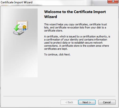

  12. Click Install Certificate... to begin the Certificate Import Wizard. The Certificate Import Wizard "Welcome" page is displayed:
    Figure 3-11 Certificate Import Wizard
    img/t-certificate-import-wizard.jpg

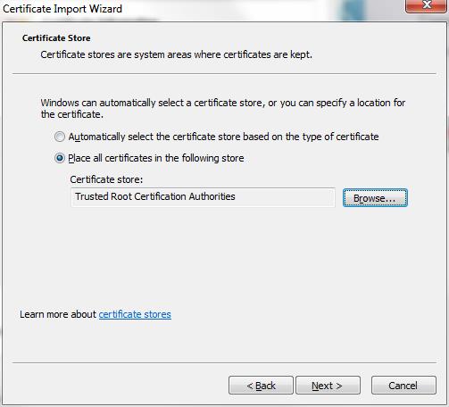

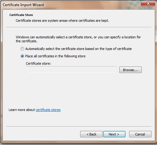

  14. Select the "Place all certificates in the following store" radio button, then click Browse to display the Select Certificate Store window.
    Figure 3-13 Select Certificate Store
    img/t-select-certificate-store.jpg

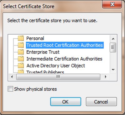

  15. Select the "Trusted Root Certification Authorities" option and click OK to display the Certificate dialog box.
    Figure 3-14 Certificate Store
    img/t-certificate-import-wizard-place-store.jpg

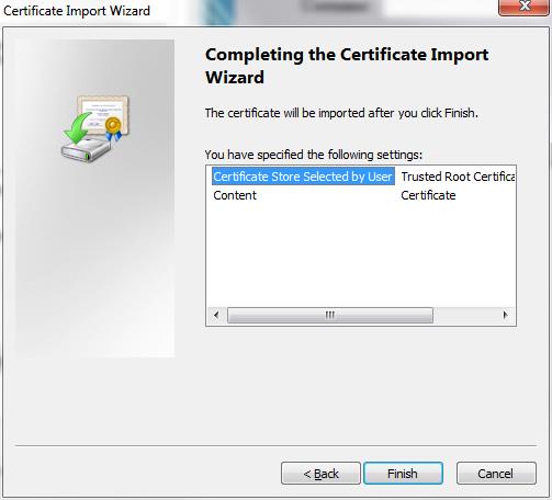

  16. Click Next. The Certificate Import Wizard "Completing the Certificate Import Wizard" page is displayed:
    Figure 3-15 Completing the Certificate Import Wizard
    img/t-certificate-import-wizard-complete.jpg

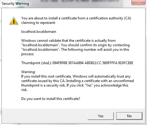

  17. Click Finish. If a Security Warning dialog box is displayed, click Yes.
    Figure 3-16 Security Warning
    img/t-certificate-import-warning.jpg

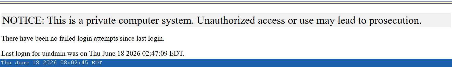

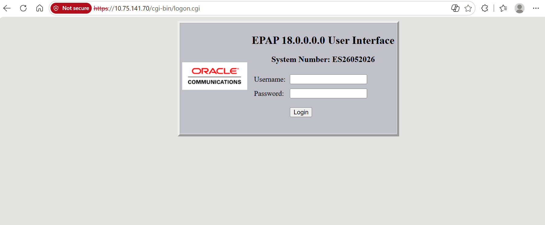

3.1.2 Login Screen
The first screen of the EPAP User Interface (UI) is the login screen. Two fields are prompted for on this screen: Username and Password. To log in, enter a valid user name and password, then click the Login button. These fields provide the user identification and verification.

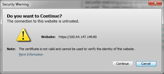

After logging in, a Security Warning dialog box alerts the user that the connection is untrusted. The user clicks Continue to proceed to the second Security Warning dialog box.
Figure 3-18 Security Warning for Untrusted Connection
img/security-warning-connection-epapgui.png

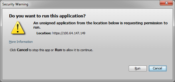

The second Security Warning dialog box asks the user whether to run the unsigned application. The user clicks Run to run the application.
Figure 3-19 Security Warning for Unsigned Application
img/security-warning-application-epapgui.png
When a user logs in successfully, the screen workspace indicates that the user is logged in.
When a user logs into the EPAP UI, the user does not need to log in again if the web browser session remains active and if no user in the admin user group changes the HTTPS configuration. Subsequent user authentication is handled with cookies, which are stored in the browser of the user and are retained during the browser operation. If a user in the admin user group changes the HTTPS configuration from only HTTP to only HTTPS, all logged -n users are disconnected. Similarly, if a user in the admin user group changes the HTTPS configuration from only HTTPS to only HTTP, all logged-in users are disconnected. For more information, see EPAP Support for HTTPS on GUI.

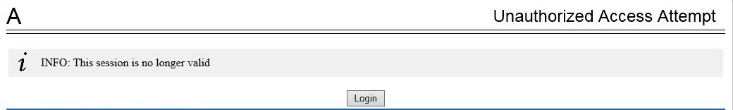

Figure 3-24 EPAP GUI Terminated Session
img/c-epap-gui-terminated.jpg

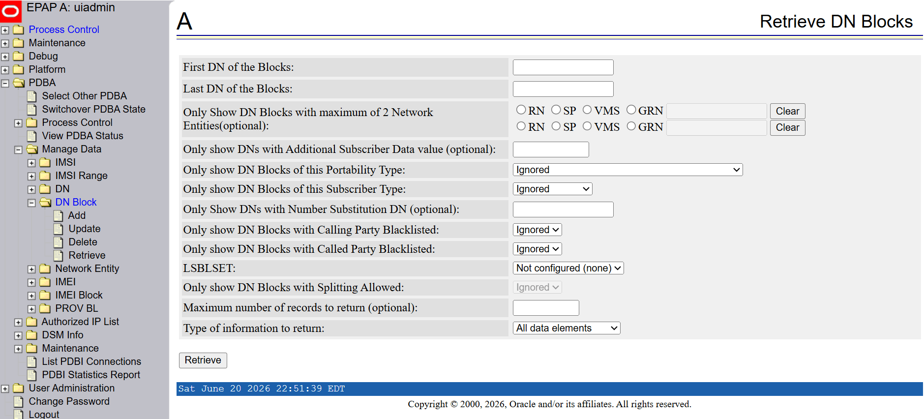

Menu Section
The EPAP graphical user interface menu is located in the left frame of EPAP browser interface. At the top of the frame is the software system title, EPAP, and a letter designation of the selected MPS machine, either A or B. One or more submenus appear below the title, depending on the access privilege of the user who views the menu. An icon accompanies the name of each submenu.
By clicking on the name or folder icon of a directory, the user may expand and contract the listing of submenu contents in the typical “tree-menu” fashion. Directory contents may be either menu actions or more submenus. When you click the Menu actions, the output is displayed in the workspace section, which is the right frame of EPAP browser interface.
Workspace Section
The results of menu actions are displayed in the workspace section. The content of the workspace section can be various things such as prompts or status reports. Every menu action that writes to the workspace uses a standard format.
The format for the workspace is a page header and footer. In the header, the left-justified letter A or B designates which MPS server this menu action affects. The right-justified menu will also display the action title. The footer consists of a bar and text with the time when the page was generated, as well as Oracle copyright notice information.

3.2 EPAP Graphical User Interface Menus
The EPAP menu is the main menu of the EPAP application. It provides the functions of the EPAP User Interface. epap-graphical-user-interface.html#GUID-E8A2DB6C-8026-4DE2-BF1E-AC53F05A1FCA__V2462447 shows the EPAP main menu.
Figure 3-25 EPAP Menu
EPAP Menu
The EPAP menu provides two actions which are common to all users: Change Password and Logout. All the remaining actions are options assignable by the system administrator to groups and individual users.

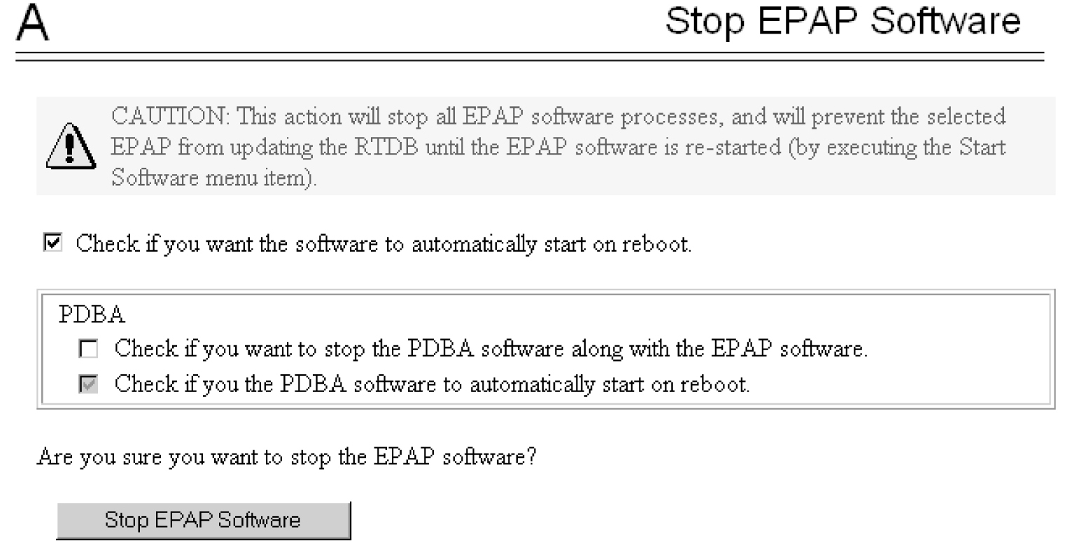

The Start EPAP Software menu option contains a button to confirm that you do want to start or stop the software processes and a checkbox to start the PDBA.
Stop EPAP Software
The Stop EPAP Software screen contains a button to confirm that the user wants to stop the software processes. It also allows a choice to automatically restart the software when the server reboots.
Figure 3-26 Stop EPAP Software Screen
img/c-process-control-menu-epapgui-epapadmin-fig4.jpg

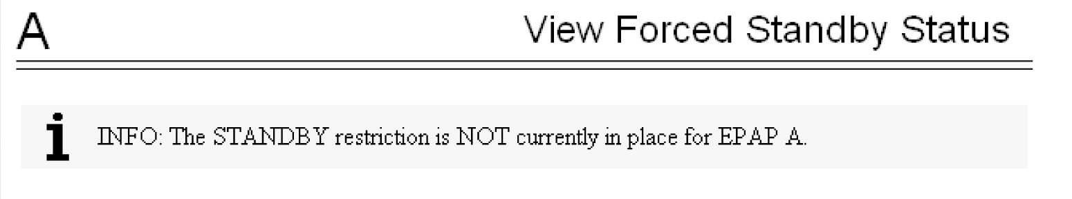

The Maintenance / Force Standby menu gives the user the ability to view the EPAP status and change the status.
The Force Standby menu provides the following actions:
View Status
The View Status screen displays whether or not EPAP is currently in a forced standby state.

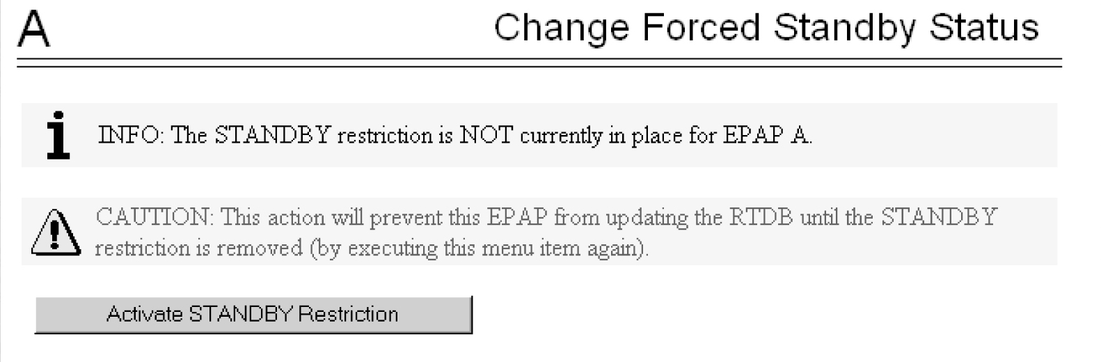

Figure 3-27 View Forced Standby Status Screen
img/c-maintenance-menu-epapgui-epapadmin-fig3.jpg
Change Status
The Change Status screen displays the current state of the selected EPAP. If the EPAP is not currently in forced standby mode, this screen lets the user force it into standby mode.
If the EPAP is currently in forced standby mode, the user can remove the standby restriction on the selected EPAP. See the Change Forced Standby Status screen.
Figure 3-28 Change Forced Standby Status Screen
img/c-maintenance-menu-epapgui-epapadmin-fig4.jpg
Table 3-4 Rules for Change Forced Standby Status
Semantic Rules
Error Code
A connection to the EPAP maintenance process must be available
E1005
Other Messages
Condition
Message Text
Standby restriction removed
Forced standby restriction removed from EPAP <selected EPAP>.
Forced standby completed
EPAP <selected EPAP> now in forced standby mode

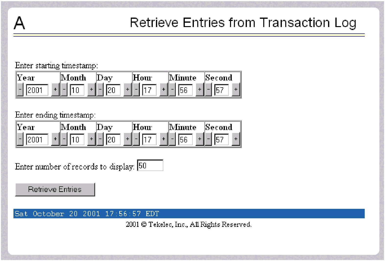

Retrieve Entries Screen
The Retrieve Entries screen lets the user retrieve log entries from the transaction log. The user is prompted for the start and end time range, along with the maximum number of records to display to the screen.
Figure 3-29 Retrieve Entries from Transaction Log Screen
img/c-maintenance-menu-epapgui-epapadmin-fig10.jpg
Table 3-6 shows the syntactic and semantic rules for retrieving transaction log entries.
Table 3-5 Rules for Retrieving Transaction Log Entries
Syntax Rules
Error Code
Dates/Times must be valid:
Field Valid Range
Year: 0000 - 9999
Month: 01 - 12
Day:01 - 31
Hour: 00 - 23
Minute: 00 - 59
Second: 00 - 59
(The day must be appropriate for the month and year.)
E1002
Maximum number of records must be in the range of 1 to 10,000
E1002
Semantic Rules
Error Code
Transaction log task must successfully process query
E1039
Transaction log task must create a file containing the result
E1040
UI task must successfully parse the result
E1041

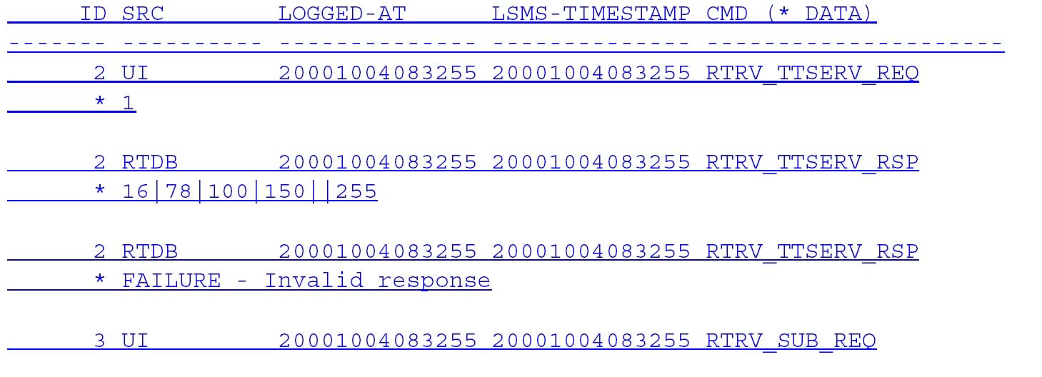

See Figure 3-30 for a sample of the output from the Retrieve Transaction Log, followed by a table with the output field descriptions.
Figure 3-30 Sample of Retrieve Transaction Log Entry Output
img/c-maintenance-menu-epapgui-epapadmin-fig11.jpg
Output Field Descriptions
Field
Description
ID
This field represents a unique identifier for the corresponding transaction. It is used internally with the Transaction log to correlate commands and responses. Any entries with the same ID are part of the same transaction. This field is used by customer service or engineering to investigate an issue.
SRC
This field stores the source of the corresponding transaction. The SRC field correlates to an internal task with the EPAP software and is used to determine the originator of the transaction. This field is used by customer service or engineering to investigate an issue.
LOGGED-AT
This field is the timestamp when the transaction was logged by the EPAP software. The format is: “yyyyMMddhhmmss” which indicates:
yyyy:
Year
MM:
Month
dd:
Day
hh:
Hour
mm:
Minute
ss:
Second
LSMS- TIMESTAMP
This field is the timestamp from the LSMS for the transaction.
CMD (* DATA)
This field contains a command identifier string and the command string from the LSMS. Command strings too long to be displayed on one line are not truncated.
For details about the contents of the Transaction Log, refer to Figure 3-30, which shows sample output as obtained by the Retrieve Entries action.

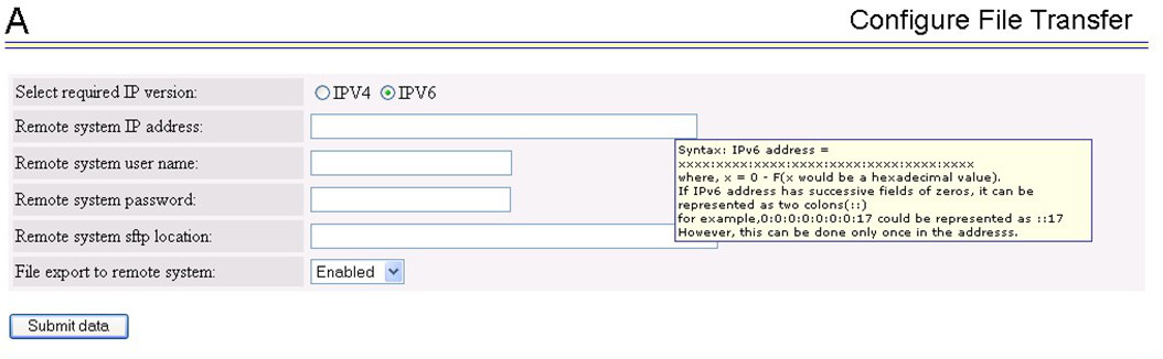

3.2.2.5 Configure File Transfer
This screen has several different functions. This screen can be used to:
  • Define the location of where the results of the automatic import are stored.
  • Provide the options for enabling/disabling the Automatic Export capability.
  • Provide a mechanism for testing the connection to the remote machine. This is done by using the username/ password and IP address provided to attempt to make an SFTP connection to the remote machine. The status of the connection is then displayed . This test is run anytime the data on this screen is entered or modified.
This screen consists of the following fields:
  • Choice of IPv4 or IPv6 remote system address:
    • The user is allowed to configure IPv4 only remote system address
    • The user is allowed to configure IPv6 only remote system address
    • On dual stack - the user is allowed to configure IPv4 or IPv6 remote system address
  • Remote System IP Address - the IP address from where the data will be exported (customer system).
  • Remote System User Name - required for logging onto the customer system
  • Remote System Password - required for logging onto the customer system. This password will be stored in encrypted format.
  • Remote System SFTP Location - the location of the directory on the customer system.
  • File Export to Remote System - this is used to return the results of the import file (default = enabled ).
The Configure File Transfer Screen is shown in Figure 3-31.
Figure 3-31 Configure File Transfer Screen
img/c-epap-configure-file-transfer.jpg

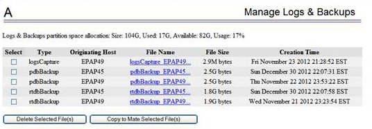

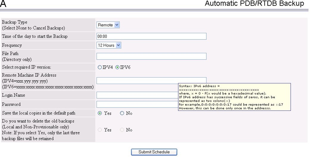

3.2.2.6 Automatic PDB/RTDB Backup
This screen is used to configure the Automatic PDB/RTDB Backup using either IPv4 or IPv6 addresses for a remote machine IP. The options for backup type are:
  • Local - Backup is stored on the same EPAP server
  • Mate - Backup is stored on the mate EPAP server
  • Remote - Backup is stored on a remote server
  • None - No backup is scheduled and cancel all previously scheduled backups. This will not affect a backup that is currently in progress.
    Verify there is adequate disk space (approximately 17 GB of disk space is required per backup) to store backup files locally, on the mate, or on a remote server. If there is inadequate disk space to store 3 copies on the local or mate, stored backups will not be overwritten, and backup operation failure alarms will be generated.
Use Table 3-9 as a guide when populating the Automatic PDB/RTDB Backup screen. See Figure 3-32.
Table 3-9 Mandatory and Optional Parameters
Parameter Backup Type
Local Mate Remote
Time of the day to start the Backup
Mandatory
Mandatory
Mandatory
Frequency
Mandatory
Mandatory
Mandatory
File Path (Directory only)
Optional
Optional
Mandatory
Remote Machine IP Address (xxx.xxx.xxx.xxx)
Not Applicable
Not Applicable
Mandatory
Login Name
Not Applicable
Not Applicable
Mandatory
Password
Not Applicable
Not Applicable
Mandatory
Save the local copies in the default path
Not Applicable
Optional
Mandatory
Do you want to delete the old backups (Local and Mate only) Note: If you choose Yes, only the last three backup files, including the current one will be kept.
Mandatory
Mandatory
Not Applicable
Oracle recommends that this Automatic PDB/RTDB Backup be performed on a daily (24 hour) basis. If the 12-hour frequency is selected, the first backup will always be created in the AM. For example, if the Time of the day to start the backup is selected as 15:00, the first backup will be created at 3 AM and then subsequent backups at 12-hour intervals.
The default file path where subdirectories are created (in the mate and locally) is /var/TKLC/epap/free/.
In the case of mate and remote backup destinations, a local copy is saved (even if the option not to save the local copy was selected) if the transfer of the file fails after the backup has been created on the local machine. This file is located at the default file path. In the case of mate and remote backup destinations, a local copy is saved (even if the option not to save the local copy was selected) if the transfer of the file fails after the backup has been created on the local machine. This file is located at the default file path.
PDB only maintains a single copy of backup file, if this backup file is already present automatic backup will fail for PDB. Therefore it is required to schedule remote transfer of PDB backup file using Configure File Transfer as described in section Configure File Transfer.
If the Automatic PDB/RTDB backups are being directed to a remote server, then before scheduling:
  • The SFTP must be installed at the remote server
  • The connection to the remote server must be validated
  • Verify there is adequate disk space (approximately 17 GB of disk space is required per backup)

When using the Automatic PDB/RTDB Backup screen to configure the automatic backup, follow these semantic rules:
Backup Type - Select None to cancel Backups.
Time of the Day should be in hh:mm 24 hour (14:03) format.
File path (in remote only) should be the absolute path from root /backups/xxxx
IP address should be in xxx.yyy.zzz.aaa format (192.168.210.111).
Password entered by the user will be displayed in asterisks (*)

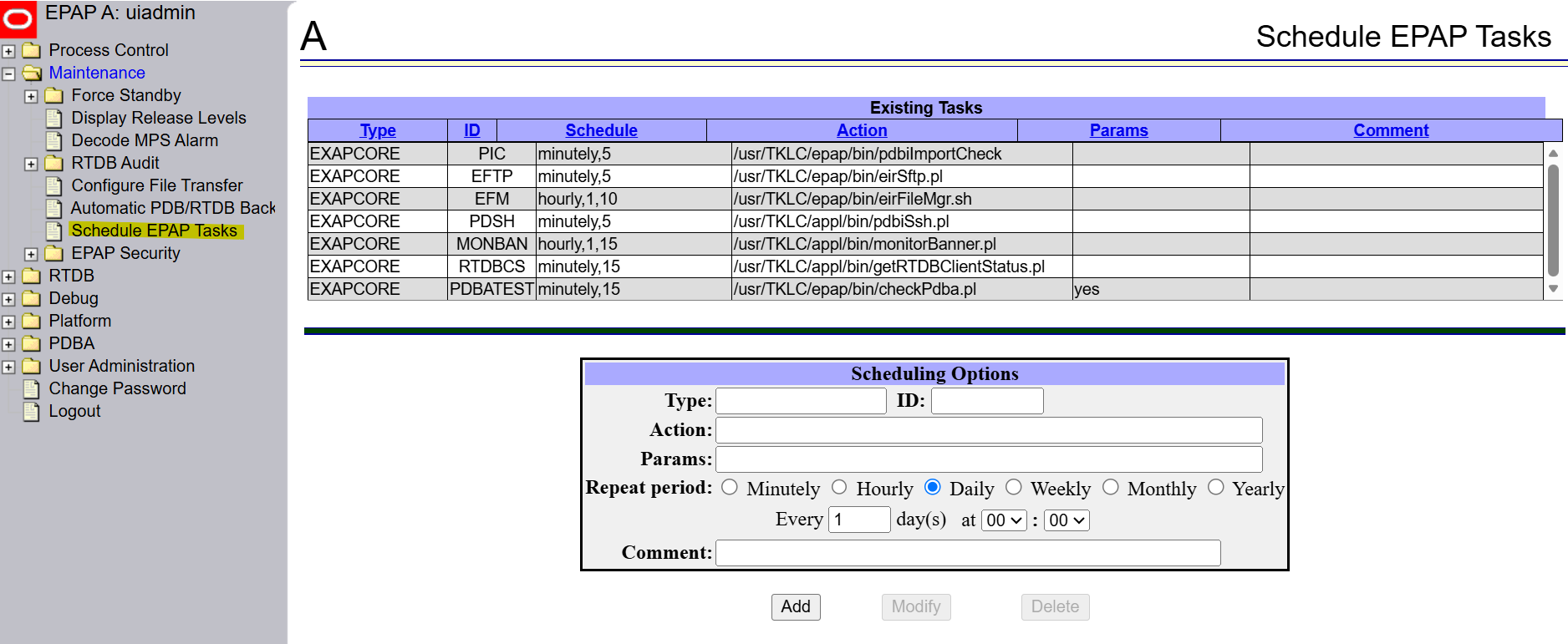

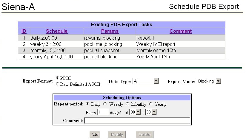

3.2.2.7 Schedule EPAP Tasks
Maintenance /Schedule EPAP Task
This screen is used to Schedule EPAP Tasks. Through this screen the customer has a choice of what tasks to be scheduled as well as the day and time of day for the execution of the tasks.
The tasks can be scheduled at a specific time for each of the following repeat periods: at specific minute, at specific hour, every N number of days (N can be up to 30), on specific days of the week, on a specified day of the month, or on a specified day of the year.
The Schedule EPAP Tasks screen is used to display any existing tasks and to create a task by specifying the type, ID, Action, Parameters, as well as the time and repeat period. In addition, a Comment field is available to describe the task.
Figure 3-33 is an example of the Schedule EPAP Tasks screen.
Figure 3-33 Schedule EPAP Tasks Screen
img/epapadmin-scheduletasks.jpg
Existing Tasks
The Existing Tasks portion at the top of the screen displays all currently scheduled tasks in table format.
Clicking on a column heading causes the entries in that column to be sorted, either alphabetically or numerically, depending on whether the column entries start with a letter or a number. Clicking the column again sorts the entries in the opposite order.
Clicking on a row causes the data contained in that task to be displayed in the data entry fields below the table, to view, modify or to delete the tasks.
Scheduling Options
The Scheduling Options section of the Schedule Tasks screen allows the user to choose how often to repeat the scheduled task and to specify the exact day and time. The appearance of this section changes depending on which Repeat Period radio button is selected:
The following fields are the same among the various Repeat Period selections (for more information
about fields that differ depending on the Repeat Period selected, see Variable Fields in Scheduling Options:
Type:
Type of the task can be specified in this field.
ID:
ID of the task can be specified in this field.
Action:
Action of the task specified by adding the path for the task.
Parameters:
Parameters for the task can be specified in this field.
Comment:
Use this optional field to add comments about Tasks. The content of this field is stored and displayed on the GUI, but it is not used otherwise.
The following sections describe how the Scheduling Options fields change depending on the Repeat Period that is selected.
Minutely Repeat Period
To schedule the task to be run minutely, select the minutely radio button, select the minute and optionally enter a comment.
Hourly Repeat Period
To schedule the task to be run hourly, select the hourly radio button, select the hour, select the minute and optionally enter a comment.
Daily Repeat Period
To schedule the task to be run every N days, select the Daily radio button, specify a number (N) to indicate that the Task should be run every N days, select the time and optionally enter a comment.
Although the maximum value allowed in the day(s) field is 30.
Weekly Repeat Period
To schedule the task to be run each week, select the Weekly radio button, select one or more days of the week, select the time and optionally enter a comment.
Monthly Repeat Period
To schedule the tasks to be run one day each month, select the Monthly radio button, select a numeric day of the month, select the time and optionally enter a comment.
For months that do not contain the number of days specified in the Day field, the task will run on the first day of the following month. (For example, if the Day field value is 29, the task will run on March 1 rather in February for any year that is not a leap year.)
Yearly Repeat Period
To schedule the tasks to be run one day each year, select the Yearly radio button, select a numeric day of the year, select the day of the month, select the time, and optionally enter a comment.
Add, Modify, and Delete Buttons
The Add, Modify, and Delete buttons are located at the bottom of the Schedule EPAP Tasks screen.
Add
To add a scheduled EPAP Task, enter all the data to describe the task, and click the Add button.
If the task, as described by the current data in the data entry fields, does not exactly match an existing task, a new task is scheduled. If the task exactly matches an existing task, an error message is displayed.
Modify
To modify a scheduled EPAP Task, click that task in the Existing Tasks in Tasks table, change any data that describes the task, and click the Modify button. The Modify button is selectable only when an entry in the Existing Tasks table at the top of the screen has been selected and one or more fields other than Type and ID on the screen have been changed.
Delete
To delete a scheduled Task, click that task in the Existing EPAP Tasks table, and click the Delete button.
The Delete button is selectable only when an entry in the Existing Tasks table at the top of the screen has been selected.
3.2.2.8 EPAP Security
This menu allows the user to view/configure access security for EPAP server. The user can view/change the following two configurations:
  • Restrict/Allow command line access to server root account.
  • Restrict/Allow server access to only authorized IPs or to all.
This menu allows the user to view security access for EPAP server on which the GUI is open. The user can view the following two configurations:
  • Restrict command line access to server root account.
  • Restrict server access to only authorized IPs or to all.
When the value of Restrict remote access to server root account is set to No, root can access the server using ssh. When the value of Restrict remote access to server root account is set to Yes, root cannot directly access the server using ssh. However, the user can ssh to the server as epapdev and then do an su - root to access the server as root.
When the value of Restrict server access to authorized IPs is set to No, the server can be accessed from any IP address. When the value of Restrict server access to authorized IPs is set to Yes, the server can be accessed only from the IP addresses that are added in file /etc/hosts.allow.
This menu allows the user to change security access for EPAP server on which the GUI is open. The user can change the following two configurations:
Configuration will only be done on the server on which the GUI is open. To change configuration on mate, select mate from GUI and select Maintenance, and then EPAP Security, and then Change Security Configuration.

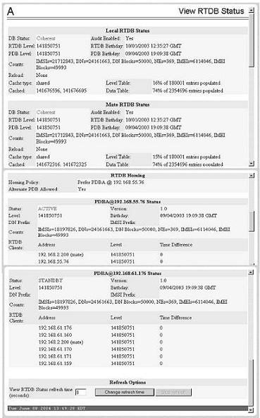

3.2.3.1 View RTDB Status
The RTDB / View RTDB Status screen displays the current level and birthday of the EPAP RTDBs. This selection displays the RTDB status information for both the selected EPAP and its mate. The status information reports the DB level and the DB birthday (date and time of the creation of the database). The RTDB Status refresh time can be viewed and changed with this screen.
The IMSI count returned from the RTDB and the IMSI count returned from the PDB may not match when there is both G-Flex and EIR data. Any IMSI created for EIR that does not have a G-Flex IMSI association is not included in the IMSI counts of the PDB. The PDB reports only G-Flex IMSIs. The RTDB reports the total of G-Flex and EIR IMSIs as one count.

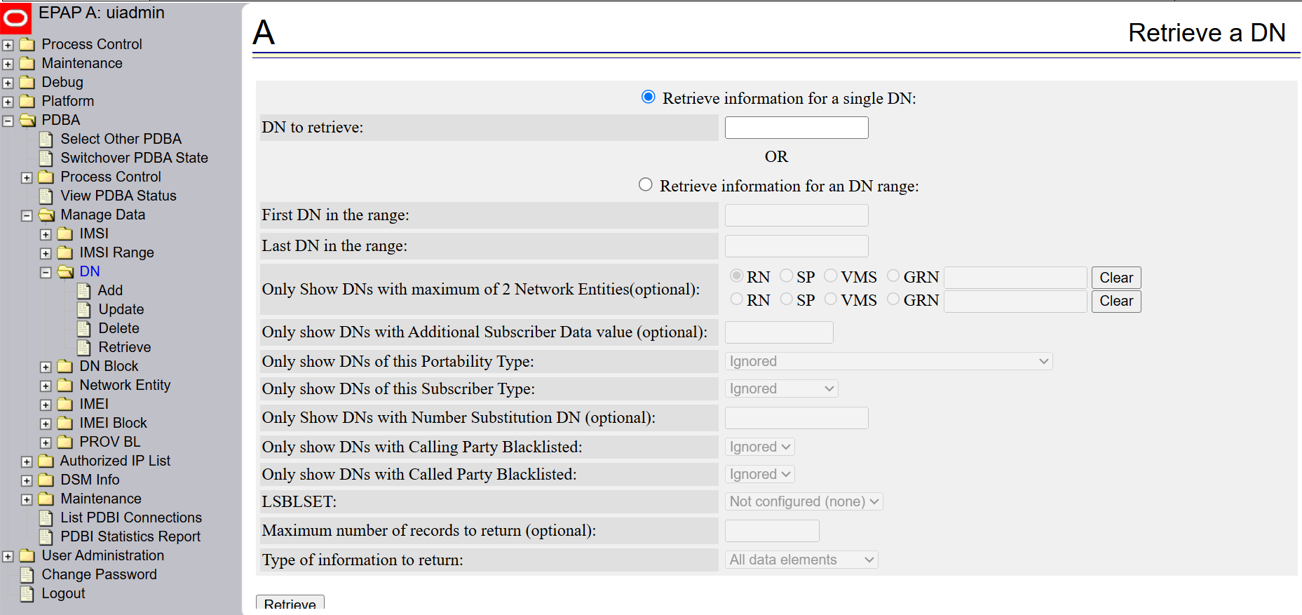

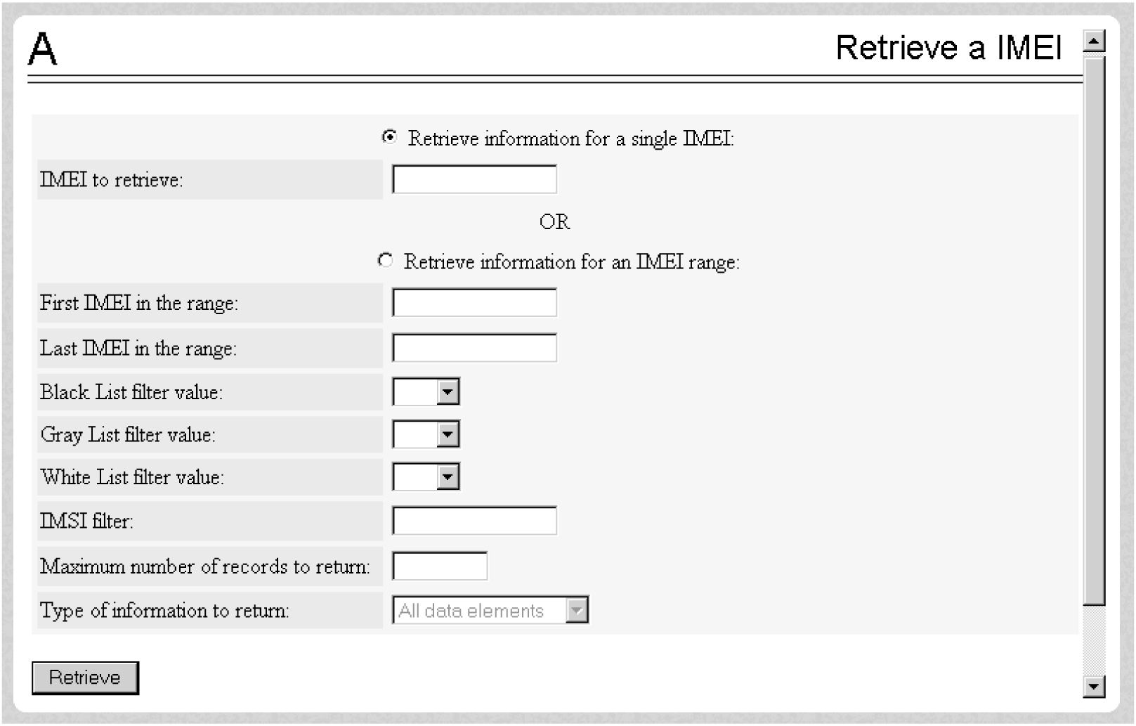

3.2.3.3 Retrieve Records
The RTDB / Retrieve Records menu allows the user to query (from the web GUI) data that resides in the RTDB (Real-Time Database). The user can compare data in the PDB (Provisioning Database) with data in the RTDB to verify that they are consistent:
The RTDB / Retrieve Records menu contains:
A limit of 1,000 is imposed on the retrieval of DN, DN Blocks, NE, IMSI and IMEI. In order to fetch the next 1,000 entries the user has the following options:
  1. Run another retrieval starting with the last entry in the last GUI retrieval.
  2. Run the PDBA export (see PDBA / Maintenance / Export PDB to File).
  3. Use the PDBA retrievals from the CLI PDBI Interface (see the "Simple Queries" section in Provisioning Database Interface User's Guide.

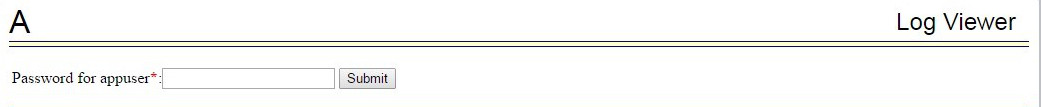

When any of the Debug / View Logs files are chosen, the process is the same. Complete the following steps to view logs from the EPAP GUI menu:
  1. Log in to the EPAP GUI
  2. Expand the Debug Menu, then Select View Logs
  3. Select a log file. Figure 3-38 shows the selection of the Maintenance log file:
    Figure 3-38 Maintenance Log Option
    img/c-viewlogs-gui-menu.jpg
    Opening any log in this window displays the requested log in the log viewer window. All log view screens require an authorized password for the user appuser. All log files are viewed with the EPAP Log Viewer utility.

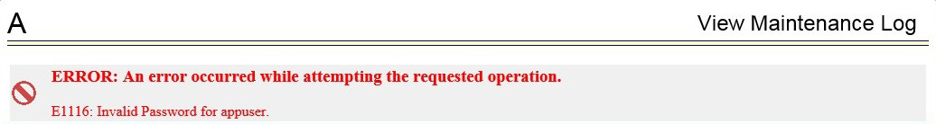

    The system may ask you to change the appuser password from the CLI. If you change the password from the root user, the system will prompt you to change the password again. If the password is changed using the appuser, you will not be asked to change it an additional time.
  4. Enter the password for the appuser and select the Submit button.
    Figure 3-39 Log Viewer Password Prompt
    img/c-viewlogs-password-prompt.jpg

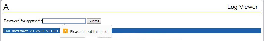

    When the user selects the Submit button without entering the password, the following error will display:
    Figure 3-40 Log Viewer Password Missing
    img/c-viewlogs-password-mandatory.jpg

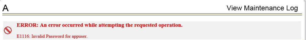

    If the user enters an invalid password, the following error will display:
    Figure 3-41 Log Viewer Invalid Password
    img/c-viewlogs-password-invalid.jpg

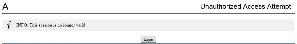

    When the GUI session expires before the user submits a valid password, the following screen will display:
    Figure 3-42 Log Viewer Session Expired
    img/c-viewlogs-expired-session.jpg

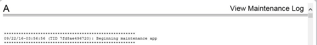

    On the successful submission of the appuser password, the log file contents will be visible in the work area. Figure 3-43 shows an example of the Maintenance Log:
    Figure 3-43 Maintenance Log Viewer
    img/c-viewlogs-success.jpg

3.2.4.3 Manage Logs and Backups
The Debug / Manage Logs and Backups displays the captured log files and allows the user to delete the copies no longer wanted or copy the selected file to the mate. See Figure 3-46 with an example of one recorded log file on the Manage Log Files screen.
Figure 3-46 Manage Logs & Backups Screen
img/epapadmin-managelogs.jpg
In the Manage Log Files screen, you can remove a log file by clicking the Delete? button and then the Delete Selected Capture File button. A successful removal message appears.

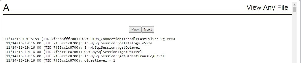

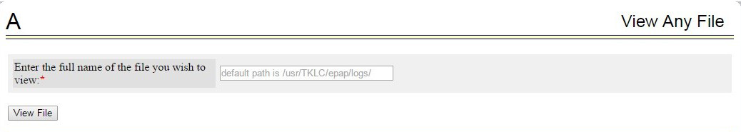

3.2.4.4 View Any File
The View Any File screen allows the user to "view any log file" on the system using the Log Viewer by entering the authorized password for the user appuser. Log files that cannot be viewed from this utility include:
  • exinit.log
  • slow-queries.log
  • platwrap.log
  • backupPdb.out
When the user enters a filename, the Log Viewer is invoked. Complete the following steps in order to view logs using the View Any File menu on the EPAP GUI:
  1. Log in to the EPAP GUI.
  2. Expand the Debug menu.
  3. Select View Any File.
    Figure 3-47 View Any File on the EPAP GUI Menu
    img/c-viewanyfile-epap-gui-menu.jpg

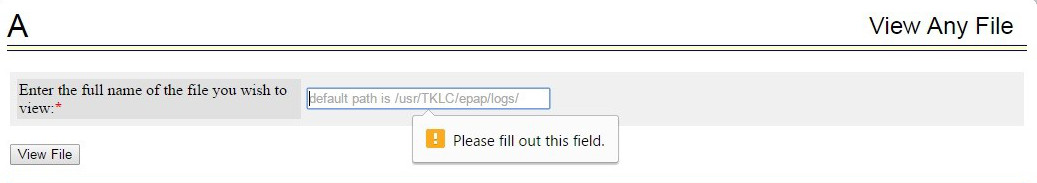

  4. On selecting View Any File, the user will be asked to enter the filename to be viewed. The default path for this utility is /usr/TKLC/epap/logs. The filename field is mandatory (marked with * as displayed in Figure 3-48).
    Figure 3-48 View Any File Filename Prompt
    img/c-viewanyfile-filename-prompt.jpg
    When the View File button is selected without inputting the filename, the following error will be displayed:

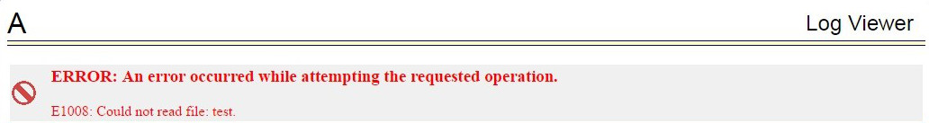

    If the user inputs a non-existing filename in the /usr/TKLC/epap/logs directory, the following error will be displayed:
    Figure 3-50 View Any File Non-Existing Filename Error
    img/c-viewanyfile-nonexisting-filename.jpg

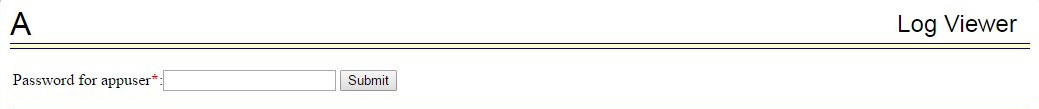

  5. After entering a valid filename, the user will be prompted for the appuser password, as displayed in Figure 3-51:
    Figure 3-51 View Any File Password Prompt
    img/c-viewanyfile-password-prompt.jpg

  6. After entering the valid appuser password, the log file contents will be visible in the work area, along with the log file name as its heading, as displayed in Figure 3-55:

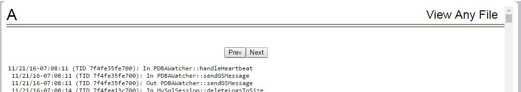

    Figure 3-55 Log Viewer
    img/c-viewanyfile-log-viewer.jpg
Opening any file in this window displays the requested file in the file viewer window. All files are viewed with the same file viewing utility. For details about this utility, see Platform Menu.
Table 3-10 Rules for Viewing Any File
Semantic Rules
Error Code
The file must exist and be readable.
E1008

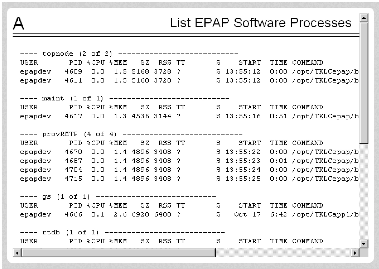

3.2.4.5 List EPAP Processes
The Debug / List EPAP Processes screen shows the EPAP processes started when the EPAP boots or with the “Start EPAP software” prompt. The /usr/ucb/ps -auxw command generates this list. The operating system's manual page for the ps command thoroughly defines the output for this command. Figure 3-56 shows an example of the format of the process list.
Figure 3-56 Example of List EPAP Processes Output
img/c-debug-menu-epapgui-epapadmin-fig11.jpg

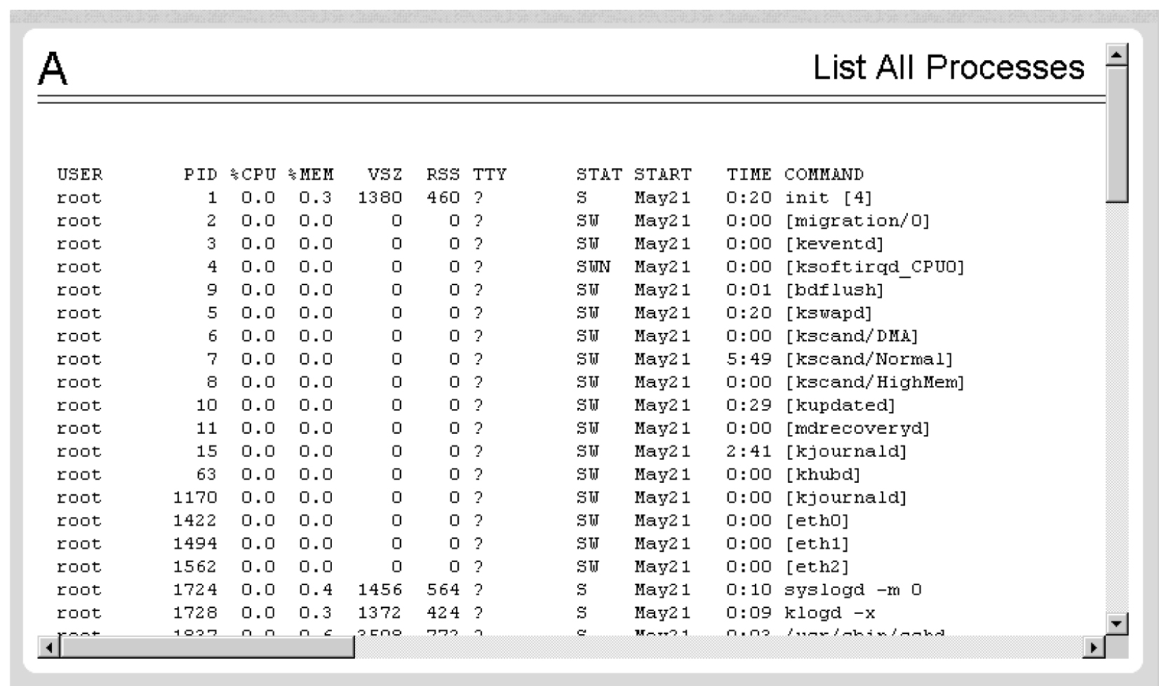

3.2.5.2 List All Processes
The Platform / List All Processes screen lists all processes running on the selected EPAP. The /usr/ucb/ps -auxw command generates this list. The operating system's manual page for the ps command thoroughly defines the output for this command. Figure 3-57 shows an example of the process list.
Figure 3-57 List All Processes Screen
img/c-platform-menu-epapgui-epapadmin-fig5.jpg
The process list shown here will not be the same on your EPAP servers. The output from this command is unique for each EPAP, depending on the EPAP software processes, the number of active EPAP user interface processes, and other operational conditions.

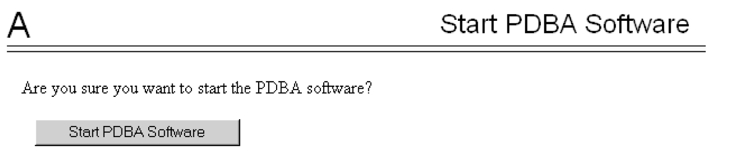

Start PDBA Software
The PDBA / Process Control / Start PDBA Software screen begins the execution of the PDBA software. When you click the Start PDBA Software button, the EPAP attempts to start the software. Starting the PDBA software from this menu item also clears the indicator that keeps the software from being automatically started on a reboot.
Figure 3-58 Start PDBA Software Screen
img/c-pdba-menu-epapgui-epapadmin-fig6.jpg
When you choose the Start PDBA Software screen, another screen requires to confirm your choice to start the PDBA software. Click the Start PDBA Software button.
Stop PDBA Software
The PDBA / Process Control / Stop PDBA Software screen stops the PDBA software.
The screen also has a checkbox that lets users specify whether PDBA is to be automatically restarted when the machine boots. If this checkbox is selected, the software can only be restarted via the Start PDBA menu.
The Stop PDBA Software button launches the successful stopping of the PDBA.

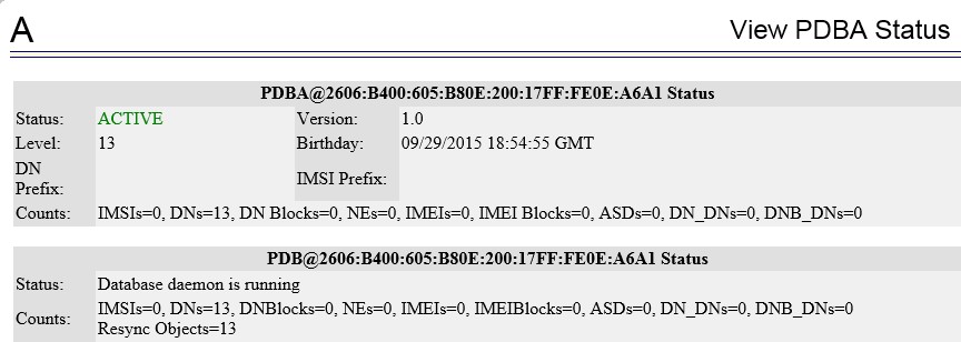

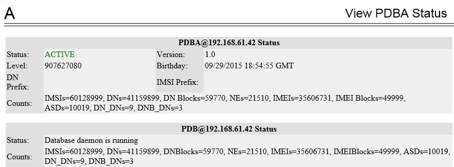

3.2.6.4 View PDBA Status
The PDBA / View PDBA Status screen is used to display the current status of the selected PDBA. The PDBA Status refresh time can be viewed and changed with this screen.
When the EPAP is configured in the dual stack configuration, the PDBA will also have both IPs. On the "View PDBA Status" screen, the PDBA IP will be in the IP version format with which the EPAP GUI is accessed. If the EPAP GUI is accessed using the IPv6 IP, then the PDBA IP will be displayed in the IPv6 format. If the EPAP GUI is accessed using the IPv4 IP, then the PDBA IP will be displayed in the IPv4 format.
See the rules for screen in Table 3-12.
Figure 3-59 View PDBA Status With IPv6 PDBA IP
img/c-view-pdba-status-ipv6.jpg
Figure 3-60 View PDBA Status With IPv4 PDBA IP
img/c-view-pdba-status-ipv4.jpg
Table 3-12 Rules for Viewing PDBA Status
Semantic Rules
Error Code
PDBA must respond within 15 seconds.
E1030

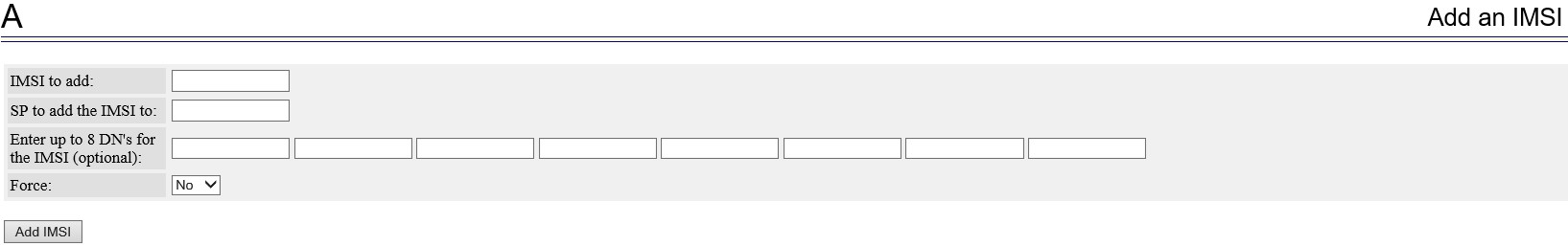

3.2.6.5.1 IMSI
The PDBA / Manage Data / menu is used to add, update, delete, and view subscriptions in the Provisioning Database (PDB).
The PDBA / Manage Data / IMSI menu provides these actions:
Add an IMSI
The PDBA / Manage Data / IMSI / Add an IMSI screen promptsthe user for the fields needed to add an IMSI to the Provisioning Database (PDB). If there is a conflicting subscription in the PDB, the user is prompted to confirm before overwriting the existing subscription.
There are limited numbers of digit combinations in the first 9 digits of DN/IMSI/IMEI. In DN/IMSI the first 9 digits consist of the Country Code, Area Code, Service Provider Code, and up to 2 digits of Subscriber number. The maximum number of 9digs is 65K entries, which includes two (2) default entries representing 5 digits and 6 digits, regardless if they are provisioned or not. If all provisioned DN/IMSIs have digits greater than or equal to 7, the max number of 9digs parsed from these provisioned DNs cannot exceed 65K - 2 entries.
Figure 3-61 Add an IMSI
img/epap-add-imsi.jpg
Table 3-13 describes the rules that the EPAP user interface uses to perform the Add IMSI action. The table also describes other messages generated by the EPAP user interface while performing this action.
Table 3-13 Rules for Add IMSI Screen
Syntax Rules
Error Code
The user must enter a valid SP.
E1002
The user must enter a valid IMSI.
E1002
The user must enter a valid DN.
E1002
Semantic Rules
Error Code
This menu option is valid only if the G-Flex feature is installed.
None
The SP must exist in the PDB.
E1014
The user may enter up to 8 DNs
None
The user may elect to force the transaction to be entered into the PDB, even if there are conflicting subscriptions.
None
The PDBI must return a success status.
E1017
PDBI command ent-sub, on the creation of a single IMSI with or without DNs, supports a response "PDBI_MAX_IMSI9DIG_LIMIT" if the to-be provisioned IMSI causes the first 9 digits go above its max limit of 65,000. E1066
PDBI command ent-sub, on the creation of one IMSI to 1-8 DNs, supports a response "PDBI_MAX_DN9DIG_LIMIT" if the to-be provisioned DN causes the first 9 digits go above its max limit of 65,000. E1068
Other Messages
Condition
Message Text
The new subscription already exists in the PDB.
This subscription conflicts with an existing subscription.
The new subscription was attempting to overwrite an existing IMSI.
IMSI <imsi> already exists in the PDB. If you choose to overwrite the existing subscription, all data associated with the existing IMSI will be lost. All DNs associated with the existing IMSI will be deleted.
The subscription was added.
Subscription successfully added.
The subscription was not added.
Subscription not added.

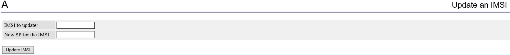

Update an IMSI
The PDBA / Manage Data / IMSI / Update IMSI screen prompts the user for the fields necessary to change the SP for an IMSI in the Provisioning Database (PDB).
Figure 3-62 Update an IMSI
img/epap-update-imsi.jpg
Table 3-14 describes the rules that the EPAP user interface uses to perform the Update IMSI action. The table also describes other messages generated by the EPAP user interface while performing this action.
Table 3-14 Rules for Update IMSI Screen
Syntax Rules
Error Code
E1002
E1002
Semantic Rules
Error Code
None
The IMSI must exist in the PDB.
E1015
E1014
E1017
Other Messages
Condition
Message Text
The subscription was modified.
Subscription successfully modified.
The subscription was not modified.
Subscription not modified.

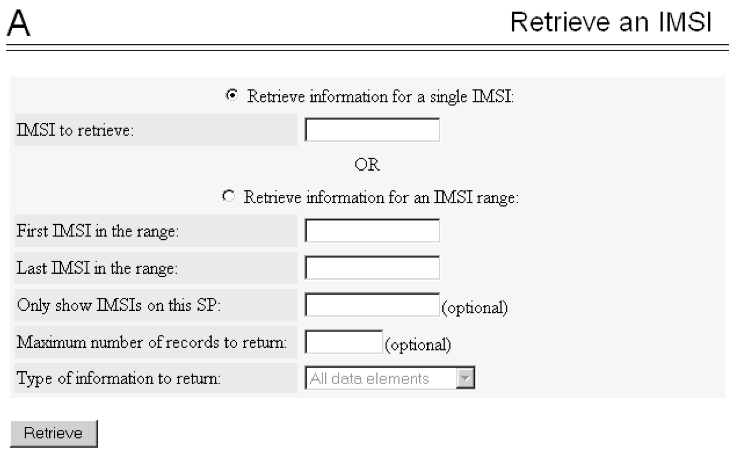

Retrieve an IMSI
The PDBA / Manage Data / IMSI / Retrieve an IMSI screen prompts you for the fields necessary to retrieve subscriptions from the Provisioning Database (PDB). If you specify the ‘last IMSI’, all subscriptions from the ‘first IMSI’ and ‘last IMSI’ are shown.
Figure 3-63 shows a sample output form the Retrieve IMSI menu action. The choices for the drop down menu for the Display field are: All data elements, Network entries only, and Record counts only.
Figure 3-63 Retrieve IMSI Screen
img/c-pdba-menu-epapgui-epapadmin-fig18.jpg

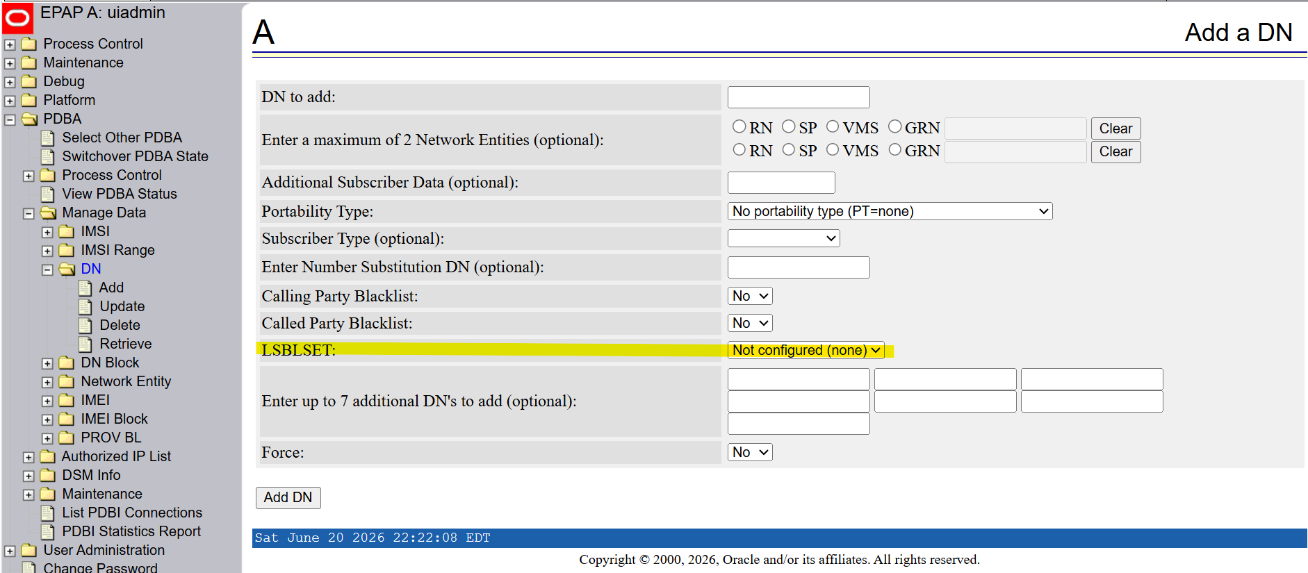

Add a DN
The PDBA / Manage Data / DN / Add a DN screen prompts you for the fields needed to add a DN to the Provisioning Database (PDB). If there is a conflicting subscription in the PDB, you are prompted to confirm before overwriting the existing subscription.
It is not recommended to provision more than 60 millions of Number Substitute of DN (NSDN). Higher NSDN data causes a failure in the RTDB reload from the PDB.
See Figure 3-64 for an example of the Add a DN screen.
Figure 3-64 Add a DN Screen
img/epap-add-dn.jpg
Table 3-20 describes the rules that the EPAP user interface uses to perform the Add DN action. The table also describes other messages generated by the EPAP user interface while performing this action.
Table 3-20 Rules for Add DN Screen
Syntax Rules
Error Code
E1002
E1002
E1002
Semantic Rules
Error Code
The user may enter a portability type only if an SP was not specified.
None
E1014
The RN must exist in the PDB.
E1014
None
None
E1017
E1068
PDBI command ent-sub, on the creation of one or more DNs on the same NE with no IMSI, supports a response "PDBI_MAX_IMSI9DIG_LIMIT" if the to-be provisioned DN causes the first 9 digits go above its max limit of 65,000.

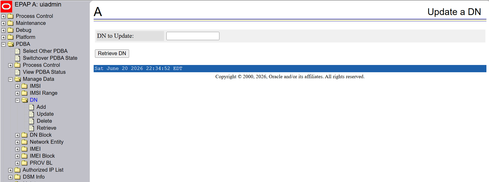

Update a DN
The PDBA / Manage Data / DN / Update a DN screen prompts you for the fields necessary to change the SP or RN for an DN in the Provisioning Database (PDB). See Figure 3-65 for an example of the Update a DN menu.
Figure 3-65 Update a DN Screen
img/update-dn-epapadmin.png
Table 3-21 describes the rules that the EPAP user interface uses to perform the Update DN action. The table also describes other messages generated by the EPAP user interface while performing this action.
Table 3-21 Rules for Update a DN Screen

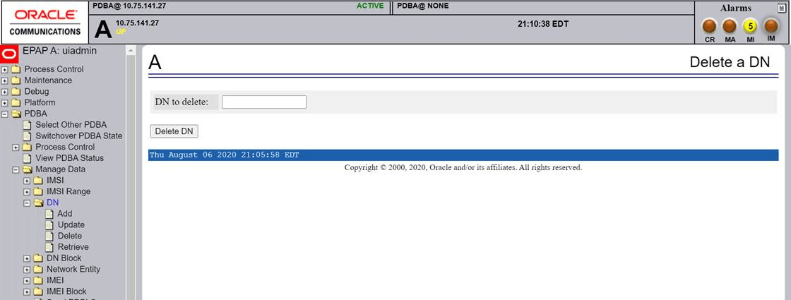

Delete a DN
Figure 3-66 Delete a DN Screen
Delete a DN Screen
The PDBA / Manage Data / DN / Delete a DN screen prompts the user for the fields necessary to remove a DN from the Provisioning Database (PDB).
Table 3-22 describes the rules that the EPAP user interface uses to perform the Delete DN action. The table also describes other messages generated by the EPAP user interface while performing this action.
Table 3-22 Rules for Delete DN Screen

Retrieve a DN
The PDBA / Manage Data / DN / Retrieve a DN screen prompts you for the fields necessary to retrieve subscriptions from the Provisioning Database (PDB) by DN.
Figure 3-67 Retrieve a DN
img/epap-retrieve-dn.jpg
Table 3-23 describes the rules that the EPAP user interface uses to perform the Retrieve DN action. The table also describes other messages generated by the EPAP user interface while performing this action.
Table 3-23 Rules for Retrieve DN Screen
Syntax Rules
Error Code
E1002
E1002
The user must enter a valid RN.
E1002
Semantic Rules
Error Code
The user may enter a range of DNs.
None
The user may only enter an SP if G-Flex or G-Port is installed.
None
The user may only enter an RN if G-Port or INP is installed.
None
The type of output data to return may only be entered if a DN range is requested.

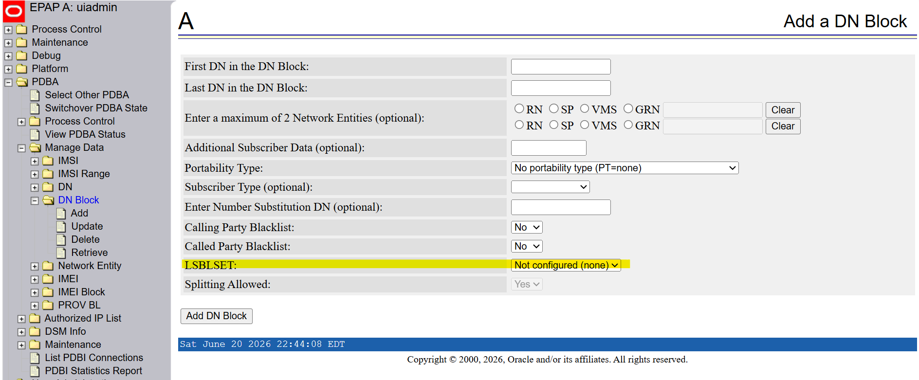

3.2.6.5.4 DN Block
The PDBA / Manage Data / DNBlock menu lets you add, update, delete, and view DN Blocks in the Provisioning Database (PDB). A ‘dialed number’ can refer to any mobile or wireline subscriber number, and can include MSISDN, MDN, MIN, or the wireline Dialed Number. A DN Block is a grouping of DN numbers that is treated as a continuous sequence of DNs.
The PDBA / Manage Data / DN Block menu provides these actions:
Add a DN Block
The PDBA / Manage Data / DNBlock / Add a DN Block screen prompts you for the fields needed to add a DN block to the Provisioning Database (PDB). If there is a conflicting subscription in the PDB, you are prompted to confirm before overwriting the existing subscription.
Figure 3-68 Add a DN Block
img/epap-add-dn-block.jpg
Table 3-24 describes the rules that the EPAP user interface uses to perform the Add DN Block action. The table also describes other messages generated by the EPAP user interface while performing this action.
Table 3-24 Rules for Add DN Block Screen
Syntax Rules
Error Code
E1002
E1002
E1002
Semantic Rules
Error Code
This menu option is valid only if the G-Port or INP feature is installed.
None
E1014
E1014
The user may enter a portability type only if a SP was not specified.
None
None
E1017
Other Messages
Condition
Message Text
DN block <start DN-end DN> already exists in the PDB. If you choose to overwrite the existing subscription, all data associated with the existing DN block will be lost
The new subscription was attempting to overwrite an existing DN block.

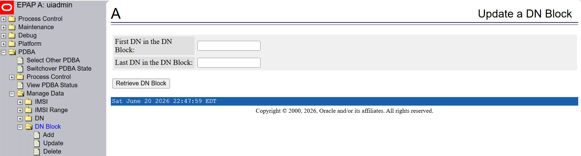

Update a DN Block
The PDBA / Manage Data / DNBlock / Update a DN Block screen prompts you for the fields necessary to change the SP or RN for an DN block in the Provisioning Database (PDB).
Figure 3-69 Update a DN Block Screen
img/update-dn-block.jpg
Table 3-25 describes the rules that the EPAP user interface uses to perform the Update DN Block action. The table also describes other messages generated by the EPAP user interface while performing this action.
Table 3-25 Rules for Update a DN Block Screen
Syntax Rules
Error Code
E1002
E1002
E1002
Semantic Rules
Error Code
None
E1014
E1022
The DN block must exist in the PDB.
E1016
The DN may not be already associated with an IMSI.
E1018
The user my enter a portability type only if an RN is specified.
None
E1017
Other Messages
Condition
Message Text

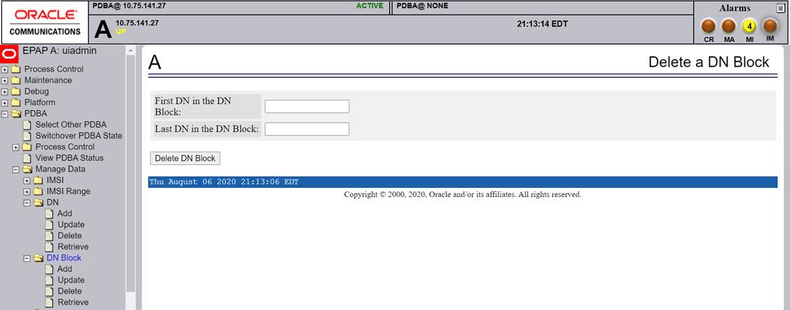

Delete a DN Block
Figure 3-70 Delete a DN Block Screen
Delete a DN Block
The PDBA / Manage Data / DNBlock / Delete a DN Block screen prompts the user for the fields necessary to remove a DN block from the Provisioning Database (PDB).
Table 3-26 describes the rules that the EPAP user interface uses to perform the Delete DN Block action. The table also describes other messages generated by the EPAP user interface while performing this action.
Table 3-26 Rules for Delete DN Block Screen
Syntax Rules
Error Code
E1002
Semantic Rules
Error Code
The menu option is valid only if the G-Port or INP feature is installed.
None
The subscription must exist in the PDB.
E1012
E1017

Retrieve DN Blocks
Figure 3-71 Retrieve a DN Block Screen
Retrieve a DN Block
The PDBA / Manage Data / DNBlock / Retrieve DN Blocks screen prompts you for the fields necessary to retrieve subscriptions from the Provisioning Database (PDB) by DN. You must specify a block of DNs.
Table 3-27 describes the rules that the EPAP user interface uses to perform the Retrieve DN Block action. The table also describes other messages generated by the EPAP user interface while performing this action.
Table 3-27 Rules for Retrieve DN Block Screen
Syntax Rules
Error Code
E1002
E1002
E1002
Semantic Rules
Error Code
None
None
None
The type of output data to return may be entered only if a DN range is requested.
None
The maximum number of records to return may be entered only if a DN range is entered.
None
E1017
Other Messages
Condition
Message Text
No records were found.
Query returned no subscriptions.

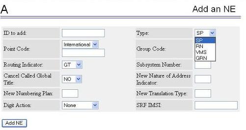

Figure 3-72 Add an NE Example
img/c-new-feat-epap-9-5-12.jpg
Table 3-28 describes the rules that the EPAP user interface uses to perform the Add Network Entity action. The table also describes other messages generated by the EPAP user interface while performing this action.
Table 3-28 Rules for Add Network Entity Screen
Syntax Rules
Error Code
The user must enter a valid entity ID.
E1002
The user must enter a valid PC (point code).
E1002
The user must enter a valid SSN.
E1002
Semantic Rules
Error Code
For RNs, entering a point code is optional.
None
If no point code is entered, no optional parameters can be specified.
None
Only one of the 3 point code types may be entered.
None
If the routing indicator is GT, Cancel Called Global Title must be set to NO.
None
If the routing indicator is GT, a digit action may be specified.
None
E1017

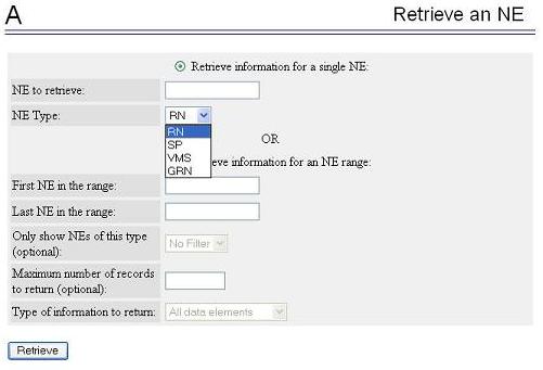

Retrieve Network Entity
The PDBA / Manage Data / Network Entity / Retrieve Network Entity screen prompts you for the fields necessary to retrieve a Network Entity from the Provisioning Database (PDB).
Figure 3-73 Retrieve an NE Example
img/c-new-feat-epap-9-5-15.jpg
Table 3-31 describes the rules that the EPAP user interface uses to perform the Retrieve Network Entity action. The table also describes other messages generated by the EPAP user interface while performing this action.
Table 3-31 Rules for Retrieve Network Entity Screen
Syntax Rules
Error Code
E1002
Semantic Rules
Error Code
The type of output data to return may be entered only if a range of Network Entities is requested.
None
The maximum number of records to return may be entered only if a range of Network Entities is requested.
None
E1017
Other Messages
Condition
Message Text
Query returned no network entities.

The PDBA / Manage Data / IMEI menu is used to add, update, delete, and view individual IMEI entries in the Provisioning Database (PDB).
The PDBA / Manage Data / IMEI menu provides these actions:

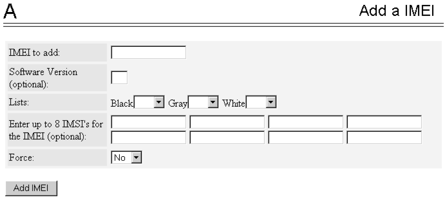

Add an IMEI
The PDBA / Manage Data / IMEI / Add an IMEI screen is used to create new IMEI entries in the Provisioning Database (PDB). The following functions are performed from this screen:
  • Add a new IMEI, its associated List Types (WL,GL,BL), SVN, and 0 to 400 IMSIs. An IMEI and at least one List Type must be specified.
  • Overwrite an existing IMEI. The IMEI and any other parameters and Force must be specified.
  • Add a new IMSI to an existing IMEI. Existing IMEI and IMSI must be specified.
The SVN is an optional field. If no value is entered the default is 0. See Figure 3-74 for an example of the Add a IMEI screen.
Figure 3-74 Add an IMEI Screen
img/c-pdba-menu-epapgui-epapadmin-fig40.jpg
There are limited numbers of digit combinations in the first 9 digits of DN/IMSI/IMEI. In IMEI, the first 9 digits are Type Allocation Code (TAC), which must not exceed 250,000 combinations.
Table 3-33 describes the rules that the EPAP user interface uses to perform the Add IMSI action. The table also describes other messages generated by the EPAP user interface while performing this action.
Table 3-33 Rules for Add IMSI Screen
Syntax Rules
Error Code
E1002
E1002
E1002
Semantic Rules
Error Code
None
E1014
None
None
E1017
"PDBI_MAX_IMEI9DIG_LIMIT" if to-be provisioned IMEI causes the first 9 digits to go above its max limit of 250,000. E1067
Other Messages
Condition
Message Text
Update an IMEI
The PDBA / Manage Data / IMEI / Update IMEI screen is used to update/modify individual IMEI entries in the PDB. The following functions are performed from this screen:
  • Update an IMEI with its associated List Types (WL,GL,BL). An IMEI and at least one List Type must be specified. At least one List Type must be set to yes. Unless specified, the List types will not change.
  • Overwrite an existing SVN. An IMEI and SVN must be specified.
IMSIs cannot be updated with this screen. ENT_EIR and DLT_EIR are used to define IMSIs. To change the List Types, use the yes/no options for the various lists.

Retrieve an IMEI
The PDBA / Manage Data / IMEI / Retrieve is used to retrieve IMEI data from the Provisioning Database (PDB). The following functions are performed from this screen:
  • Retrieve an IMEI and its associated List Types (WL,GL,BL), SVN, and 0 to 400 IMSIs. The IMEI must be specified. Once IMSIs are added as part of the add IMEI option, the user will be allowed to add up to 400 IMSIs per IMEI using PDBI commands or import scripts, with no more than 8 IMSIs to be added per command.
  • Retrieve a range (1 through 10,000) of IMEIs that match either filter:
    • Have a specific List Type set to YES.
    • Have an IMSI that matches the requested IMSI.
  • Retrieve the beginning and ending IMEI. At least one optional filter type must be specified.
See Figure 3-75 for an example of the Retrieve a IMEI screen.

Add an IMEI Block
The PDBA / Manage Data / IMEI / Add an IMEI Block screen is used to create new IMEI entries in the Provisioning Database (PDB). This screen is used to add a new IMEI block with its associated List Types (WL,GL,BL). The First IMEI, Last IMEI, and at least one List Type must be specified.
Table 3-36 describes the rules that the EPAP user interface uses to perform the Add IMSI action. The table also describes other messages generated by the EPAP user interface while performing this action.
Table 3-36 Rules for Add IMSI Screen
Syntax Rules
Error Code
E1002
E1002
E1002
Semantic Rules
Error Code
None
E1014
None
None
E1017
Other Messages
Condition
Message Text

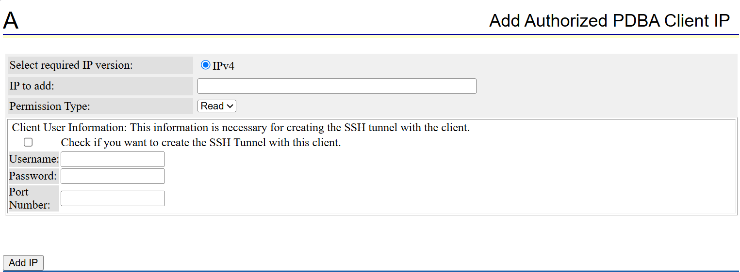

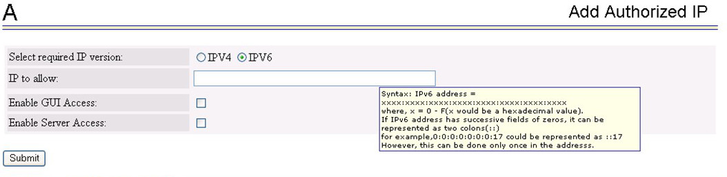

Add Authorized IP
The PDBA / Authorized IP List / Add Authorized PDBA Client IP screen allows you to:
  • Add an IP address to the list of authorized IP addresses
  • Specify a Permission Type of Read or Write for that IP address
  • Decide if an SSH (secure shell) tunnel should be created between that IP address and the EPAP
  • Specify a username, password, and port number to use on the machine represented by the IP address
Figure 3-76 Add Authorized PDBA Client IP
img/c-epap-authorized-pdba-client-ip.jpg
Table 3-39 describes the rules that the EPAP user interface uses to perform the Add Authorized PDBA Client IP action. The table also describes other messages generated by the EPAP user interface while performing this action.
Table 3-39 Rules for Add Authorized PDBA Client IP
Syntax Rule Error Code
The user must enter a valid IP address. E1002
Messages
Condition Message Text
An IP address with read-only access was added. IP address xxx.xxx.xxx.xxx is authorized for READ access.
An IP address with read-write access was added. IP address xxx.xxx.xxx.xxx is authorized for READ/WRITE access.

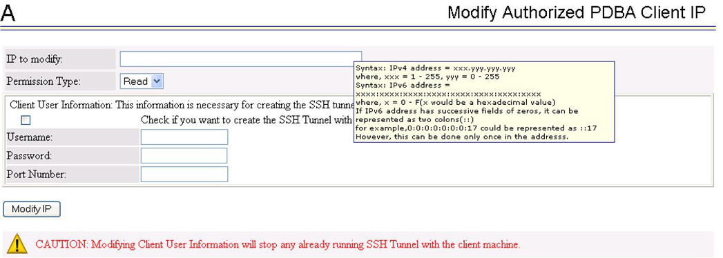

The PDBA / Authorized IP List / Modify Authorized PDBA Client IP screen allows you to:
  • Change the Permission Type of an authorized PDBA client IP address
  • Decide to change SSH tunnel status
  • Change username, password, and port number
Figure 3-77 Modify Authorized PDBA Client IP
img/c-epap-modify-authorized-pdba-client-ip.jpg
Table 3-40 describes the rules that the EPAP user interface uses to perform the Add Authorized PDBA Client IP action. The table also describes other messages generated by the EPAP user interface while performing this action.
Table 3-40 Rules for Add Authorized PDBA Client IP
Syntax Rule
Error Code
E1002
Other Messages
Condition
Message Text
To modify an authorized PDBA client IP address:
  1. Enter an IP address in the IP to modify field
  2. Select a Permission Type
  3. Make a selection for the Client User Information checkbox
  4. Enter username, password, or port number
  5. Click the Modify IP button
When the modification of the IP address is accepted, you see the message indicating a successful acceptance of the altered permission type.

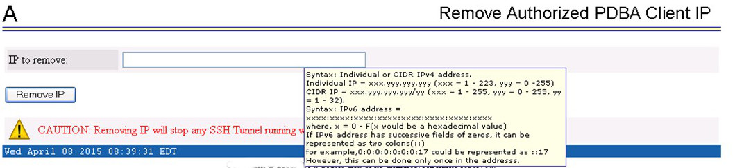

Remove Authorized IP
The PDBA / Authorized IP List / Remove Authorized PDBA Client IP screen allows you remove an IP address from the list of authorized addresses. A CAUTION message informs you that removing an IP will stop any SSH tunnel that is currently connected with that IP.
Figure 3-78 Remove Authorized PDBA Client IP
img/c-epap-remove-authorized-pdba-client-ip.jpg
Table 3-42 describes the rules that the EPAP user interface uses to perform the Add Authorized PDBA Client IP action. The table also describes other messages generated by the EPAP user interface while performing this action.
Table 3-42 Rules for Add Authorized PDBA Client IP
Syntax Rule
Error Code
E1002
Other Messages
Condition
Message Text
To remove an authorized PDBA client IP address, enter the desired IP address in the IP to remove: field, and click the Remove IP button.
When the removal of the IP address is accepted, a message appears indicating a successful completion of the action.

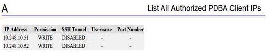

List All Authorized IPs
The PDBA / Authorized IP List / List All Authorized PDBA Client IPs screen allows you display all authorized IP addresses.
Figure 3-79 List All Authorized PDBA Client IPs Screen
img/epapadmin-listclientips.jpg
Table 3-44 describes the rules that the EPAP user interface uses to perform the List All Authorized PDBA Client IPs action. The table also describes other messages generated by the EPAP user interface while performing this action.
Table 3-44 Rules for List All Authorized PDBA Client IPs Screen
Other Messages
Condition
Message Text
The list of authorized IP addresses is empty.
There are no authorized IP addresses.

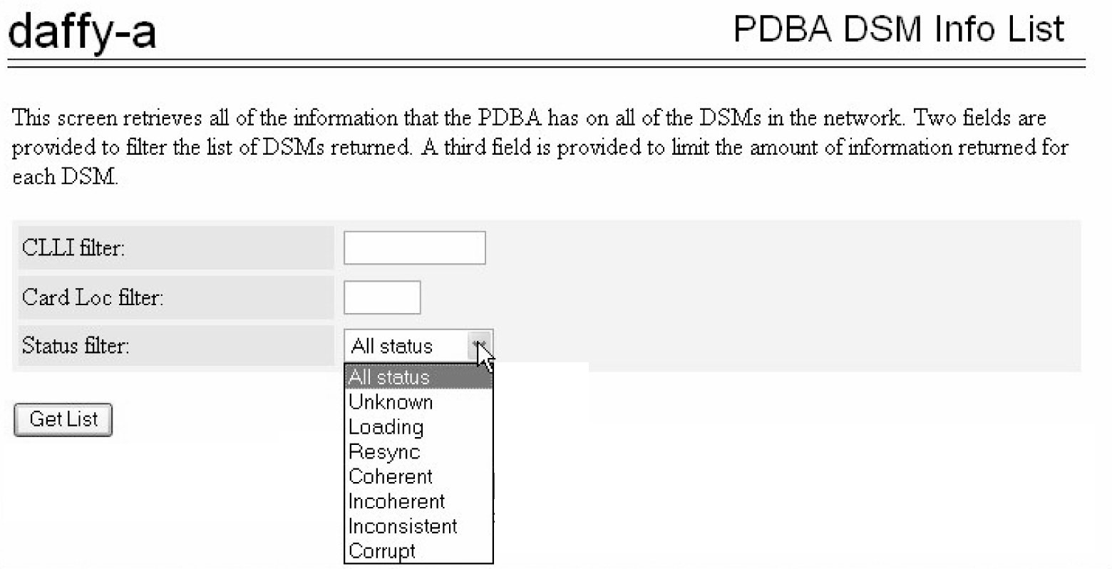

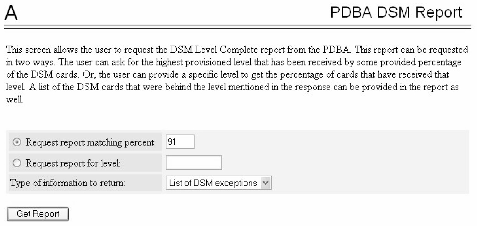

PDBA DSM Report
The PDBA / DSM Info / PDBA DSM Report screen is used request the DSM Level complete report from the PDBA. This report can be requested in two ways. The user can ask for the highest provisioned level that has been received by some provided percentage of the Service Module cards. Or the user can provide a specific level to get the percentage of cards that have received that level. A list of the Service Module cards that were behind the level mentioned in the response can be provided in the report as well. See Figure 3-80 for the PDBA DSM Report screen.
Figure 3-80 PDBA DSM Report Screen
img/c-pdba-menu-epapgui-epapadmin-fig68.jpg
PDBA DSM List
Table 3-45 describes the rules that the EPAP user interface uses to perform the Add Authorized PDBA Client IP action. The table also describes other messages generated by the EPAP user interface while performing this action.
Table 3-45 Rules for Add Authorized PDBA Client IP
Syntax Rules
Error Code
E1002
Other Messages
Condition
Message Text
An address with read-only access was added.
An address with read-write access was added.
This screen retrieves all of the information that the PDBA has on all of the Service Module cards in the network. Two fields are provided to filter the list of Service Module cards returned. A third field is provided to limit the amount of information returned for each Service Module card. Refer to Figure 3-81 for an example of the PDBA DSM Info List.
Figure 3-81 PDBA DSM Info List Screen (with Status filter pulldown)

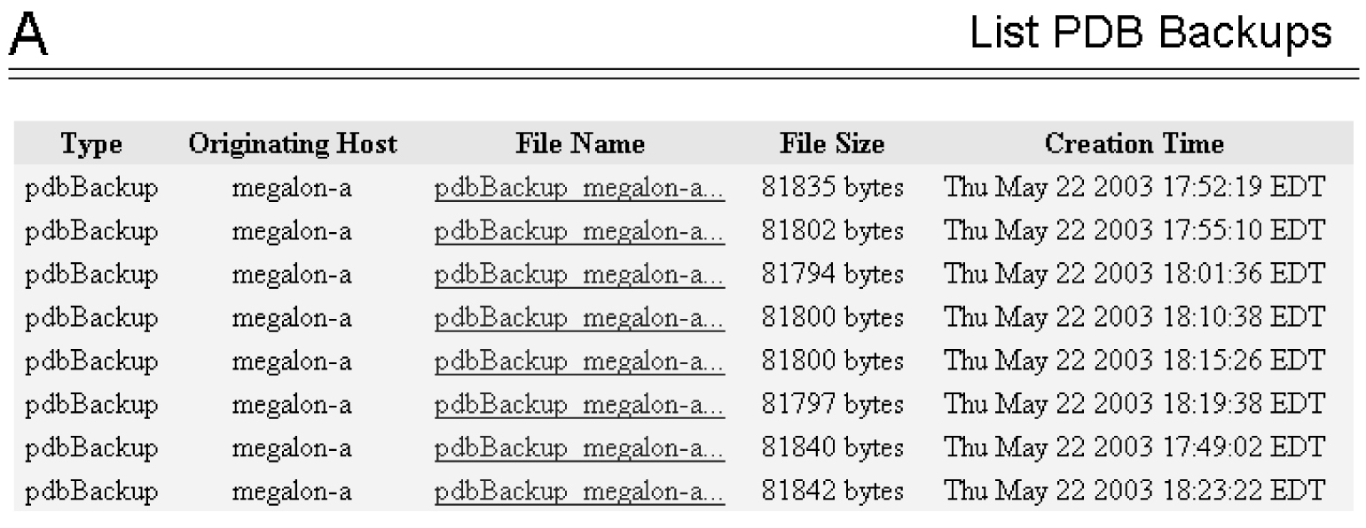

List Backups
The PDBA / Maintenance / Backup / List PDB Backups screen lists the details of the backup. See Figure 3-82 for an example of the List PDB Backups screen.

View Command Log
The PDBA / Maintenance / Logs / View Command Log menu selection lets you view the current PDBA Command Log. To view historic PDBA command logs, use the View Any File action. Refer to View Any File.
Table 3-49 describes the rules that the EPAP user interface uses to perform the View PDBA Command Log action.
Table 3-49 Rules for View PDBA Command Log
Semantic Rules
Error Code
The log file must exist.
E1008
View Debug Log
The PDBA / Maintenance / Logs / View PDBA Debug Log menu selection lets you view the current PDBA Debug Log. To be able to see historic PDBA Debug logs, you must use the View Any File action. Refer to View Any File.
Table 3-50 describes the rules that the EPAP user interface uses to perform the View PDBA Debug Log action.
Table 3-50 Rules for View PDBA Debug Log
Semantic Rules
Error Code
E1008
View Error Log
The PDBA / Maintenance / Logs / View PDBA Error Log menu selection lets you view the current PDBA Error Log. To be able to see historic PDBA Error logs, you must use the View Any File action. Refer to View Any File.
Table 3-51 describes the rules that the EPAP user interface uses to perform the View PDBA Error Log action.
Table 3-51 Rules for View PDBA Error Log
Semantic Rules
Error Code
E1008

3.2.6.8.7 PDBA / Maintenance / Schedule PDB Export
This screen is used for the the Automatic/Schedule Export Mode. This screen is used to automatically export PDB data to a file that is then available to a client SFTP. This screen allows the user to export a single object type rather than the complete database. By default, all object types are exported. Through this screen the customer has a choice of what data to be exported as well as the day and time of day the data is exported.
The export can be scheduled at a specific time for each of the following repeat periods: every N number of days (N can be up to 365) on specific days of the week, on a specified day of the month, or on a specified day of the year. The schedule export screen is used to display any existing PDB support tasks and to create a task by specifying the data type, the export format (PDBI or CSV), the export mode (blocking, snapshot, or real-time) as well as the time and repeat period. In addition, a Comment field is available to describe the task.
Figure 3-83 Schedule PDB Export Example
img/c-schedexport-maintenance-pdba-menu-epapgui-epapadmin-fig1.jpg
Existing PDB Export Tasks
The Existing PDB Export Tasks portion at the top of the screen displays all currently scheduled exports in table format. Clicking on a column heading causes the entries in that column to be sorted, either alphabetically or numerically, depending on whether the column entries start with a letter or a number. Clicking the column again sorts the entries in the opposite order.
Clicking on a row causes the data contained in that task to be displayed in the data entry fields below the table, for viewing, modification, or deletion.
Export Format, Data Type, and Export Mode
For more information about the Export Format, Data Type, and Export Mode choices, refer to Provisioning Database Interface User's Guide.
Scheduling Options
The Scheduling Options section of the Schedule PDB Export screen allows the user to choose how often to repeat the scheduled export and to specify the exact day and time. The appearance of this section changes depending on which Repeat Period radio button is selected:
The following fields are the same among the various Repeat Period selections (for more information about fields that differ depending on the Repeat Period selected, see Variable Fields in Scheduling Options):
Repeat period:
Select the values for the hour and minute to start the scheduled export from the two drop-down boxes at the right of the Scheduling Options section. The hour drop-down uses a 24-hour clock. For example, if you want the export to start at 10:30 PM, select 22 from the left drop-down box and select 30 from the right drop-down box.
Comment:
Use this optional field to add comments about this export. The content of this field is stored and displayed on the GUI, but it is not used otherwise.
Daily Repeat Period
To schedule an export to be run every N days, select the Daily radio button, specify a number (N) to indicate that the export should be run every N days, select the time, and optionally enter a comment.
Although the maximum value allowed in the day(s) field is 365, if an export is desired to run once a year, it is recommended to use the yearly repeat period so that leap years are properly treated (see Yearly Repeat Period).
To schedule an export to be run each week, select the Weekly radio button, select one or more days of the week, select the time, and optionally enter a comment.
To schedule an export to be run one day each month, select the Monthly radio button, select a numeric day of the month, select the time, and optionally enter a comment.
For months that do not contain the number of days specified in the Day field, the export will run on the first day of the following month. (For example, if the Day field value is 29, the export will run on March 1 rather in February for any year that is not a leap year.)
To schedule an export to be run one day each year, select the Yearly radio button, select a numeric day of the year, select the time, and optionally enter a comment.
The Add, Modify, and Delete buttons are located at the bottom of the Schedule PDB Export screen.
Add
To add a scheduled PDB export, enter all the data to describe the export, and click the Add button.
Modify
To modify a scheduled PDB export, click that export task in the Existing PDB Export Tasks table, change any data that describes the export, and click the Modify button.
The Modify button is selectable only when an entry in the Existing PDB Export Tasks table at the top of the screen has been selected and one or more fields on the screen has been changed.
Delete
To delete a scheduled PDB export, click that export in the Existing PDB Export Tasks table, and click the Delete button.
The Delete button is selectable only when an entry in the Existing PDB Export Tasks table at the top of the screen has been selected.

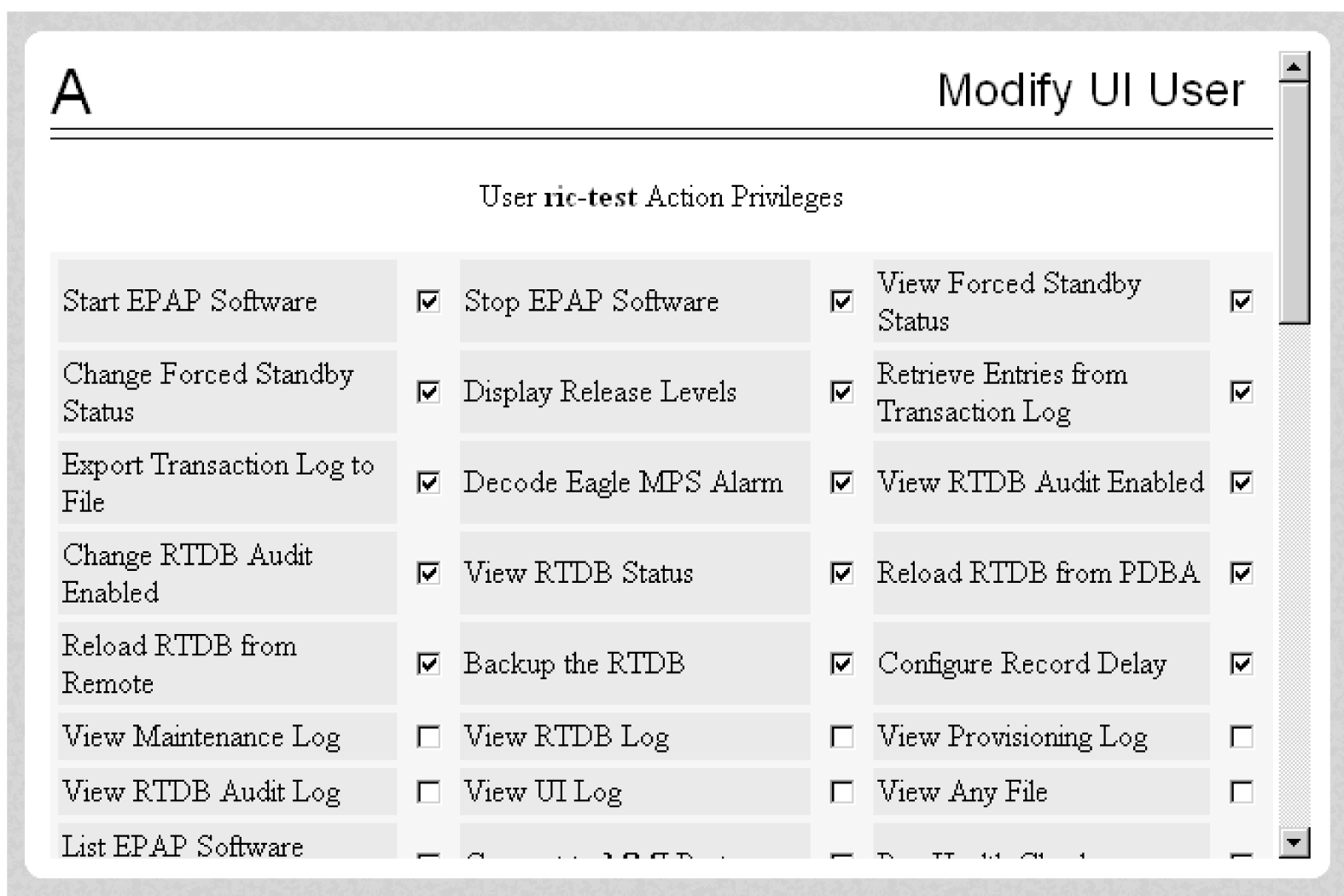

The User Administration / Users / Modify UI User screen is used to change a user permission profile. The administrator must first select a user name from the list of current users.
After selecting a User Name, the user permissions screen appears. In this screen, the permissions allowed to the user can viewed and specified.
You can directly specify the number of concurrent log-ins, an inactivity time limit, and a password age limit. In addition, you can modify group membership data and specific actions that the user is permitted.
After modifying any entries, click the Submit Profile Changes button. The Modify Group Membership screen appears, allowing the user to customize individual access to groups. Click Sumbit Group Membership Changes when finished. A confirmation screen will appear.
Clicking the Modify Specific Actions button displays Action Privileges to specify for the user being modified. See Figure 3-84.
Figure 3-84 Modify UI User’s Specific Actions
img/c-user-administration-menu-epapgui-epapadmin-fig10.jpg
This screen contains many selections from which to choose. After customizing the settings, click the Submit Specific Action Changes at the bottom of the screen.
The bottom of the Modify UI User’s Special Actions screen contains these explanatory notes:
  • A - Permission for this action has been explicitly added for this user.
  • R - Permission for this action has been explicitly removed for this user.
These notes indicate the privileges specifically added or removed for an individual user from the groups to which he/she is a member. This allows discrete refinement of user privileges even though he/she may be a member of groups.The system will generate a confirmation of the change for the user.
