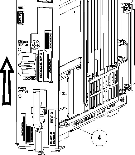

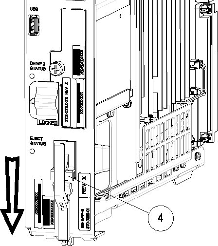

  1. On the E5-APP-B/APPD card, slide the Ejector switch (4) up to the UNLOCKED position (see Figure 5-1).
    Caution:
    When the Ejector switch goes from locked to unlocked and the E5-APP-B card is in service, the card will halt.
    Figure 5-1 E5-APP-B Card Eject Hardware Switch, UNLOCKED
  2. WAIT for the E5-APP-B/APPD Eject Status LED to go from blinking red to a steady red.
    When the Eject Status LED is steady red, the E5-APP-B/APPD card is in shutdown state.
    If the Ejector switch is put into the LOCKED position now, the E5-APP-B/APPD card will reboot.

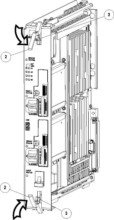

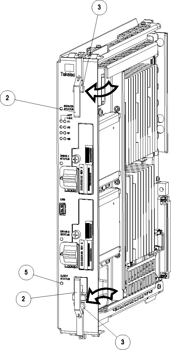

  3. Grasp the upper and lower card Inject/Eject (I/E) lever release (3) just underneath the I/E lever, and press it to meet the I/E lever. This is the mechanical interlock for the card.
    See Figure 5-2
    Figure 5-2 E5-APP-B Card UNLOCKED
  4. While holding the I/E interlock and lever, pull the levers (2) away from the shelf until they are parallel to the floor.
  5. Remove the E5-APP-B/APPD card from the EAGLE shelf.

  1. While holding the I/E interlock and lever, pull the levers (2) away from the card until they are parallel to the floor.
    Figure 5-3 illustrates the angle of the interlocks and levers just before inserting E5-APP-B Card into the EAGLE shelf.
    Figure 5-3 E5-APP-B Card UNLOCKED

  4. Slide the E5-APP-B Ejector switch (4) down to the LOCKED position (see Figure 5-5).
    When the Ejector switch goes from UNLOCKED to LOCKED, the E5-APP-B Eject Status LED blinks red as the E5-MASP card goes online.
    Figure 5-5 E5-APP-B Card Inject Hardware Switch, LOCKED
  5. WAIT for the E5-APP-B Eject Status LED to go from blinking red to off.

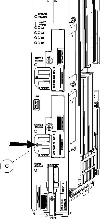

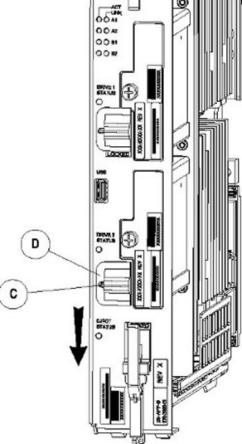

  1. Verify that the drive module is locked in position and in use.
    The switch lock release (C) is in the LOCKED position and the Status LED on the E5-APP-B card is OFF.
    Move the switch lock release (C) to the "released" position by pressing in the direction indicated. Refer to Figure 5-6.
    Figure 5-6 Drive Module Released

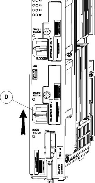

  2. Move drive module locking switch (D) from the LOCKED to the unlocked position and wait for the LED (B) to indicate a steady red state. See Figure 5-7 and Figure 5-8, respectively.
    When drive module locking switch (D) is transitioned from locked to unlocked, the LED will flash red to indicate the drive is unlocked and in process of shutting down.
    Figure 5-7 Drive Module UNLOCKED
    Caution:
    Removal of the drive prior to the LED indicating steady red could result in drive corruption.

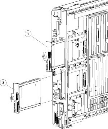

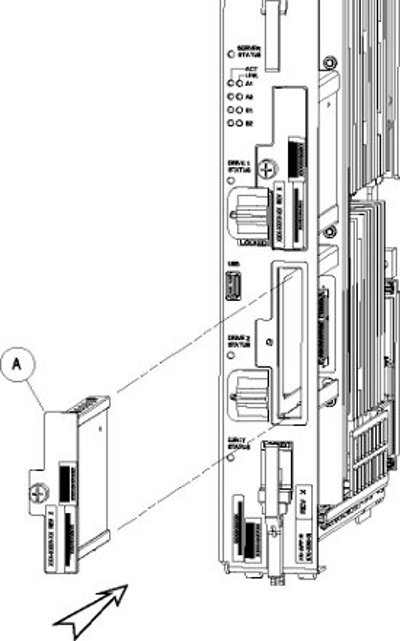

  1. Slide a new drive(s) module into the drive slot on the card (see Figure 5-10).
    Figure 5-10 Drive Module Replacement
  2. Gently push the drive (A) in slowly until it is properly seated.

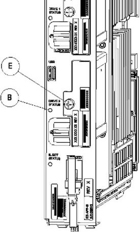

  3. Tighten the mounting screw until the Drive Status LED is in a steady red state ((B), from Figure 5-8).
  4. Move the drive module locking switch (D) from the unlocked to the LOCKED position.
    When drive module locking switch (D) is transitioned from unlocked to locked, the LED will flash red to indicate the drive is locked and in process of coming online (see Figure 5-11).

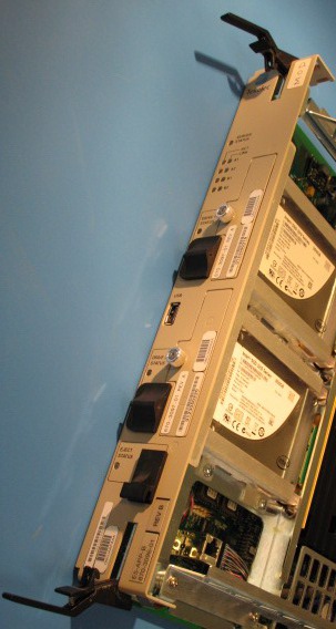

5.6 Increasing Data Capacity with 480G Drive Modules
If 300G drive modules were in use when EPAP was installed, EPAP must be re-installed to take advantage of the additional storage capacity available on 480G drive modules.
Procedure - Increase Data Capacity with 480G Drive Modules
  1. Backup the data and configurations of the existing setup.
    Perform the following procedures for data backup and configurations:
    • Pre Full Upgrade Steps
      1. SETTING UP PRE-FULL UPGRADE ENVIRONMENT
      2. CAPTURING CURRENT CONFIGURATIONS
      3. CAPTURING CURRENT CONFIGURATIONS ON STANDALONE EPAP
      4. PRE-FULL UPGRADE CHECK
    • Data Backup before Full Upgrade
      1. SHUTTING DOWN THE PDBA AND EPAP
      2. DISABLE EPAP VIP AND DEACTIVATE PDBA PROXY FEATURE
      3. STOP ACTIVE PDBA AND VERIFY PDBA REPLICATION STATUS
      4. DISCONNECT REMOTE PDBA
      5. BACKUP EUIDB DATABASE
      6. BACKUP PDB
      7. BACKUP RTDB DATABASE
      8. STOP MYSQL SERVICE
      9. TRANSFER DATABASES TO MATE AND REMOTE
    For detailed configurations of these procedures, refer 3.2 Pre Full Upgrade Steps and 3.3 Data Backup before Full Upgrade in Full Upgrade Guide.
  2. If you have not already replaced both 300G drive modules with 480G drive modules, remove the 300G drive modules from the E5-APP-B card.
  3. If you have not already replaced both 300G drive modules with 480G drive modules, insert the new 480G drive modules.
    See steps 1 through 4 in Replacing a Drive Module Assembly.
