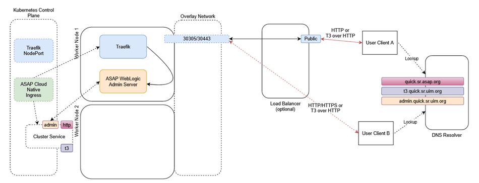

Connectivity Between the Building Blocks
The following diagram illustrates the connectivity between the building blocks in an ASAP cloud native environment using an example:
Figure 9-1 Connectivity Between Building Blocks in ASAP Cloud Native Environment
Description of Figure 9-1 follows
Description of "Figure 9-1 Connectivity Between Building Blocks in ASAP Cloud Native Environment"
Invoking the ASAP cloud native Helm chart creates a new ASAP instance. In the above illustration, the name of the instance is "quick" and the name of the project is "sr". The instance consists of an ASAP pod and a Kubernetes service.
The Cluster Service contains endpoints for both HTTP and T3 traffic. The instance creation script creates the ASAP cloud native Ingress object. The Ingress object has metadata to trigger the Traefik ingress controller as a sample. Traefik responds by creating new front-ends with the configured "hostnames" for the cluster (quick.sr.asap.org and t3.quick.sr.uim.org in the illustration). The IngressRoute connects the hostname to the service exposed on the pod. The service is created on the ASAP WebLogic admin server port.
The prior installation of Traefik has already exposed Traefik itself using the selected port number on each worker node.
Inbound HTTP Requests
An ASAP instance is exposed outside of the Kubernetes cluster for HTTP access via an Ingress Controller and potentially a Load Balancer.
Because the Traefik port is common to all ASAP cloud native instances in the cluster, Traefik must be able to distinguish between the incoming messages headed for different instances. It does this by differentiating on the basis of the "hostname" mentioned in the HTTP messages. This means that a client (User Client B in the illustration) must believe it is talking to the "host" dev2.mobilecom.asap.org when it sends HTTP messages to Traefik port on the access IP. This might be the Master node IP, or IP address of one of the worker nodes, depending on your cluster setup. The "DNS Resolver" provides this mapping.
In this mode of communication, there are concerns around resiliency and load distribution. For example, If the DNS Resolver always points to the IP address of Worker Node 1 when asked to resolve dev2.mobilecom.asap.org, then that Worker node ends up taking all the inbound traffic for the instance. If the DNS Resolver is configured to respond to any *.mobilecom.asap.org requests with that IP, then that worker node ends up taking all the inbound traffic for all the instances. Since this latter configuration in the DNS Resolver is desired, to minimize per-instance touches, the setup creates a bottleneck on Worker node 1. If Worker node 1 were to fail, the DNS Resolver would have to be updated to point *.mobilecom.asap.org to Worker node 2. This leads to an interruption of access and requires intervention. The recommended pattern to avoid these concerns is for the DNS Resolver to be populated with all the applicable IP addresses as resolution targets (in our example, it would be populated with the IPs of both Worker node 1 and node 2), and have the Resolver return a random selection from that list.
An alternate mode of communication is to introduce a load balancer configured to balance incoming traffic to the Traefik ports on all the worker nodes. The DNS Resolver is still required, and the entry for *.mobilecom.asap.org points to the load balancer. Your load balancer documentation describes how to achieve resiliency and load management. With this setup, a user (User Client A in our example) sends a message to dev2.mobilecom.asap.org, which actually resolves to the load balancer - for instance, http://dev2.mobilecom.asap.org:8080/OrderManagement/Login.jsp. Here, 8080 is the public port of the load balancer. The load balancer sends this to Traefik, which routes the message, based on the "hostname" targeted by the message to the HTTP channel of the ASAP cloud native instance.
By adding the hostname resolution such that admin.dev2.mobilecom.asap.org also resolves to the Kubernetes cluster access IP (or Load Balancer IP), User Client B can access the WebLogic console via http://admin.dev2.mobilecom.asap.org/console and the credentials specified while setting up the "wlsadmin" secret for this instance.

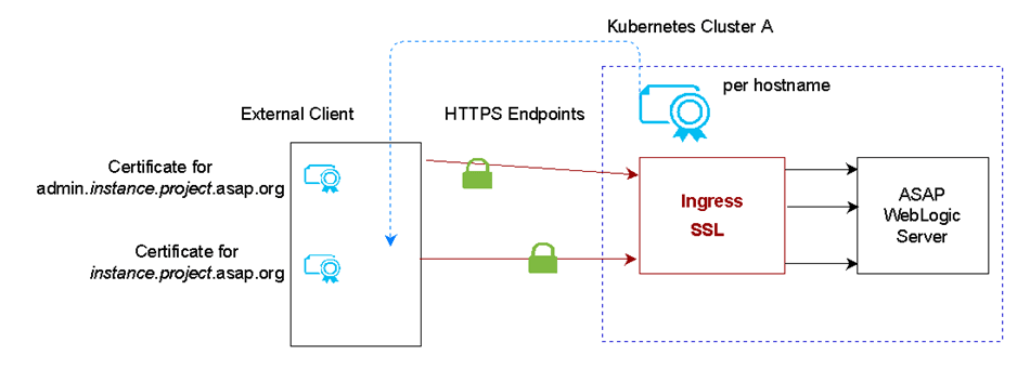

Generating SSL Certificates for Incoming Access
The following illustration shows when certificates are generated.
Figure 9-2 Generating SSL Certificates
Description of Figure 9-2 follows
Description of "Figure 9-2 Generating SSL Certificates"
When ASAP cloud native dictates secure communication, then it is responsible for generating the SSL certificates. These certificates must be provided to the appropriate client.
