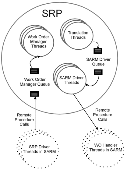

Tuning JSRP Message Queues
The purpose of tuning the JSRP is to provide WOs at a rate that creates an even flow to the downstream SARM process.
Figure 4-1 illustrates the schematic flow of the JSRP.

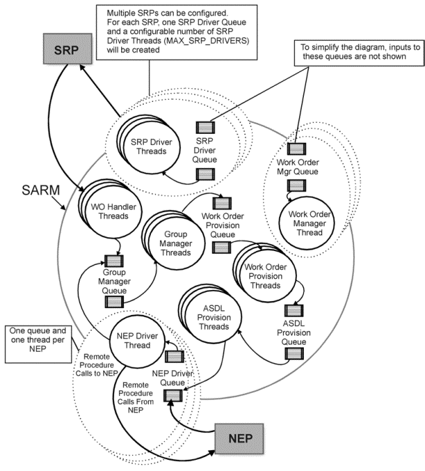

Figure 4-2 illustrates the flow of messages through the SARM.
Table 4-7 lists and describes the group Mgr message queue.
Table 4-7 Group Mgr Message Queue
| Item | Description |
Parameter Controlling Message Addition Rate to Queue |
The number of WO Handler threads and number of NEPs in the system are fixed for the purpose of Group Manager message queue tuning. Do not configure them at this time. |
Parameter Controlling Message Removal Rate from Queue |
Number of Group Manager Threads. MAX_GROUP_MGRS |

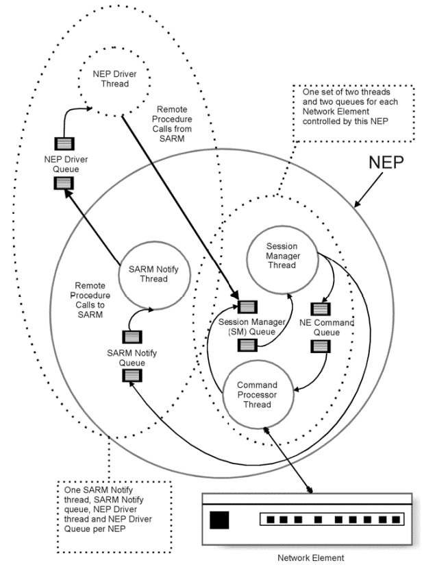

Table 4-11 lists and describes the NEP driver message queues.
Table 4-11 NEP Driver Message Queues
Number of ASDL Provision Threads MAX_PROVISION_HANDLERS (less) MAX_WO_HANDLERS |
Number of NEPs in the system (dependent on throughput requirements and machine resources). |

Table 4-12 lists and describes the SRP driver message queues.
Table 4-12 SRP Driver Message Queues
Nearly every thread in the SARM can add messages to this queue. Therefore, it is not possible to control the number of messages that are added. |
Number of SRP Driver Threads. MAX_SRP_DRIVERS |
There is one SRP Drive Queue for each SRP in the system.
Tips for Tuning the SARM
To tune the SARM, use the following:
The number of WO threads (MAX_WO_HANDLERS) in the SARM must be equal to the sum of all SARM Driver Threads (MAX_SARM_DRIVER) in all of the SRPs.
The total number of configured handler threads (MAX_WO_MGRS) in all SRPs must be equal to the driver threads (MAX_SRP_DRIVERS) in the SARM.
All event notifications not used by any customized SRP implementation must be turned off.
Sanity level diagnostics during production should be used.
The configured number of provision handlers (ASDL and WO) must be no less than the sum of the number of handler threads (MAX_WO_HANDLERS) and the number of operating NEP servers. Start tuning with a ratio of 1:3 of WO Manager Threads to provision handlers (ASDL and WO).
Tuning NEP Message Queues
The purpose of tuning a NEP is to provide:
ASDLs to the NEs
Remote Procedure Call (RPC) responses back to the SARM at a rate that does not cause excessive buildup in any of the SARM Notify, Session Manager, or NE Command queues.
Figure 4-3 illustrates the schematic flow of the NEP.
Table 4-13 lists and describes the SARM notify message queue.
Table 4-13 SARM Notify Message Queues
Tool |
NEP Server |
Session Manager Thread for the NE. Non-configurable |
SARM Notify Thread for the NEP. Non-configurable |
You can manage this queue indirectly by decreasing the number of NEs supported by the NEP (usually by increasing the absolute number of NEPs, if machine resources permit) or by balancing the load between NEPs (by moving a busy NE from a busy NEP to a less busy NEP).
Table 4-14 lists and describes the NE command queue.
Table 4-14 NE Command Message Queues
Tool |
NEP Server |
Command Processor Thread for the NE. Non-configurable |
You can manage this queue indirectly by increasing or decreasing NE response times (faster response times decrease the length of the queue).
Table 4-15 lists and describes the session manager queue for the NE.
Table 4-15 Session Manager Message Queues for the NE
Tool |
NEP Server |
Command Processor Thread of the NE - NEP Driver thread in the SARM for the NEP. Non-configurable |
You can manage this queue indirectly using the NE response times (fast responses increase the length of the queue). However, depending on communication and switch technology, this may not be configurable.
Tips for Tuning NEP
To tune the NEP, use the following:
Unless machine resources are limited, target for a ratio of 50 NEs per NEP.
If possible, group similar NE technologies and switch software loads on a single NEP. This reduces the number of ASDL programs held in memory because each NEP caches its own copy of every ASDL command that it has been asked to perform.
Balance the load on each NEP by distributing your busy NEs across several NEPs. You must determine the expected load based on both the number and complexity of the ASDL commands being serviced.
