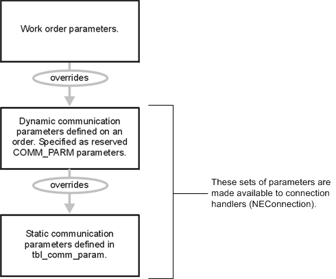

The template name (DYN_DALLAS) specified in the dynamicRoutingTemplate tag identifies the template that must be specified in the work order.
Parameters provided on the work order override statically defined values in the template.

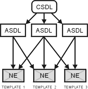

Scenario 3 – One Service Action to Multiple Atomic Actions Routed to Different NEs
Figure 7-3 shows a single service action that is mapped to two or more atomic actions, each of which is routed to a different NE. Each NE is using a different network template.
Figure 7-3 One Service Action to Multiple Atomic Actions Routed to Different NEs
Description of "Figure 7-3 One Service Action to Multiple Atomic Actions Routed to Different NEs"

The atomic action parameter MCLI in this case identifies the network template. In static routing, the atomic action parameter MCLI identifies the NE.
This configuration routes each atomic action to a different NE. Table 7-7 shows the downstream program (State Table or JInterpreter class) parameters.

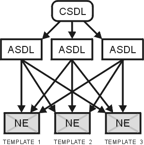

Scenario 4 – One Service Action to Multiple Atomic Actions Routed to Multiple NEs
Figure 7-4 shows a case that differs from the previous scenario in that all of the atomic actions are sent to each NE.
Figure 7-4 One Service Action to Multiple Atomic Actions Routed to Multiple NEs
Description of "Figure 7-4 One Service Action to Multiple Atomic Actions Routed to Multiple NEs"

This configuration routes each atomic action to each NE. Table 7-9 shows the downstream program (State Table or JInterpreter class) parameters.

Scenario 5 – One Service Action to Multiple Atomic Actions Routed to Different NEs
Figure 7-5 shows atomic actions that are routed to one or more NEs, and others that are routed to another NE.
Figure 7-5 One Service Action to Multiple Atomic Actions Routed to Different NEs
Description of "Figure 7-5 One Service Action to Multiple Atomic Actions Routed to Different NEs"

This configuration routes atomic action A-SERVICE_1 to NE_1 and NE_2; A-SERVICE_2 to NE_1, NE_2, and NE_3; and A-SERVICE_3 to NE_2 and NE_3. Table 7-11 shows the downstream program (State Table or JInterpreter class) parameters.

Managing Communication and Order Parameters
Parameters defined with the same label as both communication and order parameters will conflict. In order of precedence, order communication parameters override static parameters if they have the same label. Oracle recommends that solutions developers not use conflicting labels for both communication and order parameters.
During provisioning, parameters contained in work orders override work order communication parameters (COMM_PARM), which override static communication parameters contained in tbl_comm_param (see Figure 7-6).
