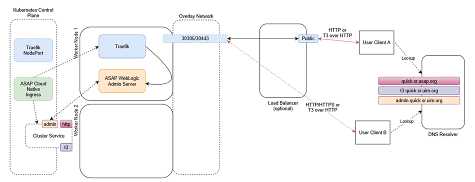

The following diagram illustrates the connectivity between the building blocks in an ASAP cloud native environment using an example:
Figure 9-1 Connectivity Between Building Blocks in ASAP Cloud Native Environment
Description of "Figure 9-1 Connectivity Between Building Blocks in ASAP Cloud Native Environment"
Invoking the ASAP cloud native Helm chart creates a new ASAP instance. In the above illustration, the name of the instance is "quick" and the name of the project is "sr". The instance consists of an ASAP pod and a Kubernetes service.
The Cluster Service contains endpoints for both HTTP and T3 traffic. The instance creation script creates the ASAP cloud native Ingress object. The Ingress object has metadata to trigger the Traefik ingress controller as a sample. Traefik responds by creating new front-ends with the configured "hostnames" for the cluster (quick.sr.asap.org and t3.quick.sr.uim.org in the illustration). The IngressRoute connects the hostname to the service exposed on the pod. The service is created on the ASAP WebLogic admin server port.
The prior installation of Traefik has already exposed Traefik itself via a selected port number (30305 in the example) on each worker node.
Inbound HTTP Requests
An ASAP instance is exposed outside of the Kubernetes cluster for HTTP access via an Ingress Controller and potentially a Load Balancer.
Because the Traefik port (30305) is common to all ASAP cloud native instances in the cluster, Traefik must be able to distinguish between the incoming messages headed for different instances. It does this by differentiating on the basis of the "hostname" mentioned in the HTTP messages. This means that a client (User Client B in the illustration) must believe it is talking to the "host" dev2.mobilecom.asap.org when it sends HTTP messages to port 30305 on the access IP. This might be the Master node IP, or IP address of one of the worker nodes, depending on your cluster setup. The "DNS Resolver" provides this mapping.
In this mode of communication, there are concerns around resiliency and load distribution. For example, If the DNS Resolver always points to the IP address of Worker Node 1 when asked to resolve dev2.mobilecom.asap.org, then that Worker node ends up taking all the inbound traffic for the instance. If the DNS Resolver is configured to respond to any *.mobilecom.asap.org requests with that IP, then that worker node ends up taking all the inbound traffic for all the instances. Since this latter configuration in the DNS Resolver is desired, to minimize per-instance touches, the setup creates a bottleneck on Worker node 1. If Worker node 1 were to fail, the DNS Resolver would have to be updated to point *.mobilecom.asap.org to Worker node 2. This leads to an interruption of access and requires intervention. The recommended pattern to avoid these concerns is for the DNS Resolver to be populated with all the applicable IP addresses as resolution targets (in our example, it would be populated with the IPs of both Worker node 1 and node 2), and have the Resolver return a random selection from that list.
An alternate mode of communication is to introduce a load balancer configured to balance incoming traffic to the Traefik ports on all the worker nodes. The DNS Resolver is still required, and the entry for *.mobilecom.asap.org points to the load balancer. Your load balancer documentation describes how to achieve resiliency and load management. With this setup, a user (User Client A in our example) sends a message to dev2.mobilecom.asap.org, which actually resolves to the load balancer - for instance, http://dev2.mobilecom.asap.org:8080/OrderManagement/Login.jsp. Here, 8080 is the public port of the load balancer. The load balancer sends this to Traefik, which routes the message, based on the "hostname" targeted by the message to the HTTP channel of the ASAP cloud native instance.
Access to the WebLogic Admin console is provided for review and debugging use only. Do not use the console to change the system state or configuration. As a result, any such manual changes (whether using the console or using WLST or other such mechanisms) are not retained in pod reschedule or reboot scenarios. The only way to change the state or configuration of the WebLogic domain or the ASAP installation is inside the ASAP Image.Inbound JMS Requests
JMS messages use the T3 protocol. Since Ingress Controllers and Load Balancers do not understand T3 for routing purposes, ASAP cloud native requires all incoming JMS traffic to be "T3 over HTTP". Hence, the messages are still HTTP but contain a T3 message as a payload. ASAP cloud native requires the clients to target the "t3 hostname" of the instance - t3.dev2.mobilecom.asap.org, in the example. This "t3 hostname" should behave identically as the regular "hostname" in terms of the DNS Resolver and the Load Balancer. Traefik however not only identifies the instance this message is meant for (dev2.mobilecom) but also that it targets the T3 channel of instance.
The "T3 over HTTP" requirement applies for all inbound JMS messages - whether generated by direct or foreign JMS API calls or generated by SAF. The procedure in SAF QuickStart explains the setup required by the message producer or SAF agent to achieve this encapsulation. If SAF is used, the fact that T3 is riding over HTTP does not affect the semantics of JMS. All the features such as reliable delivery, priority, and TTL, continue to be respected by the system. See "Applying the WebLogic Patch for External Systems".

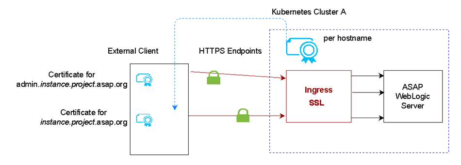

Configuring Secure Incoming Access with SSL
This section demonstrates how to secure incoming access to ASAP cloud native. In this scenario, SSL termination happens at the ingress. The traffic coming in from external clients must use one of the HTTPS endpoints. When SSL terminates at the ingress, it also means that communication within the cluster from Traefik ASAP cloud native instances is not secured.
The ASAP cloud native toolkit provides the sample configuration for Traefik ingress. If you use Voyager or other ingress, you can look at the $ASAP-CNTK/charts/asap/templates/traefik-ingress.yaml file to see what configuration is applied.
Generating SSL Certificates for Incoming Access
The following illustration shows when certificates are generated.
When ASAP cloud native dictates secure communication, then it is responsible for generating the SSL certificates. These certificates must be provided to the appropriate client.
