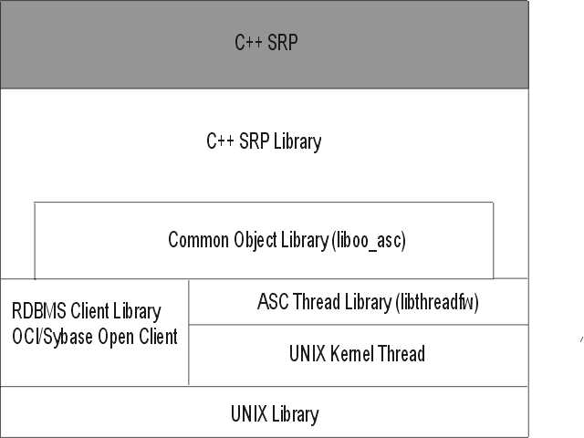

C++ SRP API library
The C++ SRP API library is a library in ASAP to let the user applications interface with SARM. In addition, the library will help the users to develop SRP in ASAP with an object-oriented interface. It provides the POSIX thread interfaces.
The C++ SRP API library provides the following functionality:
OO interface to generate and submit work orders.
OO interface to manipulate work orders.
OO interface to process work orders.
OO interface to retrieve work order information in ASAP.
ASAP high availability.
Reliable communication between SRP and SARM.
Common object library (liboo_asc)
The liboo_asc library provides you with the following functionality:
Diagnostic message logging facility to the application programmers.
System event generation.
Application configuration parameter determination.
Remote Procedure Calls API.
Network connection management.

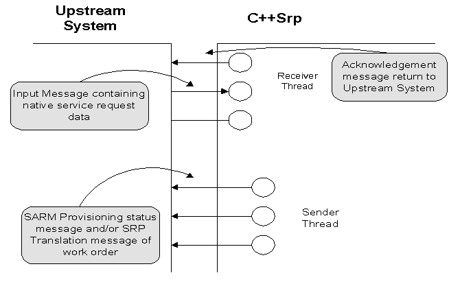

Communication between the C++ SRP API and Upstream systems
TCP/IP Sockets
Connection Verification
Communication between C++ SRP API and upstream systems
Sender thread and Receiver thread in each C++ SRP API handles the connections between C++ SRP API and upstream system.
Connection method is site specific.
Commonly used communication protocol, for example, TCP/IP (socket), Open Client/Server Language Communication, SNA LU 6.2).
Routines must be thread-saved with the Sybase multithread library.
Synchronous communication is used, for example, acknowledgement required for data transfer.
TCP/IP sockets
Implementation of TCP/IP requires a new thread (Connection Handler thread) in the C++ SRP API server.
Connection Handler Thread [server] constantly waits for connection from the upstream system [client].
IP address and port number belong to the upstream system, and the C++ SRP API is defined in command line or input file.
To create a socket, the Connection Handler Thread uses listen.
To wait for I/O from the upstream system and connection socket, Accept is used.
To handle the data transfer between C++ SRP API and upstream system, the Connection Handler thread spawns the Receiver thread.
Read and write are used for data transfer between receiver and upstream system.

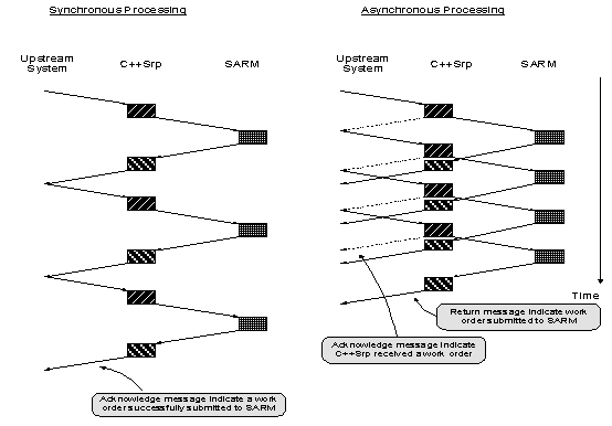

Synchronous processing
The C++ SRP API returns the acknowledgment to the Upstream system after the work order submits to SARM.
Upstream system submits the next work order after it receives an acknowledgment from the C++ SRP API.
Asynchronous processing
The C++ SRP API returns acknowledgment to the Upstream system after the C++ SRP API successfully receives a message from the Upstream system.
Upstream system submits the next work order after it receives an acknowledgement from the C++ SRP API.
The C++ SRP API translates the work order and submits the work order to SARM. During this time, the current work order has no persistence (for example, if the C++ SRP API system goes down, the work order cannot be recovered).
The C++ SRP API returns to the Upstream system after the work order successfully submits to SARM.
Upstream system needs to maintain the work order submitted to the C++ SRP API until the C++ SRP API successfully submits the work order to SARM.
Figure C-7 Synchronous and Asynchronous C++ SRP API Processing
Description of "Figure C-7 Synchronous and Asynchronous C++ SRP API Processing"
If Upstream system can persist, the work order is submitted to the C++ SRP API before the work order is submitted to the SARM, therefore work order dependency is not important or is maintainable. The asynchronous processing is recommended because of its faster throughput.
Table C-1 Processing characteristics
| Synchronous | Asynchronous |
Receiver and Translator thread process in sequence. |
Receiver and Translator thread process in parallel. |
SRP return SARM submission status to upstream through receiver thread. |
C++ SRP API return SARM submission status through sender thread (other connect to upstream system). |
Slow throughput. |
Fast throughput for work order submission. |
Simpler Implementation |
Harder implementation |
Easy re-submission of work order during system failure. |
Hard implementation of re-submission of work order during system failure. |
Upstream system does not need to maintain work order once acknowledgement received from SRP. |
Upstream system needs to maintain work order after acknowledgement received, until the SRP returns stating work order successfully saved in SARM. |
Work Order dependency preserves because work order submits to SARM in the same sequence work order submitted from Upstream. |
Work Order dependency needs to manage by C++ SRP API because work order might not submit to SARM in the same sequence work order submits from upstream system. |
If throughput is not as important, synchronous processing should be used for simple implementation.

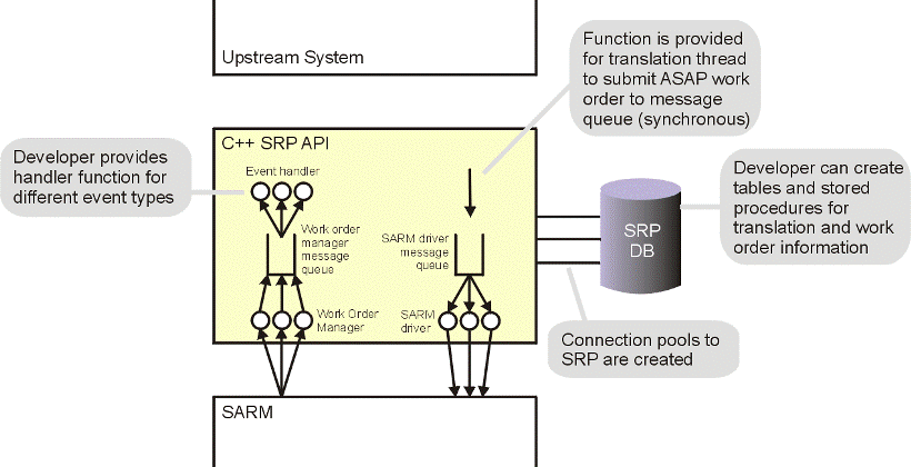

SRP_initialize
Calls SRP_initialize() in appl_initialize() before other initialization routines. Add functionality that is generic to all SRP servers.
SRP_initialize() creates the following threads:
SARM Driver thread
Work Order Manager thread
part of event handler thread
SRP_initialize() creates the following message queues:
Work Order Manager
SARM Driver
Figure C-9 shows the components that are added to C++ SRP API server after call to SRP_initialize.
You must develop code that:
Interfaces with the Upstream system (receiver thread and sender thread).
Translates a service request in native format to CSDL (Translator thread).
Submits an ASAP work order containing CSDL to SARM Driver message queue.
Handles a provisioning event from SARM by defining the event handling function.

Receiver
The following tasks are performed by the receiver:
Connects to the Upstream system using the protocol agreed with upstream system.
Validates the connection for security purposes.
Waits for the work order containing the service request in the native format from upstream system.
Checks the dependency of work order.
Allocates the translator message structure, stores the work order in the native format and provides the field containing the translator return status (synchronous).
Submits the pointer to the translator message to the Translator message queue.
Waits for the return status from the translator.
Formats the acknowledgement message.
Returns the acknowledgement message to the upstream system.
Waits for the next request from the upstream system.
The receiver thread submits the message to translator message queue with wait.
Translator thread wakes up the receiver thread after the work order successfully submits to SARM.
Translator message contains the field to store the SARM submission status. The receiver has the responsibility to deallocate the translator message structure after translator returns.
Receiver returns the acknowledgment to the upstream system and waits for the work order from the upstream system.
Receiver thread submits the message to the translator message queue with no wait.
Translator thread process in parallel with the receiver thread.
Receiver thread returns the acknowledgement to the upstream system after it submits the message to the translator thread.

Single connection, synchronous processing (batch submission of work order)
One Receiver thread and multiple Translator thread are used.
Multiple work orders are submitted to the C++ SRP API in batches within one data transfer from the upstream system.
Receiver maintains a counter of the number of work orders and a message queue (Receiver message queue).
After the receiver thread submits all work orders of a batch to the Translator thread, it waits for the message from the Receiver message queue.
Translator thread sends a message to the Receiver message after finish submitting one work order to SARM.
Receiver thread decrements the work order counter when it receives one message from the translator. Once the counter reaches zero, the Receiver returns an acknowledgement message to the upstream system and waits for the next batch of work orders.
Figure C-11 Single Connection, Synchronous Processing (Batch Submission of Work Order)

Synchronous translation – Updates the return status inside the translator message, and wakes up receiver thread.
Asynchronous translation – Allocates to the sender message structure and sends the structure to the sender message queue asynchronously.
The following steps are required to return the translation status to the upstream system:
Table C-3 Synchronous vs asynchronous processing
| Synchronous Processing | Asynchronous Processing |
Update the return status in the Translator Message structure. |
Allocate and populate the Sender Message structure with the status of translation. |
Wake up the Receiver Thread. |
Send a message to Sender Message queue without waiting (asynchronously). |
Receiver thread will lookup the translation status in the Translator Message structure. |
Translator frees the memory allocated for the Translator Message structure. |
Receiver frees the memory allocated for the Translator Message structure. |
Translator status will send through the connection established with Sender Thread. |
Receiver will return the Translation status as ACK/NACK to the upstream system through the connection established with receiver |
Event handling
This section describes event handling.
SARM events
At different stages of provisioning, SARM will notify the C++ SRP Work Order Manager thread. The Work Order Manager (handled by API), in turn, spawns threads to handle the event.
The SRP_EventManager manages a connection with SARM to receive work order events. When a SRP_EventManager thread starts up, it waits to receive a message, which is an event, from SARM. The message is constructed as a DU packet format, which is provided. The SRP_EventManager thread decodes the message and creates the SRP_Event object to the corresponding event type in the messsage. The thread calls the corresponding event handler for the event with the SRP_Event object. After the event handler is done, it returns to receive an event. If an event is the kick_start, the thread does not create a SRP_Event object. It just sends CS_TRUE back to the SARM.
The following are the possible events and the sequence of events for a work order:
SRP_WO_ESTIMATE_EVENT
WO_STARTUP_EVENT
WO_SOFT_ERROR_EVENT
WO_NE_UNKNOWN_EVENT
WO_ROLLBACK_EVENT
WO_TIMEOUT_EVENT
WO_FAILURE_EVENT
WO_COMPLETE_EVENT
The sequence of events is guaranteed for a work order. For example, a WO_FAILURE event will not occur before a WO_STARTUP event.
Actions performed by event handler
All action methods send a diagnostic message for performance testing to indicate in what is the status of the work order and then calls the appropriate RPC to update the SRP database to reflect the new conditions of the work order.
EventHandler::softErrorHandler().
EventHandler::woEstimateHandler()
EventHandler::woStartHandler()
EventHandler::woRollbackHandler()
EventHandler::neUnknownHandler()
EventHandler::woBlockHandler()
EventHandler::woTimeOutHandler()
EventHandler::neAvailHandler()
EventHandler::neUnavailHandler()
EventHandler::woAcceptHandler()
EventHandler::woCompleteHandler()
EventHandler::woFailureHandler()
Sender
Sender manages the connection with the upstream system to return provisioning information to the upstream system. The Sender thread can receive a message from an event handler or translator (asynchronous processing).
The following tasks are performed by the Sender thread:
Establishes the dedicated connection with the upstream system.
Waits for a message from sender message queue.
Formats the sender message.
Sends the message to the upstream system.
If the sender message comes from the event handler, it wakes up the event handler thread.
If the message comes from the translator, it deallocates the sender message.
Sender message
Wo_id must be part of the sender message to allow the upstream system to recognize which work order the message belongs to.
If the Translator sends a message to the Sender, all Sender Messages should include the type of message (for example, translator or event message) because the translation message is different from the event message.

Receiver
Spawned by the connection handler once the connection is detected.
Loops and does the following:
Reads the message header and message from the socket connected to the upstream system and populates the translator message structure.
If the connection drop is detected, it terminates the current receiver thread only.
If the connection drop is not detected, it verifies the message retrieved from the socket.

Translator thread
Main program spawns the translator threads and creates the translator message queue when the server starts up.
Repeat the following:
Translator thread waits for the message from the receiver through translator message queue.
Translator parses out the service request in the native format and stores the tokens in the SRP work order structure.
Creates SRP_WO object base on SRP work order structure.
Translators submit SRP_WO to SARM using submitWO.
