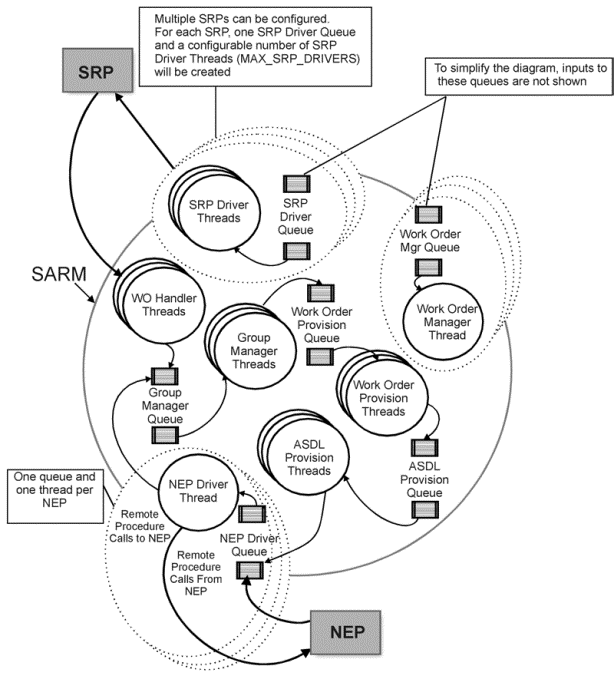

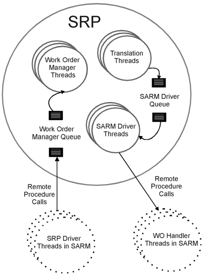

Tuning JSRP and SRP Message Queues
The purpose of tuning the SRP is to provide WOs at a rate that creates an even flow to the downstream SARM process.
Figure 4-1 illustrates the schematic flow of the SRP.
Table 4-8 lists and describes the WO manager queue.
Table 4-8 Work Order Manager Queue

Table 4-9 lists the SARM driver message queues.
Table 4-9 SARM Drive Queue
| Item | Description |
Tool |
asap_utils, Real-time System Monitoring option 109, SRP Server |
Parameter Controlling Message Addition Rate to Queue |
Number of Translation Threads (implementation dependent). |
Parameter Controlling Message Removal Rate from Queue |
Number of SARM Driver Threads MAX_SARM_DRIVER Variable size:
Tips for Tuning the SRP
To tune the SRP, use the following:
As an initial estimate, set the number of WO Manager Threads (MAX_WO_MGRS) in the SRPs equal to the number of configured MAX_SRP_DRIVERS threads in the SARM. The initial setting can be modified depending upon the complexity of the WO (number of CSDLs and parameters), and the number of events defined to return to the SRP. Monitor the WO Manager queue(s) in the SRP(s) and the SRP driver queue in the SARM to verify these configuration variables.

Tuning SARM Message Queues
The purpose of tuning the SARM is to:
Provide the Atomic Service Description Layer (ASDL) commands to the NEPs.
Send event notices back to the SRPs at an even rate to both the upstream and downstream processes.
Since only one SARM process exists in an ASAP system, the performance of the SARM cannot be enhanced by spreading the load across multiple Central Processing Units (CPUs) or systems. Therefore, the SARM must be well tuned to get high performance from ASAP.
Figure 4-2 illustrates the flow of messages through the SARM.

Table 4-12 lists and describes the WO provision queue.
Table 4-12 Work Order Provision Queue
Tool |
asap_utils, Real-time System Monitoring option (109), SARM Server |
Number of Group Manager threads MAX_GROUP_MGRS Variable size:
Number of WO Provision threads MAX_WO_HANDLERS Variable size:
Table 4-13 lists and describes the ASDL Provision Message Queues.
Table 4-13 ASDL Provision Message Queues
Tool |
Number of WO Provision Threads MAX_WO_HANDLERS Variable size:
Number of ASDL Provision Threads MAX_PROVISION_HANDLERS–(Less) MAX_WO_HANDLERS Variable size:
Example |
If you have five (5) WO Handlers and you want ten (10) ASDL Provision Threads, set the MAX_PROVISION_HANDLERS to fifteen (15). The difference is the ten (10) that you wanted. |
Table 4-14 lists and describes the NEP driver message queues.
Table 4-14 NEP Driver Message Queues
Tool |
asap_utils Real-time System Monitoring option (109), SARM Server |
Number of ASDL Provision Threads MAX_PROVISION_HANDLERS (less) MAX_WO_HANDLERS Variable size:
Number of NEPs in the system (dependent on throughput requirements and machine resources). |
There is one NEP Driver Queue for each NEP in the system.
Table 4-15 lists and describes the SRP driver message queues.
Table 4-15 SRP Driver Message Queues
Tool |
Nearly every thread in the SARM can add messages to this queue. Therefore, it is not possible to control the number of messages that are added. |
Number of SRP Driver Threads. MAX_SRP_DRIVERS Variable size:
There is one SRP Drive Queue for each SRP in the system.

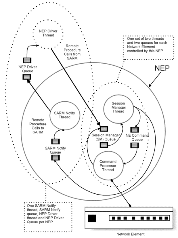

Tuning NEP Message Queues
The purpose of tuning a NEP is to provide:
ASDLs to the NEs
Remote Procedure Call (RPC) responses back to the SARM at a rate that does not cause excessive buildup in any of the SARM Notify, Session Manager, or NE Command queues.
Figure 4-3 illustrates the schematic flow of the NEP.
Table 4-16 lists and describes the SARM notify message queue.
Table 4-16 SARM Notify Message Queues
Tool |
asap_utils Real-time System Monitoring option (109), NEP Server |
Session Manager Thread for the NE. Non-configurable |
SARM Notify Thread for the NEP. Non-configurable |
You can manage this queue indirectly by decreasing the number of NEs supported by the NEP (usually by increasing the absolute number of NEPs, if machine resources permit) or by balancing the load between NEPs (by moving a busy NE from a busy NEP to a less busy NEP).
Table 4-17 lists and describes the NE command queue.
Table 4-17 NE Command Message Queues
Tool |
asap_utils, Real-time System Monitoring option (109), NEP Server |
Command Processor Thread for the NE. Non-configurable |
You can manage this queue indirectly by increasing or decreasing NE response times (faster response times decrease the length of the queue).
Table 4-18 lists and describes the session manager queue for the NE.
Table 4-18 Session Manager Message Queues for the NE
Tool |
Command Processor Thread of the NE - NEP Driver thread in the SARM for the NEP. Non-configurable |
You can manage this queue indirectly using the NE response times (fast responses increase the length of the queue). However, depending on communication and switch technology, this may not be configurable.
Tips for Tuning NEP
To tune the NEP, use the following:
Unless machine resources are limited, target for a ratio of 50 NEs per NEP.
If possible, group similar NE technologies and switch software loads on a single NEP. This reduces the number of ASDL programs held in memory because each NEP caches its own copy of every ASDL command that it has been asked to perform.
Balance the load on each NEP by distributing your busy NEs across several NEPs. You must determine the expected load based on both the number and complexity of the ASDL commands being serviced.
