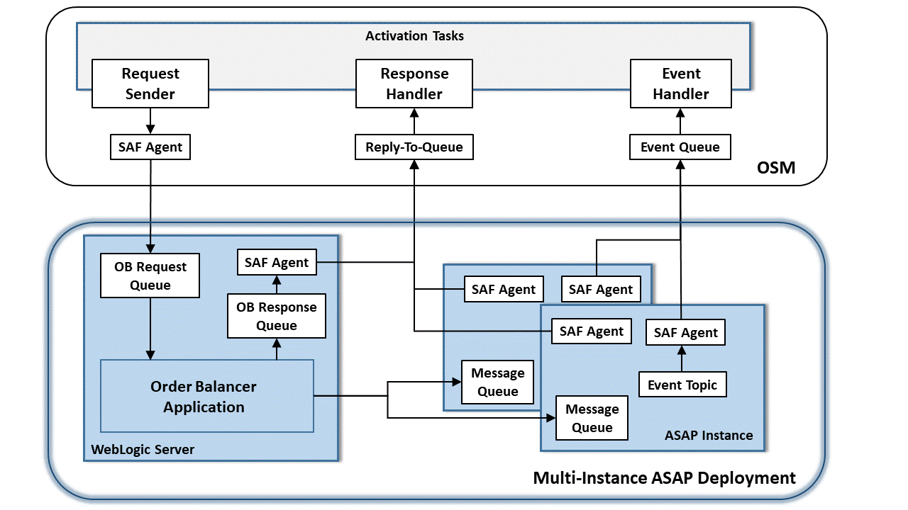

Connecting Order Balancer with Multiple ASAP Instances to a Remote Application
Oracle recommends that you create an SAF agent between Order Balancer, all ASAP WebLogic Servers, and the remote application WebLogic Server. Oracle recommends this SAF agent for JMS to ensure reliable communication.
Figure 6-1 illustrates SAF configuration between Order Balancer with multiple ASAP instances and a client on a remote application. In this illustration, OSM is used as an example of a remote application.
Figure 6-1 Connecting Order Balancer with Multiple ASAP Instances to a Remote Application
In this example, an OSM SAF agent sends requests to the Order Balancer request queue. Based on the order type in the requests, Order Balancer routes the requests to the message queue of the corresponding ASAP member instance. The ASAP instance processes the requests and returns responses through the ASAP SAF agent to the OSM reply-to queue. In case of exceptions in Order Balancer, such as ASAP server is down, and invalid order sent in the request, Order Balancer sends the error responses from Response Queue with an SAF agent to OSM reply-to-queue. Each ASAP member instance sends work order state changes from their respective JSRP XVTEventTopic through a JMS bridge with an SAF agent to the OSM event queue.
For detailed instructions on creating SAF and JMS bridges between ASAP and OSM, see the Configuring WebLogic Resources for OSM Integration With ASAP And UIM On Different Domains (Doc ID 1431235.1) knowledge article on My Oracle Support. This article is applicable to any remote application that uses a WebLogic JMS server to send and receive web service messages or JMS messages.
Order Balancer supports the OSS/J JMS interface and the web services interface for both traditional and cloud native deployments. Other interfaces such as Custom SRP and JVT (RMI) are not supported.

About Order Balancer JMS Queues
Order Balancer queues enable you to route the requests from upstream systems to Order Balancer, which distributes the requests among the ASAP instances for high availability. Table 6-3 describes the Order Balancer queues that the installer configures automatically.
Table 6-3 Order Balancer JMS Queues
JMS Resource Queue Description
Request Queue System.ASAPOB.ApplicationType.ServiceActivation.Application;ASAP.Comp.OBRequestQueue The input Queue to send ASAP orders to Order Balancer.
Connection Factory System.ASAPOB.ApplicationType.ServiceActivation.Application;ASAP.Comp.TopicConnectionFactory This is the Order Balancer connection factory.
Response Topic System.ASAPOB.ApplicationType.ServiceActivation.Application;ASAP.Comp.ASAP.OBResponseTopic In case of exceptions in Order Balancer and if the replyTo queue is not set in the incoming message, the exception responses are sent to this queue.
Error Queue System.ASAPOB.ApplicationType.ServiceActivation.Application;ASAP.Comp.OBErrorQueue If the message delivery on request queue exceeds the queue's re-delivery limit, the message gets redirected to this queue.
Order Balancer Web Services
Order Balancer provides the Web Services interface through which external applications can manage service activation activities and operations. The supported external transport protocols are HTTP and HTTPS and the data service formats are SOAP v1.1 and 1.2. Order Balancer Web Services are of type JAX-RPC.
Order Balancer balances the SOAP requests from these protocols and routes them to the registered ASAP member instances using the respective ASAP Web Services interface. Order Balancer exposes the same Web Service Definition Language (WSDL) and Operations as ASAP and hence the same Web Services clients (stubs) can connect to Order Balancer. Order Balancer Web Service requests receives and processes the Order Management functions which includes Non-sticky requests and sticky requests.
Order requests must have Order IDs in the Order Balancer Web Service.

About Member Instance States
When routing a request to an ASAP member instance queue, Order Balancer attempts to connect to the instance queue using the connection factory details. If the connection attempt fails in the first attempt, Order Balancer reattempts the connection after the configured time interval. If the connection attempt fails again, Order Balancer marks the instance as down and sets the instance status to DOWN. If the request is a non-server dependent request, Order Balancer attempts to route the request to the next available instance.
Once an instance is marked as down, Order Balancer polls the instance for its status at the configured interval. After Order Balancer makes a successful connection to the member instance, the instance status is set to UP.
When a member instance is marked as down, no further requests are routed to it until it is marked back to UP. When a sticky type of request comes in, but the corresponding instance is down, then an error response with serverDownException type is sent to the Order Balancer's response queue after two attempts. When all the instances are down, all the requests are blocked by Order Balancer until at least one instance becomes available or till time-out. An instance becomes available (state set to UP) when Order Balancer successfully makes a connection in its periodical attempts.
Use the ALL_SERVERS_DOWN_WAIT_INTERVAL parameter to configure the duration of the time out interval. In case of time-out before at least one member instance becomes available, the request is forwarded to the error queue.
