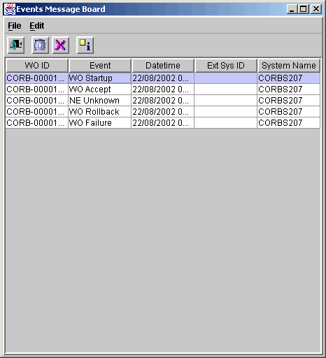

After you have subscribed to the events notification, you can open the Events Message Board window to view notifications of work order events as they occur.
The Events Message Board window displays only work order events matching the criteria that you specify when subscribing to event notifications.
To view the Events Message Board window:
  1. In the OCA window, from the Events menu, select Events Message Board.
    The Events Message Board window appears, displaying work orders on specified ASAP system, the event, and the time of the event.
  2. Double-click the event for which you want to view details.
    The work order details window appears.
    The title of the window displays the work order ID and the ASAP system that the order is being processed on.

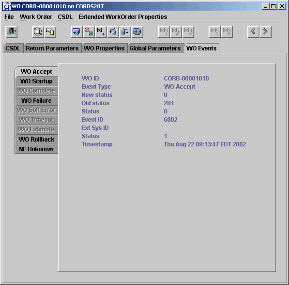

  3. Click the WO Events tab to view the work order events in the work order details window.
  4. Click the tabs on the left-hand side of the WO Events property sheet to view the details of each event. Each tab corresponds with an event.
    Only events that are applicable to the work order are accessible. For example, if the work order has processed correctly, the WO Accept, WO Startup, and WO Complete tabs are accessible. The remaining work order events are not applicable and are therefore not accessible. This example shows an incomplete work order; therefore, the WO Startup, WO Failure, and WO rollback tabs are accessible and the other tabs are not applicable.
