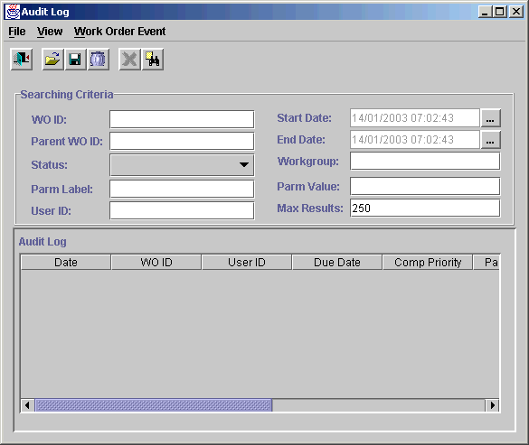

To open the audit log:
  1. In the OCA window, from the Provisioning Management menu, select Audit Log.
    The Audit Log window appears.
The Audit Log window consists of two sections:
  • Searching Criteria: Contains search criteria that you can use to retrieve audit log records.
  • Audit Log: Displays the results of your search.

Search Criteria
To restrict the search to specific audit log records, use as many known parameters as possible.
You can use the following query criteria to retrieve audit log records.
Table 5-1 Search Criteria
Field Description
WO ID
The unique work order identifier. If the work order is found, the Audit Log section displays all service request (SRQ) events associated with the work order. Maximum length: 80 characters.
Parent WO ID
The unique parent work order identifier. If the work order is found, the Audit Log section displays the parent work order, all child work orders, and their respective SRQ events. A parent work order must be provisioned before a dependent work order can be completed.
Status
The status of the work order.
Parm Label
Enables you to perform a query based on a work order parameter. Note that if you do not specify a parameter label and parameter value, no parameter label or parameter value columns appears in the search results.
User ID
The user ID of the person who submitted the order or the name of the system from which the order originated. The value entered in this field must match the value entered in the Origin field of the Work Order Details page of the New Work Order window.
Start Date
The start of the period in which the service request was updated.
End Date
The end of the period in which the service request was updated. By default, the maximum period is six days. If you do not use dates in your search criteria, the search is not restricted to six days.
Workgroup
The organizational unit of the person or group to whom event notifications should be sent.
Parm Value
The value associated with the specified parameter label. This field is accessible only if you have specified a parameter label. Note that if you do not specify a parameter label and parameter value, no parameter label or parameter value columns appear in the search results.
Max Results
The maximum number of results you want returned. The Max Results field displays a default value. You can tailor this number as required. The default is defined by the MAX_QUERY_RESULTS configuration parameter in the ASAP.cfg file. For more information on this configuration parameter, refer to ASAP System Administrator's Guide.
