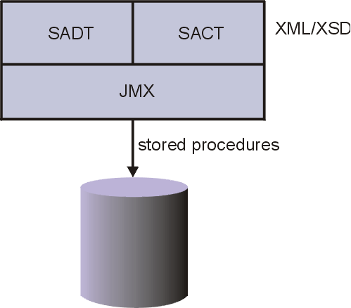

Figure 2-1 shows how the SACT and the SADT deploy an XML file or service activation model archive (SAR) file through a JMX management interface located in the Oracle WebLogic Server instance for ASAP when you first install ASAP. You can use the SADT or Oracle Communications Service Catalog and Design - Design Studio to deploy a cartridge into ASAP.
Before the SACT can process an XML file and configure ASAP server resources through the JMX interface, the XML file must conform to the resource definitions defined in the ASAP_Home/xml/xsd/ActivationConfig.xsd schema file. You can view a sample XML configuration file that conforms to this schema in the ASAP_Home/sample/sadt/SampleCommonConfig.xml file.
Schema validation for XML data processed by the SACT and the SADT is turned off by default.

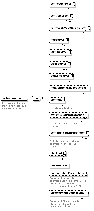

Figure 2-2 shows the ActivationConfig.xsd schema elements. Each element corresponds to configurable ASAP server or server parameter schema definitions which your XML server configuration file must conform to.
Figure 2-2 ActivationConfig.xsd Schema Elements
Description of Figure 2-2 follows
Description of "Figure 2-2 ActivationConfig.xsd Schema Elements"
The ASAP installer creates some of the elements listed in Figure 2-2 during the installation process. For example, ASAP supports one Service Activation Request Manager (SARM), JSRP, and Order Control Application (OCA) server. You do not need to add or delete these resources using SACT.
You can use the SACT to add configuration parameters to the servers that the ASAP installer creates. Some elements you may need to add include:
When authoring an XML configuration file consisting of several elements, observe the order in which elements are listed in the schema. For example, if defining an NEP server and a resource pool (connectionPool) in an XML configuration file, ensure that the NEP server definition is located before the resource pool definition since the ActivationConfig.xsd schema requires this order.
Oracle recommends that you use an XML editor to create an XML document, as XML editing tools usually have validators that ensure that the XML document is valid.

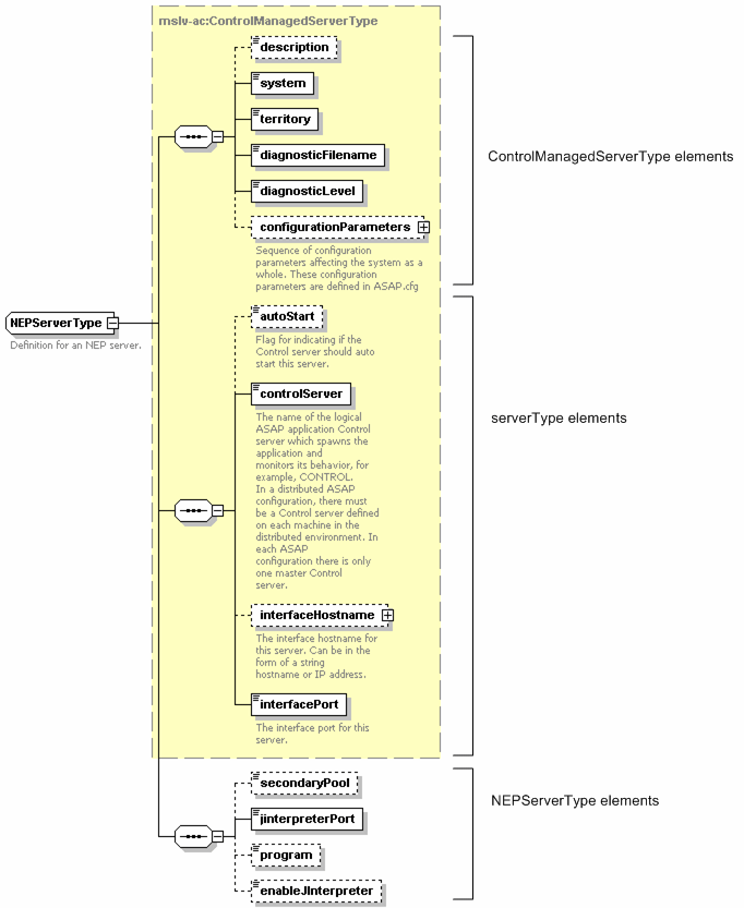

The schema contains base types and extensions for a given entity. For an NEP, for example, the XML schema identifies:
  • The base type and serverType, which contains the most common entries: description, system, territory, diagnosticFilename, diagnosticLevel.
  • ControlManagedServerType, an extension of the base serverType, which adds the autoStart flag, control server name, and interface information on top of the serverType.
  • NEPServerType, an extension of ControlManagedServerType, which contains the elements secondaryPool and jinterpreterPort.
Figure 2-3 shows the structure that has to be observed when authoring an NEP configuration file. The XML configuration file must observe the order in which the elements appear in the schema.
Figure 2-3 NEPServerType Schema
Description of Figure 2-3 follows
Description of "Figure 2-3 NEPServerType Schema"
The following is an excerpt from the ControlManagedServerType in the schema.
