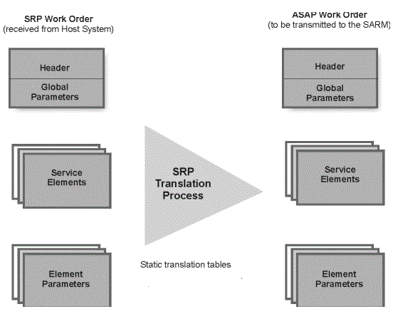

Using this data structure, the SRP performs a translation from the native SRP work order format to the ASAP work order format. Figure 5-1 describes this translation.
Figure 5-1 SRP Work Order Translation
Description of Figure 5-1 follows
Description of "Figure 5-1 SRP Work Order Translation"
The various ASAP work order components created by this process are outlined in the following section.
