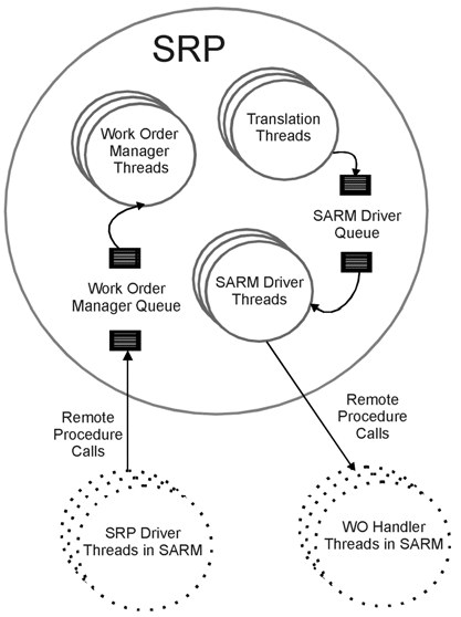

Tuning JSRP Message Queues
The purpose of tuning the JSRP is to provide WOs at a rate that creates an even flow to the downstream SARM process.
Figure 4-1 illustrates the schematic flow of the JSRP.
Table 4-1 lists and describes the WO manager queue.
Table 4-1 Work Order Manager Queue
| Item | Description |
Parameter Controlling Message Addition Rate to Queue |
Number of SRP Driver Threads in the SARM. MAX_SRP_DRIVERS |
Parameter Controlling Message Removal Rate from Queue |
Number of WO Manager Threads MAX_WO_MGRS |

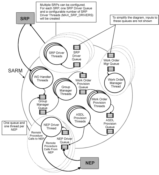

Tuning SARM Message Queues
The purpose of tuning the SARM is to:
Provide the Atomic Service Description Layer (ASDL) commands to the NEPs.
Send event notices back to the SRPs at an even rate to both the upstream and downstream processes.
Since only one SARM process exists in an ASAP system, the performance of the SARM cannot be enhanced by spreading the load across multiple Central Processing Units (CPUs) or systems. Therefore, the SARM must be well tuned to get high performance from ASAP. The WO_ACCEPT and WO_STARTUP events are turned off by default to improve SARM performance. You can turn the events on by setting wo_start_evt and wo_accept_evt to NULL in database table tbl_asap_srp. See "tbl_asap_srp" in Developer's Guide for more details.
Figure 4-2 illustrates the flow of messages through the SARM.

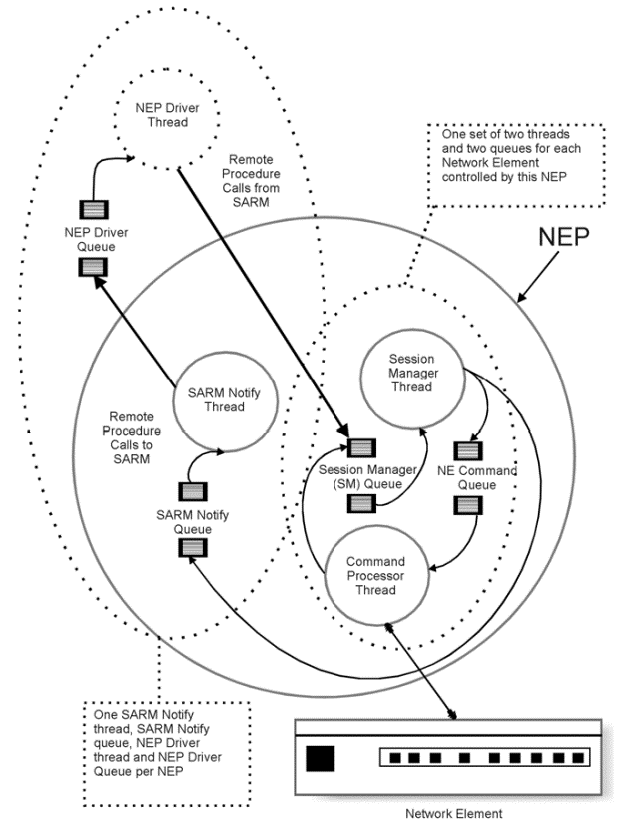

Tuning NEP Message Queues
The purpose of tuning a NEP is to provide:
ASDLs to the NEs
Remote Procedure Call (RPC) responses back to the SARM at a rate that does not cause excessive buildup in any of the SARM Notify, Session Manager, or NE Command queues.
Figure 4-3 illustrates the schematic flow of the NEP.
Table 4-9 lists and describes the SARM notify message queue.
Table 4-9 SARM Notify Message Queues
Tool |
NEP Server |
Session Manager Thread for the NE. Non-configurable |
SARM Notify Thread for the NEP. Non-configurable |
You can manage this queue indirectly by decreasing the number of NEs supported by the NEP (usually by increasing the absolute number of NEPs, if machine resources permit) or by balancing the load between NEPs (by moving a busy NE from a busy NEP to a less busy NEP).
