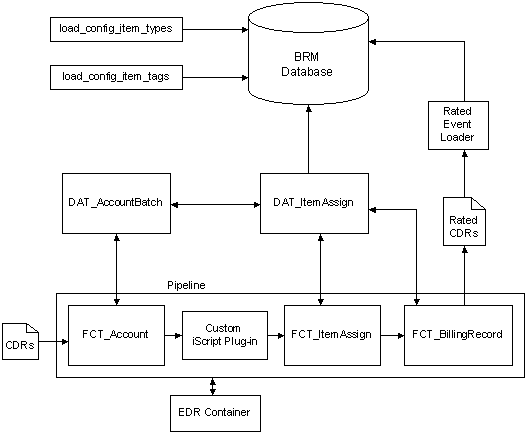

Adding Customer Balance Impact Data to EDRs
Before adding balance impacts to an EDR, you must configure internal service codes. See "About Mapping Services".
Before rating an EDR, you must add the customer's balance impact data to the EDR. This data includes the following:
The POID of the service-level item that receives the balance impact.
The start and end times of the accounting cycle that applies to the event. This data assures that the charges are applied to the correct bill item.
To find the balance impact data, you configure the following modules:

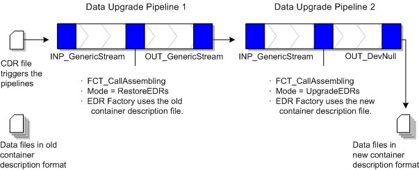

Upgrading Incomplete Calls to the New Container Description
This section explains the steps necessary to update your partially-assembled call records to a new EDR container description. These tasks are necessary to correctly process any calls that are partially assembled at the time you shut down a pipeline to make the EDR container description changes.
The tasks in this section apply only to BRM implementations that use FCT_CallAssembling. If you use an external mechanism to assemble wireless records, the instructions in "Modifying and Loading the EDR Container Description" are all you need to modify your EDR container description.
To correctly rate the incomplete calls with your new EDR container description, you must first update the data file maintained by FCT_CallAssembling. The following procedure explains how to do this by running the EDRs through two miniature pipelines that you will create. After this conversion, you can process these calls through the pipeline set up to process call records using the new container description file. Before you run the pipelines, you will also create new input and output mapping and grammar files and a new stream file.
Figure 13-2 shows the process of upgrading stored EDRs to a new EDR container description.
Figure 13-2 Incomplete Call Description Update Process
Description of "Figure 13-2 Incomplete Call Description Update Process"
Using the RestoreEDRs and UpgradeEDRs modes, FCT_CallAssembling does not assemble calls. Instead, it only migrates them from one format to another.
Follow these steps to update EDRs being stored by FCT_CallAssembling to your new EDR format. This procedure assumes that you have already created your new container description file. For details see "Modifying EDR Container Descriptions".
Run this entire procedure for each EDR container being changed.
If you are upgrading multiple pipelines to the new container description, you only need to create one set of data upgrade pipelines. You can use them to upgrade all FCT_CallAssembling pipelines getting the new container description.
Run the pin_container_to_stream_format utility on your old EDR container description file.
For example:
pin_container_to_stream_format -c oldcontainer.dsc -g OLD_ -m OLD_ -s OLD_
This creates the stream, input and output grammar, and input and output mapping files that you will use to convert the partially assembled EDRs.
(Optional) Make any changes to the data fields in the new input grammar file to match your new EDR container description. The new container description file will have automatically supplied any necessary field additions. Edit the grammar file to specify any other changes to existing fields.
Create data upgrade pipeline 1. This pipeline will have only the following modules:
INP_GenericStream using your old input mapping file (actually any input mapping file can be used here).
FCT_CallAssembling. Set Mode=RestoreEDRs and set the EdrFactory description entry to your old container description file.
OUT_GenericStream using the output mapping created by pin_container_to_stream_format in Step 1.
Create data upgrade pipeline 2. This pipeline will have only the following modules:
INP_GenericStream using the input mapping file created by pin_container_to_stream_format in Step 1 (modified as needed).
FCT_CallAssembling. Set Mode=UpGradeEDRs and set the EdrFactory description entry to your new container description file created in Step 1.
OUT_DevNull (removes the single CDR file you send in to initiate the pipelines).
Use a semaphore to stop the rating pipeline that is receiving the EDR container change. Wait for it to stop completely.
Back up the following files used by FCT_CallAssembling in your rating pipeline:
The most recent .dat file
All .EDR files
The most recent .INDEX file
Copy the most recent .dat file used by FCT_CallAssembling in your rating pipeline to the data directory used by FCT_CallAssembling in data upgrade pipeline 1 and data upgrade pipeline 2.
Copy the .EDR file used by FCT_CallAssembling from your rating pipeline to the EDR directory used by FCT_CallAssembling in data upgrade pipeline 1.
Copy the most recent .INDEX file used by FCT_CallAssembling in your rating pipeline to the index directory used by FCT_CallAssembling in data upgrade pipeline 1.
Use a semaphore to start the data upgrade pipelines.
Put one disposable CDR file in the input directory for data migration pipeline 1 to trigger the data upgrade. This file need only contain a single CDR, but it must use your old EDR container description format.
This CDR is needed only to start EDR processing; it will get dropped during processing.
Ensure that data upgrade pipeline processes have finished. The time required for these pipelines to update all EDRs varies with the number EDRs being updated.
Use a semaphore to stop the data upgrade pipelines.
Move the .dat and .EDR files from the data upgrade pipeline 2 output directory to the input directory of the FCT_CallAssembling pipeline receiving the EDR container change.
Install the new EDR container description in your rating pipeline, and start the pipeline.
This completes the process of upgrading all EDRs stored in FCT_CallAssembling while upgrading your EDR container description. These incomplete calls are processed normally.

How Batch Rating Assigns Custom Bill Items
BRM batch rating uses the FCT_ItemAssign pipeline module to assign items based on event and service combinations and uses custom iScripts to assign items based on event attributes.
To assign items to events, Pipeline Manager performs these tasks:
During initialization, the DAT_ItemAssign module loads the specified /config/item_types object into memory and reserves a pool of POID IDs. If the information in the DAT_ItemAssign config object changes, you can use the DAT_itemAssign module's Reload semaphore to refresh the configuration changes.
Your custom iScript assigns an item tag based on event attributes to the DETAIL.ITEM_TAG EDR field.
FCT_ItemAssign calls DAT_ItemAssign with the item tag in the DETAIL.ITEM_TAG EDR field.
DAT_ItemAssign retrieves the item POID list from the DAT_AccountBatch module.
DAT_ItemAssign retrieves the item type for the given item tag from the config/item_types object in memory and searches the POID list for a matching item type.
If DAT_ItemAssign finds a matching POID, it returns that item POID (for example, 1 /item/new_york m m) to FCT_ItemAssign.
If DAT_ItemAssign does not find a matching POID, it creates a new POID ID from the POID pool it reserved and returns the new POID ID to FCT_ItemAssign.
When the DAT_ItemAssign module creates new items, it updates DAT_AccountBatch with the new items it created; for example, 1 /item/new_york m m.
If the DETAIL.ITEM_TAG field is NULL, DAT_ItemAssign returns a default item POID from the item POID list.
The FCT_ItemAssign module assigns the item POID that it retrieves to the DETAIL.CUST_A.PRODUCT.SERVICE_USED_ITEM_POID EDR field for the product used for rating the event.
For sponsored usage events, the following occurs:
The FCT_BillingRecord module queries the DAT_ItemAssign module for items when required.
The DAT_ItemAssign module returns the pre-created items of type /item/sponsor to FCT_BillingRecord for sponsored events.
When the DAT_ItemAssign module creates new items, it updates DAT_AccountBatch with the new items it created; for example, 1 /item/sponsor m m.
Pipeline Manager generates the rated events.
You use Rated Event (RE) Loader to load the rated events into the BRM database and to update the account balances and create or update bill items.
Figure 13-3 shows how items are assigned to events:
