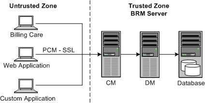

Figure 2-1 shows secure communications between BRM components using TLS.
Figure 2-1 Secure Communications Using TLS
Description of Figure 2-1 follows
Description of "Figure 2-1 Secure Communications Using TLS"
The BRM pipeline batch rating engine and BRM real-time pipeline used for advanced discounting do not support SSL/TLS connections. Therefore, the communication between the BRM CM and the batch rating pipeline/real-time discounting pipeline is not encrypted.
See "Enabling Secure Communication between BRM Components" in BRM System Administrator's Guide for more information.
