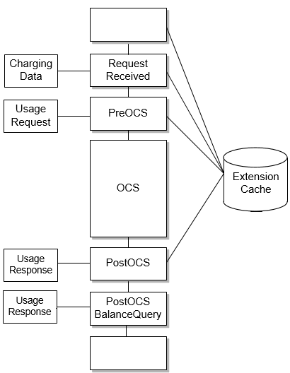

HTTP Gateway Request Processing Extension Points
HTTP Gateway provides extension points for 5G flows:
RequestReceived extension. The role of the RequestReceived extension is to manipulate the charging data before the usage request is processed by HTTP Gateway and to provide an immediate response that bypasses the online charging system (OCS) completely.
PreOCS extension. The role of the PreOCS extension is to manipulate the mapped ECE usage request payload to perform enrichments that are not possible in the RequestReceived extension.
PostOCS extension. The role of the PostOCS extension is to manipulate the ECE usage request before the HTTP Gateway response is returned to the 5G client.
PostOCSBalanceQuery extension. The role of the PostOCSBalanceQuery extension is to manipulate the ECE usage response before the HTTP Gateway response is returned to the 5G client.
Figure 26-2 shows the HTTP Gateway request processing extension points.
Figure 26-2 HTTP Gateway Processing Extension Points

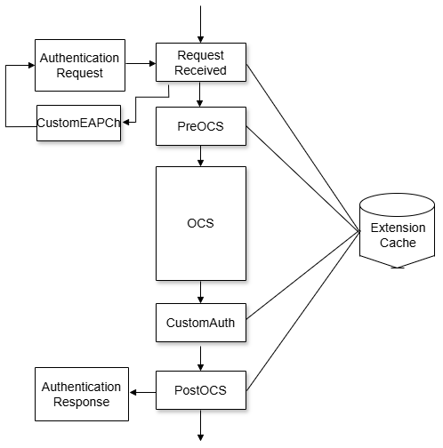

Authentication Extension Points
RADIUS Gateway provides extension points for the authentication flow:
RequestReceived extension. The role of the RequestReceived extension is to add or update a custom AVP before the authentication request is processed by RADIUS Gateway and to provide an immediate response that bypasses the OCS completely.
CustomEAPChallenge extension. The role of the CustomEAPChallenge extension is to send custom access-challenge request to the RADIUS client when the Extensible Authentication Protocol (EAP) is used for authentication.
RadiusAuthPreProcessorExtension extension. The role of the RadiusAuthPreProcessorExtension extension is to provide access to subscriber profile information including customer and balance data in the extension hooks in the authentication flow of the RADIUS Gateway.
PreOCS extension. The role of the PreOCS extension is to perform any actions related to authentication that are required before the RADIUS request is sent to ECE.
CustomAuth extension. The role of the CustomAuth extension is to implement the custom EAP authentication methods.
CustomEncode extension. The role of the CustomEncode extension is to implement the custom hashing algorithm that is used on passwords during authentication when the Password Authentication Protocol (PAP) is used for authentication.
PostOCS extension. The role of the PostOCS extension is to add or update a custom AVP before the authentication response is returned to the RADIUS client.
Figure 26-3 shows the RADIUS-request processing extension points for EAP authentication.
Figure 26-3 Extension Points for EAP Authentication
Description of "Figure 26-3 Extension Points for EAP Authentication"

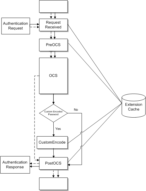

Figure 26-4 shows the RADIUS-request processing extension points for PAP and Challenge-Handshake Authentication Protocol (CHAP) authentication. The solid line depicts PAP authentication and the dotted line depicts CHAP authentication in this figure.
Figure 26-4 Extension Points for PAP and CHAP Authentication
Description of "Figure 26-4 Extension Points for PAP and CHAP Authentication"

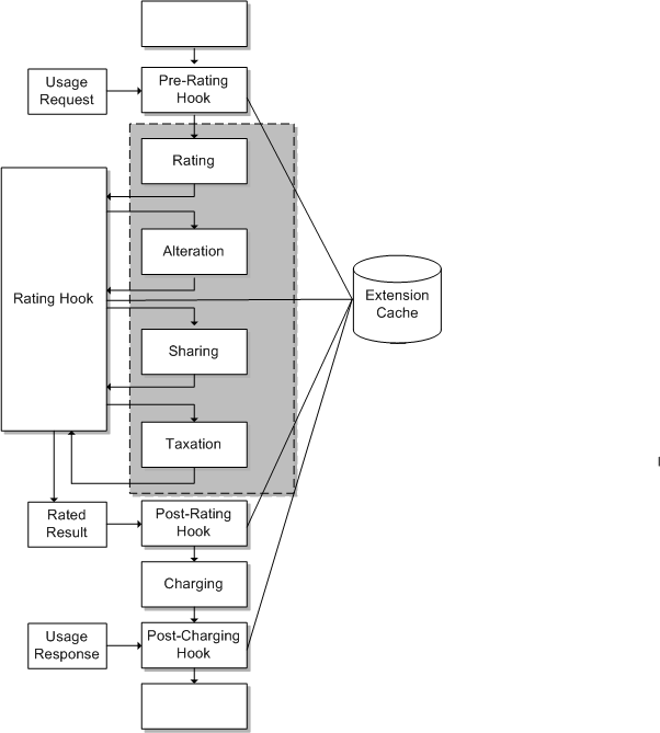

Usage-Request Processing Extension Points
ECE provides extension points in the rating flow: before charge calculation, after charge calculation (prior to making a balance impact), and after charging (after applying a balance impact).
Table 26-1 describes the role of each extension point in the rating flow.
Table 26-1 Rating Flow Extension Roles
| Extension Point | Role |
Pre-Rating Extension |
Alter the usage request |
Post Rating Extension |
Alter the rated result |
Rating Extension |
Alter rated results after each of the following processes: rating, alteration, sharing, and taxation |
Post-Charging Extension |
Enrich the usage response |
You cannot customize rating during the rating, alteration, and tax calculation processes, only before and after. Access is provided to a custom data store that provides low-latency access to data required for the extensions; for example, customer data and balance data.
Figure 26-6 shows the usage-request processing extension points.
Figure 26-6 Usage-Request Processing Extension Points
Description of "Figure 26-6 Usage-Request Processing Extension Points"

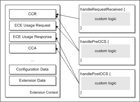

For diameter-request processing extension points, a different method is called for each extension point.
handleRequestReceived(). Called for every CCR that is processed by the charging flow.
handlePreOCS(). Called for every CCR and usage request that is processed by the charging flow.
handlePostOCS(). Called for every CCA and usage response that is processed by the charging flow.
All methods expose relevant ExtensionContext data for accessing the ExtensionsDataRepository, AppConfigRepository, and other extensions-related contexts.
Figure 26-7 shows the data used in the diameter-request processing extension points.
Figure 26-7 Data Used in Diameter-Request Processing Extension Points

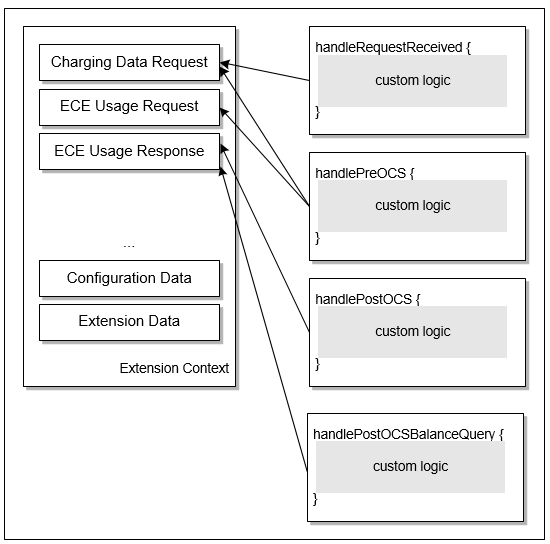

For HTTP-request processing extension points, a different method is called for each extension point.
handleRequestReceived(). Called for every charging data request that is processed by the charging flow.
handlePreOCS(). Called for every usage request that is processed by the charging flow.
handlePostOCS(). Called for every usage response that is processed by the charging flow.
handlePostOCSBalanceQuery(). Called for every usage response that is processed by the charging flow.
Figure 26-8 shows the data used in the HTTP-request processing extension points.
Figure 26-8 Data Used in HTTP-Request Processing Extension Points

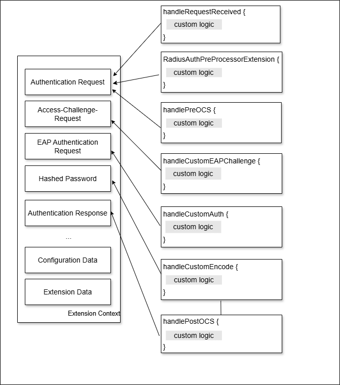

For extension points that process requests from RADIUS clients, the RadiusRequest and RadiusReply interfaces are exposed to the extension points through the ExtensionContext methods.
For authentication-related extension points, the following methods are called by the authentication flow:
handleRequestReceived(). Called for every authentication request that is processed by the authentication flow.
handlePreOCS(). Called to perform any actions related to authentication that are required in the authentication flow.
handlePostOCS(). Called for each authentication response that is processed by the authentication flow.
handleCustomEAPChallenge(). Called to send custom access-challenge requests to the RADIUS client in the EAP authentication flow.
handleCustomAuth(). Called to implement a custom EAP authentication method in the authentication flow.
handleCustomEncode(). Called to implement the custom hashing algorithm that is used on passwords in the PAP authentication flow.
Figure 26-9 shows the data used in the RADIUS-request processing extension points for authentication.
Figure 26-9 Data Used in RADIUS-Request Processing Extension Points for Authentication

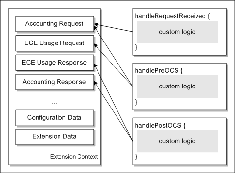

For accounting-related extension points, the following methods are called by the accounting flow:
handleRequestReceived(). Called for every accounting request that is processed by the accounting flow.
handlePreOCS(). Called for every accounting request and usage request that is processed by the accounting flow.
handlePostOCS(). Called for every accounting response and usage response that is processed by the accounting flow.
Figure 26-10 shows the data used in the RADIUS-request processing extension points for accounting.
Figure 26-10 Data Used in RADIUS-Request Processing Extension Points for Accounting

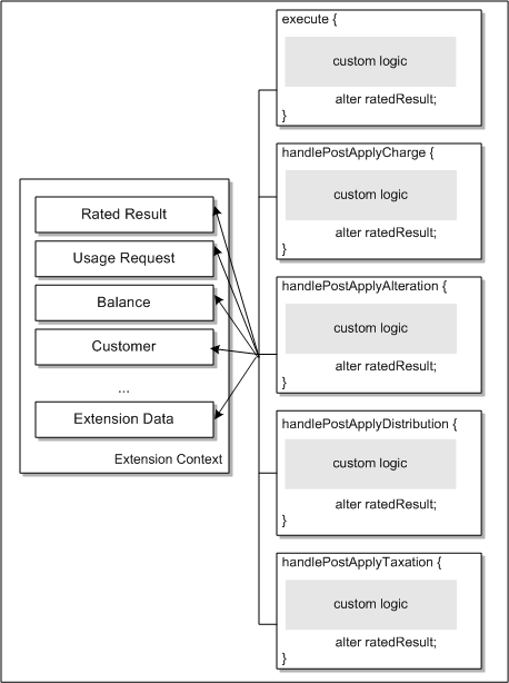

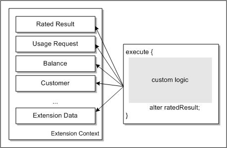

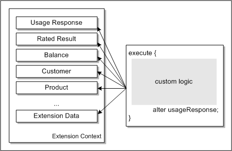

For usage-request processing extension points, the execute() method is called for every usage request, rated result, usage response, and notification that is processed by the charging flow.
For the rating extension point, the following methods are called by the charging flow:
handlePostApplyCharge(). Called to alter rated results after calculating charges (rating).
handlePostApplyAlteration(). Called to alter rated results after calculating discounts (alteration).
handlePostApplyDistribution(). Called to alter rated results after calculating charge distribution (sharing).
handlePostApplyTaxation(). Called to alter rated results after calculating taxes (taxation).
Figure 26-11 shows the data used in the pre-rating extension point.
Figure 26-11 Data Used in Pre-Rating Extension Point
Figure 26-12 shows the data used in the rating extension point.
Figure 26-12 Data Used in Rating Extension Point
Figure 26-13 shows the data used in the post-rating extension point.
Figure 26-13 Data Used in Post-Rating Extension Point
Figure 26-14 shows the data used in the post-charging extension point.
Figure 26-14 Data Used in Post-Charging Extension Point

CustomAuth Extension
The CustomAuth extension implements custom EAP authentication methods; for example, EAP-POTP, EAP-PSK etc.
The extension can access this data:
EAP-Authentication-Request
System configuration
You can use a custom EAP authentication method if the RADIUS client does not support EAP-TTLS or EAP-MD5.
CustomEAPChallenge Extension
The CustomEAPChallenge extension sends a custom access-challenge request to the RADIUS client when custom EAP authentication mechanisms are used for authentication.
Access-Challenge-Request
Extensions data
You can use the extension point to send the custom access-challenge request to the RADIUS client when EAP is used for authentication.
CustomEncode Extension
The CustomEncode extension implements the custom hashing algorithm that is used on passwords for authentication.
Encoded Password
Extensions data
You can use the custom hashing algorithm on passwords for authentication. For example, typically the password from the RADIUS client is hashed (stored in the hash format) for PAP authentication. However, if the password is hashed in any other format, you implement the CustomEncode extension point to hash the incoming password.

PreOCS Extension
The PreOCS extension manipulates usage request payloads before the usage request is sent to ECE, so that the request can match the business requirement. In addition, the PreOCS extension performs any actions related to authentication that are required before the request is sent to ECE. This extension is called before any rating, discounting, or alteration logic has been invoked.
Credit Control Request
Authentication Request
Accounting Request
ECE Usage Request
Extensions data
You can modify the ECE usage request payload. For example, certain usage request manipulations can be made only when the ECE usage request payload is accessible. The usage request manipulations are done in this extension.
The post-rating extension modifies the rated event based on customer, service, balance, product, and system data. This extension is called after any rating, discounting, or alteration logic has been invoked.
Balance information
Customer data (including profile data)
ECE usage request information
Product information
Shared customers (if part of a sharing relationship)
Service data (including profile data)
Extensions data
Rated result
You can modify rated events in the following ways:
You can modify the balance impact amount, GL code, tax code, balance element or invoice data for rating impacts generated from ECE.
Generate a midsession-rated event when an update operation occurs. This is implemented in the sample extensions provided.
You can also create new tax rating impacts, such as implementing a tax on tax.
Rating Extension
The rating extension modifies the rated results after each of the following processes: rating, alteration, sharing, and taxation.
Customer (including profile)
Shared customer (if part of a sharing relationship)
Product (including profile)
Balance information
Extensions
Rated result
You can alter rated results to modify charges, discounts, charge sharing, taxes, and item assignments. For example:
After rating, you can alter charges based on the zones, such as standard and geographic zones.
After taxation, you can alter custom item types for the rating impacts generated from ECE, such as charge, alteration, and distribution rating impacts.
RequestReceived Extension
The RequestReceived extension manipulates the CCR, charging data request, authentication request, or accounting request so that the request can match the business requirement and provides an immediate response that bypasses the OCS completely. This extension is called before any rating, discounting, or alteration logic has been invoked.
Accounting Request
Extensions data
You can modify the CCR, authentication, or accounting request. For example, you can manipulate AVPs to adapt to non-standard diameter implementations. Certain CCR, authentication, and accounting request types may not be supported by ECE, Diameter Gateway, or RADIUS Gateway, so a response can be created in this extension and returned immediately, bypassing the OCS.

The sample program SampleHTTPExtension shows how to use the ECE Extensions API to override the requested number of units and perform call screening.
The handleRequestReceived() method overrides the requested units for a call.
The handlePreOCS() method sets the timestamp of when the call originally occurred.
The handlePostOCS() method logs a message when call screening is done and returns a response to the 5G client.
The handlePostOCSBalanceQuery() method logs a message when a balance query occurs and returns a response to the 5G client.
