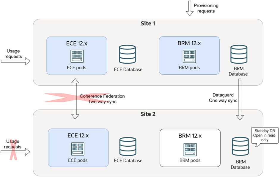

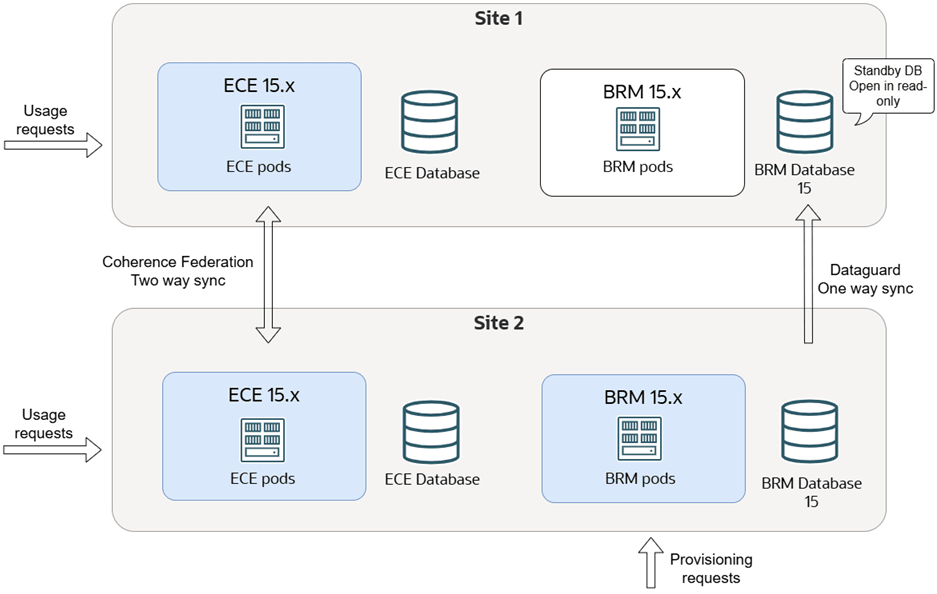

Figure 18-1 shows initial state of a BRM cloud native active-active disaster recovery system.
Figure 18-1 Initial State of BRM Cloud Native Active-Active Disaster Recovery System

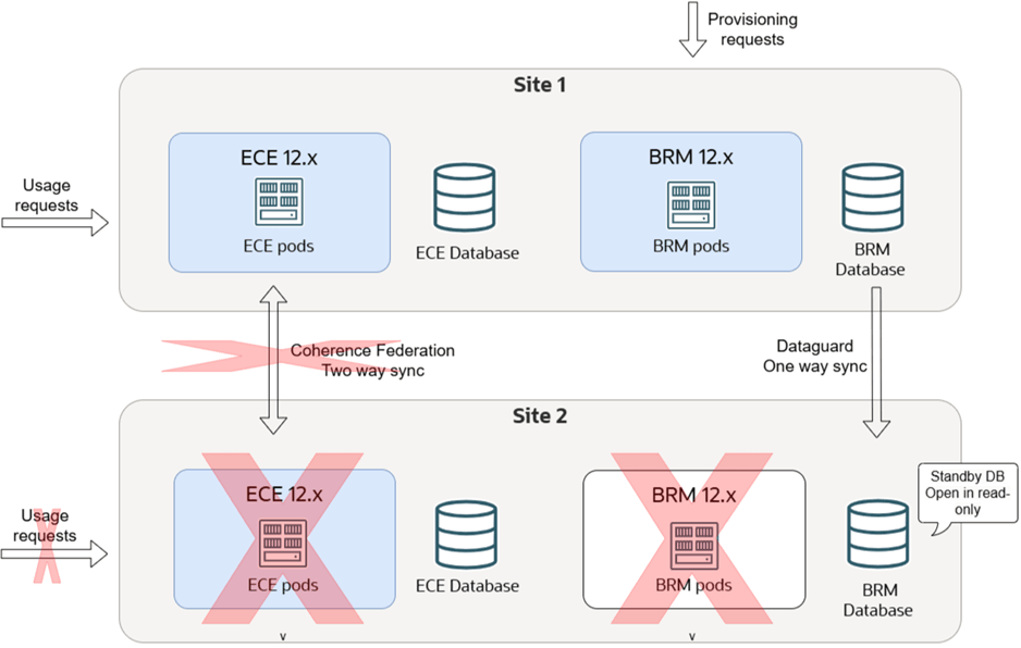

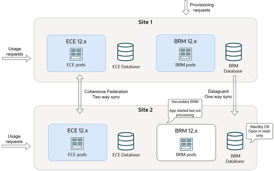

  1. Stop all usage requests to Site 2 and direct all usage requests to Site 1, as shown in Figure 18-2.
    Figure 18-2 Usage Requests for Switching Off Site 2

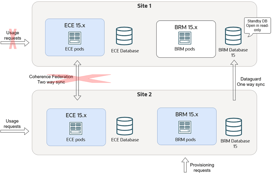

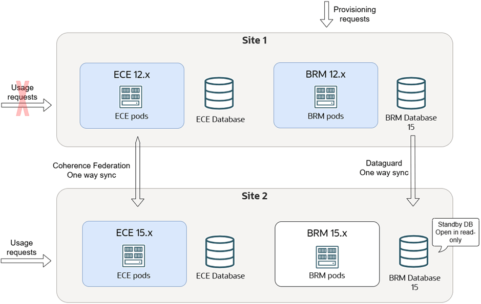

  4. Disable the federation from ECE Site 1 to Site 2, as shown in Figure 18-3.
    Keep the Site 2 to Site 1 federation active to drain any remaining data from Site 2.
    Figure 18-3 Disabled Federation from ECE Site 1 to Site 2

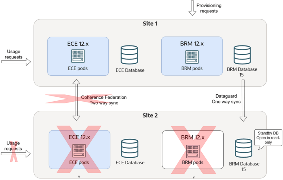

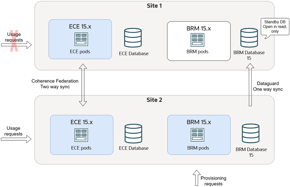

  8. Stop the federation process from Site 2 to Site 1, as shown in Figure 18-4.
    Figure 18-4 Stopped Federation from ECE Site 2 to Site 1
All data is now synchronized with Site 1. Site 2 is isolated and ready for the upgrade.

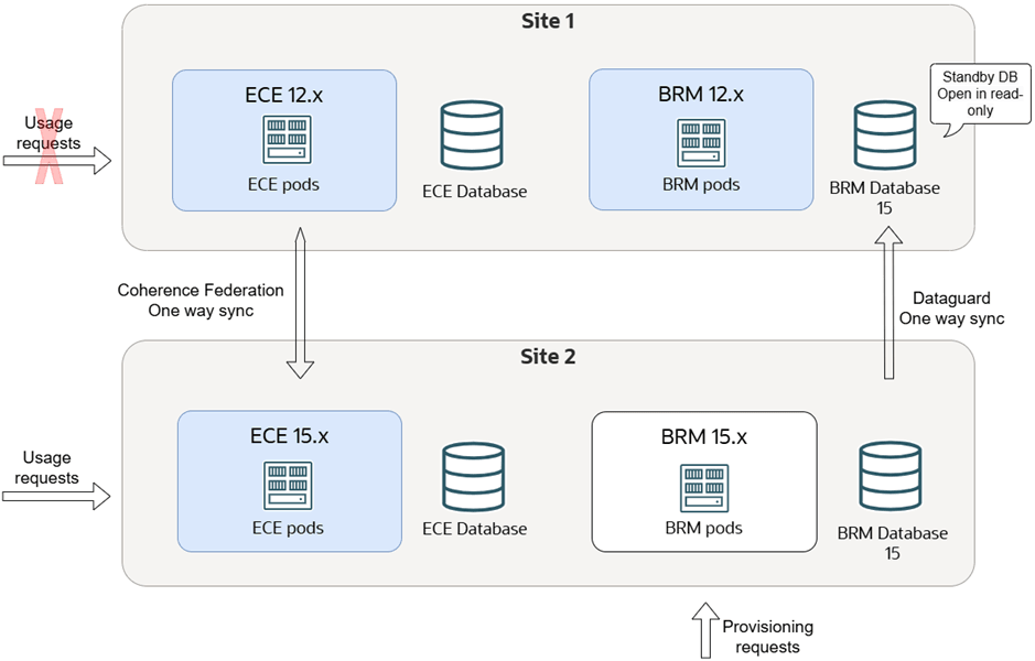

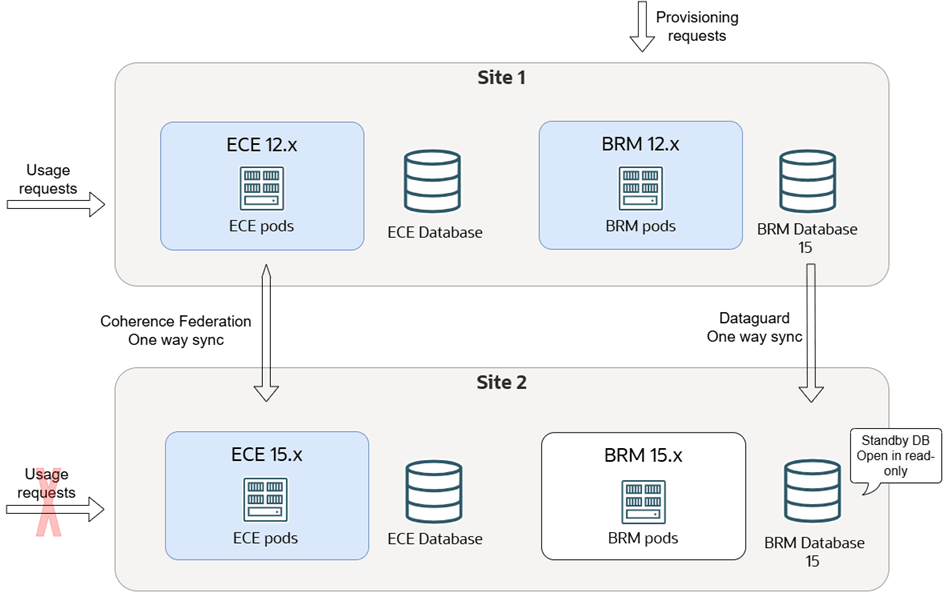

Figure 18-5 shows how to uninstall BRM and ECE from Site 2.
Figure 18-5 Uninstall BRM and ECE from Site 2

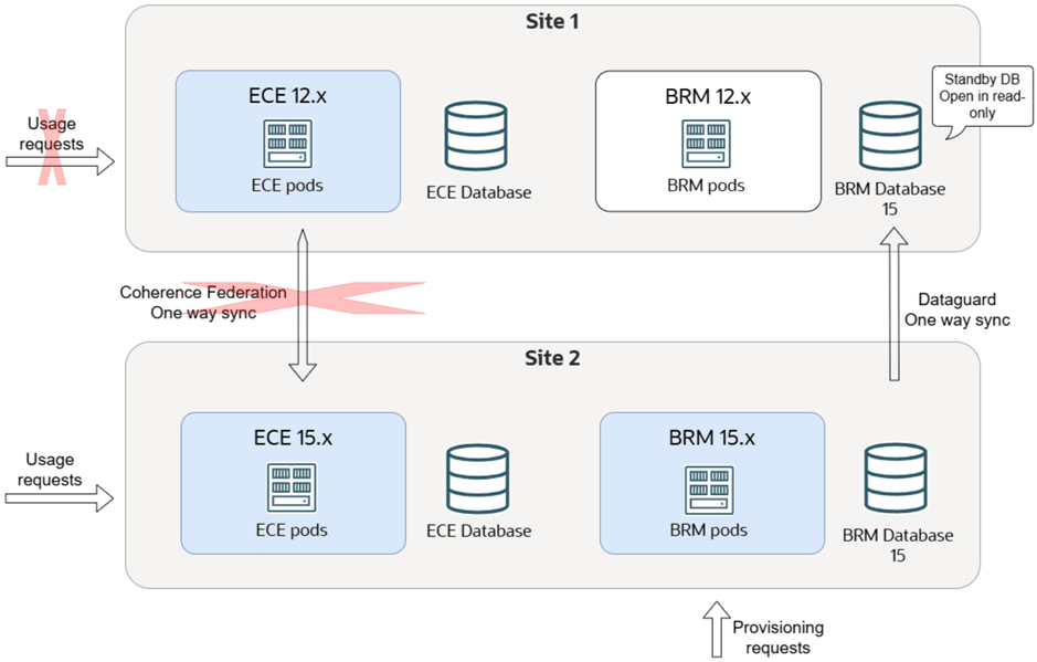

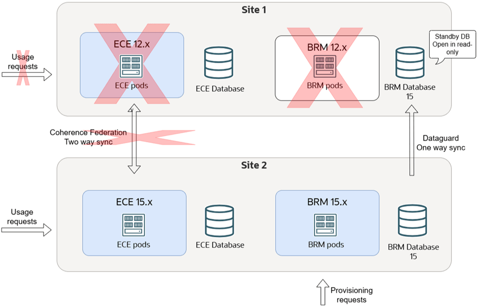

Figure 18-6 shows an upgraded BRM database schema in Site 2.
Figure 18-6 Upgraded BRM Database Schema in Site 2

  2. Start the Coherence federation process from Site 1 to Site 2, as shown in Figure 18-8. This provisions the empty ECE Site 2 cache with the latest data from Site 1.
    Figure 18-8 Coherence Federation Process from Site 1 to Site 2
  3. On Site 2, mark Site 1 inactive to ensure no preferred site routing occurs from Site 2 to Site 1.
    Site 1 also has Site 2 marked as inactive.
  4. Check that the federation process is up to date. After the federation process completes successfully:
    • The ECE pods in Site 2 transition to the Running state.
    • Site 2 transitions to the Usage Processing state and spawns Monitoring Agent pods.
    Follow the steps in "Reloading ECE Application Configuration Changes" in the BRM Cloud Native System Administrator's Guide to update the values:
    • Under brmGatewayConfigurations set the kafkaPartition value to 3.
    • Under httpGatewayConfigurations set the kafkaPartition value to 5,6,7,8,9.
  5. Stop all usage requests to Site 1 and then redirect them to Site 2, as shown in Figure 18-9.
    Figure 18-9 Usage Requests for Failing Over Site 1 to Site 2

  10. Stop the federation process from Site 1 to Site 2, as shown in Figure 18-11.
    Site 1 is isolated and ready for the upgrade.
    Figure 18-11 Stopped Federation Process from Site 1 to Site 2
Uninstalling BRM and ECE from Site 1
Uninstall the old version of BRM and ECE from Site 1.
To do so, perform the following steps on Site 1:
  1. Uninstall the old version of BRM cloud native:
    helm uninstall BrmReleaseName --namespace BrmNameSpace
  2. Uninstall the old version of ECE cloud native:
    helm uninstall EceReleaseName --namespace BrmNameSpace
where:
  • BrmReleaseName is the release name for oc-cn-helm-chart and is used to track this installation instance.
  • EceReleaseName is the release name for oc-cn-ece-helm-chart and is used to track this installation instance.
  • BrmNameSpace is the namespace in which to create BRM Kubernetes objects for the BRM Helm chart.
These commands delete all of the resources associated with the chart's last release and the release history.
Figure 18-12 shows uninstallation of BRM and ECE from Site 1.
Figure 18-12 Uninstallation of BRM and ECE from Site 1

  1. Enable the two-way federation process between Site 1 and Site 2, as shown in Figure 18-14.
    Figure 18-14 Federation of ECE Cache Data Between Sites
  2. Check that the federation backlog is processed successfully.
    After the federation process completes, ECE in Site 1 transitions to the Usage Processing state and spawns the Monitoring Agent pods.
  3. In ECE Site 1, mark ECE in Site 2 as active. Likewise, in ECE Site 2, mark ECE in Site 1 as active.
    This enables usage rating requests to be forwarded to the subscriber's preferred site.
  4. Enable usage requests to Site 2, as shown in Figure 18-15.
    Figure 18-15 Enabled Usage Requests for Site 2
