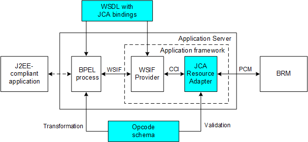

When a J2EE-compliant application sends a request to the application server, the Business Process Execution Language (BPEL) process on the server routes the request to the adapter within the application framework. Figure 1-1 illustrates the architecture of the JCA Resource Adapter.
Figure 1-1 JCA Resource Adapter Architecture
Description of "Figure 1-1 JCA Resource Adapter Architecture"
When the adapter receives the request, it performs the following tasks:
Retrieves the opcode to call from the interaction specification.
Optionally validates the input XML against the schema for the target opcode.
Converts the input XML into an input flist.
Calls the BRM opcode through the BRM context using the opcode name, opcode flags, and other attributes passed in the interaction specification.
The opcode processes the request and returns the result in an output flist to the adapter. The adapter then performs the following tasks:
Converts the opcode's output flist into output XML and stores it in the payload of the output XML record.
Optionally validates the output XML against the schema for the opcode.
Returns the output XML to the calling application.
In case of an error, returns a resource exception.
