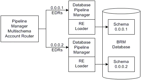

About Using RE Loader in a Multischema System
If you use a multischema system, you must set up the following for each BRM database schema in your system:
  • Pipeline Manager instance. Each instance of Pipeline Manager must also have its own set of output files.
  • RE Loader instance. Each instance of RE Loader must also have its own set of RE Loader processing directories.
  • (Running RE Loader automatically only) An instance of Batch Controller and the RE Loader batch handler.
You must also install and configure a separate instance of Pipeline Manager. This Pipeline Manager multischema account router routes EDRs to the appropriate schema Pipeline Manager instance based on the account's database number.
Figure 2-2 shows the flow of data in a multischema system:
Figure 2-2 Multischema System Data Flow
Setting Up RE Loader for Multischema Systems
To set up RE Loader for multischema systems:
  1. Install and configure one instance of Pipeline Manager for each BRM database schema and one instance for the multischema account router.
    For example, if your BRM system contains three schemas, install and configure four instances of Pipeline Manager.
  2. In the multischema account router instance of Pipeline Manager, configure the following:
    1. Set the FCT_AccountRouter module's Mode registry entry to ROUTER and configure the module's streams registry entry to create an output stream for each schema Pipeline Manager instance. See "FCT_AccountRouter" in BRM Pipeline Manager Reference.
    2. Set the DAT_AccountBatch module's UseAsRouter registry entry to True. See "DAT_AccountBatch" in BRM Pipeline Manager Reference.
