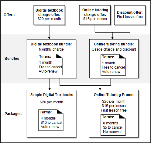

Bundles: Bundles group charge offers and discount offers together for a single service. For example, you could create:
A bundle for a cable service that charges $50 per month for a standard subscription and premium channels, and provides a 20% discount for the first six months of the standard subscription.
A bundle for an Internet service that charges $65 per month for high-speed internet and $9 per month for a modem rental.
Bundles can also be associated with terms.
Packages: Packages contain one or more bundles. You use packages to offer multiple services to subscribers. For example, you can include two bundles: one for an Internet service and one for a conferencing service.
Packages can also be associated with terms, and those terms govern any required bundles. Optional add-on bundles can be governed by separate, preset terms.

Figure 1-1 shows how charge offers and discount offers are organized into bundles and packages with associated terms.
Figure 1-1 Grouping Offers into Bundles and Packages
