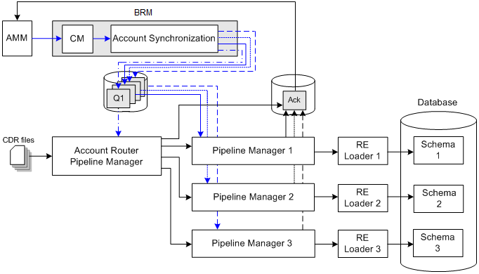

Figure 6-1 shows AMM interaction with the Pipeline Manager.
To coordinate account migration with your pipelines:
                        AMM notifies the pipelines about a job's migration status by sending business events. See "About Notifying the Pipelines About Account Migration".
                        The pipelines notify AMM about EDR processing status by sending acknowledgment events. See "About Notifying AMM About EDR Processing".
                        The account-router Pipeline Manager suspends, recycles, and routes EDRs. See "About the Account Router Instance of the Pipeline Manager".

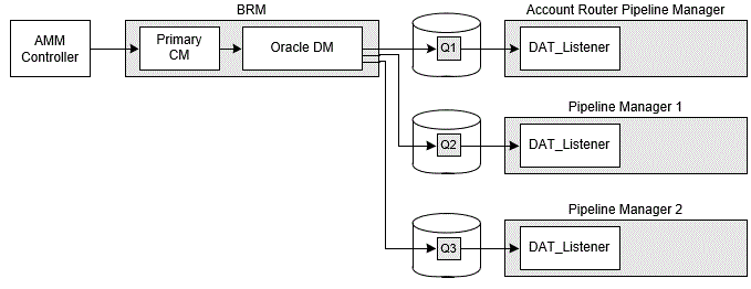

About Sending AMM Business Events to the Pipelines
AMM sends business events to the pipelines by using a series of AQ database queues. Each instance of the Pipeline Manager contains its own queue, which is dedicated to receiving business events from BRM and AMM.
If configured to do so, AMM also sends business events to a queue for external applications.
AMM sends business events to a Pipeline Manager as follows:
                              AMM sends an event to the primary Connection Manager (CM).
                              The primary CM sends the event to the Oracle DM.
                              The Oracle DM uses its aq_event_map file to publish the business event to the appropriate queue.
                              The Pipeline Manager's DAT_Listener module dequeues the event and then forwards it to the appropriate pipeline data module.
You configure your system to send AMM business events to your pipelines by:
                              Connecting AMM to the primary CM.
                              Creating an AQ database queue for each instance of the Pipeline Manager.
                              Configuring Oracle DM to publish AMM business events to your queues.
                              Configuring each instance of the Pipeline Manager to dequeue AMM business events from its associated queue.
Figure 6-2 shows the AMM business events process described. See "Configuring AMM to Send Business Events to Your Pipelines".

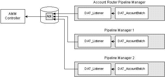

About Sending Acknowledgments to AMM
Each instance of the Pipeline Manager sends acknowledgment events to AMM by using a dedicated acknowledgment queue as shown in Figure 6-3.
Each Pipeline Manager sends acknowledgments as follows:
                              The DAT_AccountBatch module sends an acknowledgment event to the DAT_Listener module.
                              The DAT_Listener module publishes the event to the acknowledgment queue.
                              The AMM Controller dequeues the event.
Figure 6-3 Sending Pipeline Acknowledgement Events to AMM
To configure your pipelines to send acknowledgments to AMM, you must:
                              Configure the DAT_Listener module in each instance of the Pipeline Manager to publish acknowledgment events.
                              Create a single database queue that is dedicated to acknowledgment events. All instances of the Pipeline Manager use this single queue.
                              Configure the AMM Controller to dequeue events from the acknowledgment queue.
For more information, see "Configuring Your Pipelines to Send Acknowledgments to AMM".

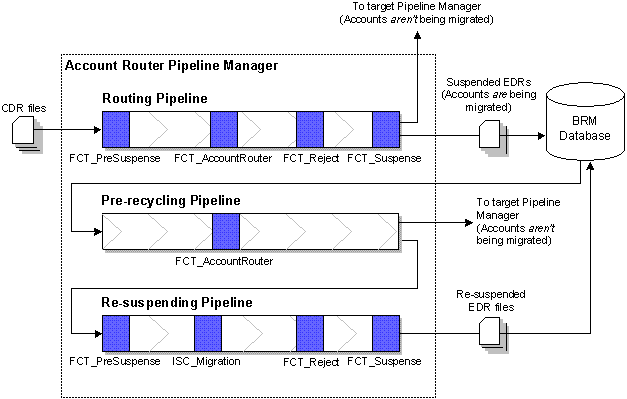

The account router instance of the Pipeline Manager is used in multischema systems to route EDRs to the correct instance of the Pipeline Manager. For example, EDRs targeted for accounts that reside in database schema 3 are routed to the Pipeline Manager instance associated with schema 3.
When configured for migration, the account-router Pipeline Manager also performs the following tasks:
                           Suspends EDRs targeted for accounts that are undergoing migration. See "About Suspending Call Records".
                           Recycles previously suspended EDRs. See "About Reprocessing Suspended Call Records".
You configure the account-router Pipeline Manager for migration by creating three separate pipelines:
                           A routing pipeline that routes EDRs to the appropriate instance of the Pipeline Manager and suspends any EDRs targeted for accounts undergoing migration. This pipeline must include the FCT_AccountRouter module, set to router mode; the FCT_PreSuspense module; the FCT_Reject module; and the FCT_Suspense module.
                           A pre-recycling pipeline that processes previously suspended EDRs, determines whether an EDR is targeted for an account undergoing migration, and then routes the EDR to the appropriate output stream. This pipeline must include the FCT_AccountRouter module, set to recycle mode.
                           A resuspending pipeline that automatically suspends all EDRs. This pipeline must include the FCT_PreSuspense module, the ISC_Migration iScript, the FCT_Reject module, and the FCT_Suspense module.
You must also configure the account router data pool to pass migration status information to your pipelines. Figure 6-4 shows the necessary pipelines and account router data pool.
Figure 6-4 Account Router Pipeline Manager
For information on how to configure the account-router Pipeline Manager, see "Configuring Your Account-Router Pipeline Manager".
The account-router Pipeline Manager initially routes and suspends call records in the routing pipeline.
After AMM notifies the account-router Pipeline Manager that a job is being migrated, the routing pipeline performs the following:
                              (Optional) The FCT_CallAssembly module assembles EDRs that were split into multiple records. Note: Any call assembling must occur in the account router instance of the Pipeline Manager and not in other instances.
                              (Optional) The FCT_DuplicateCheck module checks whether EDRs have been previously rated by the Pipeline Manager. Note: Any checking for duplicate EDRs must occur in the account router instance of the Pipeline Manager and not in other instances.
                              The FCT_PreSuspense module adds suspense-related data to the EDR.
                              The FCT_AccountRouter module, set to Router mode: -
                                    Flags the EDR for the target Pipeline Manager.
                                    Determines whether an EDR is for an account undergoing migration. If it is, FCT_AccountRouter flags the EDR for suspension.
                              The FCT_Reject module routes EDRs with a specified error status, such as warning or critical, to the suspense output stream.
                              The FCT_Suspense module determines whether an EDR is flagged for suspension. If it is, FCT_Suspense places the EDR in a separate suspense output stream, where it is eventually loaded into the BRM database by the Suspense Event (SE) Loader. Note: You can use either standard recycling or Suspense Manager with AMM.
After AMM successfully migrates a job, it calls the PCM_OP_SEARCH_RECYCLE opcode to recycle previously suspended EDRs through the pipeline. Then, the account-router Pipeline Manager recycles suspended EDRs through the pre-recycling pipeline and the resuspending pipeline.
The account-router Pipeline Manager recycles EDRs as follows:
                              In the pre-recycling pipeline, the FCT_AccountRouter module, set to Recycle mode, determines whether an EDR is targeted for an account that is being migrated by a new job. -
                                    If the account is being migrated by a new job, FCT_AccountRouter flags the EDR for suspension and routes the EDR to a separate suspense output stream, where it is processed by the resuspending pipeline.
                                    If the account is not being migrated, FCT_AccountRouter flags the EDR for the appropriate instance of the Pipeline Manager. The EDR is then rated by the target Pipeline Manager.
                              The resuspending pipeline automatically routes EDRs to a separate suspense output stream, which is eventually loaded into the BRM database by Suspense Event (SE) Loader. -
                                    The ISC_Migration iScript automatically flags the EDR for suspension.
                                    The FCT_Reject module routes EDRs with a specified error status to the suspense output stream.
                                    The FCT_Suspense module routes the EDR to a suspense output stream, which is eventually loaded into the BRM database by SE Loader.

Configuring Your Pre-recycling Pipeline
You configure your pre-recycling pipeline to recycle or suspend EDRs by using the FCT_AccountRouter module set to Recycle mode. Make sure you also set the following FCT_AccountRouter registry entries:
                              Use the Active entry to enable this module.
                              Use the Mode entry to specify Recycle mode.
                              Use the Streams entry to map EDRs to the appropriate output stream.
Configuring Your Resuspending Pipeline
You configure your resuspending pipeline to automatically suspend all EDRs by using the following pipeline modules:
                              FCT_PreSuspense. To make suspense fields queryable in Suspense Management Center, set the following FCT_PreSuspense registry entries: -
                                    Use the QueryableFields entry to specify the tables and fields that you can perform queries on in Suspense Management Center.
                              ISC_Migration. To automatically flag all EDRs for suspension, set the following ISC_Migration registry entries: -
                                    Use the Filename entry to specify the path to the ISC_Migration file.
                              FCT_Reject. To route EDRs with a specified error status to the suspense output stream: -
                                    Set the UseRejectStream entry to True. This sends EDRs to the reject stream.
                                    Use the MinErrorSeverity entry to reject EDRs that have the specified error severity.
                                    Use the StreamMap entry to map errors to specific output streams. Note: You must also configure an instance of the Out_Reject module for rejected EDRs. All rejected EDRs must be set to the suspense output stream.
                              FCT_Suspense. To send EDRs to the suspense output stream, set the following FCT_Suspense registry entries: -
                                    Use the SuspenseCreateStream entry to specify the output stream for suspended EDRs.
                                    Use the SuspenseUpdateStream entry to specify the output stream for recycled EDRs.
                                    Use the DataConnection entry to specify how to connect to the BRM database.

Configuring Synchronization of AMM Business Events
You configure BRM to send AMM business events to the appropriate instance of the Pipeline Manager by performing the following:
                              Configuring BRM to synchronize account data with Pipeline Manager. See "Synchronizing Account Data between BRM and Pipeline Manager" in BRM System Administrator’s Guide.
                              Creating Oracle Advanced Queuing (AQ) database queues for sending AMM business events to your pipelines. You must create a queue for each Pipeline Manager instance in your system. See "Configuring Your AQ Database Queues for AMM Business Events".
                              Mapping the AMM business events to your AQ database queues. See "Mapping AMM Business Events to Your Queues".
The account synchronization process uses a set of AQ database queues to send both BRM events and AMM business events to your pipelines.
Each instance of Pipeline Manager must have its own queue. For example, if your system contains three BRM database schemas, you must have four queues. That is, one for each of the following instances:
                              Account-router Pipeline Manager
                              Pipeline Manager for BRM database schema 1
                              Pipeline Manager for BRM database schema 2
                              Pipeline Manager for BRM database schema 3 Note: You must create a separate queue for any external applications requiring account migration notifications.
If your system does not already contain a queue for each instance of the Pipeline Manager, you can create additional queues by using the pin_publish_aq_oracle.pl utility.
For information about creating and configuring your AQ database queues, see "Configuring Your AQ Database Queues" in BRM System Administrator's Guide.

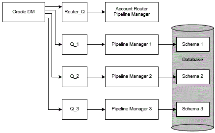

You map which types of events the Oracle DM sends to your queues by using the aq_event_map file (BRM_home/sys/dm_oracle/aq_event_map). This file lists all queues in your system and the events to route to each one.
You configure the aq_event_map file to map AMM business events, in addition to your BRM events, to each of your queues by using the following syntax:
schema_name.queue_name { Criteria }
where:
- schema_name is the name of the database schema containing the queue. Include
                the schema name only if the queue resides in a remote database schema. Omit the
                schema name if the queue resides in the local database schema.
                              In multischema systems, each instance of the Oracle DM connects to only one database queue in a schema. That schema is the DM's local schema. In some cases, the Oracle DM receives an event that belongs to a queue in a different schema (for example, when you move an account from one schema to another). Oracle AQ uses the queue name entries in the aq_event_map file to send the events to the appropriate queue.
                              queue_name is the name you assigned to the AQ database queue.
                              criteria specifies the events to send to the AQ database queue. You can configure the Oracle DM to send all business events, only events from a specific database schema, or only specific event types.
For example, assume your BRM system contains three database schemas and four queues, as shown in Figure 6-5.
Figure 6-5 Sample Synchronization Architecture
In this system, you must configure the aq_event_map file so that the Oracle DM does the following:
                              Sends HoldCDRProcessing, ResumeCDRProcessing, and MigrateAcct events to the queue for the account-router Pipeline Manager
                              Sends MigrateSource and MigrateDestination events to each queue connected to a BRM database schema
For more information about AMM business events, see "About Notifying the Pipelines About Account Migration".
In this example, the aq_event_map file requires the following additional entries:
ROUTER_Q { HoldCDRProcessing ResumeCDRProcessing MigrateAcct } Q_1 # local database schema queue { MigrateSource MigrateDestination } Q_2 { MigrateSource MigrateDestination } Q_3 { MigrateSource MigrateDestination }

Connecting AMM Directly to Your Acknowledgment Queue
You connect the AMM Controller to the acknowledgment queue so that it can retrieve acknowledgment events.
You connect the AMM Controller to the acknowledgment queue by using the controller_N_amt_queue_name and controller_N_amt_queue_owner_name entries in the AMM Infranet.properties file.
Configuring Your Pipelines to Send Acknowledgment Events
You configure your pipelines to send acknowledgment events to AMM by configuring the DAT_Listener module in each Pipeline Manager.
Configure the DAT_Listener registry entries in each instance of the Pipeline Manager to specify the following:
                              Use the InfranetConnection entry to specify how to connect to the database schema that contains your acknowledgment queue.
                              Use the AckQueueNameAMM entry to specify the name of the acknowledgment queue. This is the queue you created in "Creating the Acknowledgment Queue".
