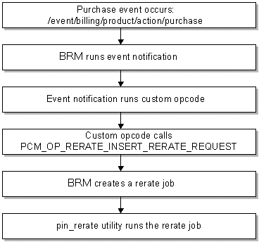

You can also configure BRM to automatically create rerate jobs when the following events occur:
When rates are changed.
When rollover corrections are made due to delayed events.
When certain events, such as purchase and cancellation events, are backdated. See "About Automatic Rerating of Backdated Events".
When pipeline batch-rated events are rated out of order. See "About Automatic Rerating of Out-of-Order Events".
When events trigger rerating based on your custom rerating requirements. See "About Trigger-Dependent Rerating".

Configuring Event Notification for Rerating Backdated Events
When a backdated event occurs, BRM rerating uses event notification to trigger automatic rerating of the event.
Although any subclass of the /event class can be used to trigger event notification, BRM rerating generates the nonpersistent /event/notification/auto_rerate event specifically to use for event notification.
By default, when this event occurs, BRM creates a rerate job.
Before you can use BRM rerating, you must configure the event notification feature as follows:
If your system has multiple configuration files for event notification, merge them.
Ensure that the merged file includes the following information from the BRM_home/sys/data/config/pin_notify file:
# Rerating related event notification 3787 0 /event/notification/auto_rerate
(Optional) If necessary to accommodate your business needs, add, modify, or delete entries in your final event notification list.
(Optional) If necessary to accommodate your business needs, create custom code for event notification to trigger.
Load your final event notification list into the BRM database.
Trigger-dependent rerating enables you to specify when events are automatically rerated. For example, if you rerate usage following a charge offer cancellation, you can set up a charge offer cancellation event to automatically trigger rerating.
To configure trigger-dependent rerating, you set up event notification to call a custom opcode that analyzes events to determine if rerating is required. For example, the criteria for rerating might be:
If the event is a cancel event.
If the cancel event for a charge offer requires proration on cancellation.
If rerating needs to occur to calculate proration for this charge offer.
If the notification event triggers rerating, the custom opcode specifies which events for an account must be rerated and sends the rerating requirements to the PCM_OP_RERATE_INSERT_RERATE_REQUEST opcode to create a rerate job.
Trigger-dependent rerating works as follows:
An event that you have configured in event notification occurs to call the custom opcode. For example, this might be a purchase event, charge offer cancellation, or change in account status. All the fields in the event are passed as input to the custom opcode.
The custom opcode analyzes the event using your custom selection criteria to determine if it should trigger rerating. For example, the opcode might be called when all purchase events occur, but not all purchase events will trigger rerating.
If the event triggers rerating because it matches your selection criteria, the custom opcode assigns an optional rerate reason code for rerating those events, specifies any price overrides, and calls PCM_OP_RERATE_INSERT_RERATE_REQUEST to create the rerate job.
PCM_OP_RERATE_INSERT_RERATE_REQUEST creates a rerate job that includes:
The account that needs to be rerated.
The events that must be rerated for that account.
The start time from which to rate the events.
The rerate reason.
Price overrides, if any.
If more than one account is included in the rerate job, the same selection criteria, price overrides, and start time apply to all the accounts.
You run the pin_rerate utility to process the rerate job and rerate the events.
Figure 7-2 shows the trigger-dependent rerating process when a purchase event occurs.
Figure 7-2 Trigger-Dependent Rerating Process
Description of "Figure 7-2 Trigger-Dependent Rerating Process"
To set up trigger-dependent rerating, see "Setting Up Trigger-Dependent Rerating".
