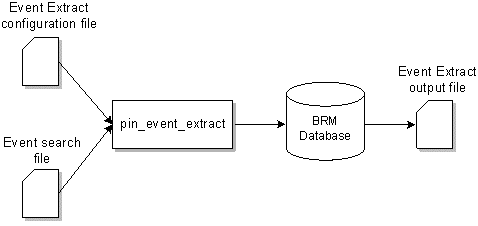

Event Extraction Manager is the first application used in the rerating process. You use it to find and extract events from the BRM database that must be rerated by Pipeline Manager and then reloaded into the BRM database by Rated Event (RE) Loader.
Event Extraction Manager does not modify or process events, nor does it lock accounts in your database. This enables BRM and other applications to safely access accounts in the database while you are extracting events.
Event Extraction Manager consists of the following components:
The event extract configuration file (pin.conf), which specifies how the pin_event_extract utility connects to your BRM system and the size and name of the event extract output file
The pin_event_extract.cfg file, which specifies the event search criteria
The pin_event_extract utility, which searches the BRM database for events meeting the search criteria and writes the results to an output file
The event extract output file, which contains the list of events to rerate
Figure 4-1 shows Event Extraction Manager.
About the Event Extract Configuration File
The event extract configuration file (pin.conf), which specifies how the pin_event_extract utility connects to your BRM system, and the size and name of your event extract output file.
If you are extracting events from a multischema system, you must modify this file for each database schema in your system. For information, see "Extracting Events from a Multischema System".
For information on how to create this file, see "Configuring Connection and Output File Parameters".
About the pin_event_extract.cfg File
The event search file (BRM_home/apps/pin_event_extract/pin_event_extract.cfg) specifies the criteria that the pin_event_extract utility uses to search for events in your BRM database. You can search for events based on a wide variety of criteria, including account number, charge offer name, and impact category.
For information about the event search criteria, see "Event Search Criteria".
For information on creating a pin_event_extract.cfg file, see "Specifying Which Events to Extract for Rerating".
About the pin_event_extract Utility
The pin_event_extract utility builds a search query with the criteria specified in the pin_event_extract.cfg file and then run it against the specified database schema. The search query selects only events that have a balance impact type of pipeline-prerated, indicating that Pipeline Manager has already rated the events.
About the Event Extract Output File
The pin_event_extract utility prints to a file the list of events meeting the search criteria. Results are written in tab-delimited columns conforming to the Oracle CDR format. You send this file directly to Pipeline Manager for rerating.
The default implementation defines the event-field-to-output file mapping for GSM and GPRS events. However, you can create additional categories by modifying the PCM_OP_BILL_POL_CONFIG_EET policy opcode.
When the number of events meeting the search criteria exceeds the specified maximum file size or number of EDRs, the utility generates multiple output files and appends a number, such as _1, _2, and so on, to each file name.
When you use the sequence number search criteria, the utility automatically appends a sequence number to the file name and ignores the specified maximum file size and number of EDRs.
