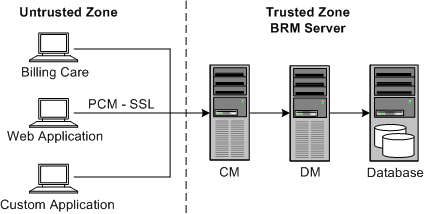

Use Secure TLS Connections
You can configure BRM to communicate between the various components using encrypted TLS sockets by setting the enable_ssl entry in the CM's pin.conf configuration file. When this configuration is enabled, BRM uses TLS sockets for any communication between its components, such as Oracle Data Manager (DM) (dm_oracle), Payload Generator EM (also called the EAI Java Server or eai_js), or Paymentech DM (dm_fusa).
For example, you can configure BRM client applications or any client tier module, such as Web Services Manager or JCA Resource Adapter, to use encrypted TLS sockets to connect to the BRM server.
BRM provides sample CA certificates and trusted client certificates. You must replace the sample CA certificate with your own CA certificate or use a CA certificate from a third party.
Figure 2-1 shows secure communications between BRM components using TLS.
Figure 2-1 Secure Communications Using TLS
Description of Figure 2-1 follows
Description of "Figure 2-1 Secure Communications Using TLS"
See "Enabling Secure Communication between BRM Components" in BRM System Administrator's Guide for more information.
