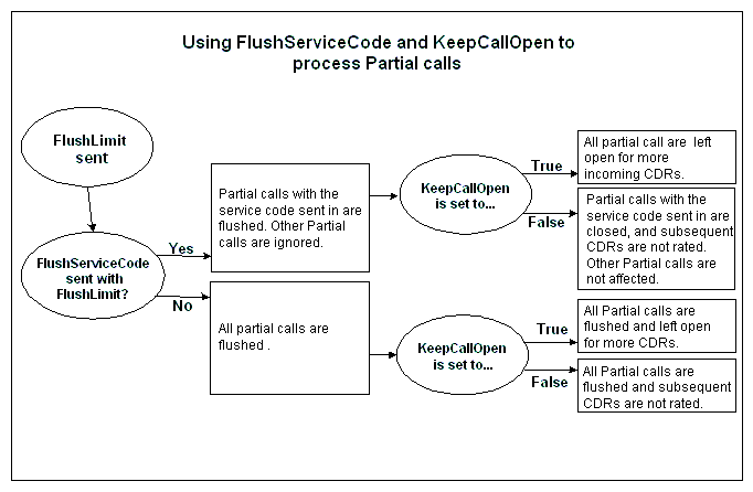

  • SL: Slice of a call. Used if KeepCallOpen = True or MaxDuration = True. Composed of the first call segment and any intermediate call segments that have arrived when the call is flushed. This part of the call is rated. When any other intermediate segments and the last segment arrive, the call is given a long duration indicator of C (complete), and these segments are rated.
  • P: Partially assembled call. Used if FlushLimit = True or KeepCallOpen = false. Partially assembled calls are rated with the information in whatever segments have arrived. Subsequent call segments are given a long duration indicator of XP and are not rated.

  • FlushLimit is a semaphore registry entry used with KeepCallOpen=True. It sets a maximum age a call can have before being flushed. When you send in the semaphore, the pipeline calculates whether a call exceeds the maximum age. If a call exceeds the FlushLimit setting, FCT_CallAssembling creates and rates the EDR and then closes the call. You set the time limit in days. A setting of 0 flushes all calls. A setting of 1 flushes all calls that have been opened more than 1 day. You can change the FlushLimit setting every time you send in a semaphore.
    For details, see "Using FlushLimit to Rate Incomplete Calls".

Rating Partial Calls by Service
Use the FlushServiceCode semaphore registry entry to limit the effect of FlushLimit to calls with specific service codes. FlushServiceCode is sent as an entry in the FlushLimit update registry entry. If the FlushServiceCode entry matches the value of the DETAIL.INTERNAL_SERVICE_CODE field of the call segment, the call is flushed. All other partial calls are ignored.
For example, the following FlushServiceCode entry directs the pipeline to rate only calls with the dat service code:
  FlushLimit = 0
  FlushServiceCode = dat
Figure 5-1 shows how the FlushServiceCode and KeepCallOpen semaphore registry entries interact.
Figure 5-1 FlushServiceCode and KeepCallOpen Semaphore Interaction
