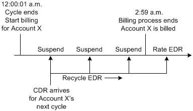

When customers use their services while their accounts are being billed, Pipeline Manager does not rate their usage until the accounts' billing is complete. The BRM billing process can sometimes take several hours. When there is account activity during the billing process, there is a greater possibility that call detail records (CDRs) will need recycling or rerating. When you use pipeline-triggered billing, the accounts are billed in a separate billing process, reducing the billing processing time.
When Pipeline Manager suspends EDRs because it is waiting for the account to be billed, those EDRs must later be recycled for rating. Each time an EDR is recycled, it is suspended until Pipeline Manager receives notification that the billing process for the account is complete.
Figure 14-1 shows how a CDR is repeatedly suspended for Account X until the account's billing is complete. In this example, the billing process takes almost three hours.
Figure 14-1 Suspension of CDR Rating During Billing

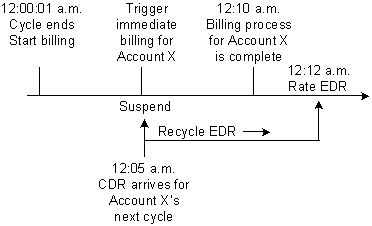

With pipeline-triggered billing, billing is triggered for Account X when the first new CDR arrives, as shown in Figure 14-2. The account is billed in a separate billing process, reducing the processing time. Pipeline Manager can then rate the recycled CDR and new CDRs that arrive for the next accounting cycle for that account:
Figure 14-2 Pipeline-Triggered Billing
Performance is affected by the number of accounts that need pipeline-triggered billing. If too many accounts are triggered for billing by Pipeline Manager, there is no performance advantage.

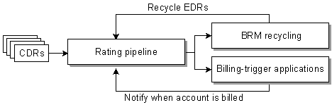

Pipeline-Triggered Billing Components
Pipeline-triggered billing comprises several components that work together to bill accounts:
  • Pipeline Manager modules flag and route EDRs for accounts that require billing. See "About the Pipeline-Triggered Billing Modules".
  • BRM recycling suspends EDRs flagged to trigger billing until the accounts are billed. The EDRs are periodically recycled. When the accounts are billed, the recycled EDRs can be rated and are no longer suspended. See "About Suspending Billing-Trigger EDRs".
  • Billing-trigger applications bill the triggered accounts. These applications include a billing batch handler (BillHandler) and the BRM billing utility. When the accounts are billed, BRM notifies Pipeline Manager that billing for the accounts is complete. See "About BillHandler".
Figure 14-3 shows the relationships among Pipeline Manager, BRM standard recycling, and the billing-trigger applications.
Figure 14-3 Pipeline Manager, Recycling, and Billing Applications Relationship

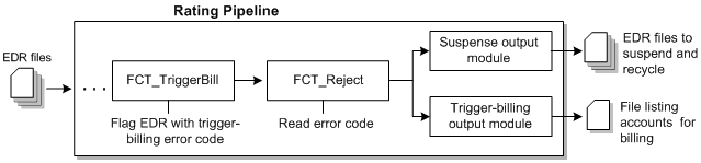

Pipeline Manager flags EDRs associated with accounts that require immediate billing and sends them to the appropriate output streams. Pipeline-triggered billing uses the following modules:
  • The FCT_TriggerBill module, which determines whether EDRs should trigger billing based on the accounting cycle date and billing state. To trigger billing, it sets a billing-trigger error code (Awaiting billing of account) in the EDRs. To flag the EDRs for recycling, it sets a billing-trigger recycle key value (Trigger_Billing).
  • The FCT_Reject module, which detects the billing-trigger error code and sends the EDR to the suspense output stream.
  • The billing-trigger output module, which creates a file containing the accounts and bill units for billing and sends the file to a separate directory.
  • The suspense output module, which adds the EDRs that trigger billing to an output file. The EDRs are loaded into the BRM database to be suspended and recycled.
Figure 14-4 shows the path that EDRs take when they are flagged to trigger billing.
Figure 14-4 EDR Path for Triggered Billing

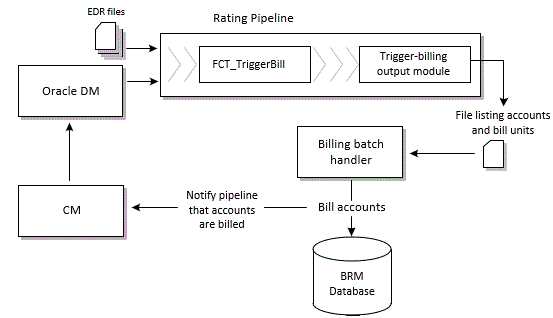

About BillHandler
BillHandler bills the accounts whose EDRs are flagged to trigger billing. BillHandler is used with the following applications:
  • Batch Controller, which watches for billing-trigger files output by a pipeline. When a file is present, Batch Controller starts BillHandler.
  • The pin_bill_accts billing utility, which bills the accounts and bill units. BillHandler starts the billing utility.
Figure 14-5 shows the batch handler billing process:
Figure 14-5 Batch Handler Billing Process
Overview of the Immediate Billing Process
To bill accounts identified for immediate billing, the following actions are performed:
  1. Batch Controller starts BillHandler when a file is present in the pipeline billing-trigger output directory.
  2. BillHandler reads the accounts and bill units in the file and passes them to the pin_bill_accts billing utility to be billed.
  3. The pin_bill_accts billing utility creates the bills and updates the account information in the BRM database.
  4. When the accounts are billed, BRM notifies Pipeline Manager by sending a business event to the Oracle DM.
Figure 14-6 shows an overview of the processes required to bill accounts that are identified for immediate billing.
Figure 14-6 Immediate Accounts Billing Process

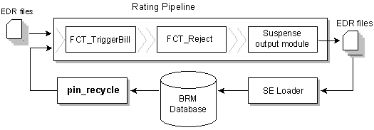

EDRs that are flagged to trigger billing are not rated and must be periodically recycled until the accounts are billed. Pipeline-triggered billing uses BRM standard recycling to suspend and recycle these EDRs.
You perform the following actions to suspend and recycle EDRs:
  1. When EDRs contain the Awaiting billing of account error code, the FCT_Reject module sends them to the suspense output stream.
  2. SE Loader retrieves the EDRs from the output stream and stores them in the BRM database.
  3. The pin_recycle utility retrieves the EDRs from the BRM database and sends them back through the rating pipeline. To continuously recycle any waiting EDRs, schedule the utility to run periodically.
EDRs are suspended each time they are recycled until the accounts are billed. After the accounts are billed, the EDRs are rated and are no longer sent to the suspense output stream.
Figure 14-7 shows an overview of the processes required to suspend and recycle EDRs flagged to triggered billing.
Figure 14-7 Suspension and Recycling of EDRs Flagged to Trigger Billing
