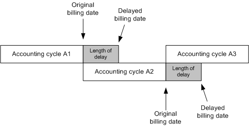

You can set up BRM to delay billing for accounts after the end of a billing cycle. This is called delayed billing. Delayed billing essentially extends a billing cycle by the delay interval. You use delayed billing to bill for events that occur within a billing cycle but are not recorded during that cycle.
For example, if a batch of events does not arrive until after the end of the billing cycle, you delay billing until all events in the batch are recorded in the BRM database. When you use delayed billing, billing for all the accounts in your BRM system is delayed for the same amount of time; you cannot specify multiple billing delay periods.
Figure 7-1 shows that with delayed billing, the billing date occurs after the original billing date, during the next accounting cycle.
Figure 7-1 Delayed Billing Timeline
Description of Figure 7-1 follows
Description of "Figure 7-1 Delayed Billing Timeline"
The length of the delay interval must be shorter than one accounting cycle.

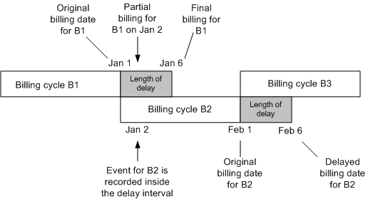

The following example is illustrated in Figure 7-2:
  • An account's billing date is January 1 and the billing delay interval is five days.
  • On January 2, a new usage event for the account occurs for the next billing cycle.
  • To ensure that the new usage event impacts items in the next billing period (B2), BRM performs partial billing.
  • On January 6, final billing is run for the previous billing cycle (B1) by running the billing utility; the status of all the bill items for the previous bill is changed to open so that they stop accumulating charges.
Figure 7-2 Partial and Final Billing Timeline

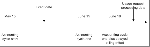

To decide which item to apply the bill to, ECE takes into account the following dates:
  • The date when the call occurred.
  • The current system date.
  • The date when the current accounting cycle ends. This is called the next accounting cycle date.
  • The number of days after the current accounting cycle ends when delayed billing runs. This number is called the delayed billing offset.

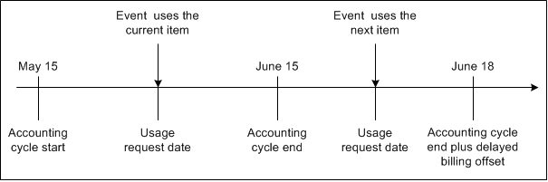

To assign the event to an item:
  • If the event date falls before the next accounting date, the event is assigned to the current item.
  • If the event date falls after the next accounting date, the event is assigned to the next item. This can happen because the event might occur after the close of the accounting cycle but before the delayed billing offset date.
Figure 7-3 shows how events are assigned:

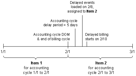

Delayed billing assigns delayed events to items of the billing cycle in which they occurred. However, in the scenario described above, you might need to assign the delayed events to the accounting cycle in which they occurred. To assign delayed events to items of the accounting cycle in which they occurred, you configure an accounting cycle delay period. You can do this to enable accurate general ledger reporting.
When a billing cycle spans multiple accounting cycles, the items for those accounting cycles are not closed until billing is run. If you run a general ledger (G/L) report at the end of an accounting cycle for which billing has not yet been run, the status of the revenue in the G/L can change if additional events are rated and loaded for that cycle before the accounts are billed.
If you require that G/L data not change after the G/L report is run, you can configure an accounting cycle delay period after which events are no longer assigned to items of that accounting cycle, even if those items are not closed. You then run G/L reports after the accounting cycle delay period has ended. This ensures that the revenue reported in the G/L is accurately represented and that the state of the revenue (earned, unearned, billed, and unbilled) does not change after the G/L report is run.
When you configure an accounting cycle delay period, BRM assigns delayed events to items based on when the accounting cycle delay period ends. BRM assigns events to items when RE Loader loads the events into the database:
  • When delayed events (events that occurred in the previous cycle) are loaded after the accounting day of month (DOM), but before the end of the accounting cycle delay period, those events are posted to the item for which the DOM has just passed as shown in Figure 7-5:
Figure 7-5 Delayed Events Arriving During Cycle Delay Period

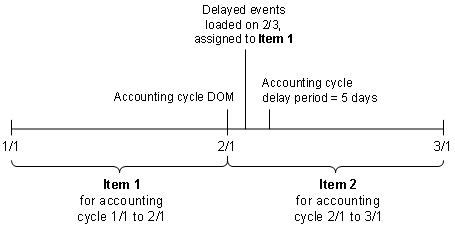

  • When the billing cycle has ended and delayed events are loaded after the end of the accounting cycle delay period, but before delayed billing is run, those events are posted to the item for the next (current) accounting cycle, even though the previous cycle has not been billed and its items are still pending. This is shown in Figure 7-6:
Figure 7-6 Delayed Events Arriving After Cycle Delay Period
