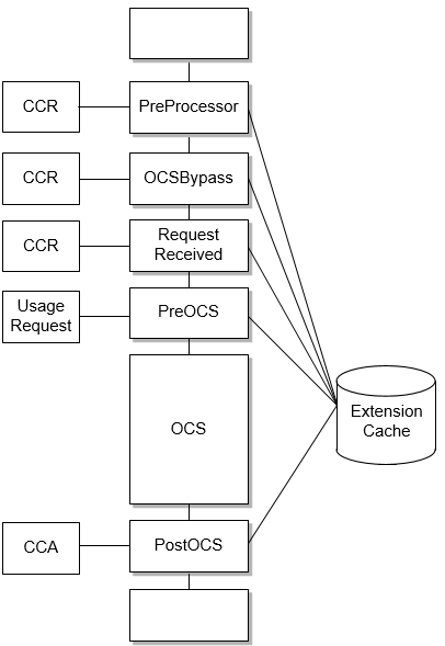

Diameter-Request Processing Extension Points
Diameter Gateway provides extension points for Credit Control Request (CCR) and Credit Control Answer (CCA) flows:
  • RequestReceived extension. The role of the RequestReceived extension is to manipulate the CCR attribute-value pair (AVP) before the usage request is processed by Diameter Gateway and to provide an immediate response that bypasses the online charging system (OCS) completely.
  • PreProcessor extension. The role of the PreProcessor extension is to add or remove any AVP in the custom response before the usage request is processed by Diameter Gateway and to provide an immediate response that bypasses the OCS completely.
  • PreOCS extension. The role of the PreOCS extension is to manipulate the mapped ECE usage request payload and perform enrichment that is not possible in the RequestReceived extension.
  • PostOCS extension. The role of the PostOCS extension is to manipulate the CCA AVPs before the diameter response is returned to the diameter client.
  • OCSBypass extension. The role of the OCSBypass extension is to bypass the rating of Diameter CCRs received during a planned maintenance or an unplanned downtime of ECE and persist them to Oracle NoSQL.
Figure 26-1 shows the diameter-request processing extension points.
Figure 26-1 Diameter-Request Processing Extension Points
Description of Figure 26-1 follows
Description of "Figure 26-1 Diameter-Request Processing Extension Points"

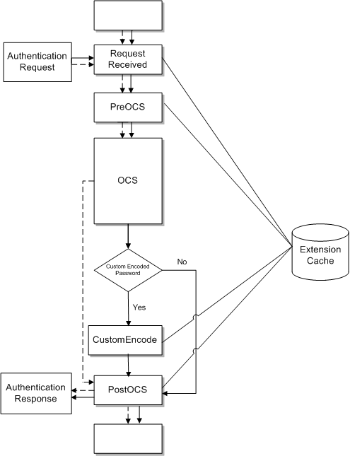

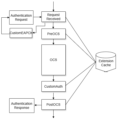

Authentication Extension Points
RADIUS Gateway provides extension points for the authentication flow:
  • RequestReceived extension. The role of the RequestReceived extension is to add or update a custom AVP before the authentication request is processed by RADIUS Gateway and to provide an immediate response that bypasses the OCS completely.
  • CustomEAPChallenge extension. The role of the CustomEAPChallenge extension is to send custom access-challenge request to the RADIUS client when the Extensible Authentication Protocol (EAP) is used for authentication.
  • RadiusAuthPreProcessorExtension extension. The role of the RadiusAuthPreProcessorExtension extension is to provide access to subscriber profile information including customer and balance data in the extension hooks in the authentication flow of the RADIUS Gateway.
  • PreOCS extension. The role of the PreOCS extension is to perform any actions related to authentication that are required before the RADIUS request is sent to ECE.
  • CustomAuth extension. The role of the CustomAuth extension is to implement the custom EAP authentication methods.
  • CustomEncode extension. The role of the CustomEncode extension is to implement the custom hashing algorithm that is used on passwords during authentication when the Password Authentication Protocol (PAP) is used for authentication.
  • PostOCS extension. The role of the PostOCS extension is to add or update a custom AVP before the authentication response is returned to the RADIUS client.
Figure 26-3 shows the RADIUS-request processing extension points for EAP authentication.
Figure 26-3 Extension Points for EAP Authentication
Description of Figure 26-3 follows
Description of "Figure 26-3 Extension Points for EAP Authentication"
Figure 26-4 shows the RADIUS-request processing extension points for PAP and Challenge-Handshake Authentication Protocol (CHAP) authentication. The solid line depicts PAP authentication and the dotted line depicts CHAP authentication in this figure.
Figure 26-4 Extension Points for PAP and CHAP Authentication
Description of Figure 26-4 follows
Description of "Figure 26-4 Extension Points for PAP and CHAP Authentication"

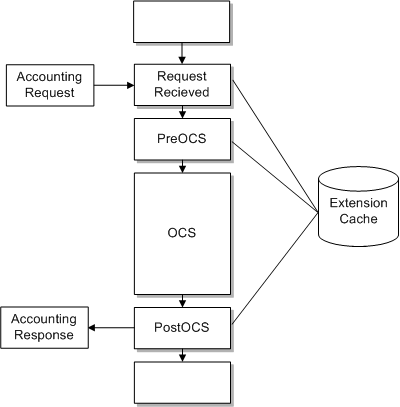

Accounting Extension Points
RADIUS Gateway provides extension points for accounting flow:
  • RequestReceived extension. The role of the RequestReceived extension is to add or update a custom AVP before the accounting request is processed by RADIUS Gateway and to provide an immediate response that bypasses the OCS completely.
  • PreOCS extension. The role of the PreOCS extension is to enrich the usage request before the usage request is sent to ECE for accounting purposes.
  • PostOCS extension. The role of the PostOCS extension is to add or update a custom AVP before the accounting response is returned to the RADIUS client.
Figure 26-5 shows the RADIUS-request processing extension points for accounting.
Figure 26-5 Extension Points for Accounting
Description of Figure 26-5 follows
Description of "Figure 26-5 Extension Points for Accounting"

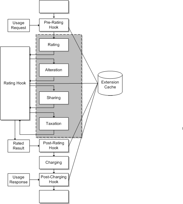

Usage-Request Processing Extension Points
ECE provides extension points in the rating flow: before charge calculation, after charge calculation (prior to making a balance impact), and after charging (after applying a balance impact).
Table 26-1 describes the role of each extension point in the rating flow.
Table 26-1 Rating Flow Extension Roles
Extension Point Role
Pre-Rating Extension
Alter the usage request
Post Rating Extension
Alter the rated result
Rating Extension
Alter rated results after each of the following processes: rating, alteration, sharing, and taxation
Post-Charging Extension
Enrich the usage response
You cannot customize rating during the rating, alteration, and tax calculation processes, only before and after. Access is provided to a custom data store that provides low-latency access to data required for the extensions; for example, customer data and balance data.
Figure 26-6 shows the usage-request processing extension points.
Figure 26-6 Usage-Request Processing Extension Points
Description of Figure 26-6 follows
Description of "Figure 26-6 Usage-Request Processing Extension Points"

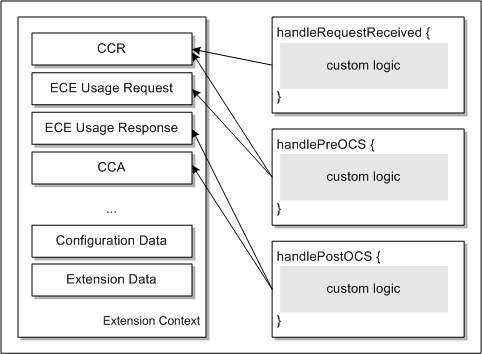

For diameter-request processing extension points, a different method is called for each extension point.
  • handleRequestReceived(). Called for every CCR that is processed by the charging flow.
  • handlePreOCS(). Called for every CCR and usage request that is processed by the charging flow.
  • handlePostOCS(). Called for every CCA and usage response that is processed by the charging flow.
All methods expose relevant ExtensionContext data for accessing the ExtensionsDataRepository, AppConfigRepository, and other extensions-related contexts.
Figure 26-7 shows the data used in the diameter-request processing extension points.
Figure 26-7 Data Used in Diameter-Request Processing Extension Points

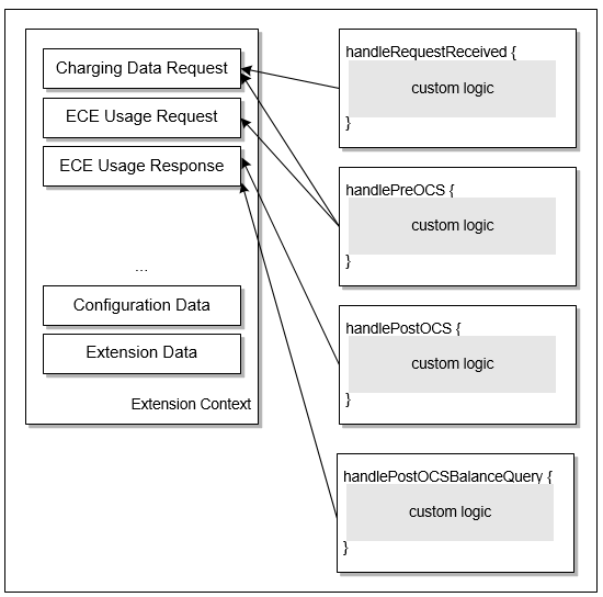

For HTTP-request processing extension points, a different method is called for each extension point.
  • handleRequestReceived(). Called for every charging data request that is processed by the charging flow.
  • handlePreOCS(). Called for every usage request that is processed by the charging flow.
  • handlePostOCS(). Called for every usage response that is processed by the charging flow.
  • handlePostOCSBalanceQuery(). Called for every usage response that is processed by the charging flow.
Figure 26-8 shows the data used in the HTTP-request processing extension points.
Figure 26-8 Data Used in HTTP-Request Processing Extension Points

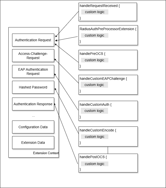

For extension points that process requests from RADIUS clients, the RadiusRequest and RadiusReply interfaces are exposed to the extension points through the ExtensionContext methods.
For authentication-related extension points, the following methods are called by the authentication flow:
  • handleRequestReceived(). Called for every authentication request that is processed by the authentication flow.
  • handlePreOCS(). Called to perform any actions related to authentication that are required in the authentication flow.
  • handlePostOCS(). Called for each authentication response that is processed by the authentication flow.
  • handleCustomEAPChallenge(). Called to send custom access-challenge requests to the RADIUS client in the EAP authentication flow.
  • handleCustomAuth(). Called to implement a custom EAP authentication method in the authentication flow.
  • handleCustomEncode(). Called to implement the custom hashing algorithm that is used on passwords in the PAP authentication flow.
Figure 26-9 shows the data used in the RADIUS-request processing extension points for authentication.
Figure 26-9 Data Used in RADIUS-Request Processing Extension Points for Authentication

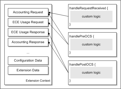

For accounting-related extension points, the following methods are called by the accounting flow:
  • handleRequestReceived(). Called for every accounting request that is processed by the accounting flow.
  • handlePreOCS(). Called for every accounting request and usage request that is processed by the accounting flow.
  • handlePostOCS(). Called for every accounting response and usage response that is processed by the accounting flow.
Figure 26-10 shows the data used in the RADIUS-request processing extension points for accounting.
Figure 26-10 Data Used in RADIUS-Request Processing Extension Points for Accounting

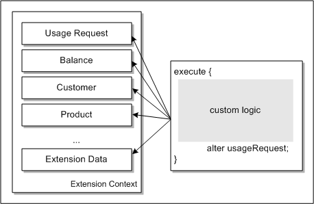

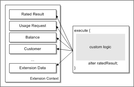

For usage-request processing extension points, the execute() method is called for every usage request, rated result, usage response, and notification that is processed by the charging flow.

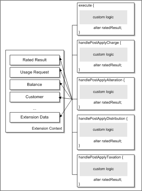

For the rating extension point, the following methods are called by the charging flow:
  • handlePostApplyCharge(). Called to alter rated results after calculating charges (rating).
  • handlePostApplyAlteration(). Called to alter rated results after calculating discounts (alteration).
  • handlePostApplyDistribution(). Called to alter rated results after calculating charge distribution (sharing).
  • handlePostApplyTaxation(). Called to alter rated results after calculating taxes (taxation).
Figure 26-11 shows the data used in the pre-rating extension point.
Figure 26-11 Data Used in Pre-Rating Extension Point
Figure 26-12 shows the data used in the rating extension point.
Figure 26-12 Data Used in Rating Extension Point
Figure 26-13 shows the data used in the post-rating extension point.
Figure 26-13 Data Used in Post-Rating Extension Point
Figure 26-14 shows the data used in the post-charging extension point.
Figure 26-14 Data Used in Post-Charging Extension Point

CustomAuth Extension
The CustomAuth extension implements custom EAP authentication methods; for example, EAP-POTP, EAP-PSK etc.
The extension can access this data:
  • EAP-Authentication-Request
  • System configuration
You can use a custom EAP authentication method if the RADIUS client does not support EAP-TTLS or EAP-MD5.
CustomEAPChallenge Extension
The CustomEAPChallenge extension sends a custom access-challenge request to the RADIUS client when custom EAP authentication mechanisms are used for authentication.
  • Access-Challenge-Request
  • Extensions data
You can use the extension point to send the custom access-challenge request to the RADIUS client when EAP is used for authentication.
CustomEncode Extension
The CustomEncode extension implements the custom hashing algorithm that is used on passwords for authentication.
  • Encoded Password
  • Extensions data
You can use the custom hashing algorithm on passwords for authentication. For example, typically the password from the RADIUS client is hashed (stored in the hash format) for PAP authentication. However, if the password is hashed in any other format, you implement the CustomEncode extension point to hash the incoming password.
OCSBypass Extension
The OCSBypass extension bypasses rating of CCRs received during ECE downtime or a planned maintenance activity. The CCRs are persisted to Oracle NoSql. When ECE is restored, the persisted requests are replayed to the ECE charging server for rating and updating balance impacts along with the real-time requests. The entire diameter request is accessible and modifiable and the entire request information is passed to the custom extension. When rating bypass is enabled and the custom extension is run, Diameter Gateway returns responses that you configured in the custom extension. If the extension is not enabled but bypassing of rating is enabled, ECE returns Diameter Result Code 5012 for the described conditions, which must be handled in your custom extension implementation.
PreOCS Extension
The PreOCS extension manipulates usage request payloads before the usage request is sent to ECE, so that the request can match the business requirement. In addition, the PreOCS extension performs any actions related to authentication that are required before the request is sent to ECE. This extension is called before any rating, discounting, or alteration logic has been invoked.
  • Credit Control Request
  • Authentication Request
  • Accounting Request
  • ECE Usage Request
  • Extensions data
You can modify the ECE usage request payload. For example, certain usage request manipulations can be made only when the ECE usage request payload is accessible. The usage request manipulations are done in this extension.
PreProcessor Extension
The PreProcessor extension manipulates CCR requests before the usage request is created, so that the request can match the business requirement. The PreProcessor extension can bypass charging or mutate the contents of the Sy message. This extension is called before any rating, discounting, or alteration logic has been invoked.
  • Request AVPs
  • ECE payload
  • Extensions data
PostOCS Extension
The PostOCS extension manipulates CCA, accounting, usage, or authentication responses to match the business requirement before returning the response to the client. This extension is called after charging, authentication, and accounting has been completed and recorded.
  • Accounting Response
  • Authentication Response
  • ECE Usage Response
  • Diameter Credit Control Answer
  • Extensions data
You can modify the CCA, accounting response, and authentication response. For example, you can manipulate AVPs to adapt to non-standard diameter and RADIUS implementations.
PostOCSBalanceQuery Extension
The PostOCSBalanceQuery extension manipulates ECE usage responses to match the business requirement before returning the response to the HTTP client. This extension is called after a balance query has been completed and recorded.
The pre-rating extension enhances the usage request based on customer, service, balance, product, and system data so that the usage request can match the business requirement. This extension is called before any rating, discounting, or alteration logic has been invoked.
  • ECE usage request information
  • Customer data (including profile data)
  • Service data (including profile data)
  • Balance information
  • Product information
  • Extensions data
You can modify usage requests. For example, you modify usage requests to:
  • Alter the requested quota. This is implemented in the sample extensions provided.
  • Apply special rates or discounts (such as birthday discounts) for calls based on the extended rating attributes of both calling customers and called customers.
  • Generate a midsession-rated event when an update operation occurs. This is implemented in the sample extensions provided.
You can also modify the values of the pricing attributes with custom logic. This enables you to override a product price.

Rating Extension
The rating extension modifies the rated results after each of the following processes: rating, alteration, sharing, and taxation.
  • Customer (including profile)
  • Shared customer (if part of a sharing relationship)
  • Product (including profile)
  • Extensions
  • Rated result
You can alter rated results to modify charges, discounts, charge sharing, taxes, and item assignments. For example:
  • After rating, you can alter charges based on the zones, such as standard and geographic zones.
  • After taxation, you can alter custom item types for the rating impacts generated from ECE, such as charge, alteration, and distribution rating impacts.

HTTP Gateway Extension – Service
The sample program SampleHTTPExtension shows how to use the ECE Extensions API to override the requested number of units and perform call screening.
  • The handleRequestReceived() method overrides the requested units for a call.
  • The handlePreOCS() method sets the timestamp of when the call originally occurred.
  • The handlePostOCS() method logs a message when call screening is done and returns a response to the 5G client.
  • The handlePostOCSBalanceQuery() method logs a message when a balance query occurs and returns a response to the 5G client.
OCSBypass Extension – Bypassing Rating
The sample program SampleOCSByPassExtension shows how to use the ECE extensions API to bypass rating during ECE downtime. When bypass rating is enabled, the CCRs are persisted to Oracle NoSQL. When ECE is restored, the persisted requests are replayed to the ECE charging server for rating and updating balance impacts along with the real-time requests. Using this extension, you can write your own logic for modifying the AVP of incoming diameter messages and for creating the diameter responses.
Pre-Rating Extension – Dynamic Quota Management
The sample program SamplePreRatingExtension shows pre-rating custom logic. It illustrates sample logic for the pre-rating scenarios.
Dynamic Quota Management – Modifying Quota Based on Network Type
The SamplePreRatingExtension program shows how to use the ECE extensions API to modify the input request quantity based on the input network type where the customer balance is greater than a predefined amount.
