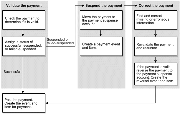

About the Payment Suspension Process
Payment suspension begins when you collect payments from a financial institution: whether you use payment clerks to manually post payments from batch files or you use a third-party payment gateway to automatically post payments.
The payment processing phase involves three steps: validation, suspension, and correction. These steps are sequential and rely on the completion of the prior step.
  1. Validation: BRM determines whether a payment meets the validation criteria and assigns a status of successful or “to be suspended." BRM takes the following actions:
    • If the payment is successful, BRM posts the payment to the account.
    • If the payment does not meet the validation criteria but has enough information to qualify for suspense, BRM marks it as “to be suspended" and forwards it to the opcodes responsible for suspending the payment.
      BRM can suspend both successful and financially failed payments. For example, a payment batch includes two check payments, each with an incorrect account number. The payment information indicates that one check has cleared and the other bounced.
      Coming into BRM, the first payment would be considered successful and the second, failed. When BRM validates the payments, both would be marked for suspense because, regardless of the financial success or failure of the payment, neither payment can be posted to the correct account.
    • If the payment does not meet the validation criteria and also does not qualify for suspense, BRM informs you that the payment cannot be posted. You must create an exception batch to handle payments that fall into this category.
    Payment validation is initiated automatically through the payment gateway or manually by a payment clerk.
  2. Suspension: BRM moves the payment to the payment suspense account and creates the associated events and items to store information on the suspended payment.
    Payment suspense can occur during account maintenance, after payments have been saved to the BRM database.
    • During account maintenance, payment suspense is initiated manually by using Payment Center. Payment suspense is initiated when you undo the allocation of a payment from a customer account.
  3. Correction: To correct a suspended payment, you use Payment Center to assign it to a correct account number or bill number and apply it to the customer account. You can also create a distribution list for a suspended payment, which enables you to apply the payment to multiple accounts.
    After payment analysts correct suspended payments and assign them to one or more accounts, the payments must be validated again. If the payment validation is successful, BRM posts the payments to the correct accounts. If the suspended payment is allocated completely (an amount does not remain in suspense), BRM reverses the suspended payment, removing it from the payment suspense account. While performing this operation, BRM creates the required objects and events.
    Payment correction is always initiated by a payment clerk through Payment Center; this step is never automatic. If, during revalidation, the payment still meets the suspense criteria, BRM again assigns a status of suspended and the payment is resubmitted to suspense.
Figure 21-1 shows the steps involved in payment suspension and the basic operations they perform.
Figure 21-1 Basic Operations and Steps Involved in Payment Suspension
Description of Figure 21-1 follows
Description of "Figure 21-1 Basic Operations and Steps Involved in Payment Suspension"
