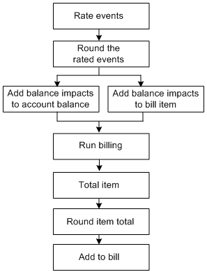

Figure 30-1 shows the general process of balance impact rounding.
Figure 30-1 BRM Balance Impact Rounding
Description of Figure 30-1 follows
Description of "Figure 30-1 BRM Balance Impact Rounding"
Assuming that rounding is configured for all events and all processes (rating, discounting, taxation, and A/R), rounding is performed in the following order:
  1. Purchase and cycle fees. When a package is purchased, the purchase and cycle fees are rounded, if necessary, and a balance impact is generated with the rounded amount. Purchase and cycle fees typically only need rounding when a user purchases or cancels an offer in the middle of the billing cycle. In this case, cycle fees and noncurrency grant amounts are prorated, if necessary, and then rounded.
  2. Usage fees. As customers use their services, the usage events are rated, the usage fees are rounded, and balance impacts are generated with the rounded amounts.
  3. Discount fees. If a usage discount applies, the discount is calculated on the rounded usage fee, the discount is rounded, and a discount balance impact is generated with the rounded amount. If there are multiple usage discounts, each discount is rounded in sequence.
  4. Taxes. If tax should be applied to the event, the tax is calculated on the rounded fee, the tax is rounded, and a balance impact is generated with the rounded amount.
  5. Billing discounts. When you run billing, if a billing-time discount applies, it is applied to the total of the rounded usage items, the discount is rounded, and a discount balance impact is generated with the rounded amount.
  6. Bills. When the bill is generated, the total amount in each item is rounded, and then all item totals are summed and included in the bill.
  7. Rollover. If there are any rollover amounts, the rollover is calculated on the total rounded usage, and then the rollover amount is rounded and applied to the next billing cycle. For example, if 100 minutes can be rolled over and the customer used 60.4 minutes, the unused amount of 39.6 minutes is rounded and then added to the account balance for the next cycle.

Rounding Examples
Rounding is performed after rating, discounting, taxation, and A/R actions such as billing and adjustments.
Table 30-6 shows the resulting balance impacts of rounded charges for rating, discounting, taxation, and billing. This example rounds to the nearest mode and uses these scales:
  • 2 for purchase events, taxation, and A/R
  • 5 for rating and discounting
Table 30-6 Rounding Examples
Action/Process Calculated Charge Rounded Charge and Balance Impact Account Balance
Purchase package
Rate cycle fee
9.95
9.95
9.95
Use service
Rate usage
5.23456789
5.23457
15.18456
Discount usage fee 10%
0.523456789
0.52346
14.66111
Tax usage event 3% (after discount)
0.1413333
= 3% * (rounded usage fee - rounded discount)
0.14
14.80111
Run billing
Apply billing-time discount of 5% off total usage
0.24250...
= 5% * usage item total after A/R rounding
(The usage total does not include the cycle fee.)
0.2425
14.55861
Create bill
14.55861
= Total of all items
14.56
(No balance impact)
14.56
