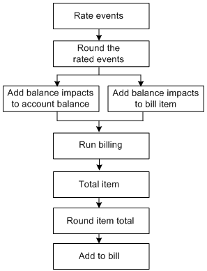

Figure 4-1 show the general process of balance impact rounding.
Figure 4-1 BRM Balance Impact Rounding
Both real-time rating and pipeline batch rating perform rounding. During pipeline rating, the pipeline rounds the amount in each charge and discount packet.
To round in a pipeline, you configure the Pipeline Manager rounding module. See "Setting Up Rounding in Pipeline Manager". To configure the rounding rules, see "Configuring Resource Rounding".
Assuming that rounding is configured for all events and all processes (rating, discounting, taxation, and A/R), rounding is performed in the following order:
  1. Purchase and cycle fees. When a plan is purchased, the purchase and cycle fees are rounded, if necessary, and a balance impact is generated with the rounded amount. Purchase and cycle fees typically only need rounding when a user purchases or cancels a plan in the middle of the billing cycle. In this case, cycle fees and noncurrency grant amounts are prorated, if necessary, and then rounded.
  2. Usage fees. As customers use their services, the usage events are rated, the usage fees are rounded, and balance impacts are generated with the rounded amounts.
  3. Discount fees. If a usage discount applies, the discount is calculated on the rounded usage fee, and then the discount is rounded and a discount balance impact is generated with the rounded amount. If there are multiple usage discounts, each discount is rounded in sequence.
  4. Taxes. If tax should be applied to the event, the tax is calculated on the fee rounded from the previous stage, and then the tax is rounded and a balance impact is generated with the rounded amount.
  5. Billing discounts. When you run billing, if a billing-time discount applies, it is applied to the total of the rounded usage items, and then the discount is rounded and a discount balance impact is generated with the rounded amount.
  6. Bills. When the bill is generated, the total amount in each item is rounded, and then all item totals are summed and included in the bill.
  7. Rollover. If there are any rollover amounts, the rollover is calculated on the total rounded usage, and then the rollover amount is rounded and applied to the next billing cycle. For example, if 100 minutes can be rolled over and the customer used 60.4 minutes, the unused amount of 39.6 minutes is rounded and then added to the account balance for the next cycle.

Rounding is performed after rating, discounting, taxation, and A/R actions such as billing and adjustments.
Table 4-6 shows the resulting balance impacts of rounded charges for rating, discounting, taxation, and billing. This example rounds to the nearest mode and uses these scales:
  • 2 for purchase events, taxation, and A/R
  • 5 for rating and discounting
    Table 4-6 Rounding Examples
    Action / Process Calculated Charge Rounded Charge & Balance Impact Account Balance
    Purchase plan
    Rate cycle fee
    9.95
    9.95
    9.95
    Use service
    Rate usage
    5.23456789
    5.23457
    15.18456
    Discount usage fee 10%
    0.523456789
    0.52346
    14.66111
    Tax usage event 3% (after discount)
    0.1413333
    = 3% * (rounded usage fee - rounded discount)
    0.14
    14.80111
    Run billing
    Apply billing-time discount of 5% off total usage
    0.24250...
    = 5% * usage item total after A/R rounding
    (The usage total does not include the cycle fee.)
    0.2425
    14.55861
    Create bill
    14.55861
    = Total of all items
    14.56
    (No balance impact)
    14.56
