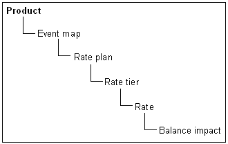

About Organizing Real-Time Rates in a Product
You organize rates in a product in a hierarchical structure as shown in Figure 6-1:
Figure 6-1 Product Rate Structure
This structure enables you to create multiple components at each level; for example, you can rate multiple events in a single product, create multiple rates based on dates, and create multiple balance impacts for a rate based on previously rated quantities.

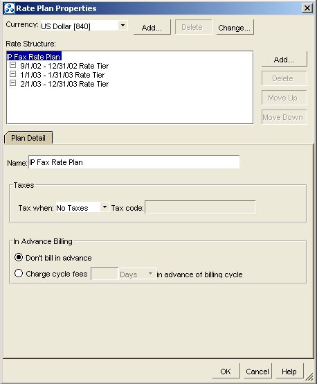

About Rate Tiers
You use rate tiers to define when and for how long rates are valid and which rates are applied first.
Figure 6-2 shows a rate plan that includes three rate tiers. Each of the rate tiers is valid for a range of dates:
Figure 6-2 Rate Plan with Three Rate Tiers
