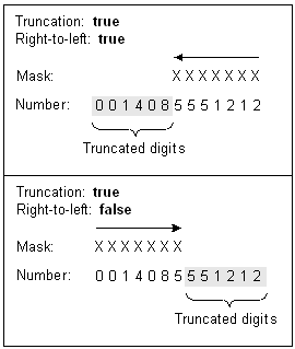

About Truncating Numbers by Using Masks
When setting the number format, you can truncate numbers. For example, if a number is entered as 001(408)5551212, you can truncate it to display as 5551212. Numbers are truncated by default.
When you truncate numbers, you can specify where to truncate: the left side of the number or the right side. By default, numbers are read from right to left, so the left side of the number is truncated.
Figure 5-1 shows the difference between truncating right to left and left to right. (A value of true truncates right to left.)
Figure 5-1 Truncating Numbers Differences
Description of Figure 5-1 follows
Description of "Figure 5-1 Truncating Numbers Differences"
Table 5-1 shows examples of how numbers are formatted based on the mask and truncation. A truncate value of true means right-to-left.
