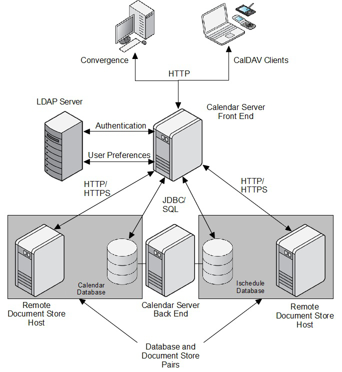

Calendar Server Front-End and Back-End Components
Calendar Server consists of the following front-end and back-end components:
Stateless J2EE-based front end (provided by the application server)
SQL back end (can be either MySQL Server or Oracle Database), for calendar data and iSchedule data
Document store, for storing large data
You can locate these components on the same host or separate the components onto multiple hosts.
Figure 2-1 shows a Calendar Server configuration that uses one front-end host and one back-end host. In this figure, the back-end host contains both the calendar database and the iSchedule database. The document stores, one for each of the databases, are located on separate hosts.
Figure 2-1 Calendar Server Front-End and Back-End Configuration
Description of "Figure 2-1 Calendar Server Front-End and Back-End Configuration"
In a multiple-host deployment, each front-end host has access to all the SQL back-end hosts. As a consequence, each front-end host has access to all Calendar Server end users' data.
Multiple front ends can be grouped together by using a simple load balancer. The load balancer must use IP-based stickiness as its load balancing method.

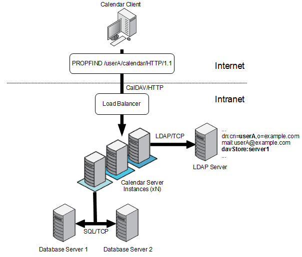

Mapping Calendar Users to Back-End Servers
In a multiple back-end host environment, when a user issues a Calendar Server request, the front-end host handling the request must determine on which back-end SQL host the targeted resource resides. Calendar Server makes this determination by using the "davstore" identifier (the actual LDAP attribute is davStore).
The mapping between Calendar Server front ends and back ends is indirect:
Each Calendar Server front-end instance is configured with a list of opaque back-end identifiers, called "davstore" identifiers. There is one "davstore" identifier per back-end SQL host database.
A Java Naming and Directory Interface (JNDI) name is associated to each "davstore" identifier (it is also in the Calendar Server configuration), for example: jdbc/davstore_id.
The application server that hosts the Calendar Server is configured with corresponding JNDI resources containing the actual back-end information such as server names, ports, database names, credentials, and so on.
At startup, Calendar Server performs a JNDI lookup for each "davstore" identifier value in its configuration.
davStore LDAP Attribute
You can add the davStore LDAP attribute to users' and resources' object classes to associate those users and resources with a particular back-end Calendar Server store. The value of the davStore attribute is equal to one of the davstore IDs defined in the server configuration. The davStore LDAP attribute is single valued. When not present, a server configurable default davstore ID is used.
Users have only one davStore LDAP attribute for all types of data. In the single user repository model, all data for users with the same davStore value is hosted on the same back-end repository. This does not prevent a deployment from using different repositories for the different types of data.

Planning the Document Store
The Calendar Server document store is used to store and retrieve large data, such as calendar events with many invitees, and todos with large attachments. You must set up one document store per configured Calendar Server back-end database. That is, every logically configured database must have its own unique document store to manage its large data. You must configure a document store even if you decide to not use its capability.
The document store can be either local or remote, or, if you use Oracle Database, within the database itself. When the document store is local, it runs as part of a Calendar Server instantiation. For example, the local document store could be part of a Calendar Server front-end installation or part of a single host installation providing both front-end and back-end functionality. When the document store is local, Calendar Server accesses the file systems directly. You can only use a local document store in a single front-end deployment, as all front-end hosts need to be able to access the data. When the document store is remote, Calendar Server accesses the documents by using either HTTP or HTTPS. If you use Oracle Database, you can configure it to contain both the calendar data and the data that otherwise would need to be stored in the separate document store. That is, you would use a single, large Oracle database for both calendar data and the document store.
You cannot configure MySQL database to contain both contact data and document store data.
In a multi-host deployment with multiple front-end hosts, you must ensure that each front-end host that accesses a back-end database must also have access to the back-end database's related document store.
The default directory for the document store is /var/opt/sun/comms/davserver/db. You can configure this by changing the store.dav.*.dbdir parameter. If at some point you move the document store, you must migrate the data.
Remote Document Store Authentication
Calendar Server provides enhanced security for remote document stores: a remote document store requires password authentication of the connection between the Calendar Server front-end host and the remote document store server.
