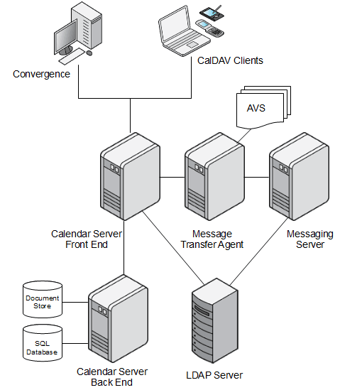

Overview of Calendar Server Virus Scanning Architecture
Figure 8-1 depicts the Calendar Server virus scanning logical architecture.
Figure 8-1 Calendar Server Virus Scanning Architecture
The following information describes how a calendar attachment is scanned for viruses.
A calendar client submits a calendar event and attachment to Calendar Server.
Calendar Server receives the event and attachment then packages the attachment as an email message for the MTA that has been configured to scan calendar attachments.
Calendar Server sends the email message containing the attachment by using the SMTP protocol to the configured MTA.
Calendar Server keeps the connection to the MTA open as it awaits the response from the MTA. During this time, the calendar client is also waiting for the MTA to reply back to Calendar Server with its verdict.
The Calendar Server function responsible for connecting to the MTA keeps the attachment.
Later, after the scan has completed, the function either stores the attachment (and possibly the event) in the Calendar Server document store or aborts if the MTA finds a virus. See step 7 for details.
The MTA receives the package on a specific channel that is configured for a sourcespamfilter, which in turn is linked to an Anti-Virus Scanner (AVS).
You actually define a sourcespamfiltern, where n is an integer in a given range, to define one of the possible sourcespamfilters on the system.
The AVS scans the package.
If the AVS detects a virus, the MTA refuses the message and replies with a virus positive message to Calendar Server over the open connection.
If the AVS does not detect a virus, the MTA uses a Messaging Server rewrite rule to send the package to the bitbucket channel and discard it. Calendar Server logs an error either when it detect a virus or the AVS is not working.
Once it is notified by the MTA, Calendar Server decides if it can continue processing the calendaring request normally or abort. If the davcore.virusscan.onlinevirusaction parameter remains unset (is using the default value) or is set to reject, the submission is rejected. The client receives the reply HttpStatus.FORBIDDEN (Virus Detected in Attachment). Otherwise if davcore.virusscan.onlinevirusaction is set to "keep," the attachment is accepted. The davcore.virusscan.onlinefailureaction parameter works similarly, except that the default action is "keep."
