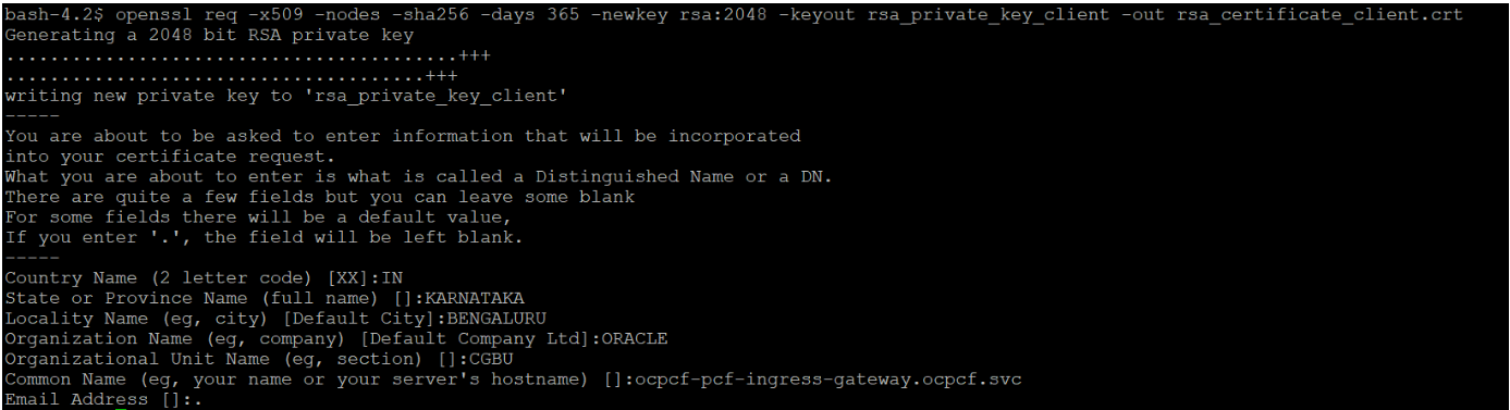

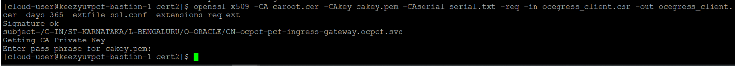

- The user should create certificates/keys (public and private) for AccessToken micro-service before deploying NRF.

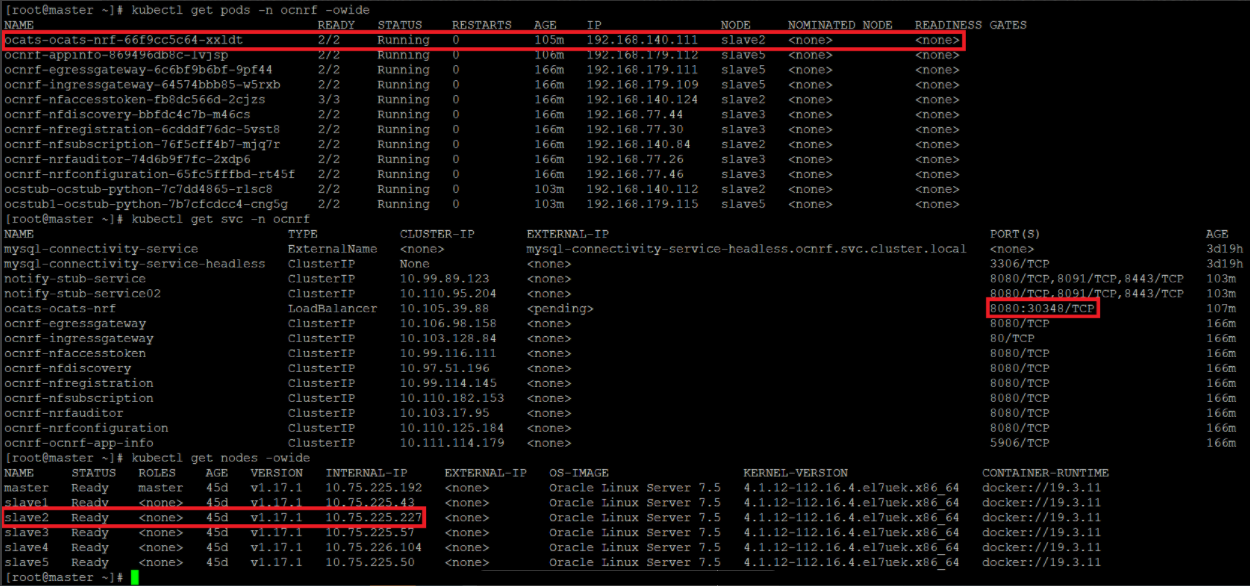

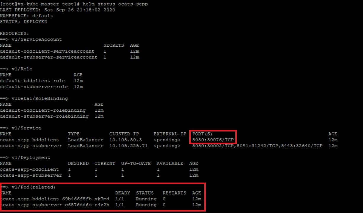

Logging into ATS
Figure 3-1 Verifying ATS Pod
You can use the external IP of the worker node and nodeport of the ATS
service as <Worker-Node-IP>:<Node-Port-of-ATS>
In the Verifying ATS Pod screen, slave2 is the node where ATS is deployed, 30348 is the ATS nodeport and 10.75.225.227 is the worker node IP, highlighed in red. For more details on ATS deployment, refer to NRF ATS Installation Procedure.Figure 3-2 ATS Login

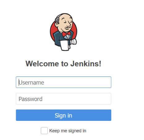

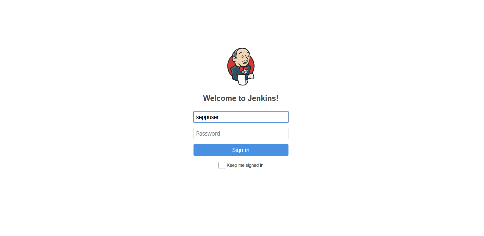

- Enter the username as 'nrfuser'
and password as
'nrfpasswd'. Click Sign
in. The following screen appears.

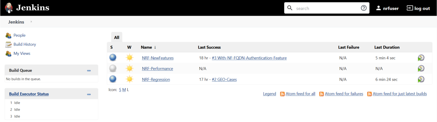

Figure 3-3 NRF Pre-Configured Pipelines
NRF ATS has three pre-configured pipelines.
- NRF-NewFeatures: This pipeline has all the test cases, which are delivered as part of NRF ATS - 1.8.0
- NRF-Performance: This pipeline is not operational as of now. It is reserved for future releases of ATS.
- NRF-Regression: This pipeline has all the test cases delivered so far in the previous releases.

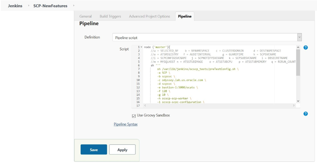

After identifying the NRF pipelines, the user needs to do one-time configuration in ATS as per NRF deployment. In this pipeline, all the new testcases related to NRF are executed. To configure its parameters:

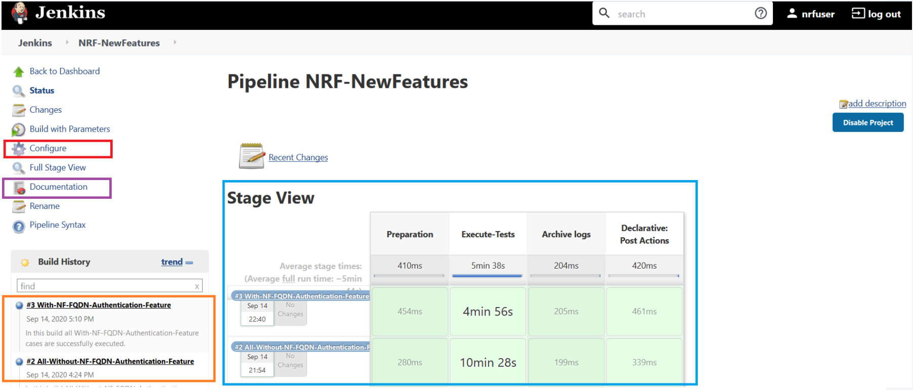

- Click NRF-NewFeatures in the Name column. Following screen appears:
Figure 3-4 Configuring NRF-New Features
In the above screen:- Click Configure to navigate to the screen where configuration needs to be done.
- Click Documentation to view the documented test cases, which are part of this NRF release.
- Click the blue dots inside Build History box to view the success console logs of the "Sanity", "All-Without-NF-FQDN-Authentication-Feature" and "With-NF-FQDN-Authentication-Feature" respectively.
- The Stage View represents the already executed pipeline for the customer reference.

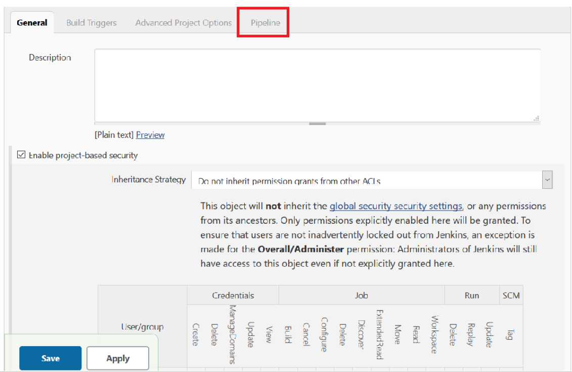

- Click Configure. User MUST wait for the page to load completely.
Once the page loads completely, click the Pipeline tab as shown below:
MAKE SURE THAT THE SCREEN SHOWN BELOW LOADS COMPLETELY BEFORE YOU PERFORM ANY ACTION ON IT. ALSO, DO NOT MODIFY ANY CONFIGURATION OTHER THAN DISCUSSED BELOW.
Figure 3-5 Pipeline Option

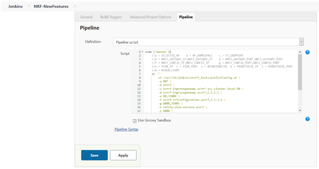

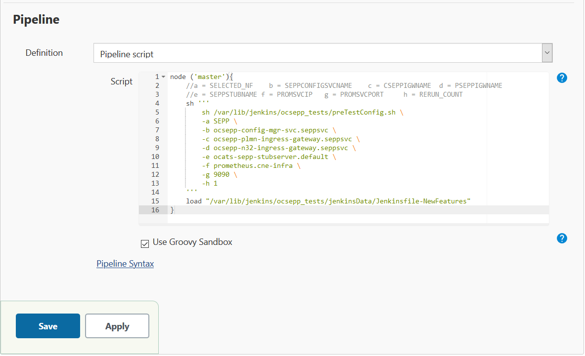

- The Pipeline section of the configuration page appears as shown
below:
Figure 3-6 Pipeline Section

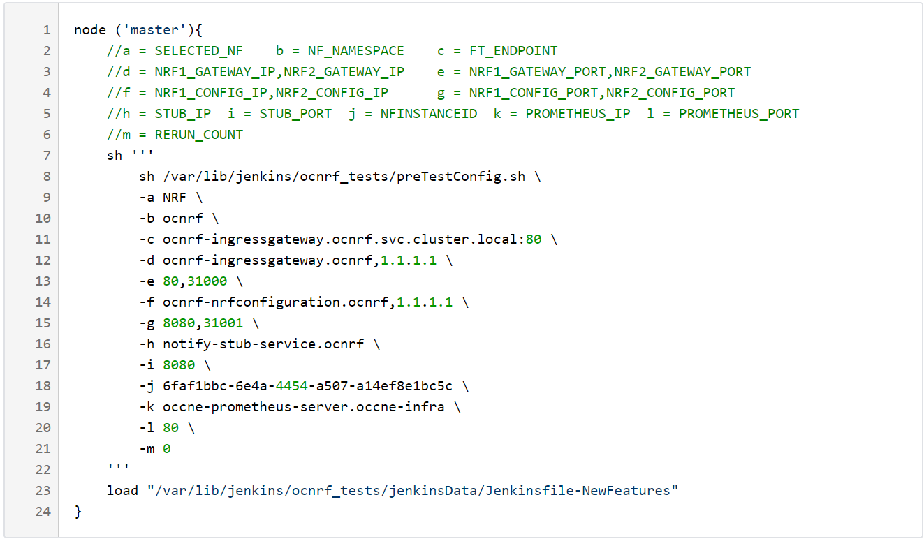

In the above screen, you can change the values of the 'Pipeline script'. The content of the pipeline script is as follows:Figure 3-7 Pipeline Script
The User MUST NOT change any other value apart from line number 9 to line 21.You can change the parameter values from "a" - to - "m" as per user requirement. The parameter details are available as comments from line number 2 - to - 6.a: Name of the NF to be tested in capital (NRF). b: Namespace in which the NRF is deployed. c: endPointIP:endPointPort value used while deploying NRF with the help of helm chart. d: Comma separated values of NRF1 and NRF2 ingress gateway service (ocnrf-ingressgateway.ocnrf,1.1.1.1). It is also known as as cluster_domain. A dummy value of NRF2 ingress gateway (1.1.1.1) is provided for the reference. e: Comma separated values of NRF1 and NRF2 port of ingressgateway service (80,31000). A dummy value of NRF2 ingress gateway port (31000) is provided for the reference. f: Comma separated values of NRF1 and NRF2 configuration service (ocnrf-nrfconfiguration.ocnrf,1.1.1.1). It is also known as as cluster_domain. A dummy value of NRF2 configuration service (1.1.1.1) is provided for the reference. g: Comma separated values of NRF1 and NRF2 port of configuration service (8080,31001). A dummy value of NRF2 configuration microservice port (31001) is provided for the reference. h: Name_of_stub_service.namespace (notify-stub-service.ocnrf). i: Port of stub service (8080). j: NRF_Instance ID (6faf1bbc-6e4a-4454-a507-a14ef8e1bc5c). k: Name_of_Prometheus_service.namespace (occne-prometheus-server.occne-infra). l: Port of Prometheus service (80). m: Number of times the re-run of failed case is allowed (default as 0).Note:
You need not to change any value if- OCCNE cluster is used
- NRF, ATS and Stub are deployed in the ocnrf namespace
- Click Save after making neccesary changes. The NRF-NewFeatures screen

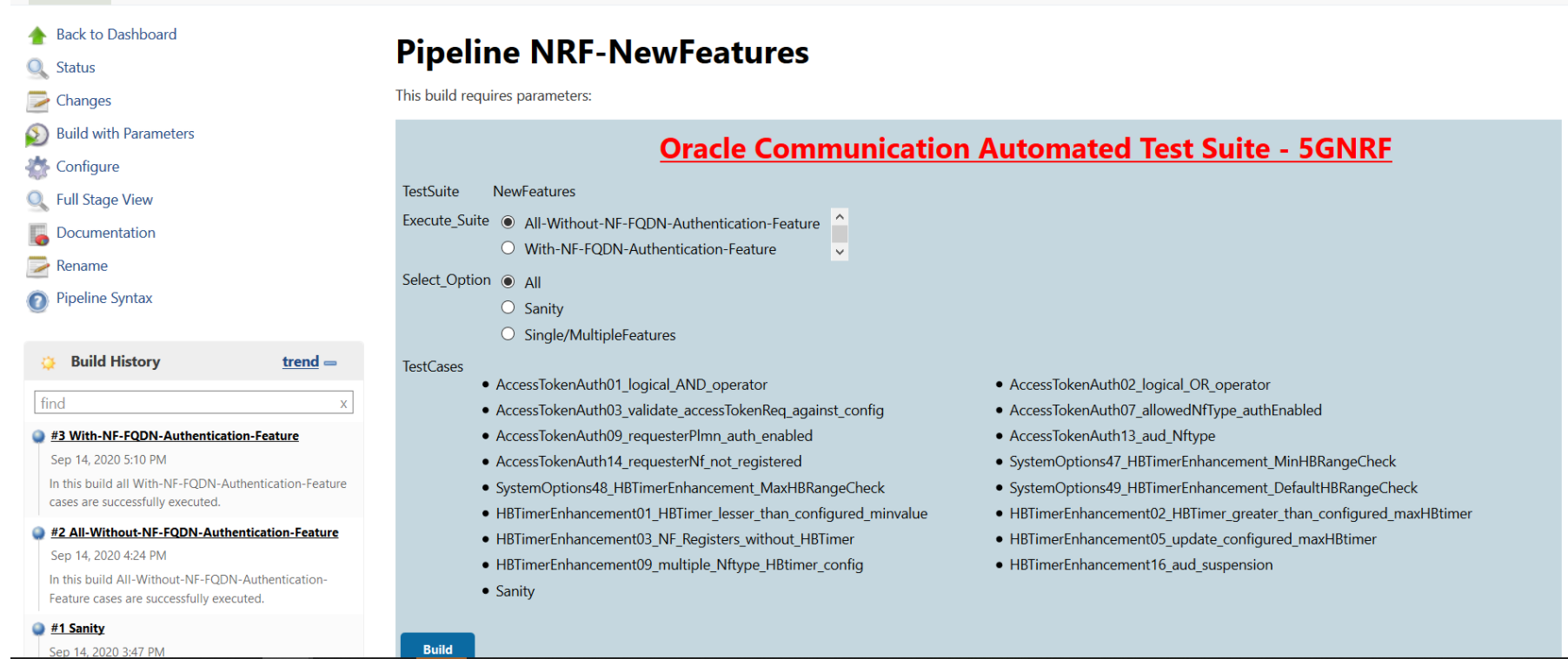

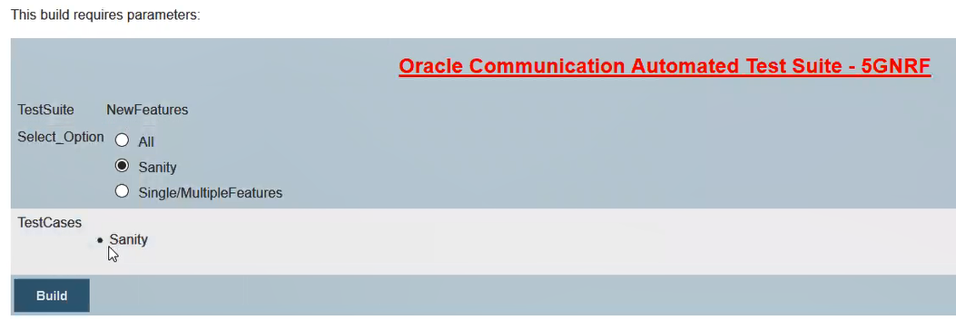

appears. Click Build with Parameters. Following screen appears:
Figure 3-8 Pipeline NRF-NewFeatures
In the above screen, you have Execute_Suite options to execute NRF test cases either:- All-Without-NF-FQDN-Authentication-Feature: This is the default option. It executes all the test cases except NF-FQDN-Authentication-Feature.
- With-NF-FQDN-Authentication-Feature: It executes all NF-FQDN-Authentication-Feature test cases.
In the above screen, there are three Select_Option(s), which are:- All: This is the default option. It executes all the NRF test cases. User just need to scroll down and click Build to execute all the test cases.
- Sanity: It is recommended to execute Sanity
before executing any test case. This helps to ensure that all the
deployments are done properly. When you select Sanity, the following
screen appears:
Figure 3-9 Build Requires Parameters - Sanity
Click Build to execute all the sanity test cases.
Sanity option is not available when Execute_Suite is set to With-NF-FQDN-Authentication-Feature. - Single/MultipleFeatures: This option allows you to select any number of test cases that you want to execute from the list of total test cases available for execution. After selecting the test cases, scroll-down and click Build. The selected NRF test cases are executed.

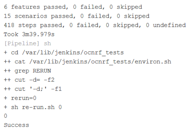

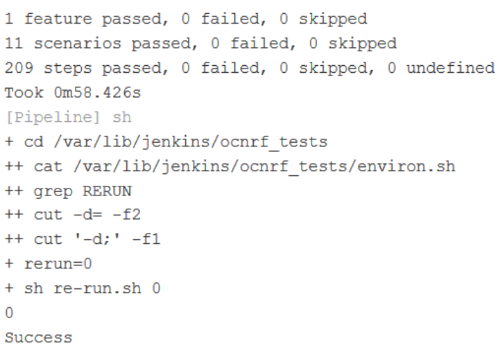

Figure 3-10 Sample Screen: NRF-ATS Full Execution
Figure 3-11 Test Cases Result - Sanity
Figure 3-12 Test Cases Result - All-Without-NF-FQDN-Authentication-Feature
Figure 3-13 Test Cases Result - All-With-NF-FQDN-Authentication-Feature

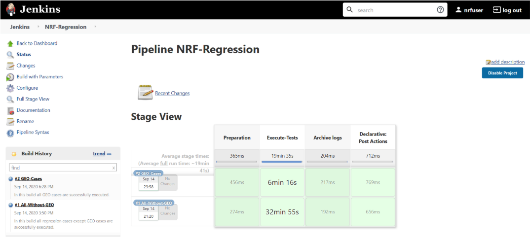

NRF-Regression Pipeline
This pre-configured pipeline contains all the test cases that are delivered till NRF ATS 1.7.0. However, some test cases are updated as per new implementation of NRF.
The configuration method and parameters are same as the NewFeatures pipeline. Only difference in this pipeline is that it does not have Sanity option. Thus to configure this pipeline, you have to provide NRF2 details.

Figure 3-16 NRF-Regression
Figure 3-17 NRF-Regression - All-Without-GEO
Figure 3-18 NRF-Regression - GEO Cases

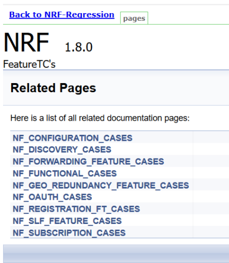

NRF-Regression Documentation

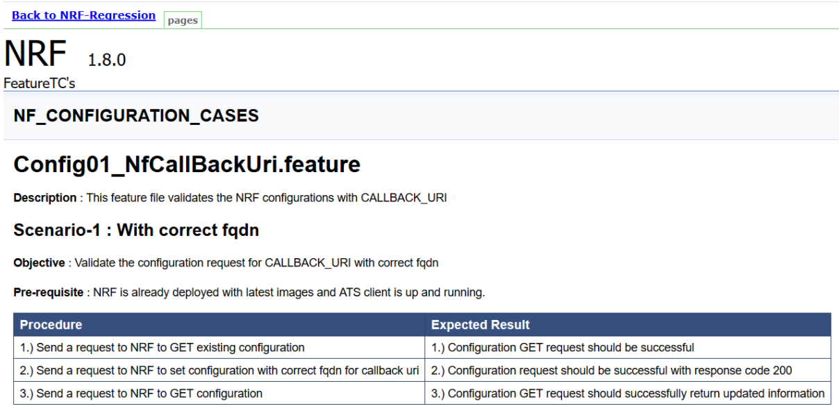

Click Documentation in the left navigation pane of the NRF-Regression pipeline to view all the test cases provided till NRF ATS 1.7.0.
- NF_CONFIGURATION_CASES - Lists the cases related to NRF configuration.
- NF_DISCOVERY_CASES - Lists all the discovery microservice related cases.
- NF_FORWARDING_FEATURE_CASES - Lists all the forwarding related cases.
- NF_FUNCTIONAL_CASES - Lists all the functional cases.
- NF_GEO_REDUNDANCY_FEATURE_CASES - Lists all the Geo-Redundancy related cases.
- NF_OAUTH_CASES - Lists all the accesstoken related cases.
- NF_REGISTRATION_CASES - Lists all the registration related cases.
- NF_SLF_FEATURE_CASES - Lists all the SLF related cases.
- NF_SUBSCRIPTION_CASES - Lists all subscription related cases.
Figure 3-19 NRF-Regression Documentation
Figure 3-20 Sample Screen: NRF-Regression Documentation

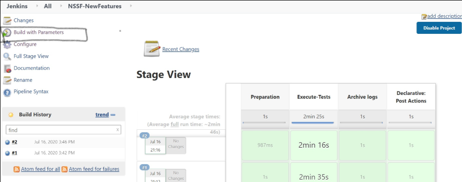

Executing ATS

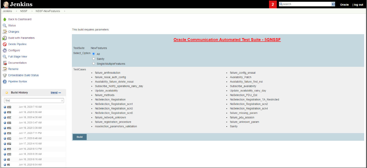

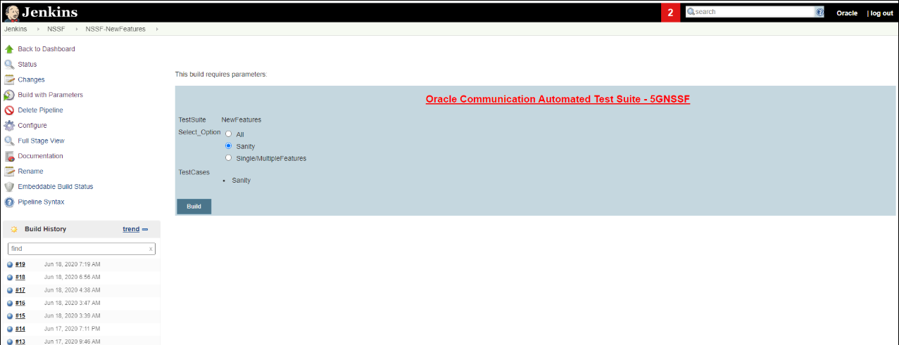

- Enter the username as 'nssfuser' and password as 'nssfpasswd'.
Click Sign in.

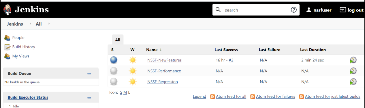

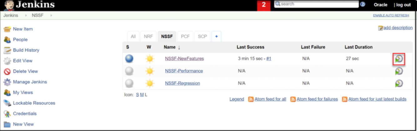

The following screen appears showing pre-configured pipelines for NSSF individually (3 Pipelines).
If you want to modify your default login password, refer to Modifying Login Password- NSSF-New-Features: This pipeline has all the test cases that are delivered as part of NSSF ATS - 1.4.
- NSSF-Performance: This pipeline is not operational as of now. It is reserved for future releases of ATS.
- NSSF-Regression: This pipleine has all the test cases of previous releases. As this is the first release of NSSF-ATS, this pipeline does not show any previous release test cases.
Figure 3-22 Pre-Configured Pipelines
Each one of this pipeline is explained below:- NSSF-NewFeatures Pipeline: After identifying
the NSSF pipelines, the user needs to do one-time configuration
in ATS as per their SUT deployment. In this pipeline, all the
new testcases related to NSSF are executed. To configure its
parameters:

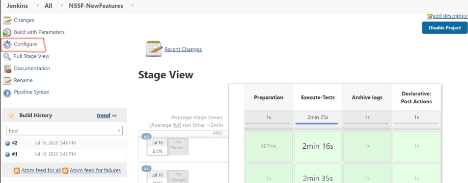

- Click NSSF-NewFeatures in the Name
column. The following screen appears:
Figure 3-23 NSSF-NewFeatures Pipeline
In the above screen:- Click Configure to navigate to a screen where configuration needs to be done.
- Click Documentation to view the documented test cases.
- Click blue dots inside Build History box to view the success console logs of the "All" and "Sanity" respectively.
- The Stage View represents already executed pipeline for the customer reference.

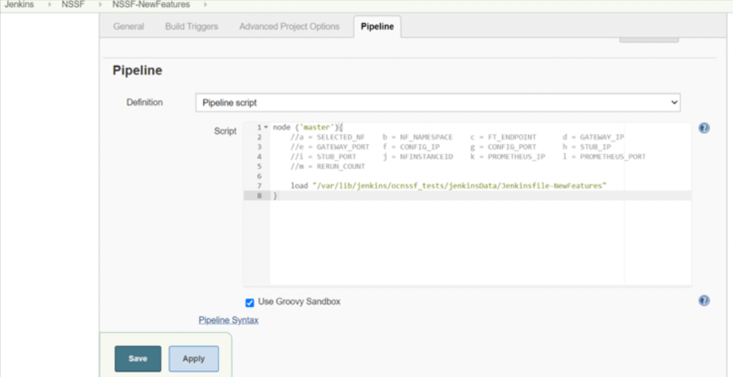

- In the above screen, the values of the
'Pipeline script' needs to be changed. The content of
follows:
node ('master'){ //a = SELECTED_NF b = NF_NAMESPACE c = FT_ENDPOINT d = GATEWAY_IP //e = GATEWAY_PORT f = CONFIG_IP g = CONFIG_PORT h = STUB_IP //i = STUB_PORT j = NFINSTANCEID k = PROMETHEUS_IP l = PROMETHEUS_PORT //m = RERUN_COUNT sh ''' sh /var/lib/jenkins/ocnssf_tests/preTestConfig.sh \ -a NSSF \ -b ocnssf \ -c ocnssf-ingressgateway.ocnssf.svc.cluster.local:80 \ -d ocnssf-ingressgateway.ocnssf \ -e 80 \ -f ocnssf-nssfconfiguration.ocnssf \ -g 8080 \ -h notify-stub-service.ocnssf \ -i 8080 \ -j 6faf1bbc-6e4a-4454-a507-a14ef8e1bc5c \ -k occne-prometheus-server.occne-infra \ -l 80 \ -m 2 ''' load "/var/lib/jenkins/ocnssf_tests/jenkinsData/Jenkinsfile-NewFeatures" }Note:
The User MUST NOT change any other value apart from line number 8 to line 20.You can change only those parameters that are marked as "a" to "m" as per your requirement.
- a - Name of the NF to be tested in capital (NSSF).
- b - Namespace in which the NSSF is deployed
- c - endPointIP:endPointPort value used while deploying the NSSF using the helm chart
- d - Name_of_NSSF_ingressgateway_service.namespace (ocnssf-nssfconfiguration.ocnssf) - this is also known as as cluster_domain.
- e - Port of ingressgateway service (80)
- f - Name_of_NSSF_configuration_service.namespace (ocnssf-nssfconfiguration.ocnssf)
- g - Port of configuration service (8080)
- h - Name_of_stub_service.namespace (notify-stub-service.ocnssf)
- i - Port of stub service (8080)
- j - NSSF_Instance ID (6faf1bbc-6e4a-4454-a507-a14ef8e1bc5c)
- k - Name_of_Prometheus_service.namespace (occne-prometheus-server.occne-infra)
- l - Port of Prometheus service (80)
- m - Number of times the re-run of failed case is allowed (default as 2).
You do not have to change any value if OCCNE cluster is used and NSSF, ATS and STUB are deployed in ocnssf namespace. - Click Save after making necessary
changes. You are navigated back to the Pipeline
NSSF-NewFeatures screen. Click Build with
Parameters as shown below:
Figure 3-25 Build with Parameters
Executing NSSF Test Cases
- Click the Schedule a Build with parameters icon present on the
NSSF-NewFeatures screen in the extreme right column corresponding to
NSSF-NewFeatures row as shown below:
Figure 3-27 Schedule a Build with Parameters
- The following screen appears:
Figure 3-28 Build Screen
- All: By default, all the NSSF test cases are selected for execution. User just needs to scroll down and click Build to execute all the test cases.
deployments are done properly or not. When you select Sanity, the
Figure 3-29 Select_Option(s) - Sanity

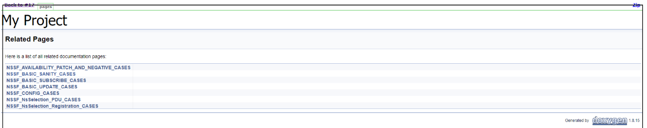

To view NSSF functionalities, go to NSSF-NewFeatures pipeline and click the Documentation link in the left navigation pane. The following screen appears:
Figure 3-30 NSSF - Documentation
Each one of the documentation features is described below:
- NSSF_BASIC_SANITY_CASES - Lists all the sanity cases, which are useful to identify whether all the NSSF functionality works fine.
- NSSF_CONFIG_CASES - Lists all the test cases related to NSSF configuration.
- NSSF_BASIC_UPDATE_CASES - Lists all the test cases relaed to Availability Update.
- NSSF_AVAILABILITY_PATCH_AND_NEGATIVE_CASES - Lists all the test cases related to Availability Patch and other negative scenarios.

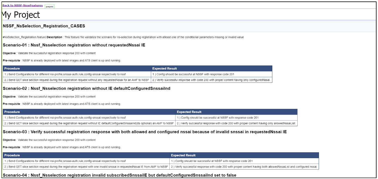

- NSSF_NsSelection_REGISTRATION_CASES - Lists all the test cases related to NsSelection registration.
- NSSF_NsSelection_PDU_CASES - Lists all the test cases related to NsSelection PDU related cases.

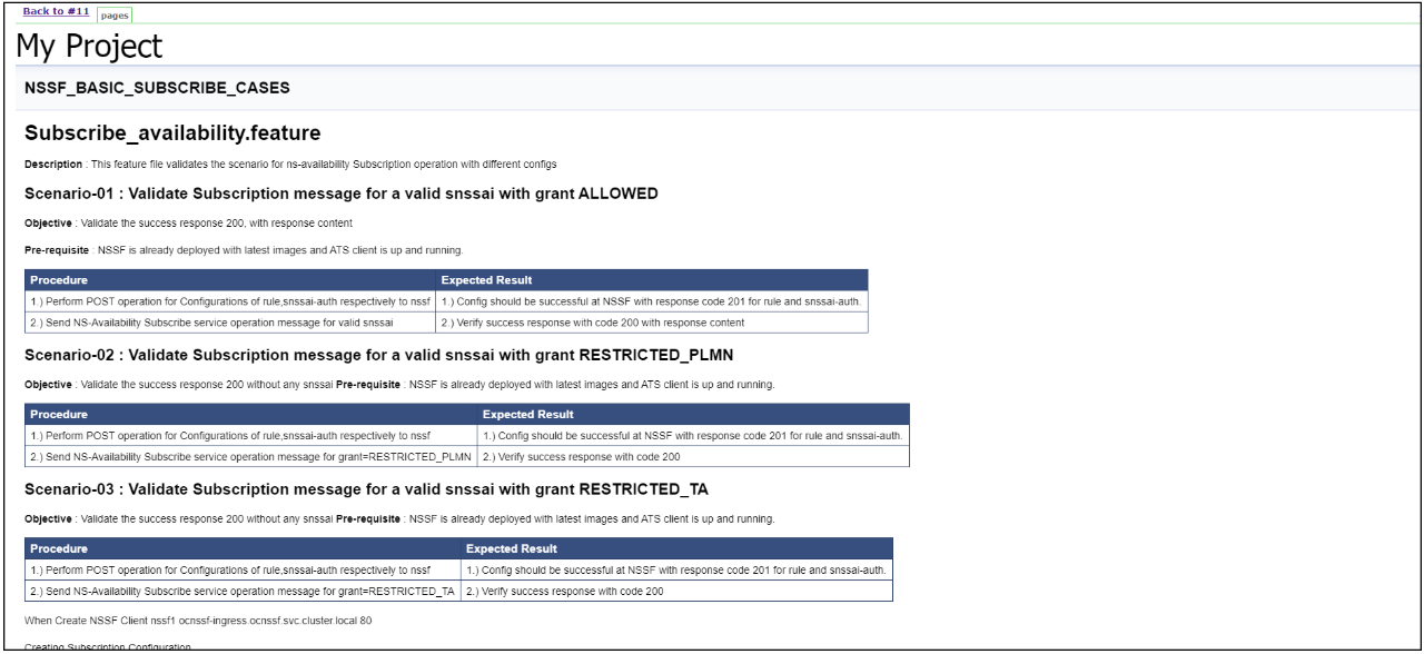

- NSSF_BASIC_SUBSCRIBE_CASES - Lists all the test cases related to subscription.
Figure 3-31 NSSF_BASIC_SANITY_CASES
Figure 3-32 NSSF_BASIC_SUBSCRIBE_CASES
Figure 3-33 NSSF_NsSelection_Registration_CASES

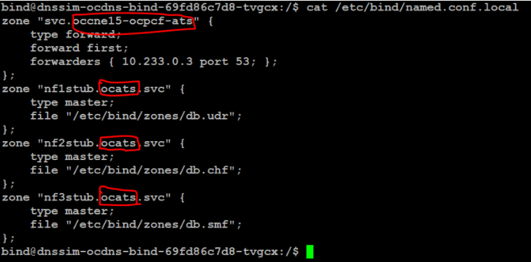

kubectl exec -it ocdns-ocdns-bind-86888f75cf-kv64w -n ocpcf bash - Edit the named.conf.local file present in /etc/bind location.
- Replace occne15-ocpcf-ats with cluster name where ocpcf is deployed.
- Replace ocats with the namespace where stubs are deployed.
- Replace 10.233.0.3 with the core DNS server IP address in your
deployment. If the core DNS server IP address is not known, you can
use the next available forwarder IP address. Execute the following
command inside DNS stub pod to know the next available
forwarder:
cat /etc/resolv.confFigure 3-34 Editing named.conf.local

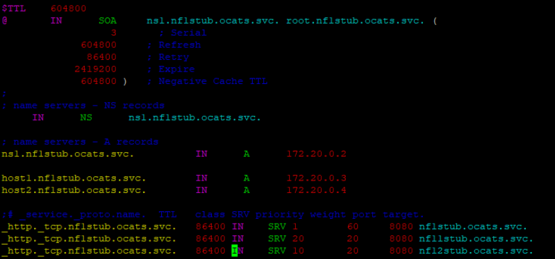

- Go to /etc/bind/zones and edit each of these files;
db.udr, db.chf and db.smf. Replace
Figure 3-35 Editing db.udr, db.chf and db.smf files

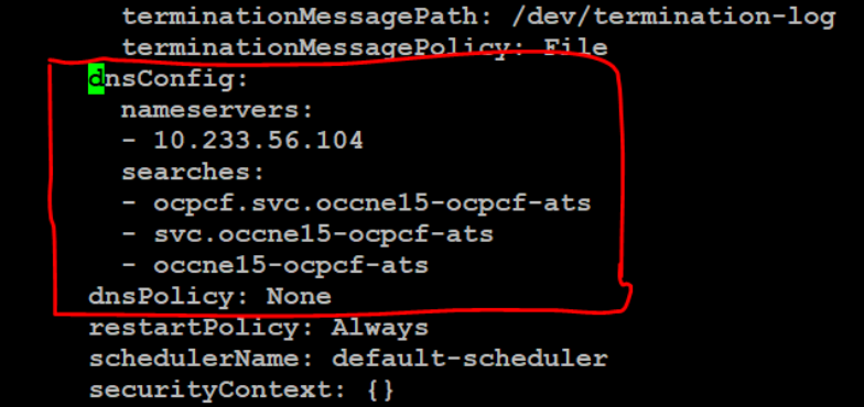

- Edit the Alternate Route Service deployment that points toward DNS Stub.
By default, it points to CoreDNS with following settings in deployment file:
Figure 3-36 Alternate Route Service Deployment File
- Execute the following command to add the given content in
alternate service to query DNS stub:
kubectl edit deployment ocpcf-occnp-alternate-route -n ocpcf - Add the IP Address of the nameservers that you have recorded after installing the DNS stub (cluster IP Address of DNS Stub).
- Add the search function based on cluster name and namespace
where you have deployed PCF:
occne15-ocpcf-ats → cluster nameocpcf → namespace where pcf deployed - Set dnsPolicy to "None".
Figure 3-37 Policy Alternate Service - DNS Config Info

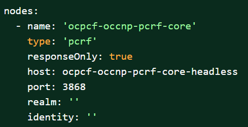

Execute the following command to edit and set the default configuration of Diameter peer in the diam configuration map and set the responseOnly parameter to true.
kubectl edit cm oc-diam-gateway-config-peers -n <namespace>Figure 3-38 Setting Diameter Log Level Configuration

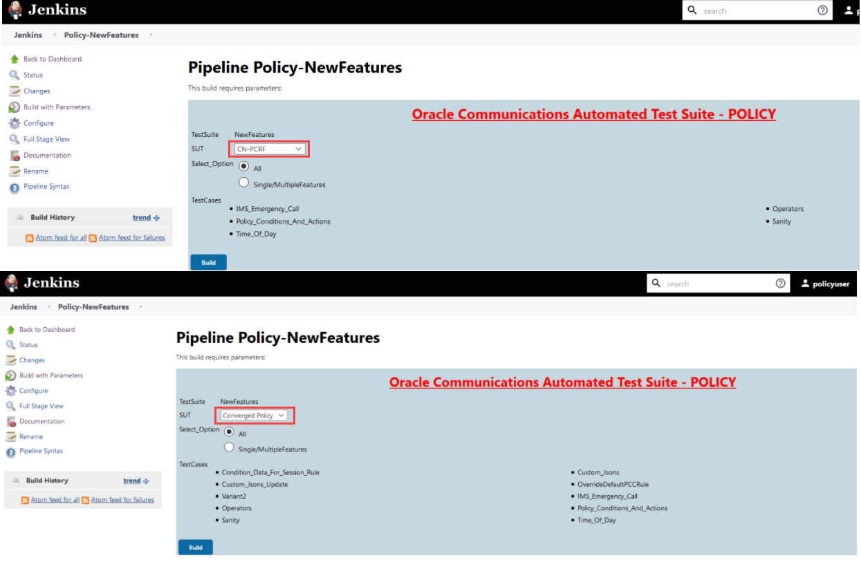

- Converged Policy: It is same as PCF and CN-PCRF. You can refer to explanation given above.

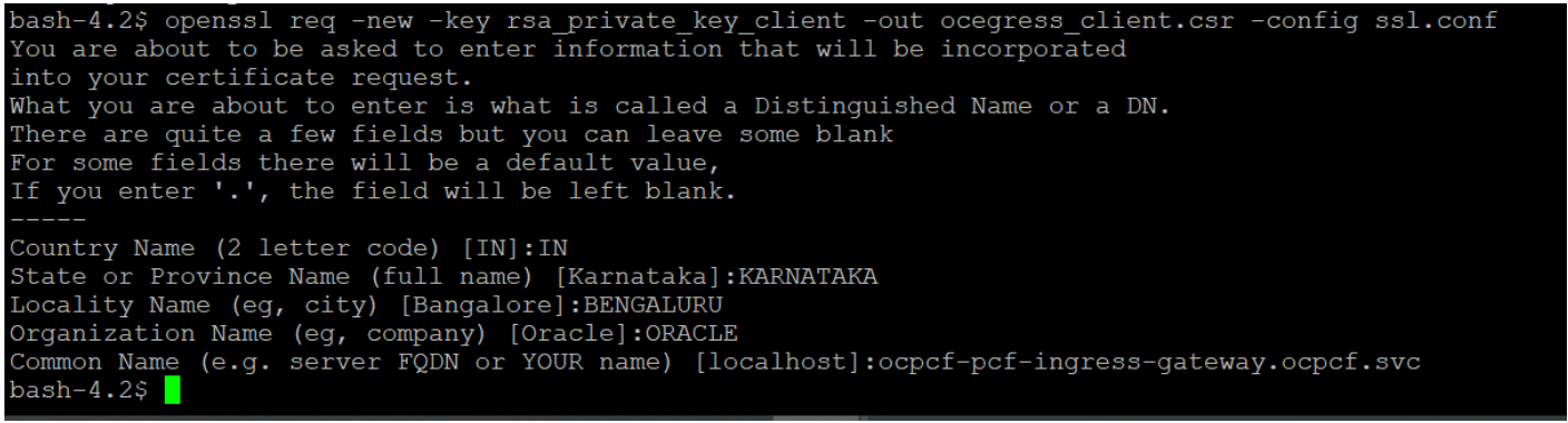

kubectl exec -it <ATS-Pod-name> bash -n <namespace> - Execute the following commands from cert directory to create private key and
certificates:
openssl req -x509 -nodes -sha256 -days 365 -newkey rsa:2048 -keyout rsa_private_key_client -out rsa_certificate_client.crtFigure 3-39 Command 1
You need to provide appropriate values and specify fqdn of PCF Ingress Gateway service i.e. <ingress-servicename>.<pcf_namespace>.svc in Common Name. -
openssl rsa -in rsa_private_key_client -outform PEM -out rsa_private_key_pkcs1_client.pemFigure 3-40 Command 2
openssl req -new -key rsa_private_key_client -out ocegress_client.csr -config ssl.conf
You can either use or copy the ssl.conf file, which was used while deploying PCF to ATS pod for this step.Figure 3-41 Command 3
- Execute the following command to copy the ocegress_client.csr to the
bastion.
openssl x509 -CA caroot.cer -CAkey cakey.pem -CAserial serial.txt -req -in ocegress_client.csr -out ocegress_client.cer -days 365 -extfile ssl.conf -extensions req_extFigure 3-42 Copying ocegress_client.csr to bastion

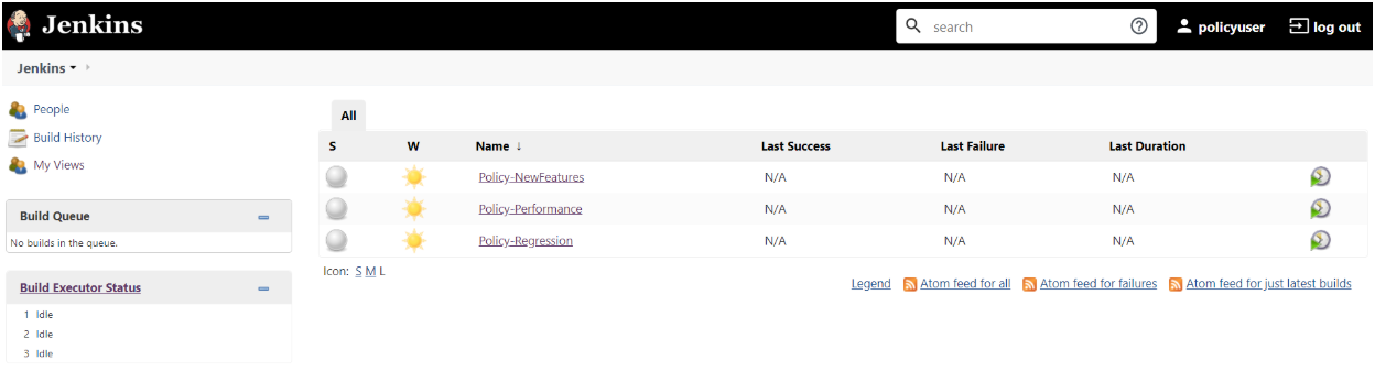

Logging into ATS
Before logging into ATS Jenkins GUI, it is important to get the nodeport of the service, 'ocats-Policy'. Execute the following command to get the nodeport:
kubectl get svc -n <Policy_namespace>
Example:
kubectl get svc -n ocpcf

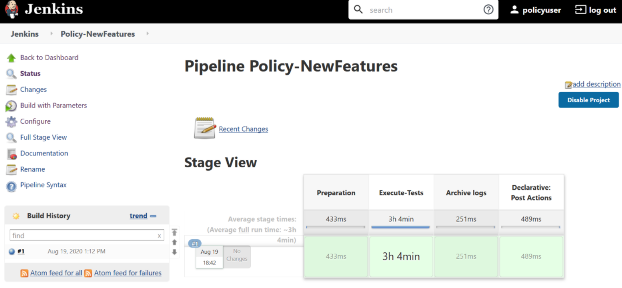

Figure 3-43 Policy Nodeport
To login to Jenkins, open the Web Browser and type the URL: http://<Worker-Node-IP>:<Node-Port-of-ATS>. In the above screen, 32471 is the nodeport. Example: http://10.75.225.49:32471
For more information on ATS deployment in PCF, refer to Policy ATS Installation Procedure.Executing ATS
To execute ATS:
- Enter the username as "policyuser" and
password as
"policypasswd". Click Sign
in.
The following screen appears showing policy pre-configured pipelines:
If you want to modify your default login password, refer to Modifying Login Password- Policy-NewFeatures: This pipeline has all the test cases, which are delivered as part of Policy ATS.

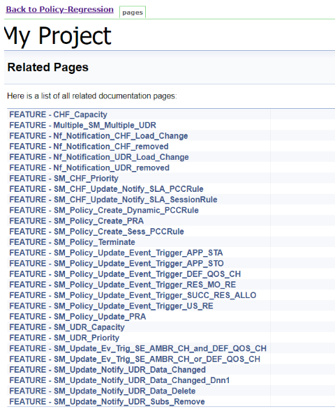

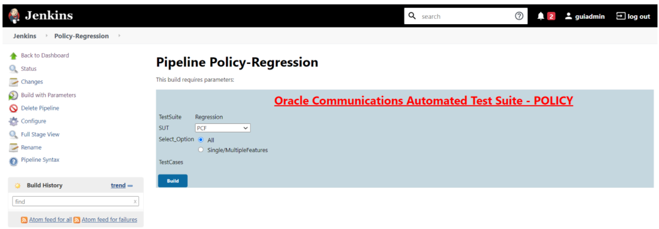

- Policy-Performance: This pipeline is not operational as of now. It is reserved for future releases of ATS.
- Policy-Regression: This pipleine has all the test cases, which were delivered in Policy ATS - 1.7.4
Figure 3-44 Pre-Configured Pipelines

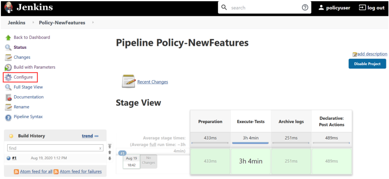

- Click Policy-NewFeatures in the Name column and then, click
Configure in the left navigation pane as shown below:
Figure 3-45 Policy-NewFeatures Configure

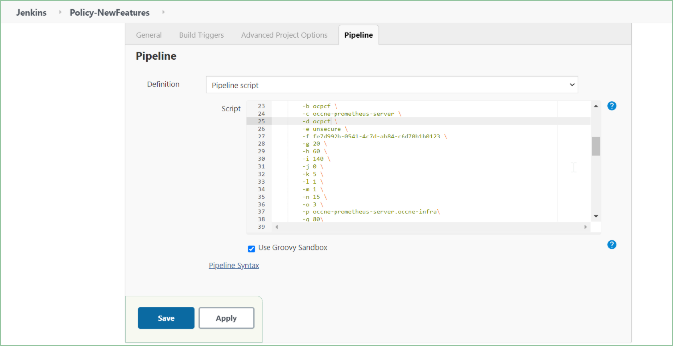

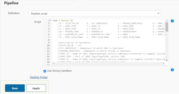

- The Policy-NewFeatures, General tab appears. Make sure that the screen loads completely.
- Scroll-down to the end. The control moves from General tab to
Figure 3-46 Policy - Pipeline Script
In the Script area of the Pipeline section, you can change value of the following parameters:- b: Change this parameter to update the namespace where Policy was deployed in your bastion.
- d: Change this parameter to update the namespace where your gostubs are deployed in your bastion.
- e: Set this parameter as 'unsecure', if you intend to run ATS in TLS disabled mode. Else, set this parameter as 'secure'.
- g: Set this parameter to more than 35 secs. The default wait time for the pod is 35 secs. Every TC requires restart of the nrf-client-management pod.
- h: Set this parameter to more than 60 secs. The default wait time to add a configured policy to the database is 60 secs.
- i: Set this parameter to more than 140 secs. The default wait time for Nf_Notification Test Cases is given as 140 secs.
- k: Use this parameter to set the waiting time to initialize Test Suite.
- l: Use this parameter to set the waiting time to get response from Stub.
- m: Use this parameter to set the waiting time after adding Policy Configuration.
- n: Use this parameter to set the waiting time after adding Policy.
- o: Use this parameter to set the waiting time before sending next message.
- p: Use this parameter to set Prometheus Server IP.
- q: Use this parameter to set Prometheus Server
Port.
DO NOT MODIFY ANYTHING OTHER THAN THESE PARAMETER VALUES. - Click Save after updating the parameters value.
The Policy-NewFeatures Pipeline screen appears.
It is advisable to save the pipeline script in your local machine that you can refer at the time of ATS pod restart.

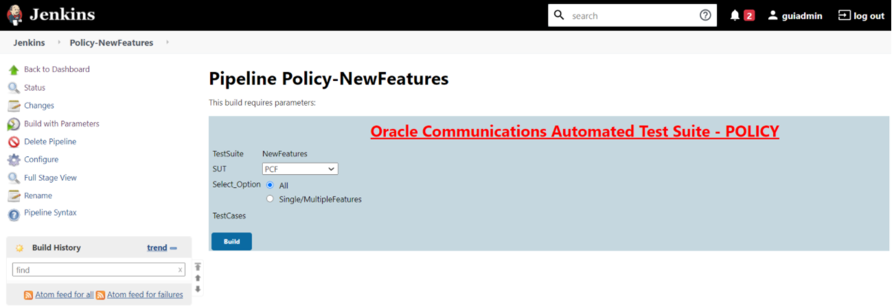

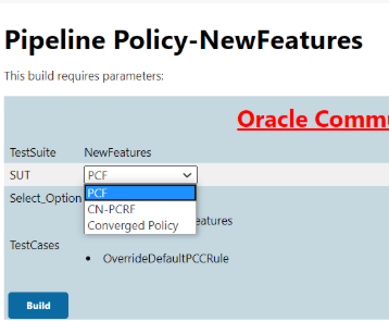

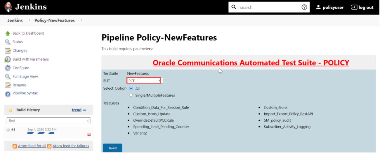

- Click the Build with Parameters link available in the left navigation
pane of the Policy-NewFeatures Pipeline screen. The following screen
appears.
Figure 3-47 Policy - Build with Parameters
Jenkins display empty TestCases list as it is referring to the custom folder for Policy NewFeatures.Copy the required test cases that are available in the PCF/PCRF/Common folder and place them in the appropriately within custom folder for Policy-NewFeatures. Reload the Jenkins page to view the cases available in the custom NewFeatures folder.Figure 3-48 Policy - Viewing Custom test Cases
In the above screen, you can select SUT as either PCF, CN-PCRF or Converged Policy. It also has two Select_Option(s), which are:- All: By default, all the Policy test cases are selected for execution. Scroll down and click Build to execute all the test cases.
- Single/MultipleFeatures: This option allows you to select any number of test cases that you want to execute from the list of total test cases available for execution. After selecting the test cases, scroll-down and click Build. The selected Policy test cases are executed.
Figure 3-49 SUT Options
Based on your selection, related TestCases appear.Figure 3-50 Test Cases based on SUT
Converged Policy Test cases are combination of PCF and CN-PCRF TestCases.Go to Build → Console Output to view the test result output as shown below:

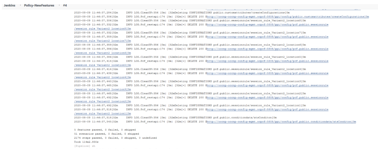

Figure 3-51 Sample: Test Result Output in Console
Figure 3-52 Sample Output of Build Status

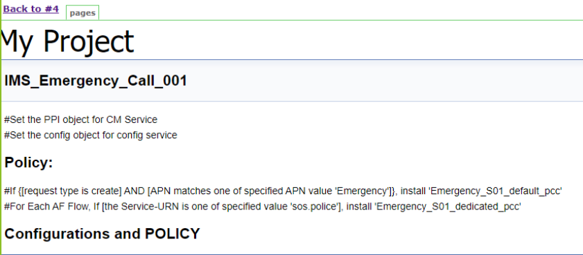

NewFeatures - Documentation
Figure 3-53 Policy-NewFeatures Feature List
Figure 3-54 IMS_Emergency_Call_001
Based on the functionalities covered under Documentation, the Build Requires Parameters screen displays test cases. To navigate back to the Pipeline Policy-NewFeatures screen, click Back to Policy-NewFeatures link available on top left corner of the screen.
PCF-Regression Pipeline
This pre-configured pipeline has all the test cases of previous releases. For example, as part of Release 1.8.0, this pipeline has all the test cases that were released as part of release 1.7.4
Figure 3-55 Policy-Regression
Jenkins display empty TestCases list as it is referring to the custom folder for Policy-Regression pipeline.Figure 3-56 Policy - Regression - Viewing Custom Test Cases

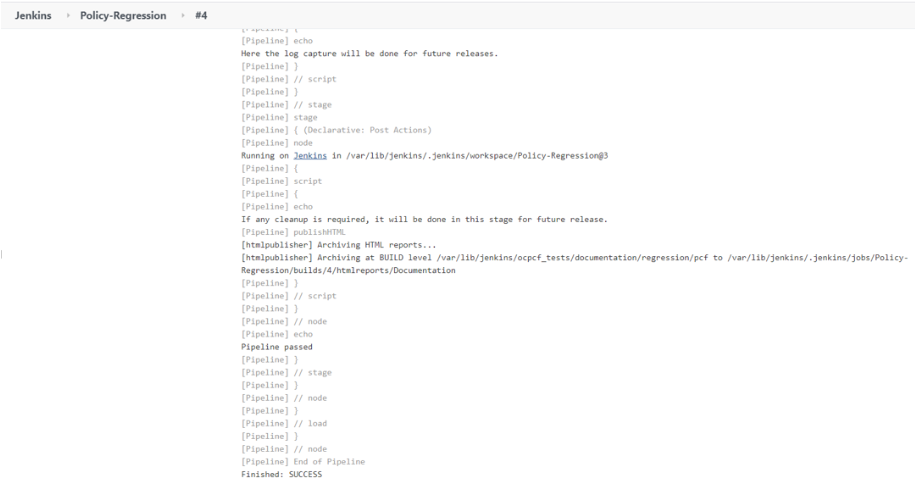

Figure 3-57 Policy-Regression Build Output
Figure 3-58 Policy-Regression Console Output
The regression pipeline does not have any sanity option. However, you should perform all the steps as performed in NewFeatures pipeline. Configure the pipeline script changes to provide environment variables.Regression - Documentation
Figure 3-59 Policy-Regression Documentation
Figure 3-60 Sample: Regression Documentation - Feature
This screen shows functionalities of only those test cases that are released in previous releases.

Logging into ATS

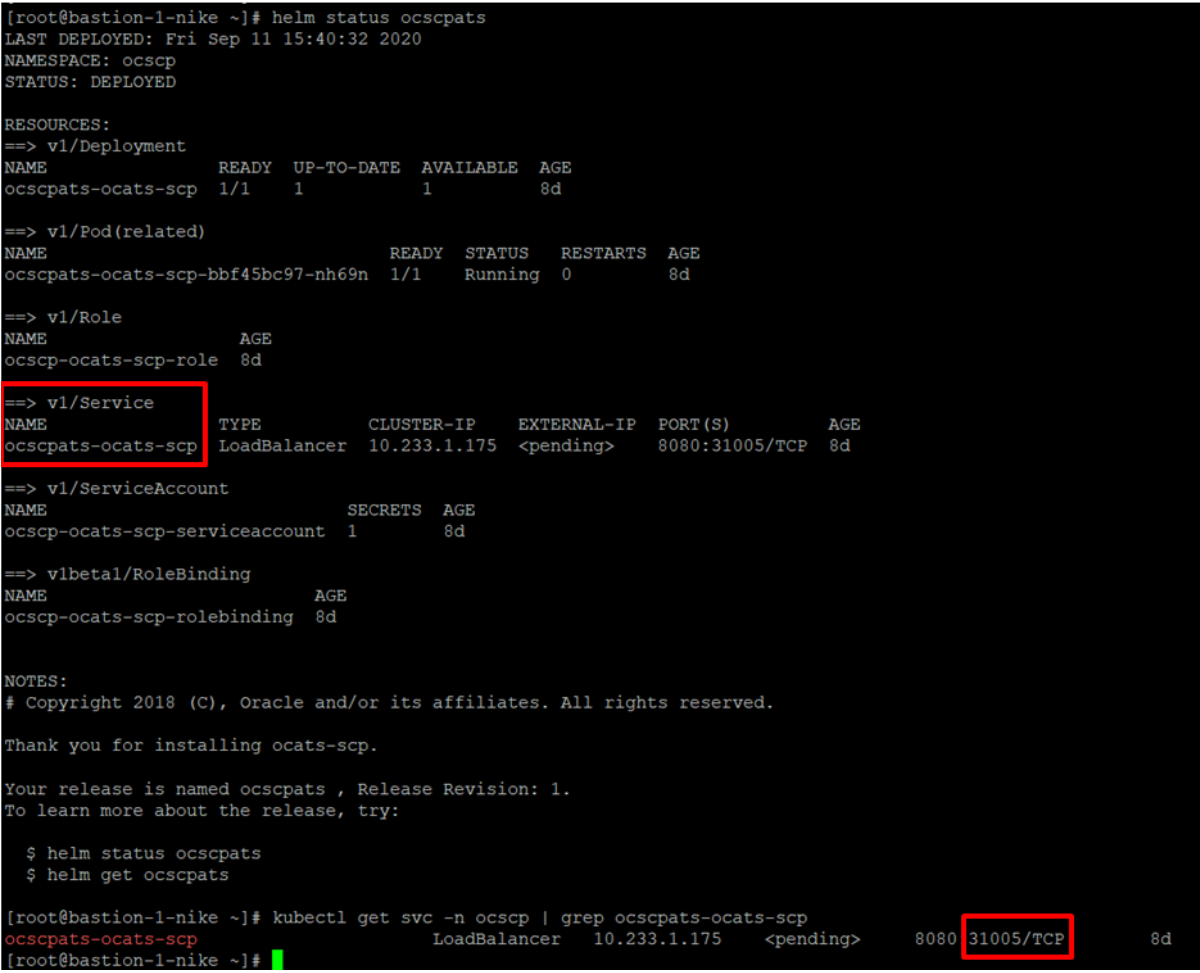

Figure 3-61 Verifying ATS Deployment
To login to ATS Jenkins GUI, open the browser and provide the external IP of
the worker node and nodeport of the ATS service as
<Worker-Node-IP>:<Node-Port-of-ATS>. The Jenkins login
screen appears.
In the Verifying ATS Deployment screen, the ATS nodeport is highlighed in red as 31005. For more details on ATS deployment, refer toSCP ATS Installation Procedure .Executing ATS

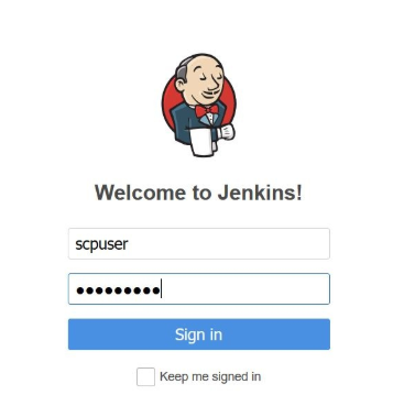

- Enter the username as "scpuser" and password as
"scppasswd". Click Sign in. A sample screen is shown below.
Figure 3-62 Logging into ATS GUI

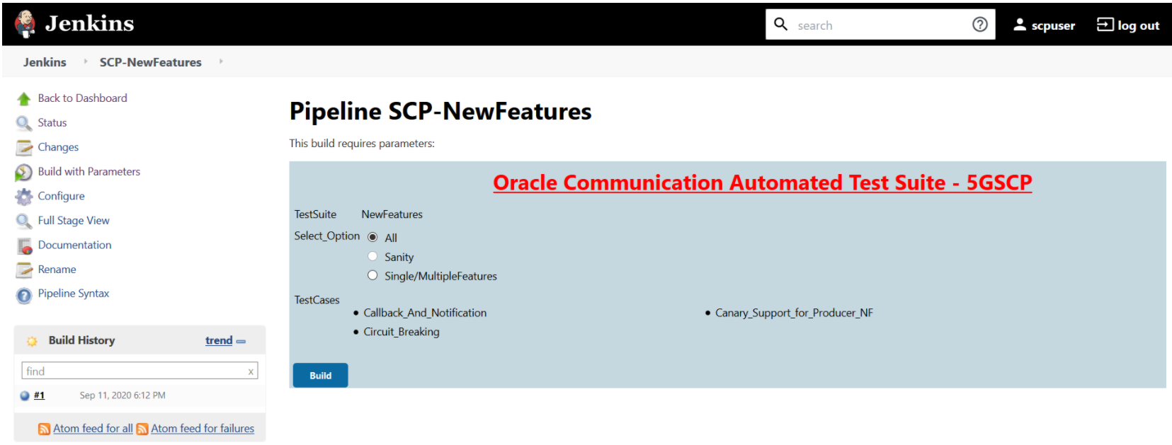

Figure 3-63 ATS SCP First Logged-In Screen
Pipeline SCP-NewFeatures
This is a pre-configured pipeline where all the SCP test cases are executed. If you are executing SCP pipeline for the first time then you have to set the Input Parameters before executing any test case. There is no need to set these parameters again unless there is any change in the configuration.
- Click SCP-NewFeatures in the Name column. The following
screen appears:
Figure 3-64 SCP-NewFeatures
- Click Configure in the left navigation pane to provide input
parameters. The SCP-NewFeatures Configure - General tab appears.
MAKE SURE THAT THE SCREEN SHOWN BELOW LOADS COMPLETELY BEFORE YOU PERFORM ANY ACTION ON IT. ALSO, DO NOT MODIFY ANY CONFIGURATION OTHER THAN DISCUSSED BELOW. - Scroll-down to the end. The control moves from General tab to
Figure 3-65 Pipeline Tab
You can modify script pipeline parameters from "-b" to "-q" on the basis of your deployment environment and click Save. The content of the pipeline script is as follows:The description of these parameters is as follows:Figure 3-66 SCP Pipeline Content
- -a - Selected NF
- -b - NameSpace in which SCP is Deployed
- -c - Kubernetes Cluster Domain where SCP is Deployed
- -d - Test Stubs NameSpace - must be same as SCP Namespace
- -e - Docker registry where test stub image is available
- -f - Audit Interval provided in SCP Deployment file
- -g - Guard Time provided SCP Deployment file
- -h - SCP-Worker microservice name as provided during deployment
- -i - SCPC-Configuration microservice name as provided during deployment
- -j - SCPC-Notification microservice name as provided during deployment
- -k - SCPC-Subscription microservice name as provided during deployment
- -l - DB Secret name as provided during deployment
- -m - Mysql Host name as provided during deployment
- -n - Test Stub Image Name with tag
- -o - Test Stub CPU requests and limit
- -p - Test Stub Memory requests and limit
- -q - re-run count
DO NOT MODIFY ANYTHING OTHER THAN THESE PARAMETERS. - Click the Build with Parameters. Following screen

Figure 3-67 Build with Parameters Options
In the above screen, there are three Select_Option(s), which are:- All: By default, all the SCP test cases are selected for execution. User just need to scroll down and click Build to execute all the test cases.
- Sanity: This option is NOT AVAILABLE for SCP.
- Single/MultipleFeatures: This option allows you to select any number of test cases that you want to execute from the list of total test cases available for execution. After selecting the test cases, scroll-down and click Build. The selected SCP test cases are executed.

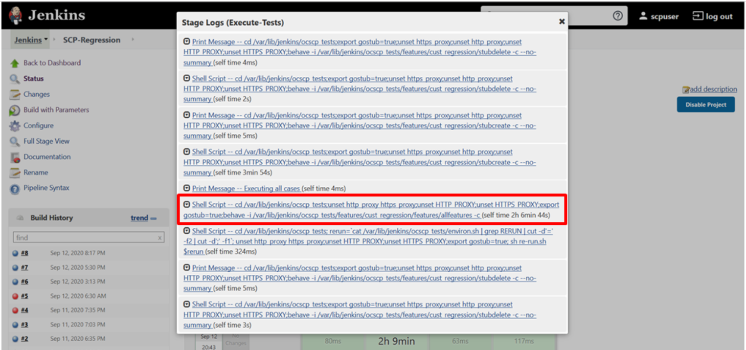

- To check execution results and logs:
- Click the execute-tests stage of pipeline and then logs.
- Select the test execution step.
- Double-click to open the execution logs console.
Figure 3-68 SCP-NewFeatures Stage Logs

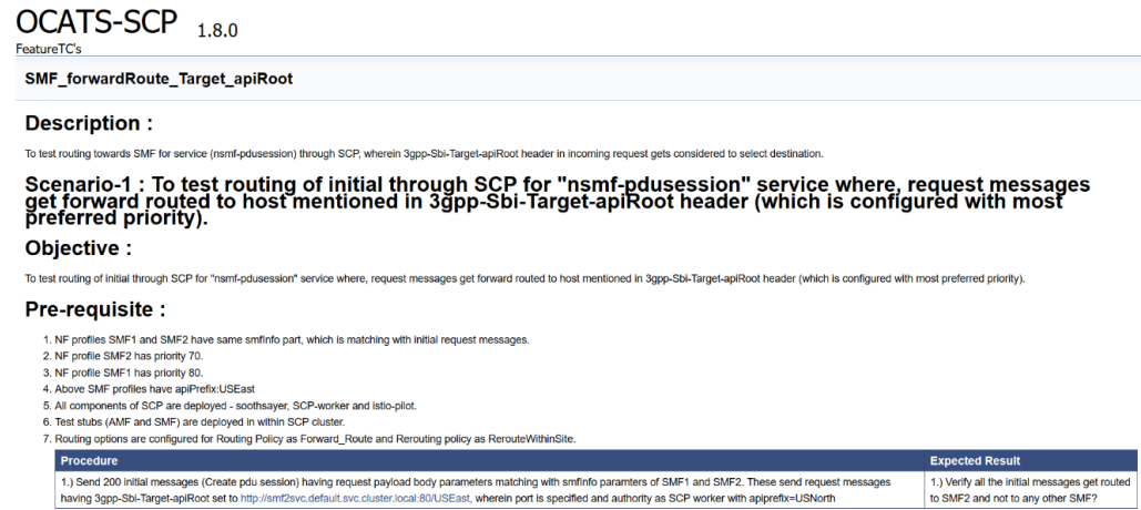

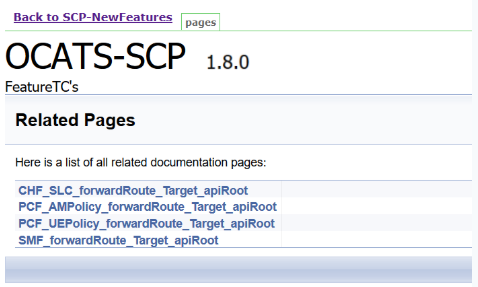

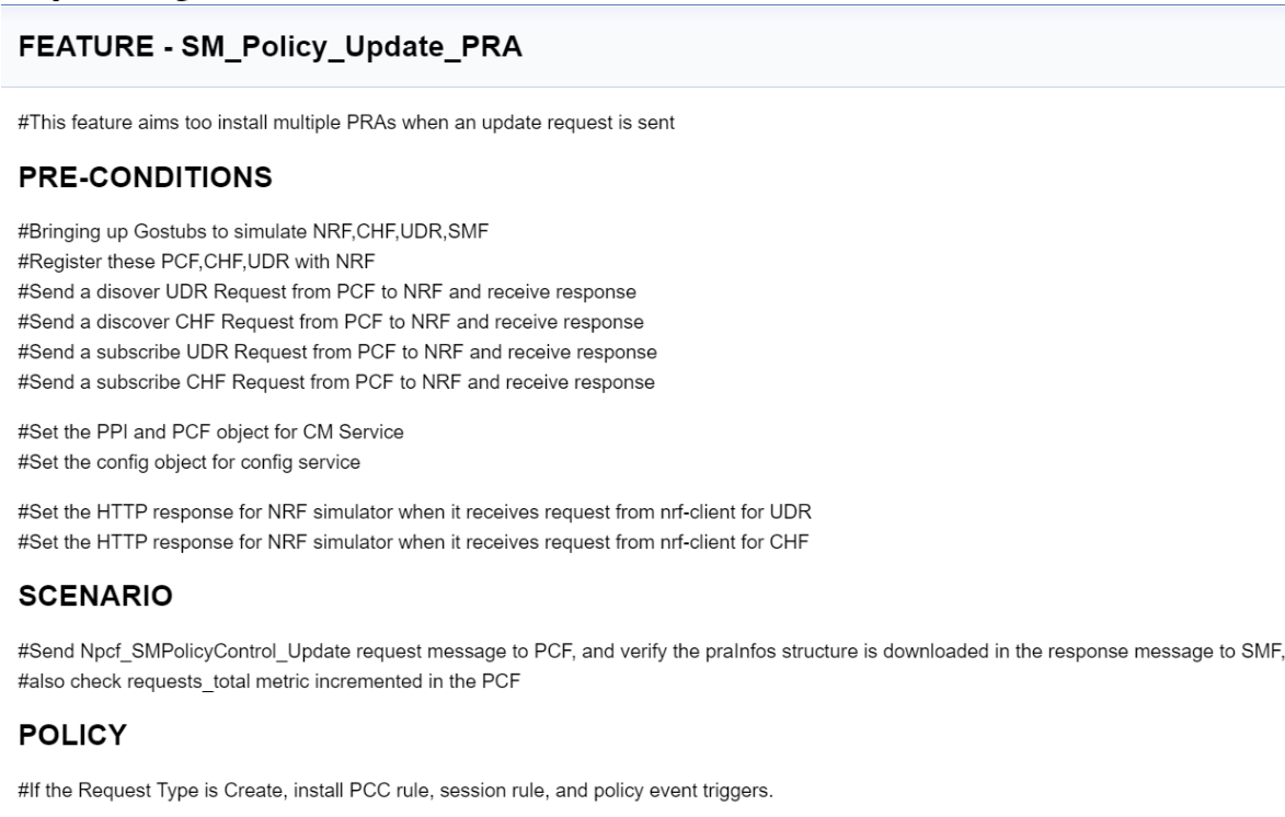

Figure 3-69 SCP-NewFeatures-Documentation
Documentation option appears only if New-Features pipeline is executed atleast once.Figure 3-70 Sample: SCP Functionality
Based on the functionalities covered under Documentation, the Build Requires Parameters screen displays test cases. To navigate back to the Pipeline SCP-NewFeatures screen, click Back to SCP-NewFeatures link available on top left corner of the screen.

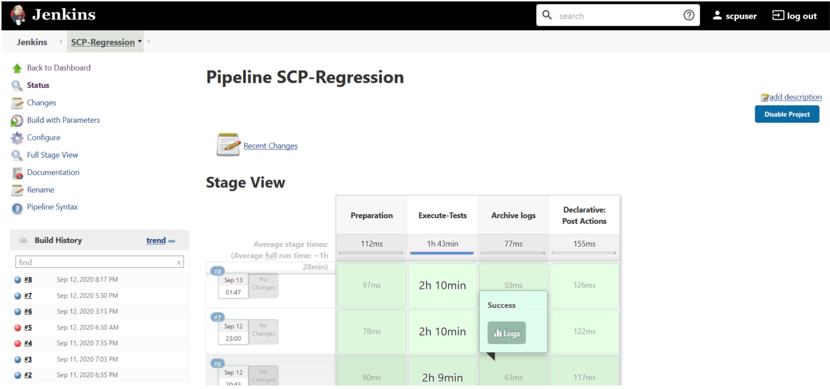

SCP-Regression Pipeline
Figure 3-71 SCP-Regression Pipeline

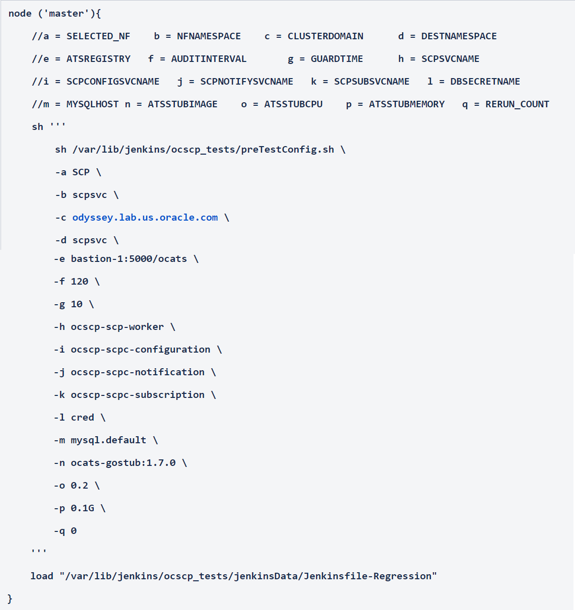

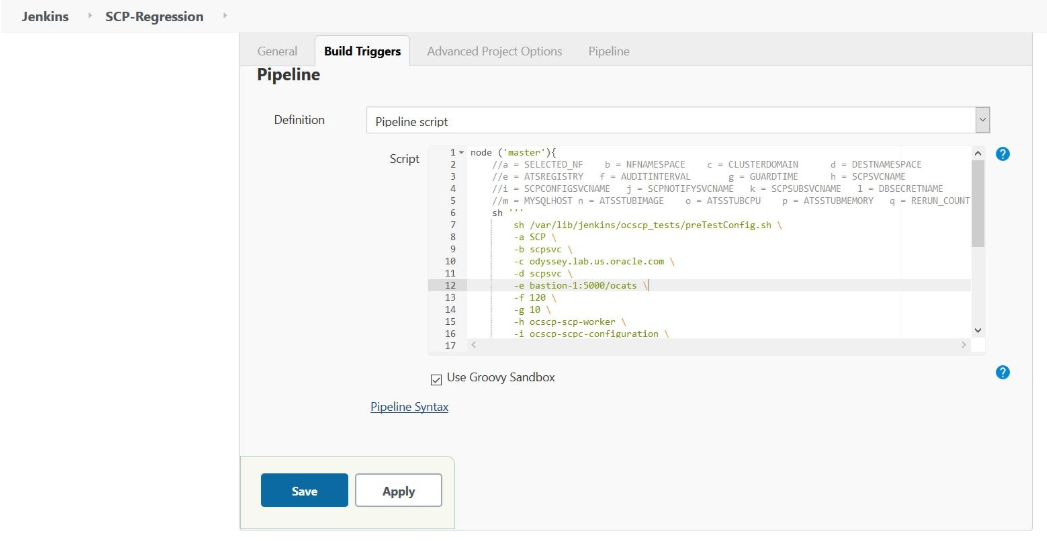

If you are executing SCP pipeline for the first time, you have to set the Input Parameters before execution. Subsequent execution does not require any input unless there is a need to change any configuration.
Figure 3-72 Regression - Pipeline Script
Figure 3-73 SCP-Regression Pipeline Script
-a - Selected NF
-c - K8s Cluster Domain where SCP is Deployed
-d - Test Stubs NameSpace - Must be same as SCP Namespace
-q - re-run count
Figure 3-74 SCP-Regression Build with Parameters Option
- All - To execute all the test cases except SCP_Audit_nnrf_disc. If SCP is deployed with nnrf-disc for Audit or Registration with NRF is not enabled, then you should not use the All option. Instead, use Single/MultipleFeatures option to select appropriate cases for execution.
- Sanity - This option is not available for SCP.
- Single/MultipleFeatures - To execute selected test cases. You can select one or more test cases and execute using this option.
Figure 3-75 SCP-Regression Build Option
Figure 3-76 SCP-Regression Stage Logs

Before logging into ATS, you need to ensure that ATS is deployed
successfully using HELM charts. A sample screen is given below:
There are two ways to login to ATS Jenkins GUI.
- When an external load balancer (metalLB in case of OCCNE) is available and an external IP is provided to the ATS service, the user can login to ATS GUI using <External-IP>:8080.
- When an external IP is not provided to the ATS service, the user
can open the browser and provide the external IP of the worker node and nodeport
of the ATS service to login to ATS GUI.
<Worker-Node-IP>:<Node-Port-of-ATS>Note:
In the Verifying ATS Deployment screen, ATS nodeport is highlighted in red as 30076. For more details on ATS deployment, refer to SEPP ATS Installation Procedure.
Open a browser and provide IP and port details as <Worker-Node-IP>:<NodePort-of-ATS> (As per the above example: 10.98.101.171:32013). The ATS login screen appears.
Executing ATS
- Enter the username as 'seppuser' and password as 'sepppasswd'. Click Sign in.
If you want to modify your default login password, refer to Modifying Login Password- SEPP-NewFeatures: This pipeline has all the test cases that are delivered as part of SEPP ATS - 1.4.

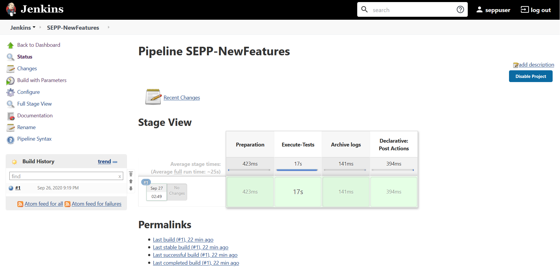

- SEPP-NewFeatures Pipeline: After identifying the SEPP pipelines, the user needs to do one-time configuration in ATS as per their SUT deployment. In this pipeline, all the new testcases related to SEPP are executed. To configure its parameters:
- Click SEPP-NewFeatures in the Name column. The following
screen appears:
Figure 3-78 SEPP-NewFeatures Pipeline
- In the above screen:

- In the above screen, the values of the 'Pipeline script' needs to
be changed. The content of the pipeline script is as
follows:
node ('master'){ //a = SELECTED_NF b = SEPPCONFIGSVCNAME c = CSEPPIGWNAME d = PSEPPIGWNAME //e = SEPPSTUBNAME f = PROMSVCIP g = PROMSVCPORT h = RERUN_COUNT sh ''' sh /var/lib/jenkins/ocsepp_tests/preTestConfig.sh \ -a SEPP \ -b ocsepp-config-mgr-svc.seppsvc \ -c ocsepp-plmn-ingress-gateway.seppsvc \ -d ocsepp-n32-ingress-gateway.seppsvc \ -e ocats-sepp-stubserver.default \ -f prometheus.cne-infra \ -g 9090 \ -h 1 ''' load "/var/lib/jenkins/ocsepp_tests/jenkinsData/Jenkinsfile-NewFeatures" }Note:
The User MUST NOT change any other value apart from line number 8 to line 20.You can change only those parameters that are marked as "a" to "h" as per your requirement.
- a - Name of the NF to be tested in capital (SEPP).
- b - SEPP Config service name including namespace
- c - cSEPP Plmn Ingress gateway service name including namespace
- d - pSEPP N32 Ingress gateway service name including namespace
- e - Stub Server service name inclding namespace
- f - Prometheus service name or IP including namespace
- g - Prometheus service port
- h - Number of times the re-run of failed case is allowed (default as 2).
You do not have to change any value if OCCNE cluster is used and SEPP, ATS and STUB are deployed in ocsepp namespace. - Click Save after making necessary changes. You are navigated back to the Pipeline SEPP-NewFeatures screen.

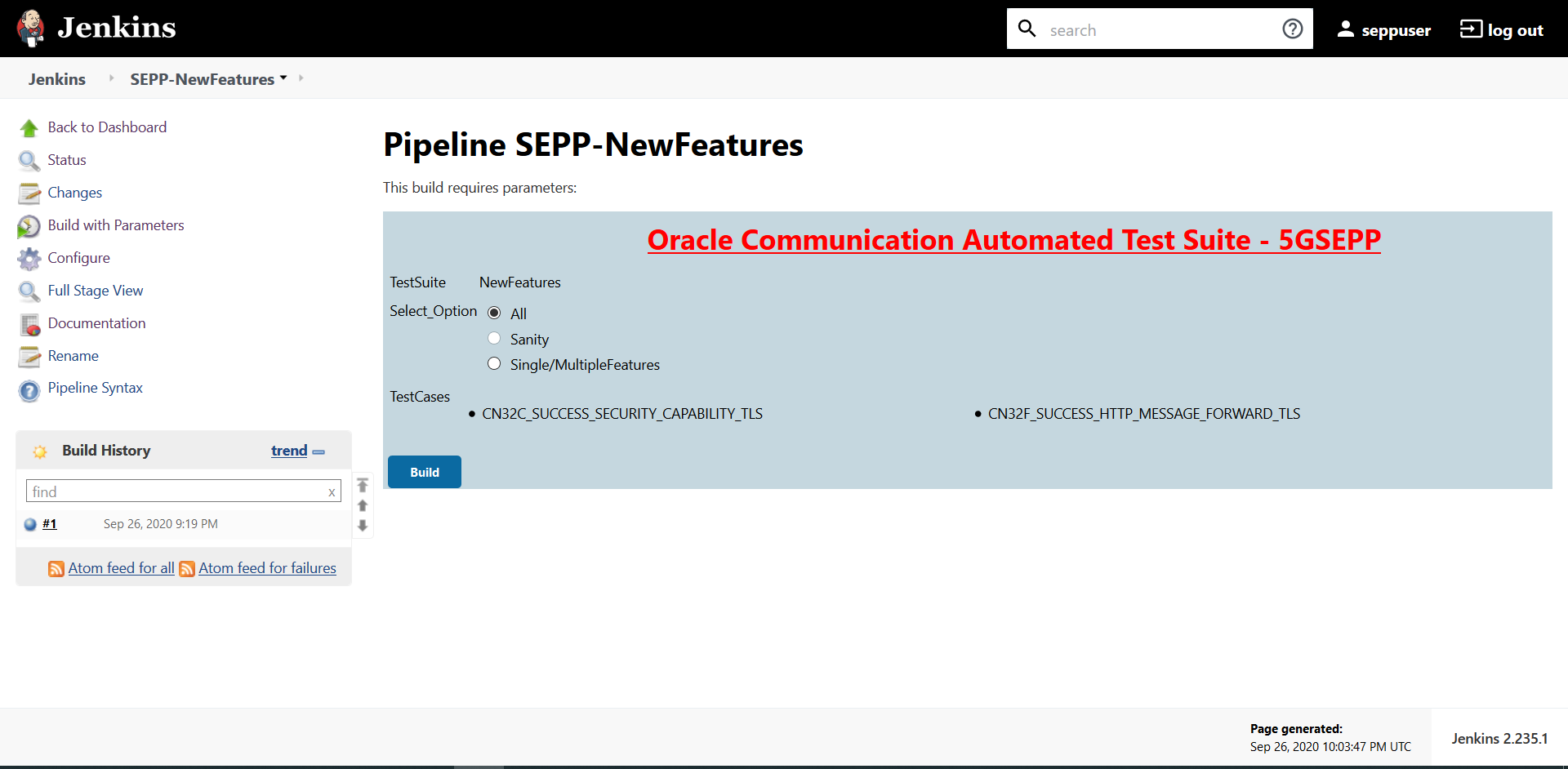

on the SEPP-NewFeatures screen in the extreme right column corresponding to
SEPP-NewFeatures row.The following screen appears:

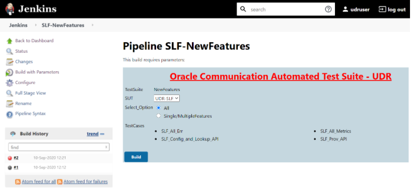

- In the above screen, there are three Select_Option(s),
which are:
- All: By default, all the SEPP test cases are selected for execution. User just needs to scroll down and click Build to execute all the test cases.
- Sanity: Currently disabled.
- Single/MultipleFeature: This option allows you to select any number of test cases that you want to execute from the list of total test cases available for execution. After selecting the test cases, scroll-down and click Build. The selected SEPP test cases are executed.

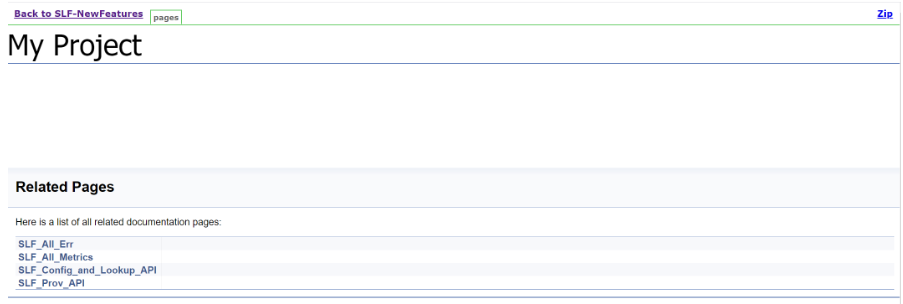

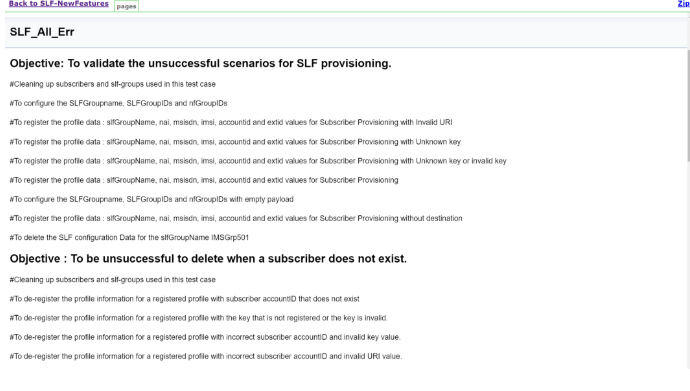

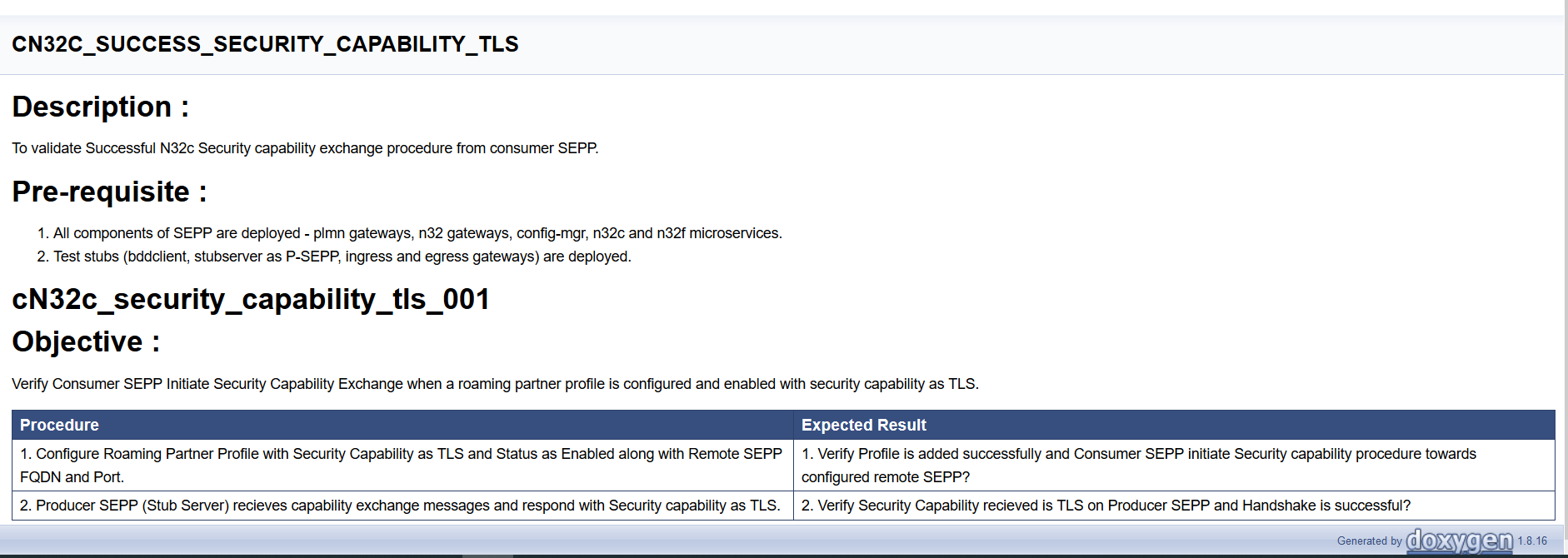

To view SEPP functionalities, go to SEPP-NewFeatures pipeline and click the Documentation link in the left navigation pane. The following screen appears:
User can click any functionality to view its test cases and scenarios of each test case. A sample screen is given below:

The Login screen appears.

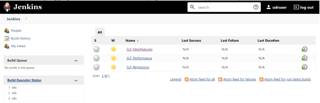

- Enter the username as 'udruser' and password as 'udrpasswd'.
Click Sign in. A screen with pre-configured pipelines for SLF appears
(3 pipelines).
- SLF-New-Features: This pipeline has all the test cases, which are delivered as part of SLF ATS - 1.8.0.
- SLF-Performance: This pipeline is not operational as of now. It is reserved for future releases of ATS.
- SLF-Regression: This pipeline has all the test cases of previous releases.
If you want to modify your default login password, refer to Modifying Login PasswordFigure 3-80 SLF Pre-configured Pipelines

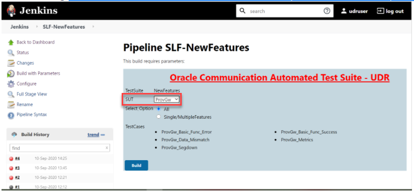

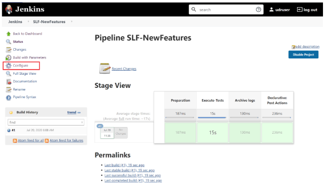

- Click SLF-NewFeatures. The following screen appears:
Figure 3-81 SLF-NewFeatures Configure
- Click Configure in the left navigation pane. The General tab appears. User MUST wait for the page to load completely.
- Once the page loads completely, click the Advanced Project
Options tab. Scroll down to reach the Pipeline configuration
as shown below:
Figure 3-82 SLF Configuration Parameters - Pipeline Tab
You SHOULD NOT change any other value apart from line number 36 to line 58. It means the parameters marked as "a" - to - "w" can only be changed as per user requirement. The detail about these parameters are provided as comments in line number 6 to 12. The parameters description is as follows:Note:
The parameters that you should modify to execute UDR-SLF ATS SUT are: a, b, d, e, n, o and p.- a - Name of the NF to be tested in capital (SLF).

- k - Port of UDR4 ingressgateway service (80)
- l - Name of PROVGW_ingressgateway_service.namespace (provgw-prov-ingressgateway.ocudr)
- m- Port of PROVGW ingressgateway service (80)
- n - Name_of_Prometheus_service.namespace (occne-prometheus-server.occne-infra)
- o - Port of Prometheus service (80)
- p - Number of times the re-run of failed case is allowed (default as 2)
- q - Name of Kubernetes Host server (kubernetes.default)
- r - Port of Kubernetes Host server (80)
- s - Mode of Communication between Prov-gateway and UDR-SLF (Can be either IP or fqdn)
- t - Helm Name for UDR1 (seg1ocudr1)
- u - Helm Name for UDR2 (seg1ocudr2)
- v - Helm Name for UDR3 (seg2ocudr1)
- w- Helm Name for UDR4 (seg2ocudr2)
- Click Save after making neccesary changes. The SLF-NewFeatures screen appears.
- Click Build with Parameters. The following screen
appears:
Figure 3-83 SLF Build with Parameters
To execute UDR-SLF related test cases, select UDR-SLF from the SUT list. This is the default option.To execute ProvGw related test cases, select ProvGw from the SUT list.Note:
To execute the ProvGw test cases, it is mandatory to have 4 UDRs up and running in the same namespace as that of UDR-SLF-ATS.Figure 3-84 SUT as ProvGw
In the above screen, there are two Select_Option(s), which are:- All: By default, all the SLF test cases are selected for execution. User just need to scroll down and click Build to execute all the test cases.
- Single/MultipleFeatures: This option allows you to select any number of test cases that you want to execute from the list of total test cases available for execution. After selecting the test cases, scroll-down and click Build. The selected SLF test cases are executed.
Figure 3-85 SLF-NewFeatures Documentation Option

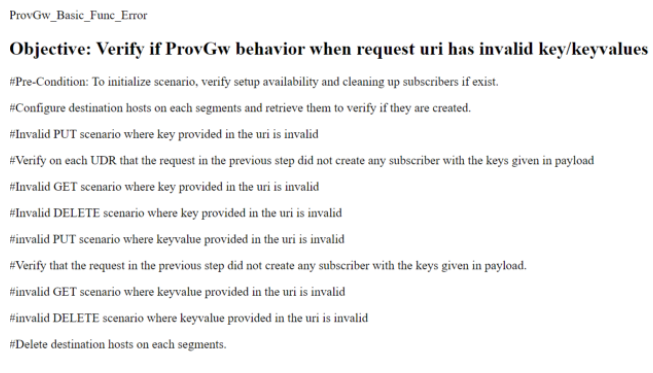

Figure 3-86 SLF-NewFeatures Documentation
Figure 3-87 ProvGw-NewFeatures Documentation
Documentation option appears only if New-Features pipeline is executed atleast once.Figure 3-88 Sample: SLF Test Case Description
Figure 3-89 Sample: ProvGw Test Case Description
Based on the functionalities covered under Documentation, the Build Requires Parameters screen displays test cases. To navigate back to the Pipeline SLF-NewFeatures screen, click Back to SLF-NewFeatures link available on top left corner of the screen.
